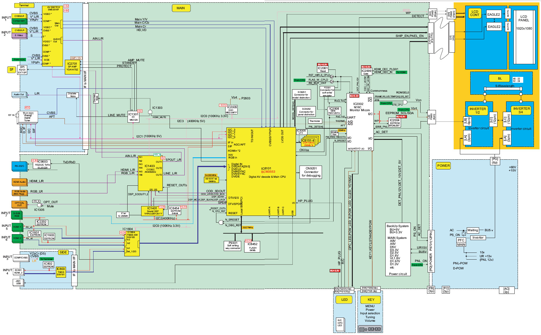

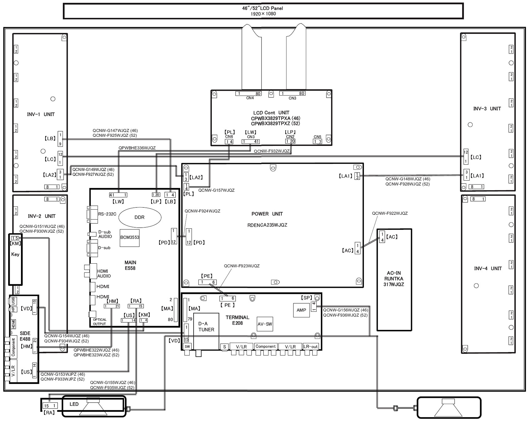

              Ive attached the diagram that shows sorta what communication goes on between the boards. Using it someone might be able to sugest a good path for you to test for errors.

                    Yes sir, I have downloaded the service manual for my set, and I have access to the wiring diagrams and such. Yet, it's been all Greek to me.
                    cashkennedy and multimeter have been kind enough to teach me some Greek, but there is still a lot more to learn, and I am ready to do so.
                    I will post some pictures of the inverter board in an hour or so

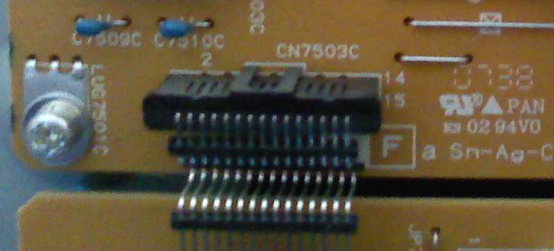

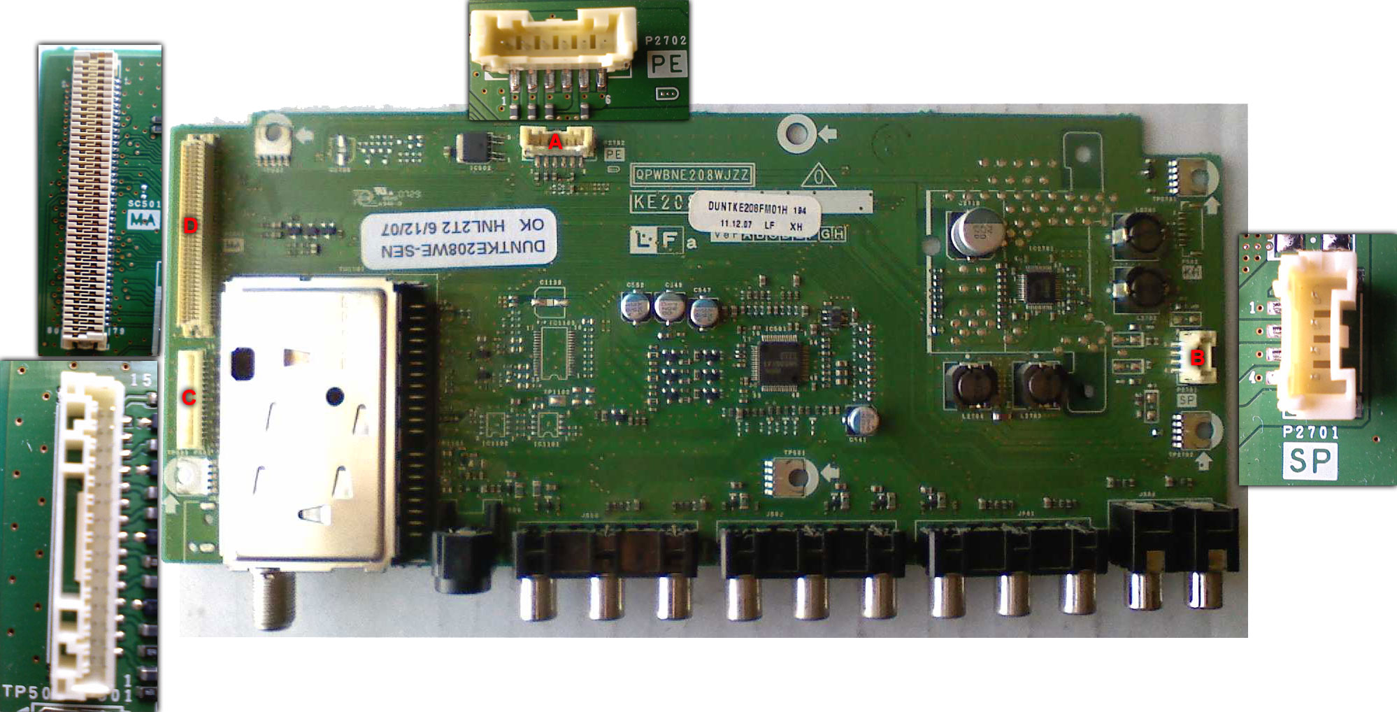

                        I tested the power supply board with the TV in error mode (when it is flashing error codes, and there is no steady power light). The power output to the inverter boards only half worked. The 12v post was reading fine, but the 60v had no reading at all. The connection to the terminal board and the t-con board were still reading fine.
                        Ok, well, the inverter boards are going to be hard to trouble shoot, and I think I would like to leave them for last? There are two to each side of the board, and each pair is connected with a strange bridge (see "connection.jpg" attachment). I am worried about breaking it when I try to detach it and separate the boards. Also, the boards have "high voltage - caution" all of them, haha; intimidating.
                        Moving onto something that I can handle easier, the terminal board. The TV repair man said that I needed a new Main Board, which I have replaced, and the main board is connected (via a bridge) to the terminal board. So, maybe it is the terminal board? Lets reference attachment "terminal.jpg"
                        I know I can test the connection (A) coming from the power supply board because they should be the same voltages as labeled on the power supply board. But after that, everything else isn't labeled; I believe it is listed on the system block diagram (attachment "system-block.jpg") but I have no clue what is what on that.
                        Connection C and D look like they are going to be impossible to test. The plug is going to be in the way. Can I use the probe and touch against the solder point to the board? I feel that this is risky, because I can very easily slip and cross connections - I don't want any more sparks.
                        Any thoughts?
                        Thanks.

                            I dont know much about testing the tuner board, but there is 1 regulator that i can see on the tuner board that you can test.
                            Connect everything and get the TV in the state where all the voltages are on. Then set your multimeter to B region for DC voltage and 20v, and black probe to metal / screw. and then red probe to each leg of the regulator.
                            The regulator is the black dime sized peice on the tuner board that is left of the A connector that goes to the power supply. It has 3 legs, but the middle one might be cut off. it also has a top metal tab that is soldered to the board, the metal tab at the top is the same as the middle leg.
                            You should see something like 12v on the right leg, then something between 3.3 > 9v on the middle leg. and then possibly 0 or a voltage on the left leg.

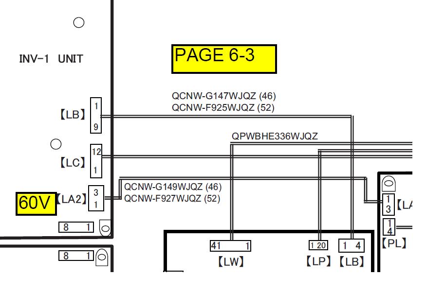

                              OK, since the thread is getting long, if you do not mind, I would like to verify the followings:
                              1) What do you have on PS_ON pin on PD connector (B) when you hit the power switch on the TV?
                              2) "The power output to the inverter boards only half worked"? Do you mean that you are not getting 60v from connector LA_L (E)?
                              There are error signals that the controller will be looking for, the error signal from the Inverter board and from the LCD panel controller board.
                              So if you do not have 60v for the inverter board to operate, the controller will sense that as an error.

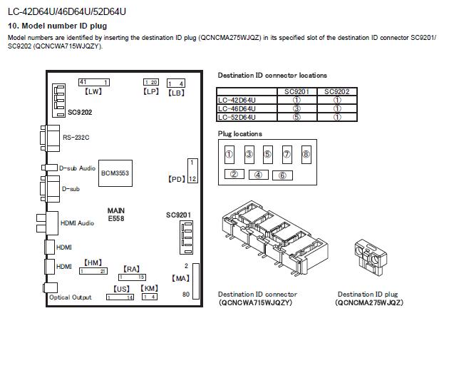

                                          Yes, it may have failed seftest.
                                          By the way, when you got the new board, did you check to make sure the Model ID plug setting is correct per page 3-14?
