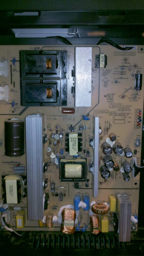

              Re: Sanyo dp46848!!
              is this the board you have got?
              http://www.ebay.co.uk/itm/SANYO-DP46...item2ebcfd19f1
              see if you can post some good close up pictures of your board.

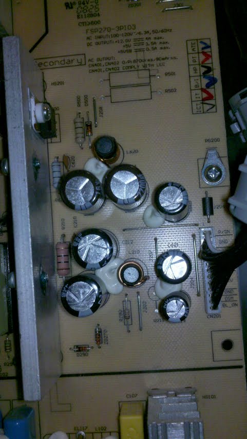

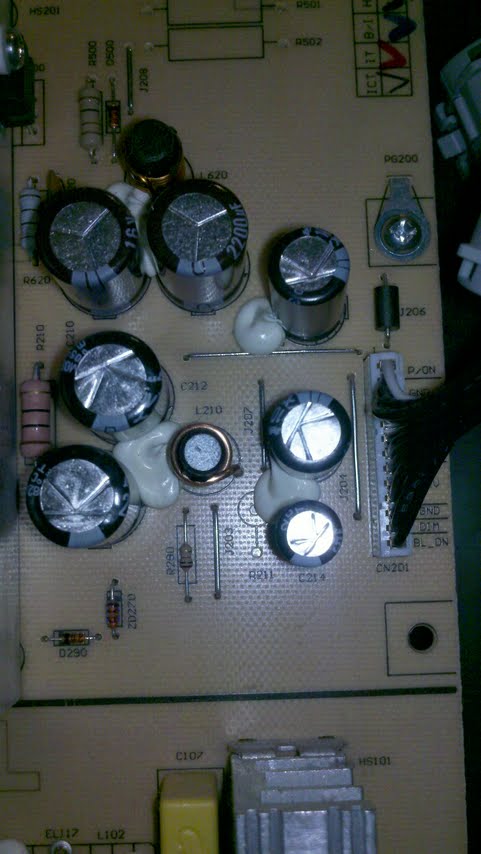

                  • aaronpass
                    • Jul 2011
                    • 33
                    Re: Sanyo dp46848!!
                    • aaronpass
                      • Jul 2011
                      • 33
                      Re: Sanyo dp46848!!
                      Originally posted by aaronpass
                      sorry they aren't the greatest pics

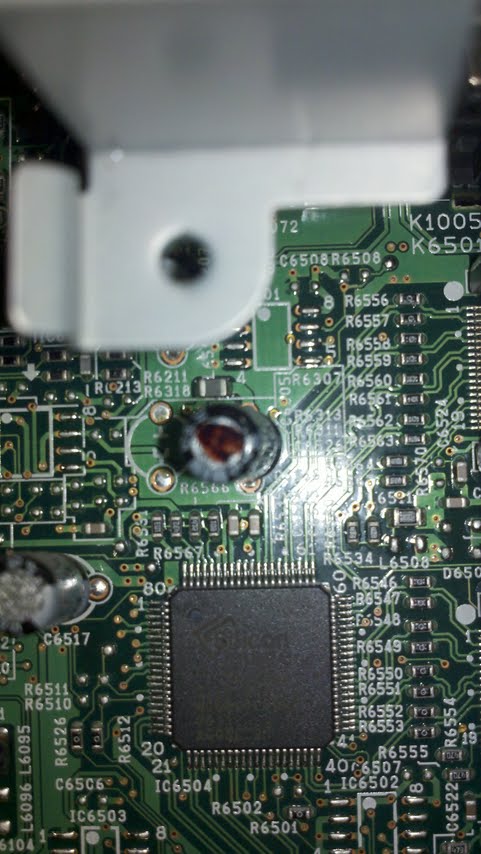

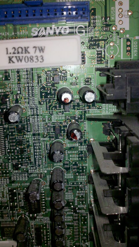

                          Re: Sanyo dp46848!!
                          Here are two pics of the main board and there are three caps that look like they have a stain on top but there isn't any bulging of the tops of them.
                          • cashkennedy
                            • Aug 2011
                            • 668
                            Re: Sanyo dp46848!!
                            Its common to put red marker on the top of caps to indicate they have been tested.
                            If there is any texture / 3d shape to taht red stuff on the top, then those caps have leaked and are bad most likely. On 2 of them it looks like a blob in the pics (and so would be bad), but in 1 it just looks like a marker / or paint coating that is very flat.

                                  I did see any caps swollen on either the power supply board or the main board. I did post pictures. Of three caps on the main board that are either marked as tested or they are leakers. They are 48uf 35v caps i was just gonna change out to be sure, but the only caps i can find available are 47uf 35v will these work??
                                    Re: Sanyo dp46848!!
                                    I've never heard of 48uF caps. Maybe 68uF?
                                    • aaronpass
                                      • Jul 2011
                                      • 33
                                      Re: Sanyo dp46848!!
                                      There is definately a 4 and an 8 looks like 48uf i guess maybe 4.8 but i dont see it looks like 48. Will a 47uf work in its place or am i looking at a sure melt down????
                                      • aaronpass
                                        • Jul 2011
                                        • 33
                                        Re: Sanyo dp46848!!
                                        I must have cooked a few capacitors in my head lol, I misread them you are 100% right they are 47uf 35v caps! im gonna try to change out the caps that have the marks on top of them that look like leaks and see if that changes anything!!
