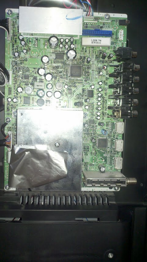

          Next check, regulators on main board. Post a pic of the main board.

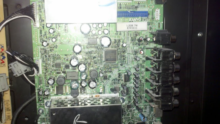

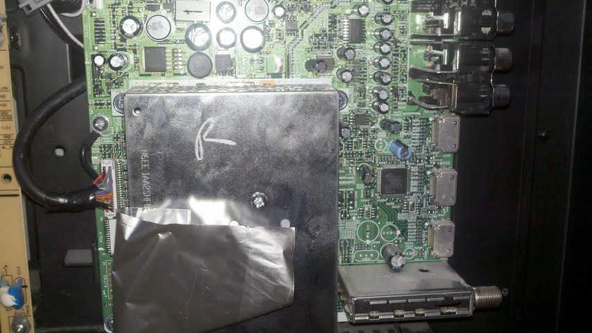

            Re: Sanyo dp46848!!
            Not sure if these will be good enough pictures

              Re: Sanyo dp46848!!
              No they are not good enough - the pictures are the only chance of us being to help you fix this. They need to be as near 2mb as you can get and should look like this

                Re: Sanyo dp46848!!
                those caps don't look like they were marked, look like they are venting drive plasma scotty(lol), hit them with a magnifying glass or usb microscope and look for a fracture in the metal cap, then trace down the culprit that blew them

                    Re: Sanyo dp46848!!
                    Cant say for others, but i'd have preferred decent pictures of the boards straight on front and back and confirmation that you have checked the regulators and re inspected the suspect caps or replaced them.
