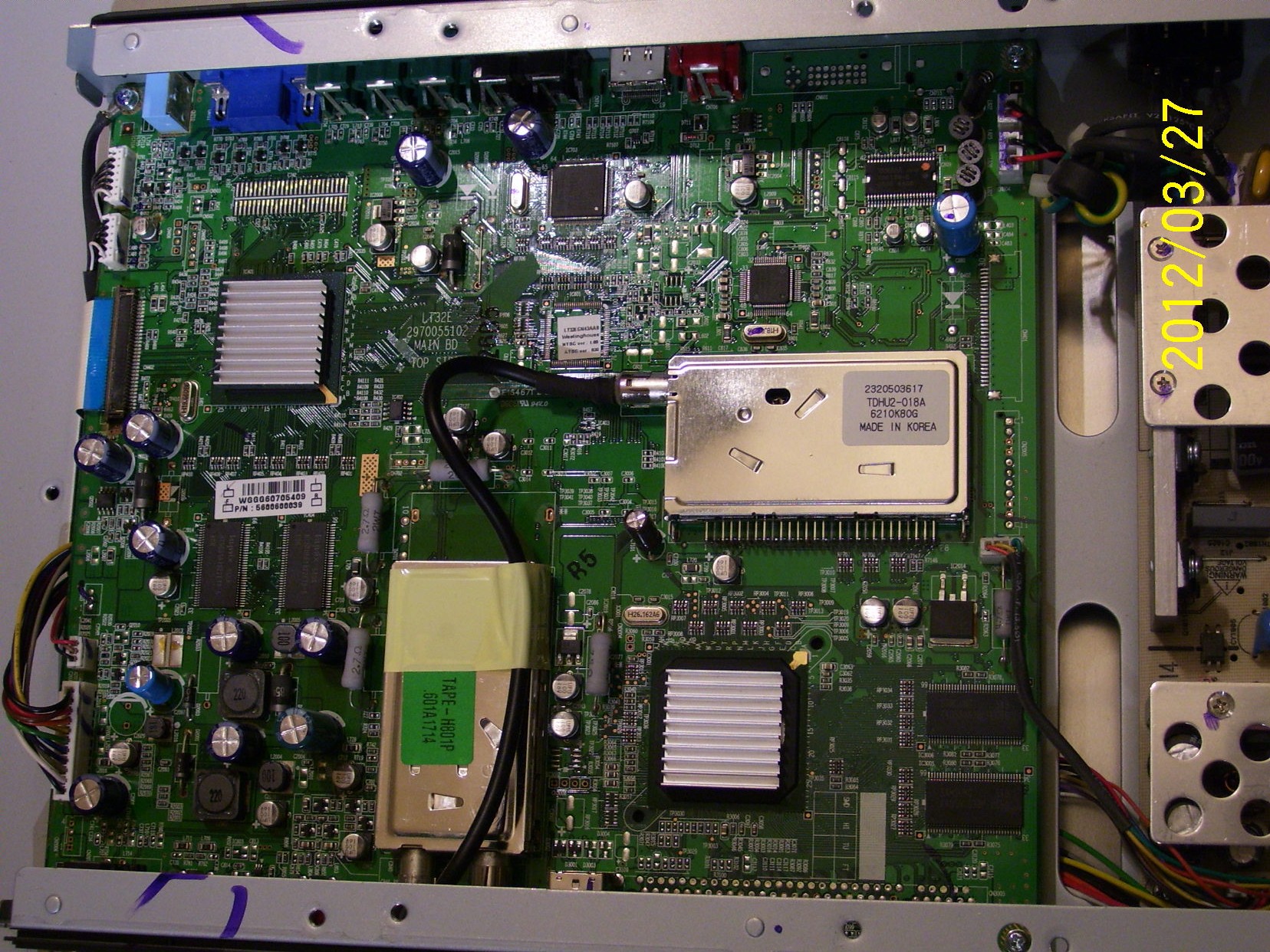

    Whestinghouse LTV-32w6hd has sound but no picture
    This one is out of my knowledge base. The backlight comes on and stays on and I get the blus screen with all OSD Functions except it wont auto scan for channels. Sound works, All the voltage regulators are clearly marked on the logic board and all voltages are @ spec per regulator. I only found 3 of them unless there is more on the back side of the board. I also measured the voltage going to the t CON board and its @ 5.01 volts. HELP Please!

    Hi does it work with other inputs PC/ Scart/ HDMI.
    Is there some discoloration on the top of the tuner box or is it just an unlucky coincidence that the flash or light is bouncing on there making it
    look so

      Re: Whestinghouse LTV-32w6hd has sound but no picture
      None of the inputs will post any video to the panel. That discoloration on the tuner is the light for the ccd sensor on my camera
          Check t-con cable it was bad on mine
          sound no video
          white flat cable
          bad on 1 pin on t-con side of card
          scrubbed all pins with brush and alcohol 91%
          re tin the pin with solder
          check end end with ohm meter - 1 ohm
          bad pin was burned and read 6 + plus ohms
          fiixed mine--
          this after check main board to make sure working right- mine had bad regulator-
          fixed - and the had sound and back light - no video
          trick above fixxed video
