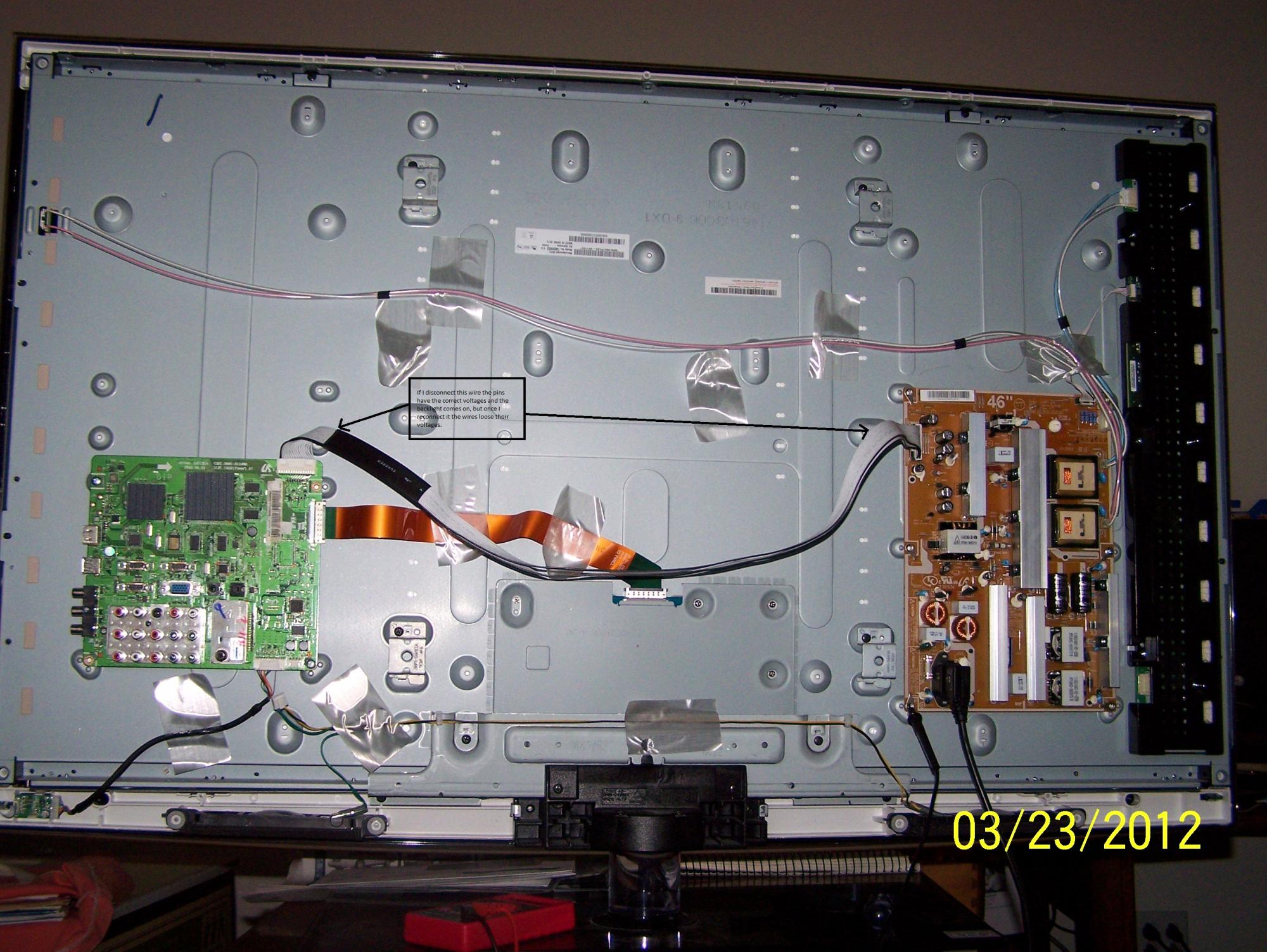

    Next thing you need to do will be taking REAL good pictures of the whole inside of the TV so we see how all the boards are connected together, then the pictures of all the boards.

      I am on Cable... The cable line was definitely surged because I had to replace some blackened connectors. Also, the digital cable box was fried. The Cable box was connected to the TV through HDMI.
      Here are the pics...

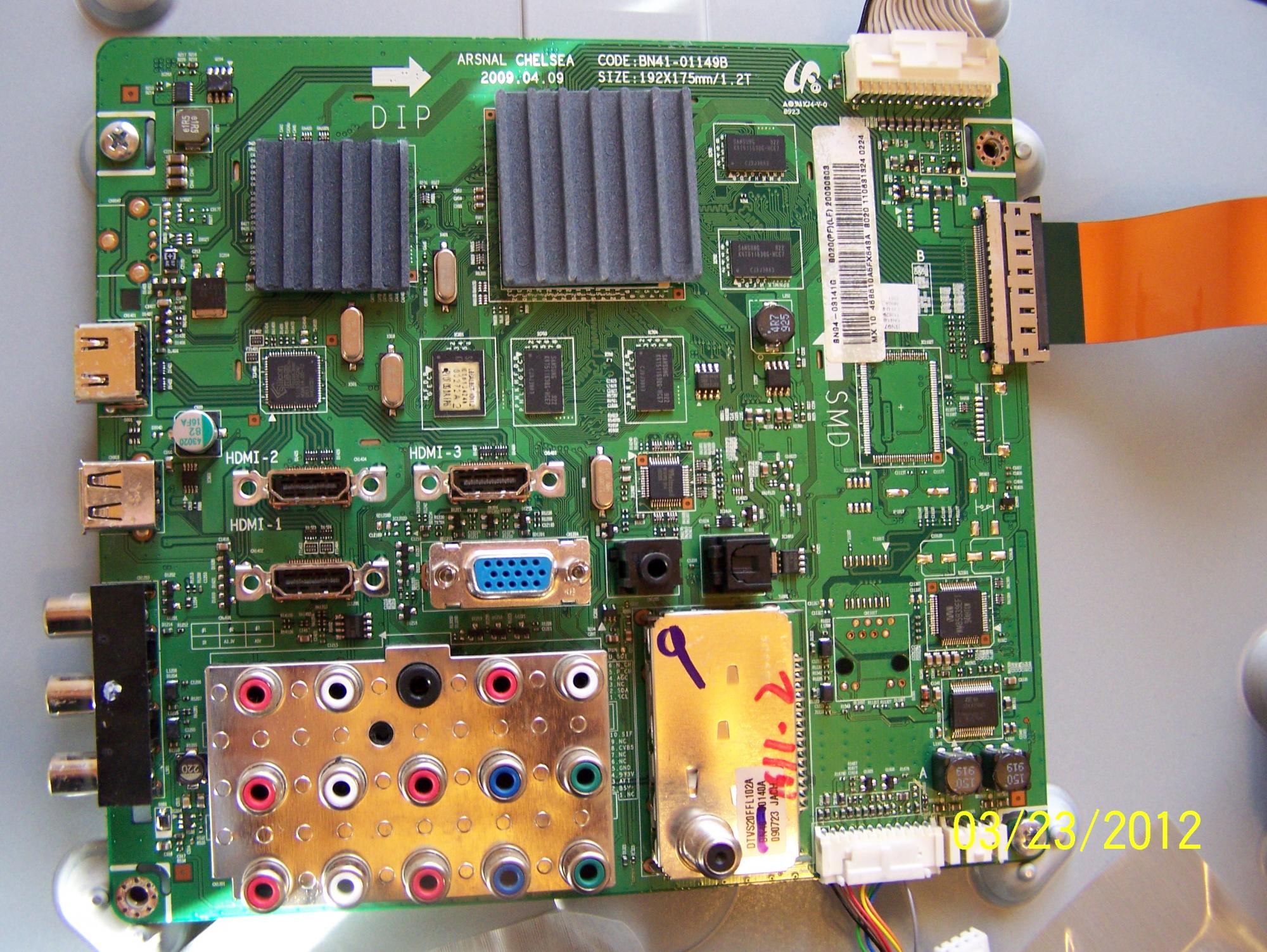

        At this point you should find out first what the replacement board cost will be, when surge hits the main board so many components can be damaged, in other word you may fix one section first then find out later that the other sections are also damaged. It will be real in-depth troubleshooting dealing with desoldering and soldering surface mounted components which takes a lot of skill not to damage the board and the components.

              when looking for a new board, don't use the number on the board itself. use the number starting with BN94 that is usually found on the white sticker (bar code).

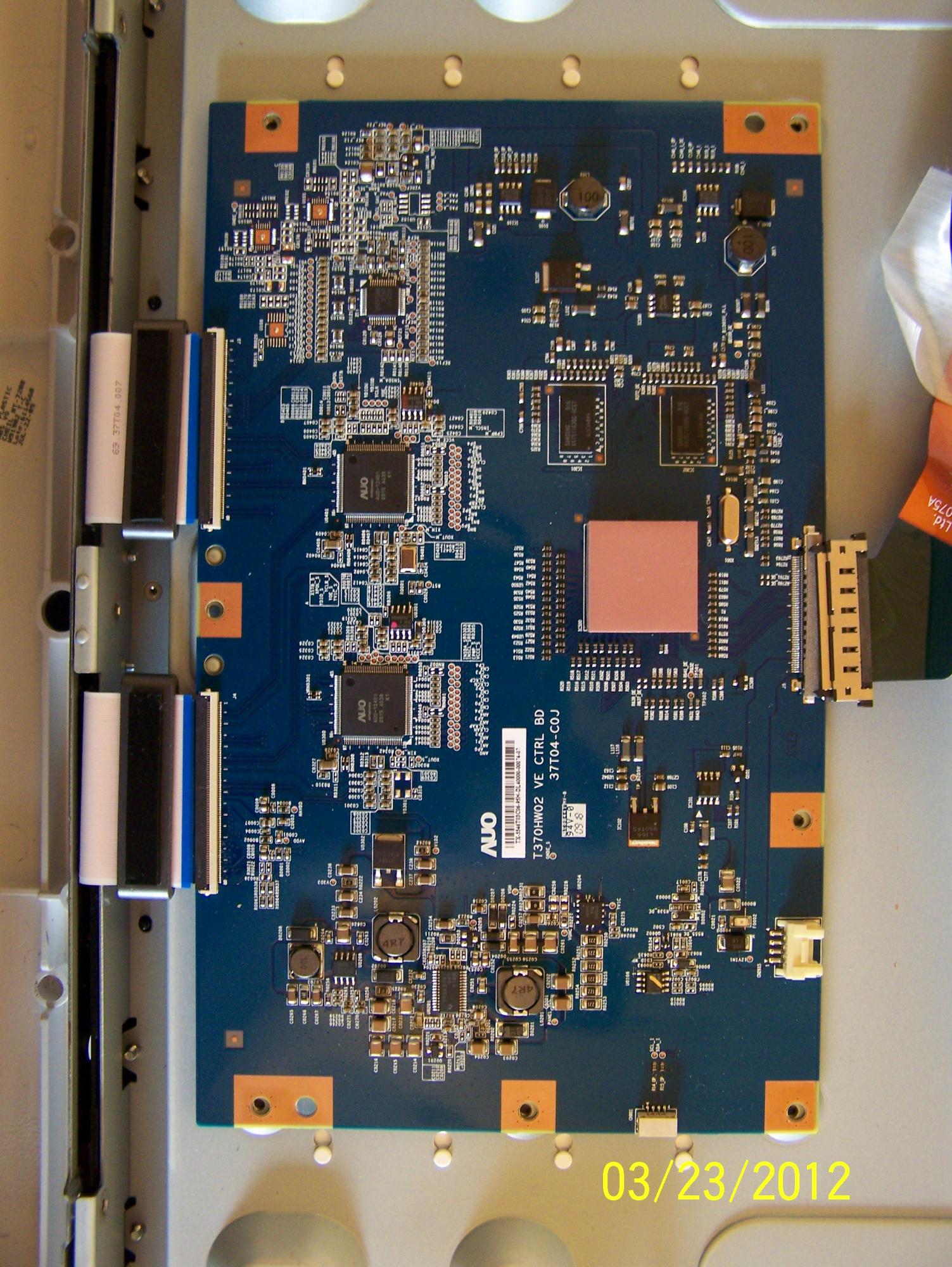

              Also try disconnecting the LVDS cable and see if it will power up. That will rule out the TCON.

                I am pretty sure the main board is bad, the control lines (PS_ON (power supply on), and BL_ON (backlights on) that goes to the Power supply and the Inverter board may be damaged in the main board. One thing that bugs me is that you said the backlights are on when you disconnect all the cables to the main board, is that true? The backlights and the 24vdc power supply should not be on unless they get the command from the main board to turn them on.

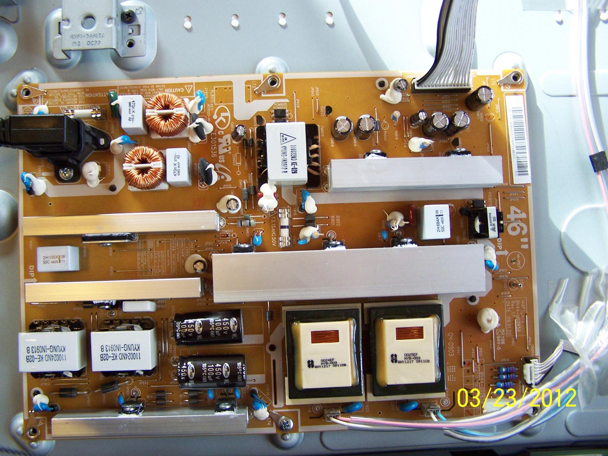

                  When i disconnect the line running from the power supply to the main board (30 pin connector) the back light will turn on (the connector on the power supply is labeled CN801 , but on the main board its CN201). It is the 28 white with two black wires in the TVLayout.jpg above.
                  The back light connector is on the bottom right of pwrBoard.jpg and has 6 white and one black wire.

                    Disconnected the LVDS cable (the brown flat one) and it still did not power up.

                      I do have some voltage to the main board when the cable is connected but it is only 5v to the pin labeled SB (pin 3 I believe) on the power supply board.
                      None of the 13 volt pins have voltage
                        Re: Samsung Ln46b610a5f Power Surge
                        That is normal, the 5vstb is always on power supply, the 12v and the 24v power supply are commanded on by the main board using the PS_ON signal when you hit the power switch or Remote pwr on button. And the BL_ON signal from the main board is routed through the power supply board to the Inverter board.

                              The usual mainboard model numbers for samsungs begin with BN41-xxxxxx.
                              From what I was able to find, your board is a BN41-01149B

                                truep posted (#7) above that I should use the number on the sticker
                                sticker: BN94-03141G
                                Board: BN41-01149b
                                Are they the same? Which one should I use?

                                  Looked at the shopjimmy.com board... shopjimmy says the part number is BN94-03141G and that is on the sticker, but BN41-01149b is still on the board.
                                  I am assuming that the BN41-01149b is the "base" main board, but if Samsung changes/adds anything on that board they give it the new BN94 Number. Yes?No?
                                    The numbers as printed on the BARCODE sticker, the BN41-01149b is the number of the blank circuit board (PCB) (no parts installed) which is used to build more than one version of the circuit board assemblies (PCBA).
                                    So the BN94-03141G is the one you want to use.
