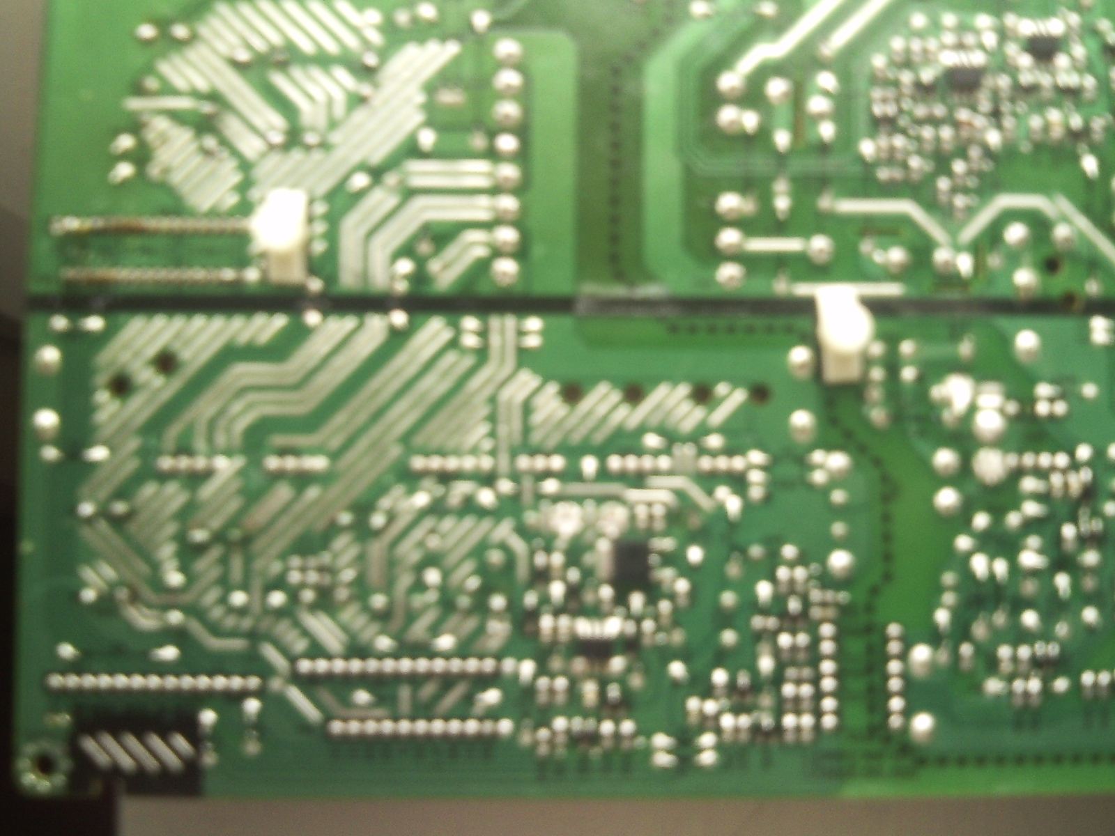

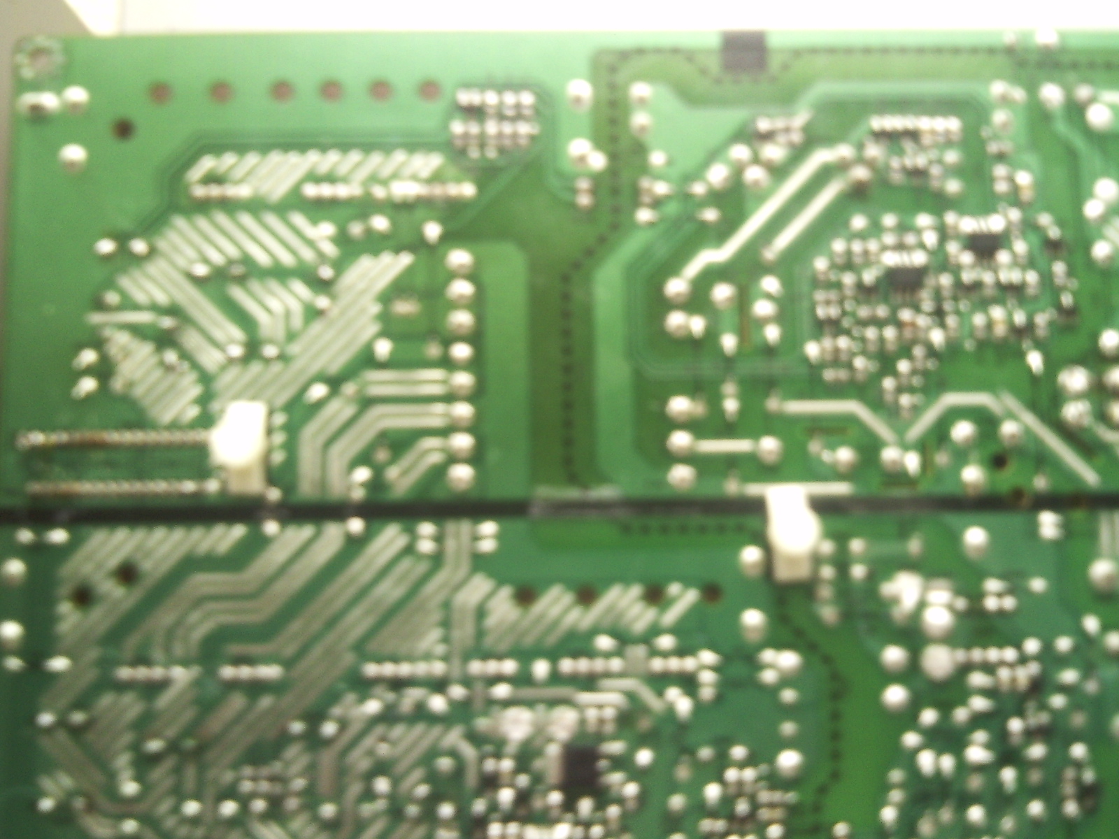

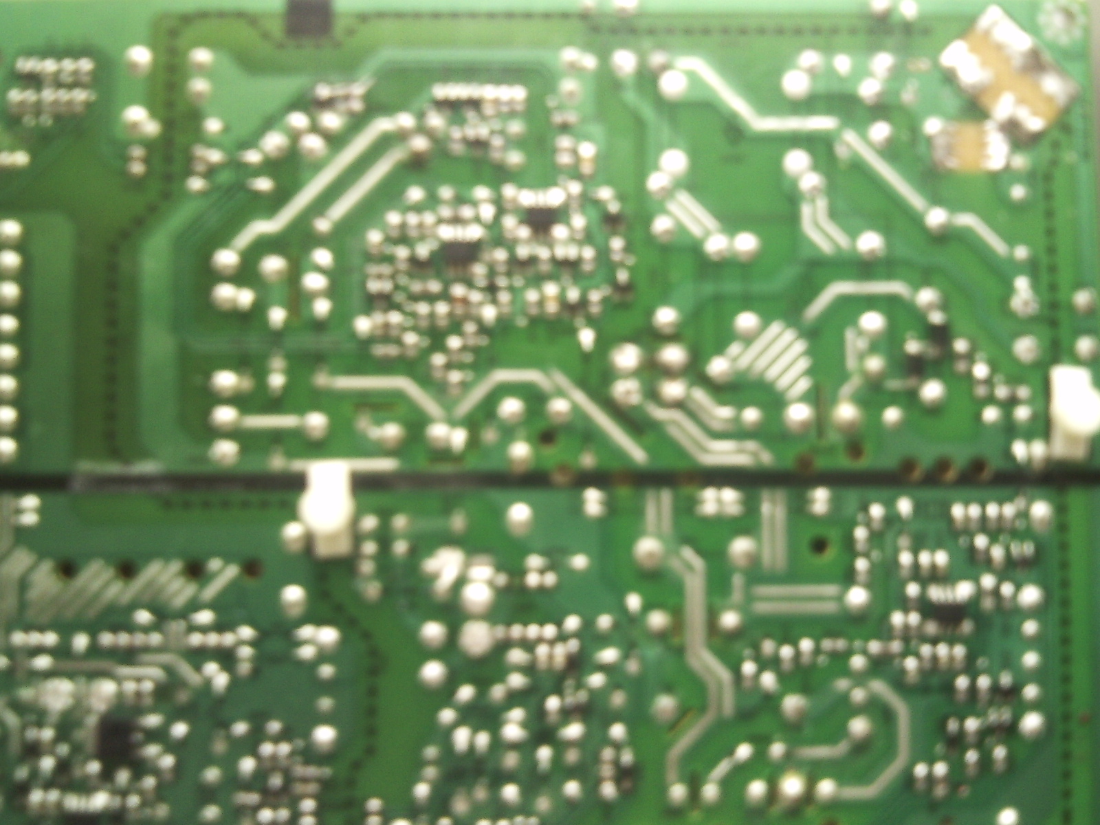

      Re: LG 32lc46 totaly dead

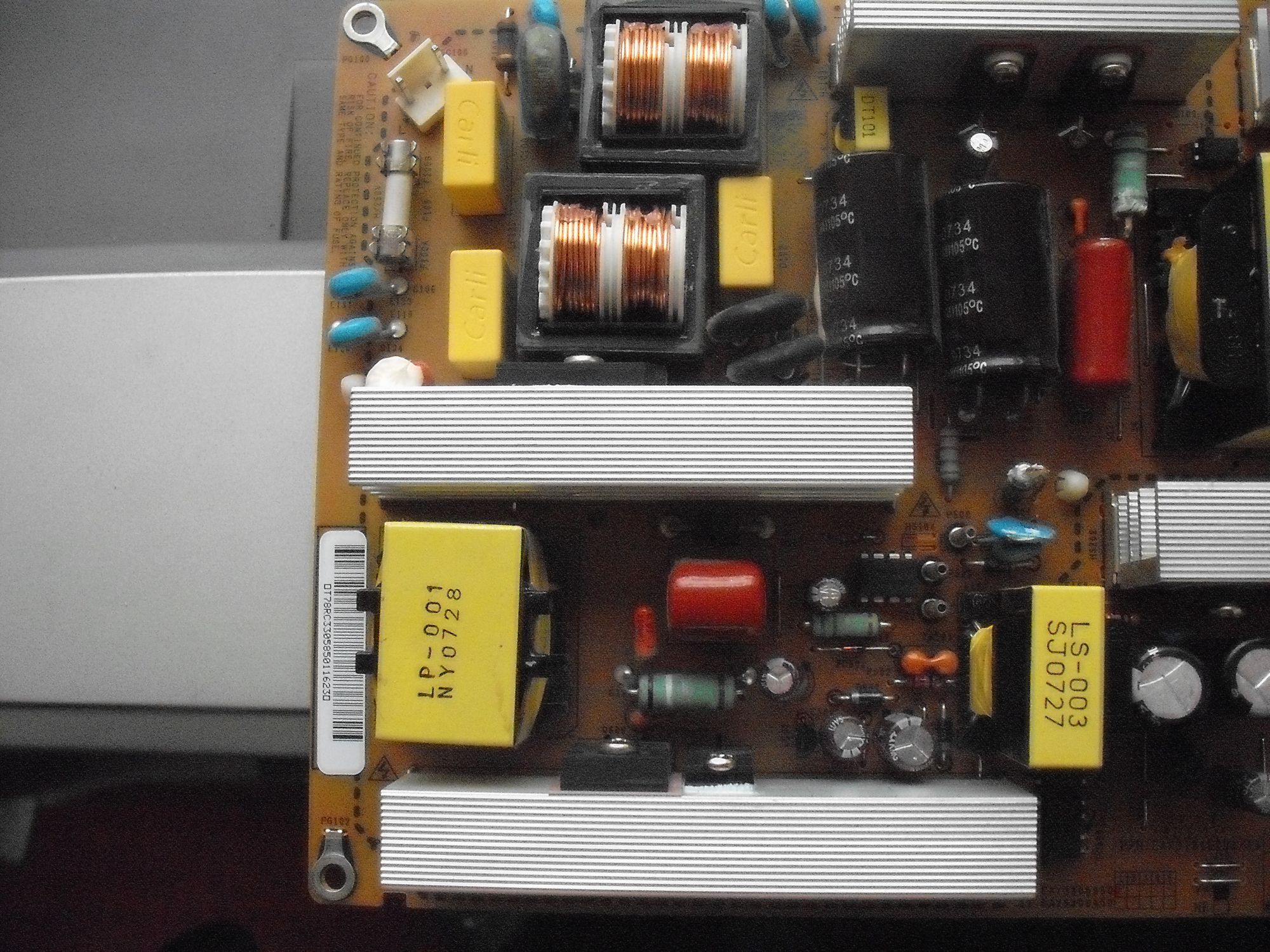

      hi just managed to borrow a neighbours camera took 4 pics before recharable battery went flat (sods law) anyway these are the best i could get so if at all possible could you point out which the controller ic is you think thats faulty giving me no voltages etc. then i will try to get part number of the ic for you to help me locate one if possible. cheers guys
      edit!! just spoke to my local scrap metal man who comes around he says he has a few lcd tvs hes been keeping with smashed screens etc so going around to see him to see if theres a lg lcd there or anything with the same power board numbers etc will update soon.

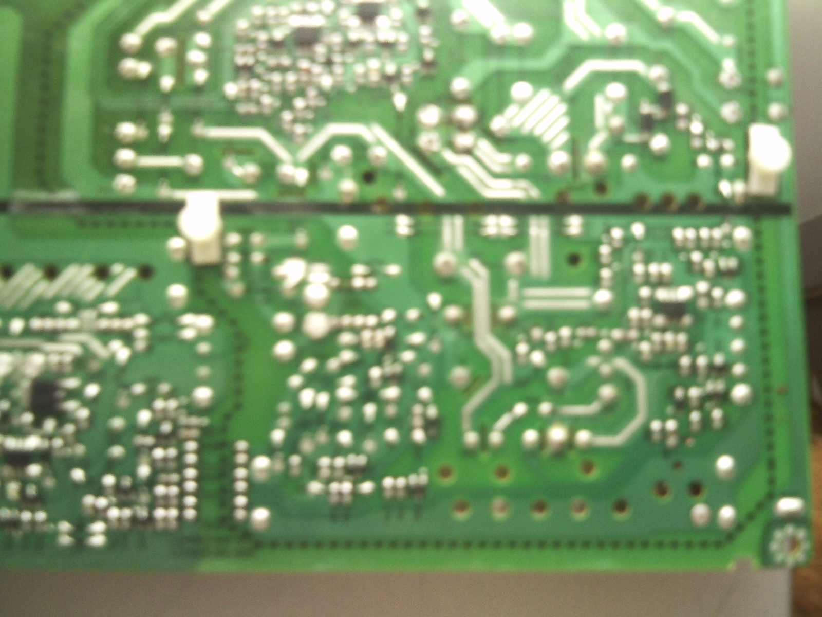

        Hi Vince,
        Its difficult to see anything with those pic's unfortunately.
        Hopefully you have borrowed the charger so that you can have another go. We need both sides of the full board. It looks like you didnt have your camera set to macro which you need to do for the close up shots. Macro is the little flower symbol on your camera.

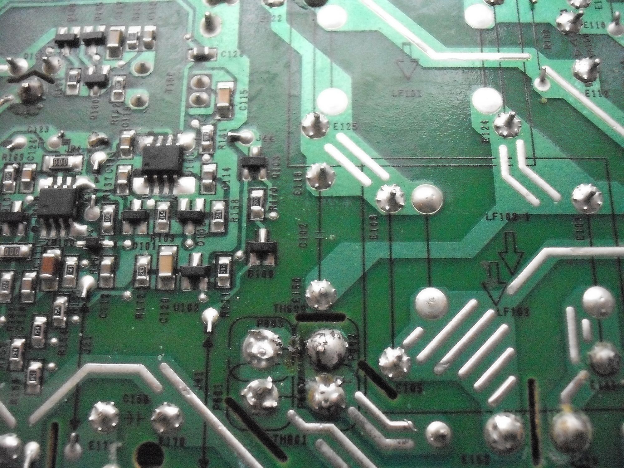

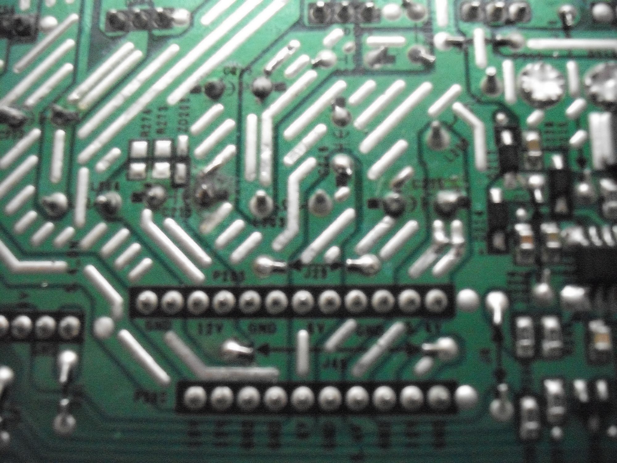

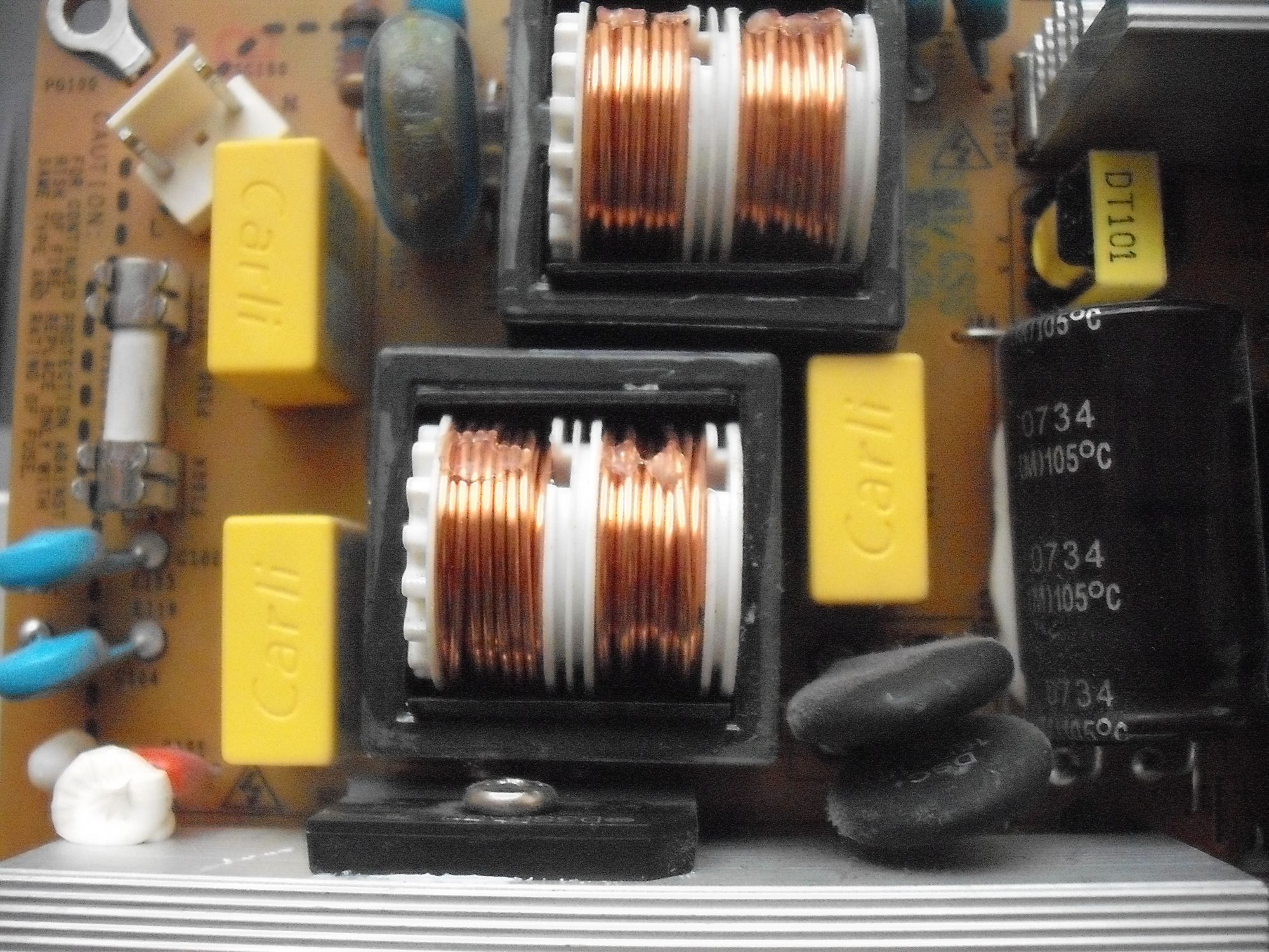

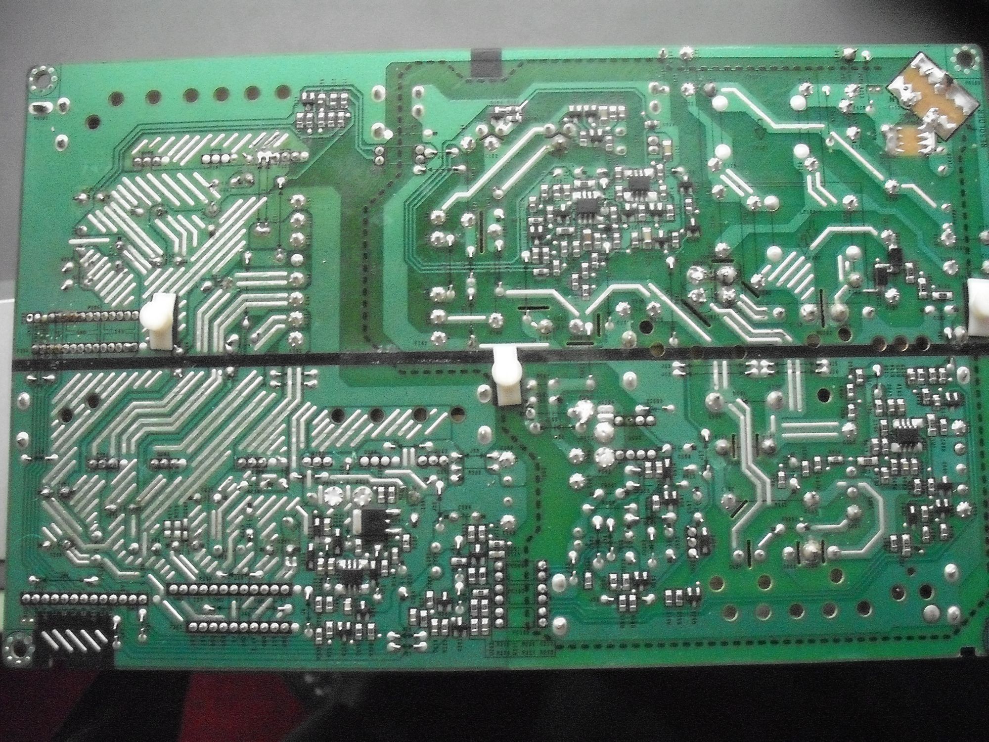

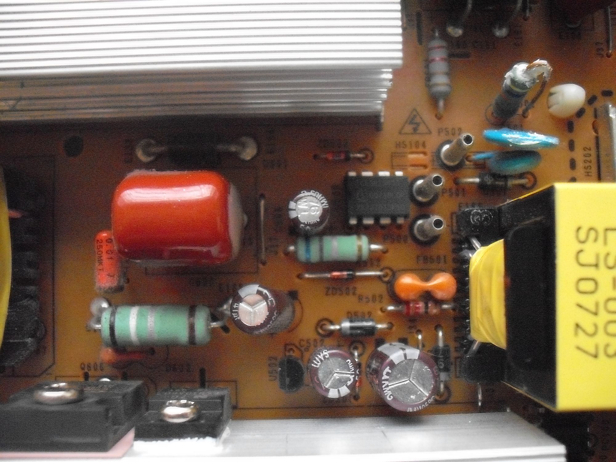

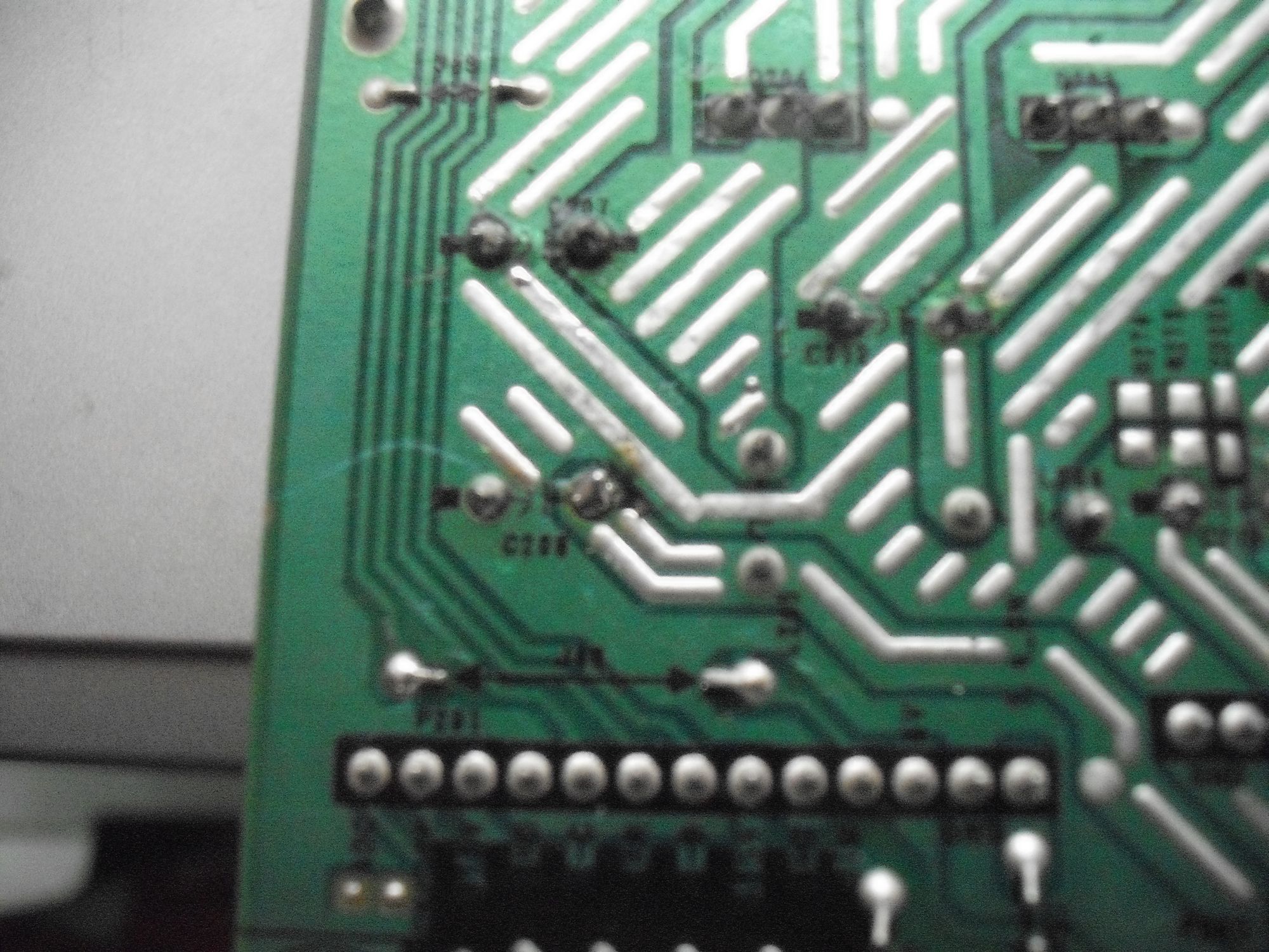

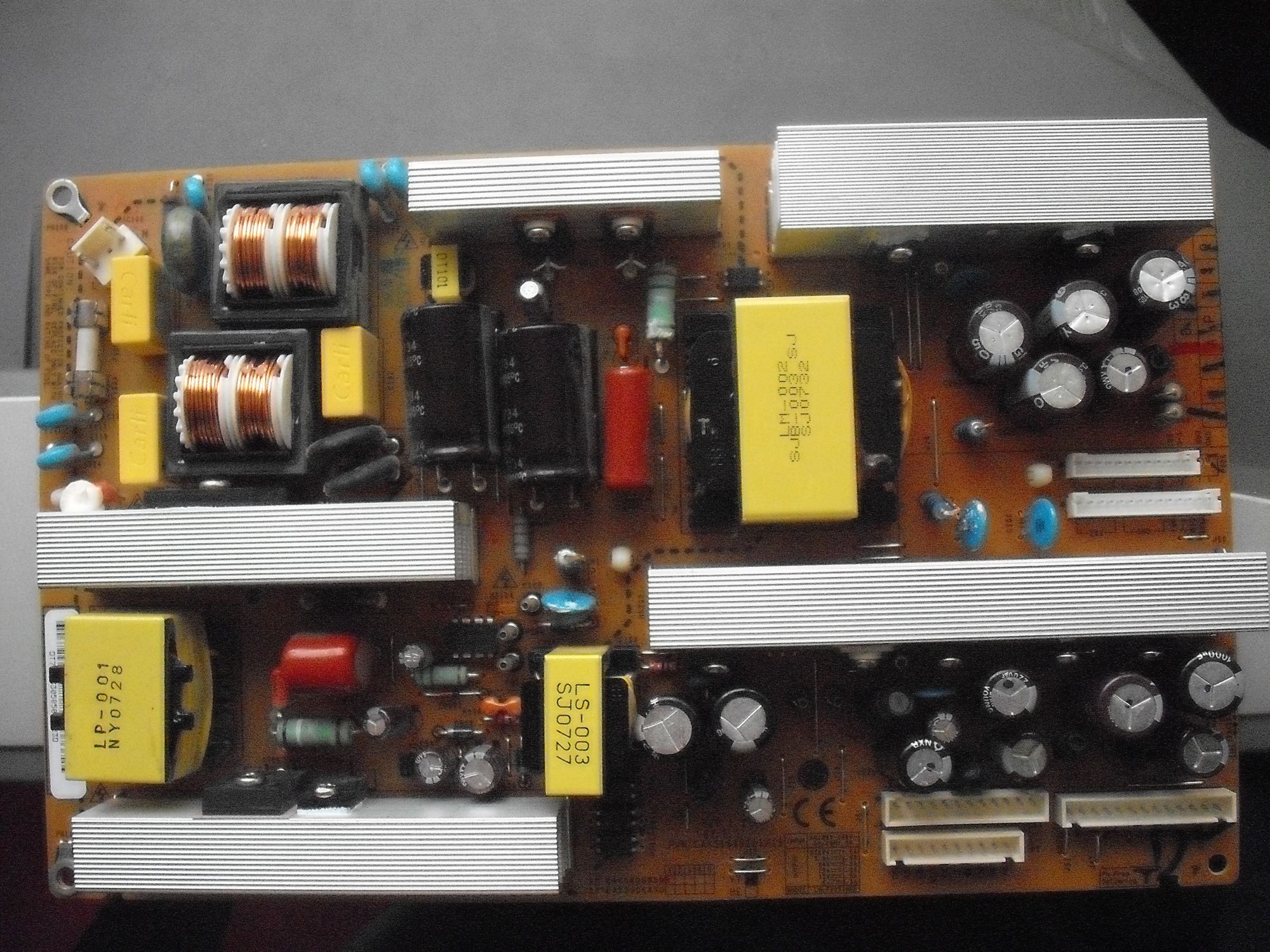

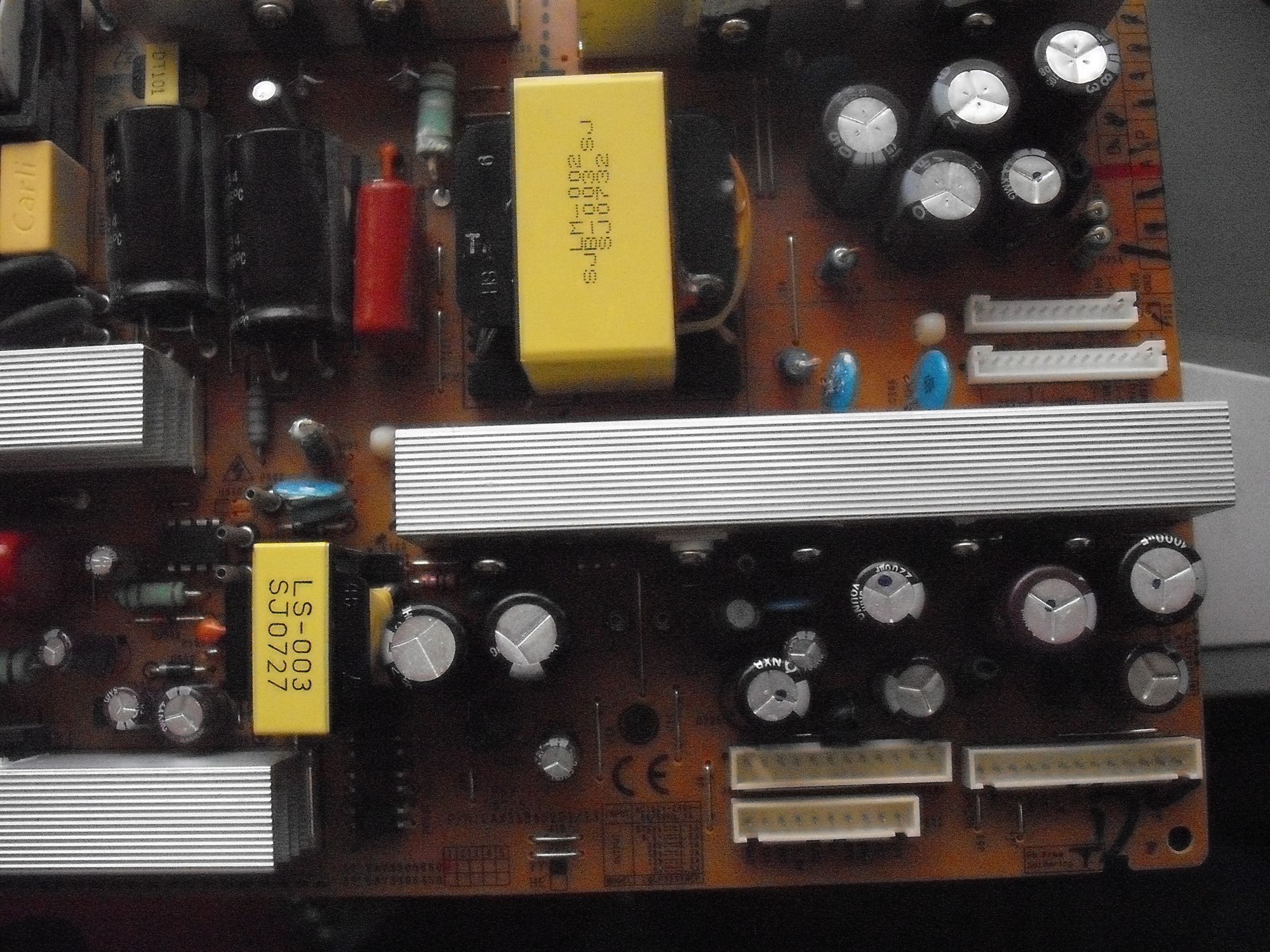

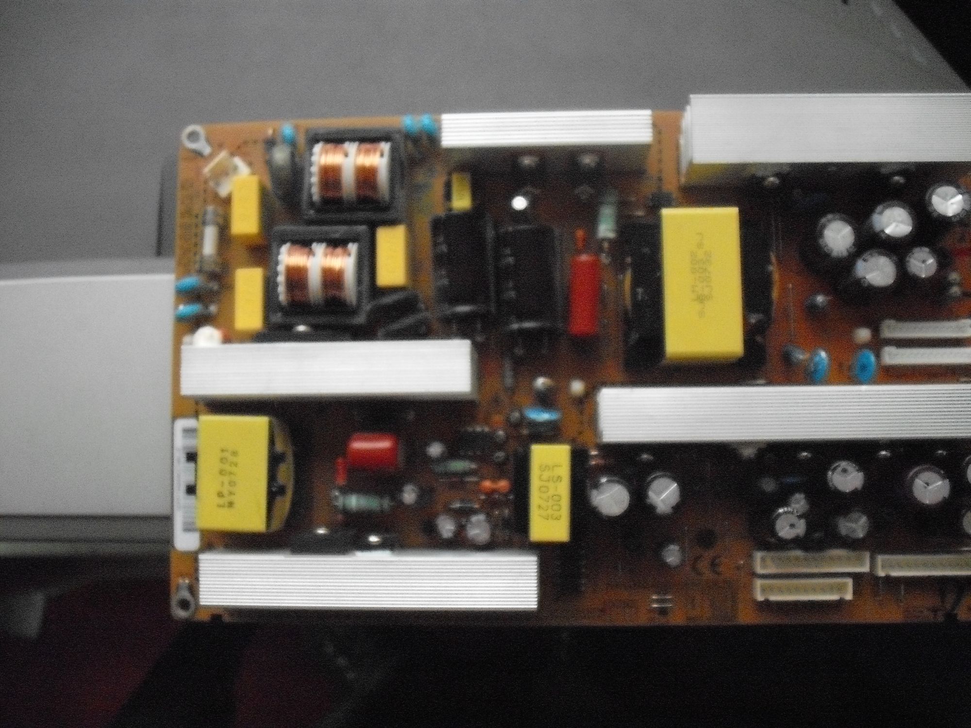

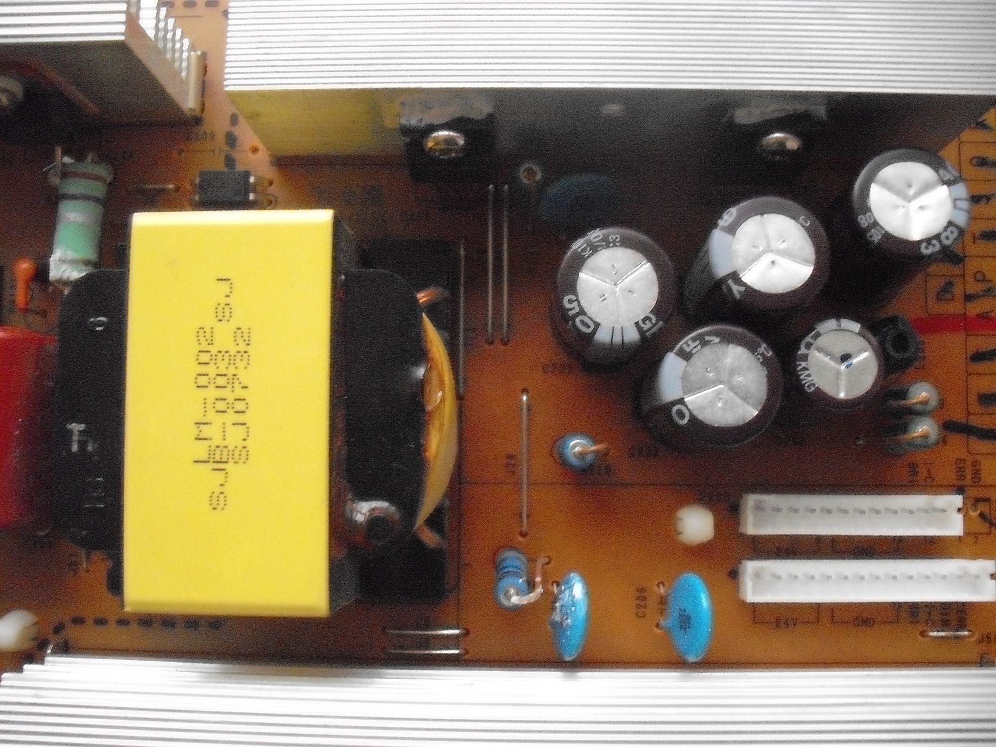

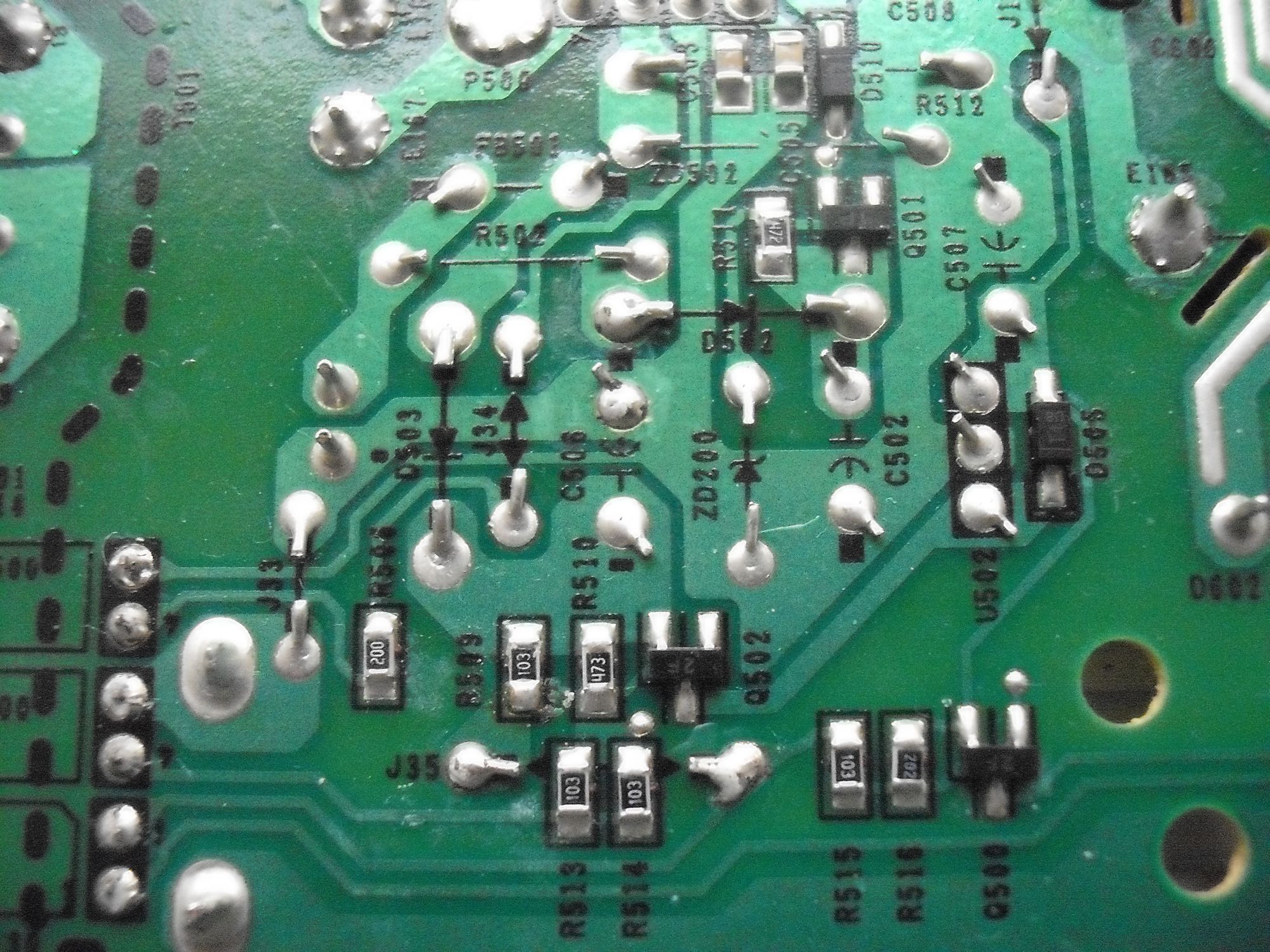

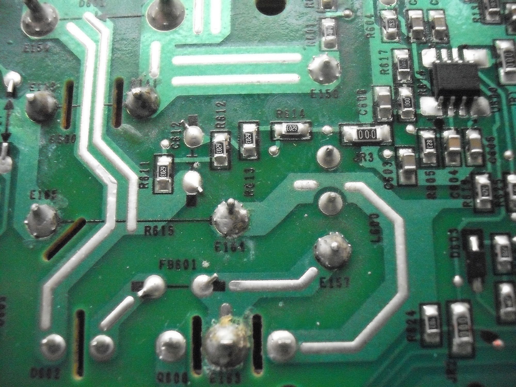

            pics of the underside as requested and a couple of the top view before i recapped it
              What Panasonic caps did you use?
              Also, what is the part # on U200 and U201... the two devices near each other, on the primary side.

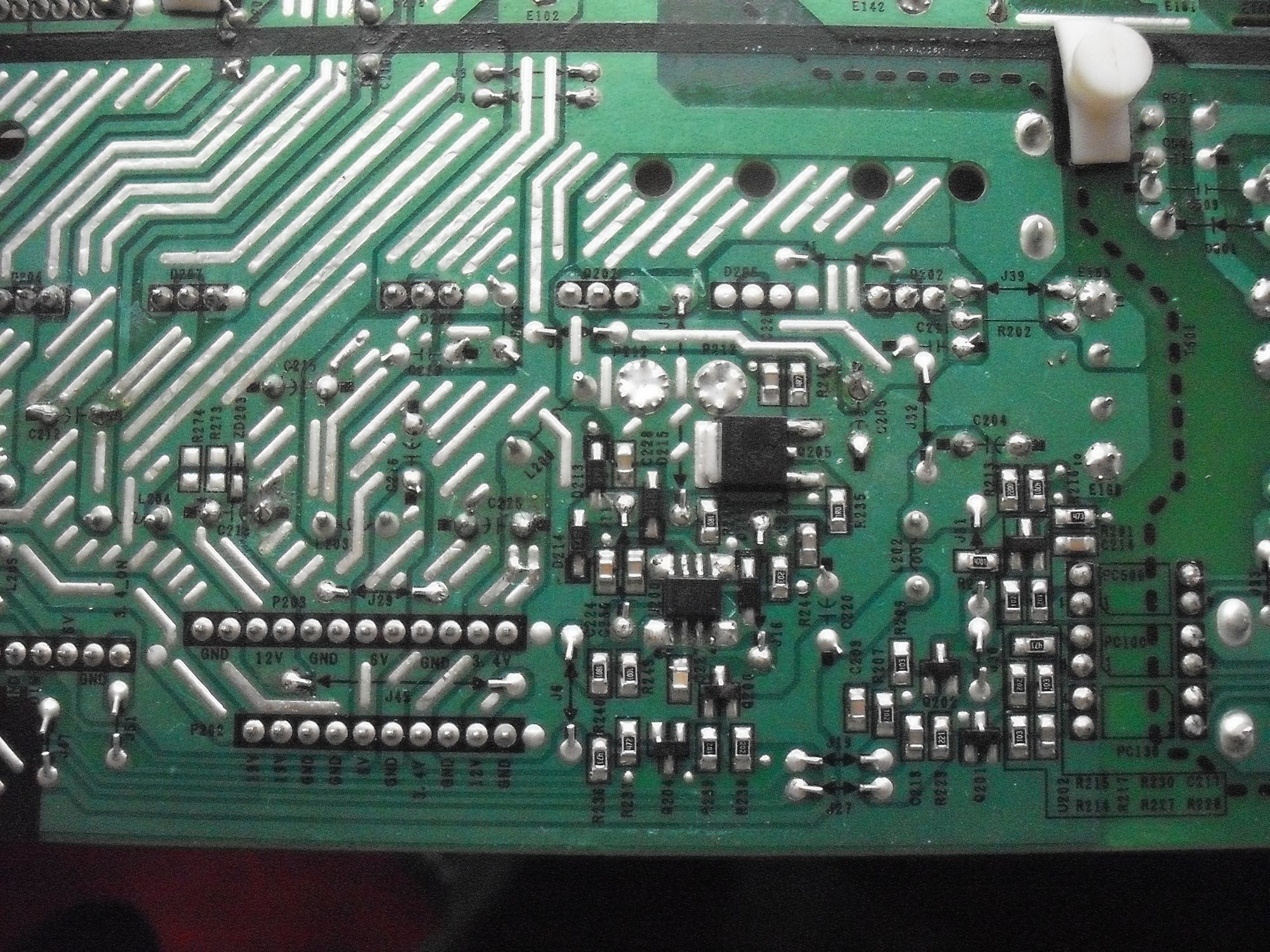

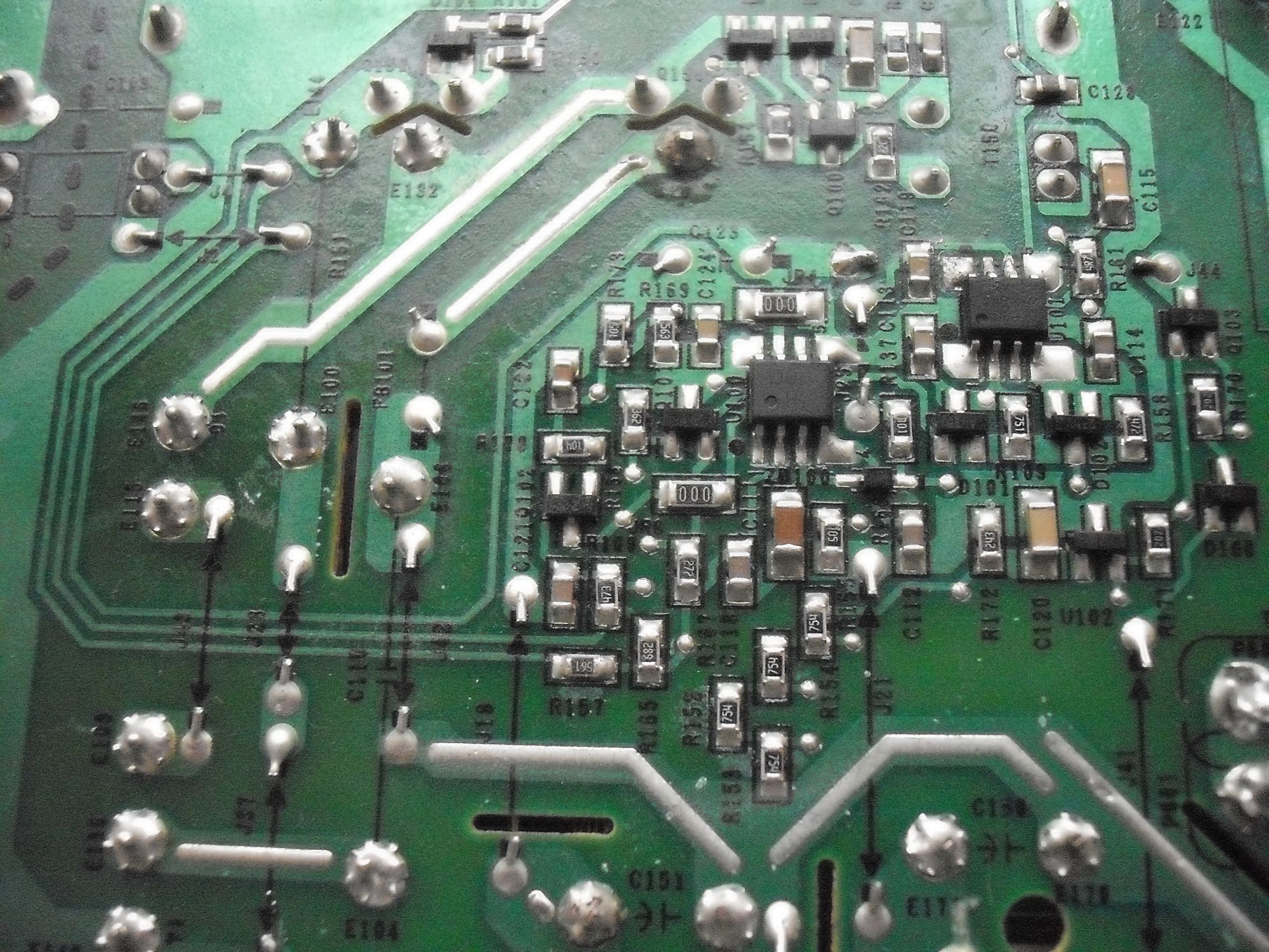

                in pic 8 you mean u100 and u101 well u 101 cant read at all (part number is on it just worn to bad to read even under magnifier) u100 looks like 0001-h26
                all caps were panasonic 105c rated. cant seem to find a power supply circuit diagram/parts list? it says on the board . REV 1.2
                  Try shining some light on it from an angle and you should be able to read it.

                    #29
                    hopefully this is right
                    u100
                    001
                    H26
                    u101
                    MIC
                    44287YM
                    06492
                    these are the 2 on the primary side would these if faulty stop the rail voltages i have missing just retested board still only have the 2x 5volts present

                      #30
                      07.5.7
                      EAX31845201/13
                      What series of capacitors? Should say on the side. For example "FC" next to the temperature rating.
                      I get no hit for the MIC44287; it's quite possible it's a custom LG IC (this has been seen before on Samsung TVs.)

                        #31
                        looks like fc to me
                        so any idea about the chip do you think its the problem? anyidea where to locate one from.
                        also before the M IN MIC there could be another leter or number just cant read it yet will try again now.
                        EDIT!! just re check looks like a funny then so its mMIC
                        4428YM
                        06492
                        http://search.digikey.com/uk/en/prod...6-5-ND/1029922
                        is this it do you think
                                sorry tom66 just read your post right
                                U200 is a
                                U3037M
                                705523
                                next to it is Q205 is a
                                62T03GH
                                725504
                                U600 is a
                                5501A
                                1D07725
                                u101 is a
                                MIC
                                4428YM
                                06492
                                  #36

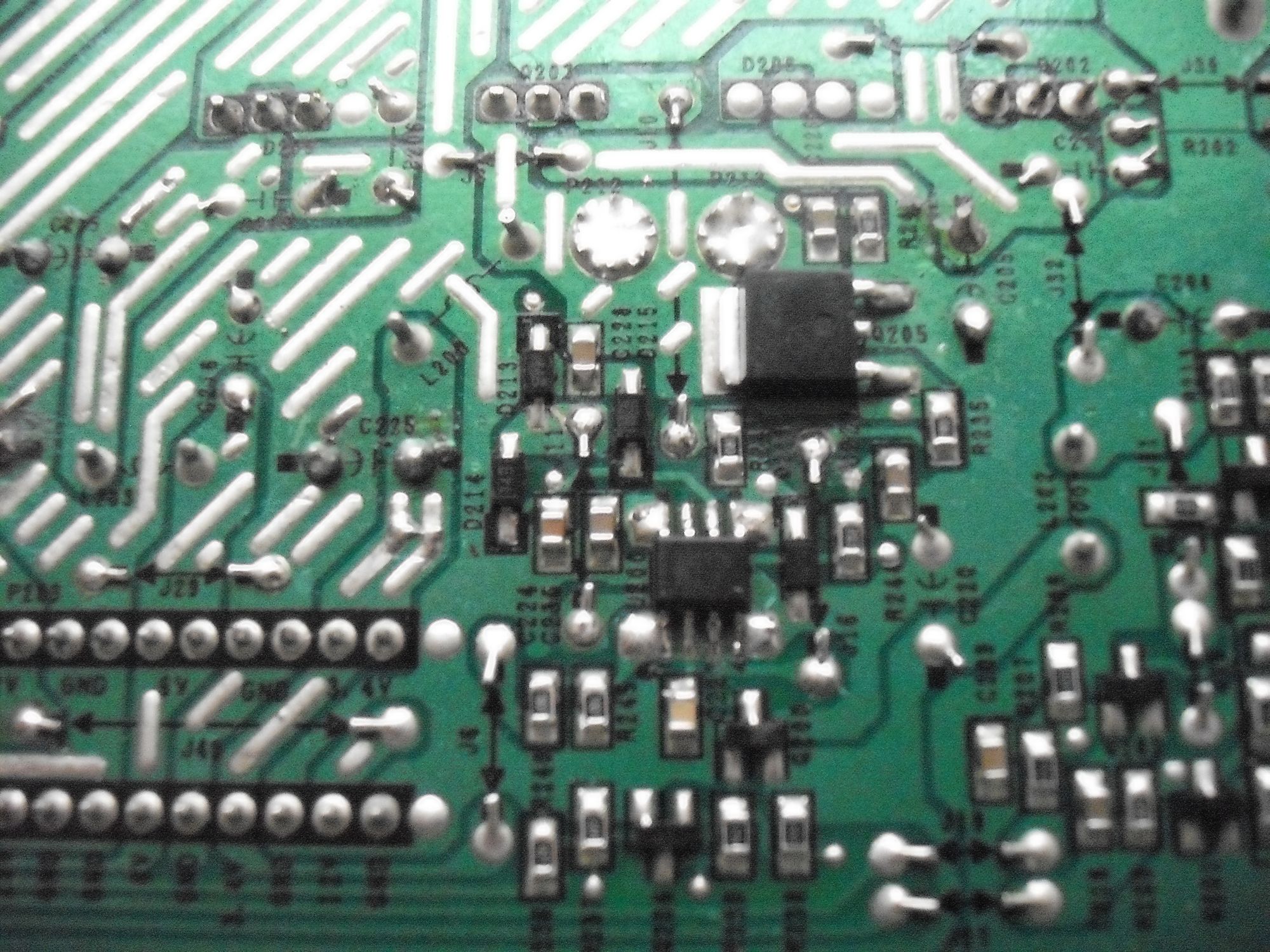

                                  Any readable number on U100?
                                  U101 drives the MOSFET device; U100 probably controls this driver IC.
                                  However, even if you can't read the number... there's a capacitor C123 which is probably the start up capacitor. If this is bad then the controller will not start up.
                                  Do you think you can test the voltage across this capacitor?

                                    yes got a better magnifer u100 is a 0001 h26
                                    c123 0 volts across it
                                    c123 is a 50v 1uf

                                      There should be something like "LM326" (as an example) - some characters then some digits.
                                      C123 is your problem - assuming that was taken with power applied?
                                        power applied board turned over black lead cap- red lead cap+ power turned on 0 volts dmm set to dc volts
                                        EDIT!!!! just changed that cap again still no voltage across it?

                                          This is good, as it helps us locate the problem.
                                          Check the DC resistance between the cap positive and negative, with the TV off.
