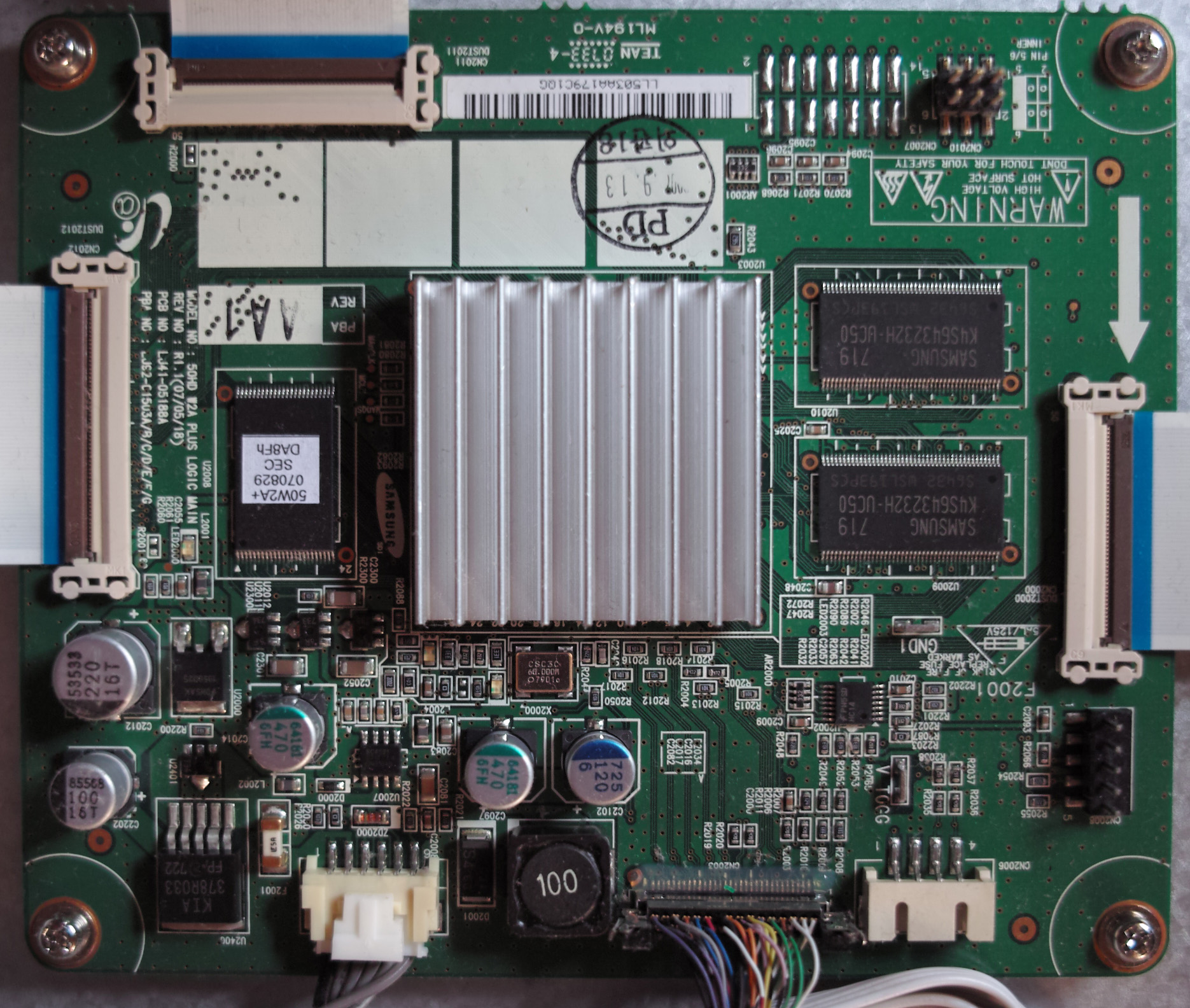

      I've attached a pic of the smaller logic board underneath as well.
        Re: Samsung PS50C91HD - No picture, not sure which board is faulty
        5.22V is fine.*
        (*probably.)
        Hot plugging is only bad if you do it on the sustain boards, in which case that usually blows the fuse but everything else survives.
        What is the voltage on either end of the fuse on the logic board?
        I see several LEDs on the board, do these light? (One is marked LED2000.)
        I've highlighted two devices that are probably voltage regulators. With the black probe grounded on the case and the TV turned on:
        For the bottommost - check all 5 pins and report back.
        For the topmost - check both exposed pins and the metal tab. Don't check the centre pin as that's the same as the tab (electrically common.) Report back the part #.
        Be very careful not to bridge any pins while checking.

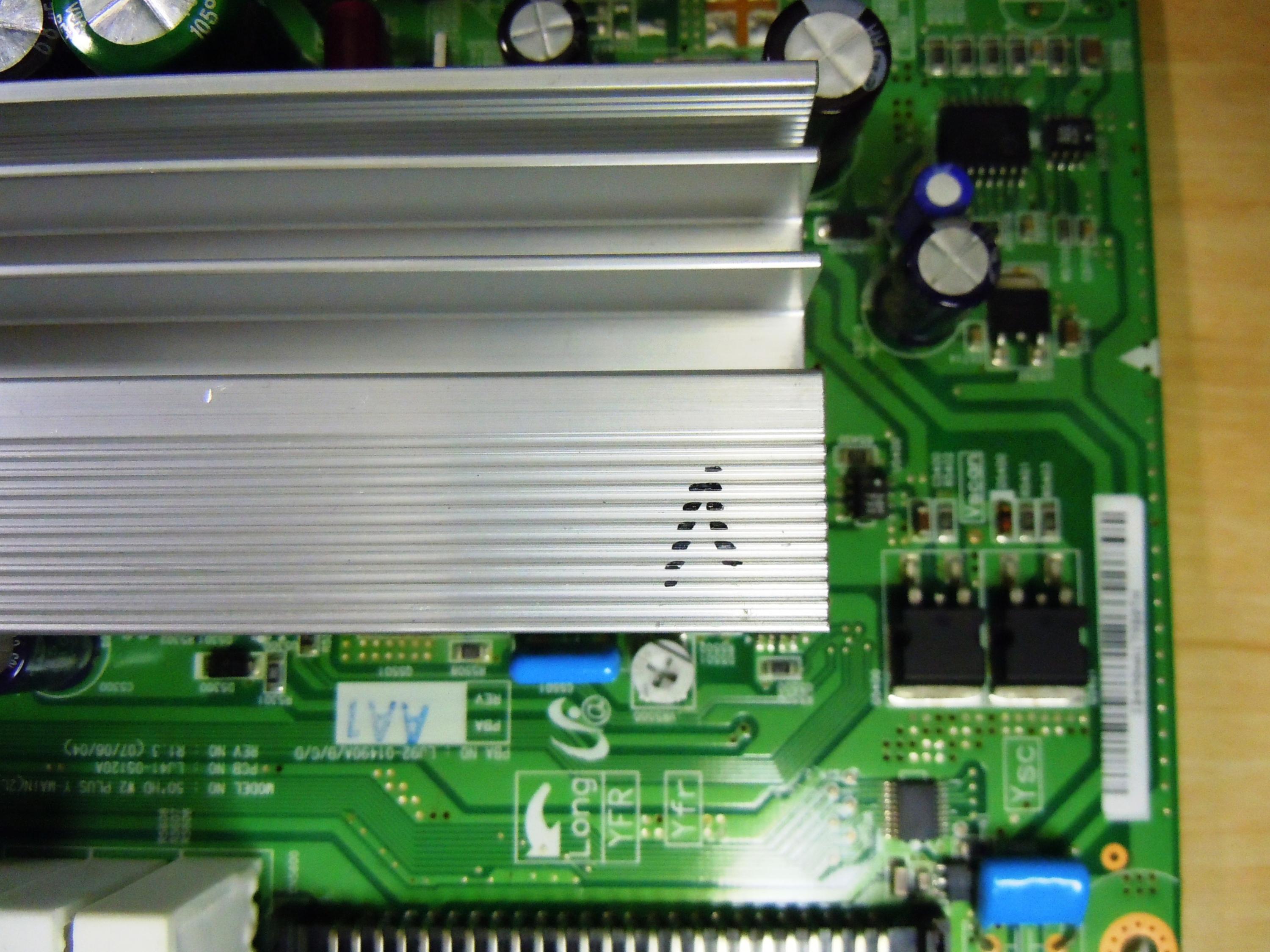

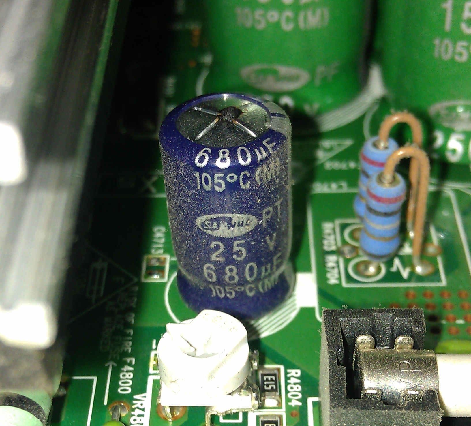

            I have a PS50Q91HD with exactly the same symptoms. I did have a bulging cap on the X-main board. I have replaced it but no improvement yet.
            On point CN810 and CN809 on pin 1 (Vg) I am getting 14v. Is this correct? I cant find anywhere to say what the voltage should be.

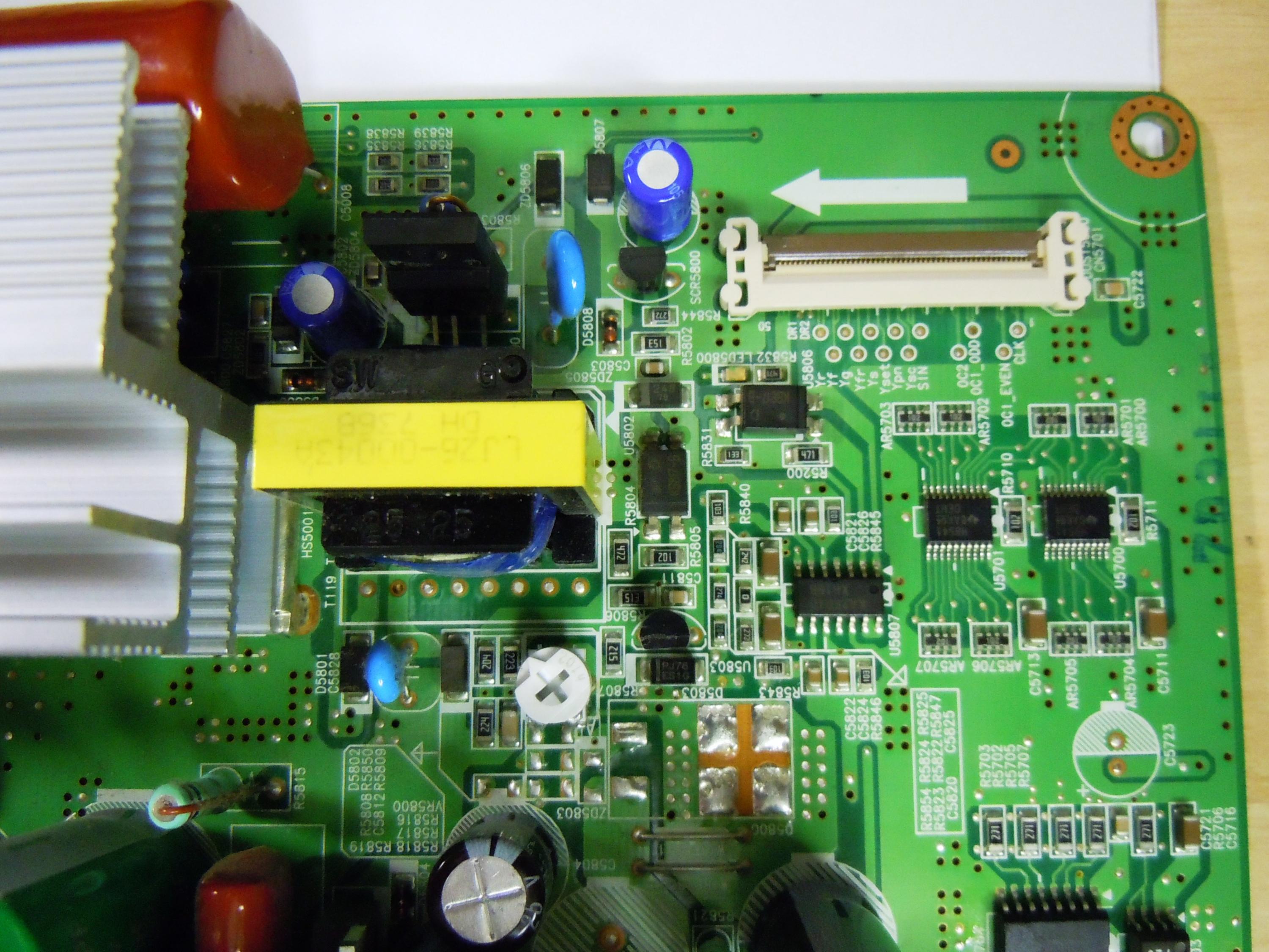

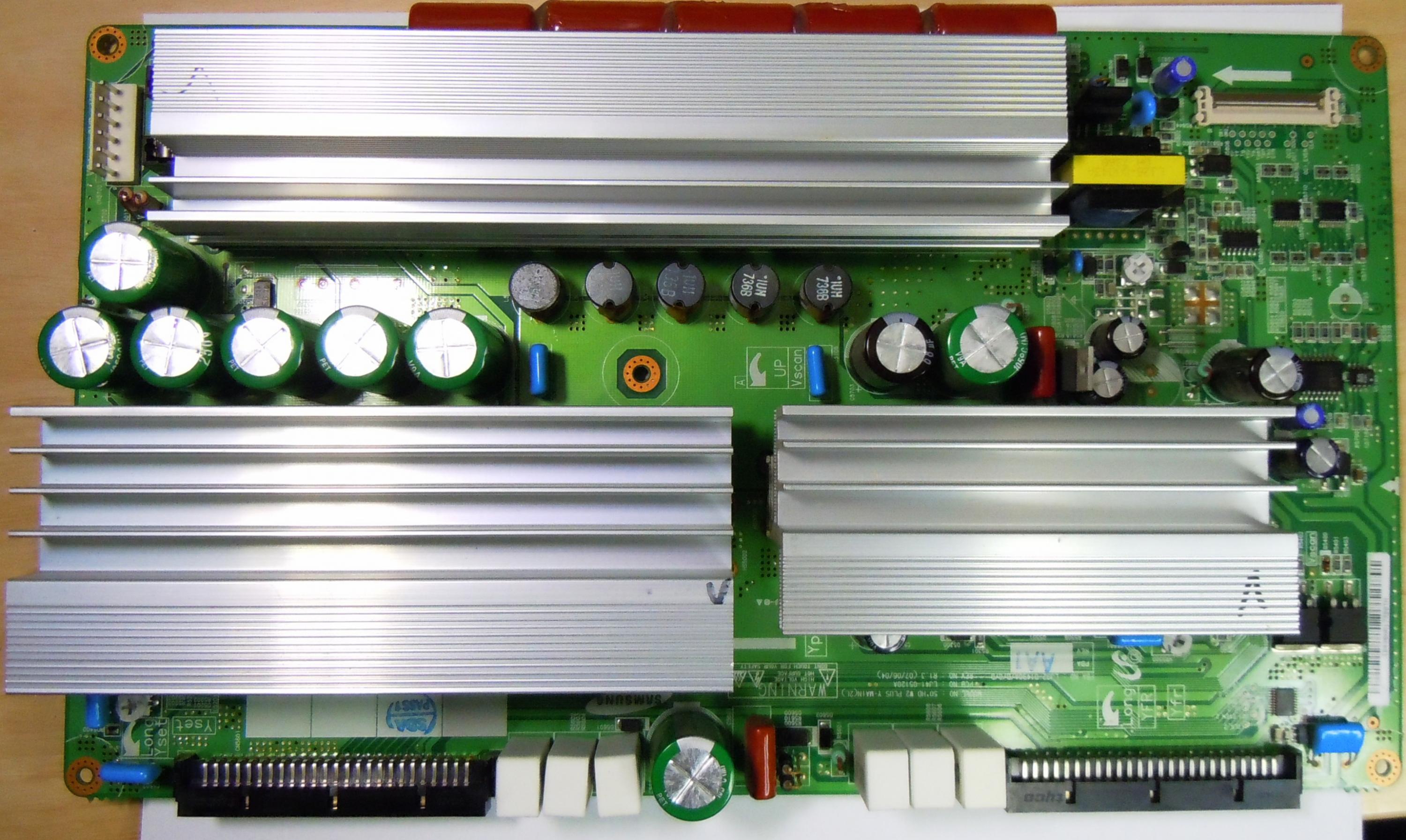

              I hate faults which don't have an ending so i'm tacking onto this one because all of the above applies to my PS50C91HD as well.
              My symptoms are as follows.
              1. Plug-in standby power available, front indication normal.
              2. turn on either front button or remote, blinking front light then locks on solid.
              3. From rear of TV (internal) power on LEDS illuminated on X-main, Y-main, CTRL Logic Board and Otic audio out on Main Board glows red.
              4. voltages normal.
              5. Nil display , but sound and controls normally.
              6. No obvious signs of any blown chips,fets or capacitors.
              7. Watching the activity LEDs as set is powered on I noticed there was an activity LED as well as the power on LED on the CTRL Logic board. This blinks at 1 sec intervals and quit suddenly after 10 secs or so.
              8. With X-main disconnected, same result with the CTRL Logic LED, Connected X-main and Y-main then disconnected, activity LED just kept blinking.
              So at this stage I was suspecting faulty Y-main and have quickly checked the FETS which I found an entire bank short cct (Q5500,5302,5303,5304,5306) 1 x 2SK2837 N Type FET, 4 x 80N30W N Type FET 80A, 300V. Q5303 was dead short and shorted the remaining FETs which tested ok once Q5303 was removed.
              Thats where I'm at, fingers crossed it was just a protection cct shutdown of the screen.
              I could not find a 80N30W TO3P so I'm throwing in an 80N30P in the TO-264 package.
              If anyone has an opinion on this I'd like to hear it. I'm assuming the main difference between the 2 would be thermal dissapation and maybe the TO-264 may not be as durable?
              I'll post up the results once i have the new FET, hopefully it'll arrive tomorrow.

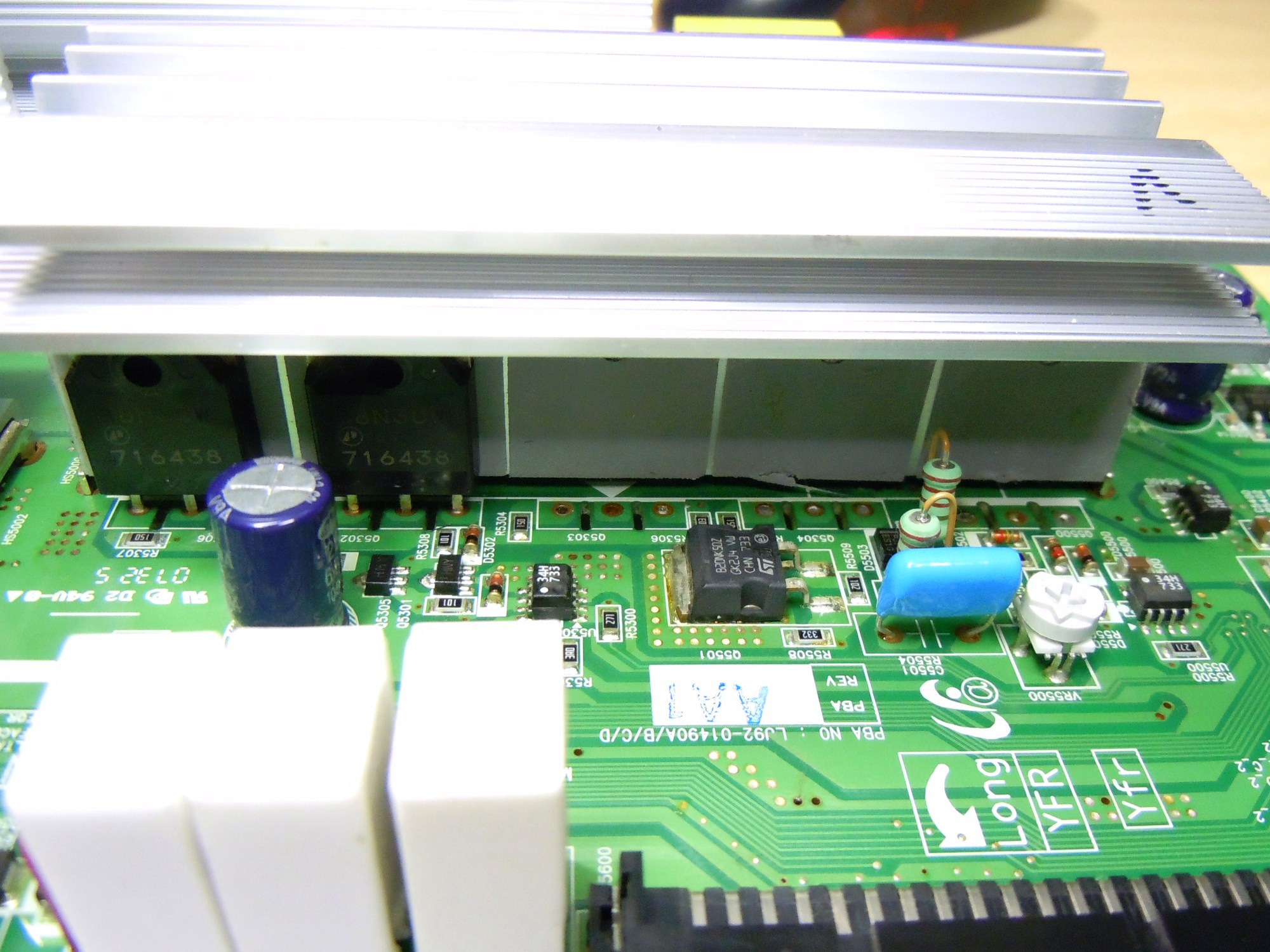

                          Maybe it's time to test all Y and Z/X board components under heatsinks for shorts/open. FET's, diodes, transistors. If Vs and Va is correct and fuses are intact I believe FET's on input stage are not shorted. I would inspect FET's on YSUS output stage that go to Y buffers. Also, check the buffer boards for shorts. This particular scan IC's are as I learned on this forum prone to failures and they like to kill YSUS as well. There is great info of how to test FET's and buffer shorts on this forum and coppeltv. All you need is standard multimeter.
                          Another thing, as I understand, TV goes to standby ok, powers up ok, changes programs/video inputs, sound is ok. You should try a HDMI source (which in addition imply complex audio video processing and D/A conversion) and if it also produces normal sound than I beleive main video board and most circuitry on it is ok.

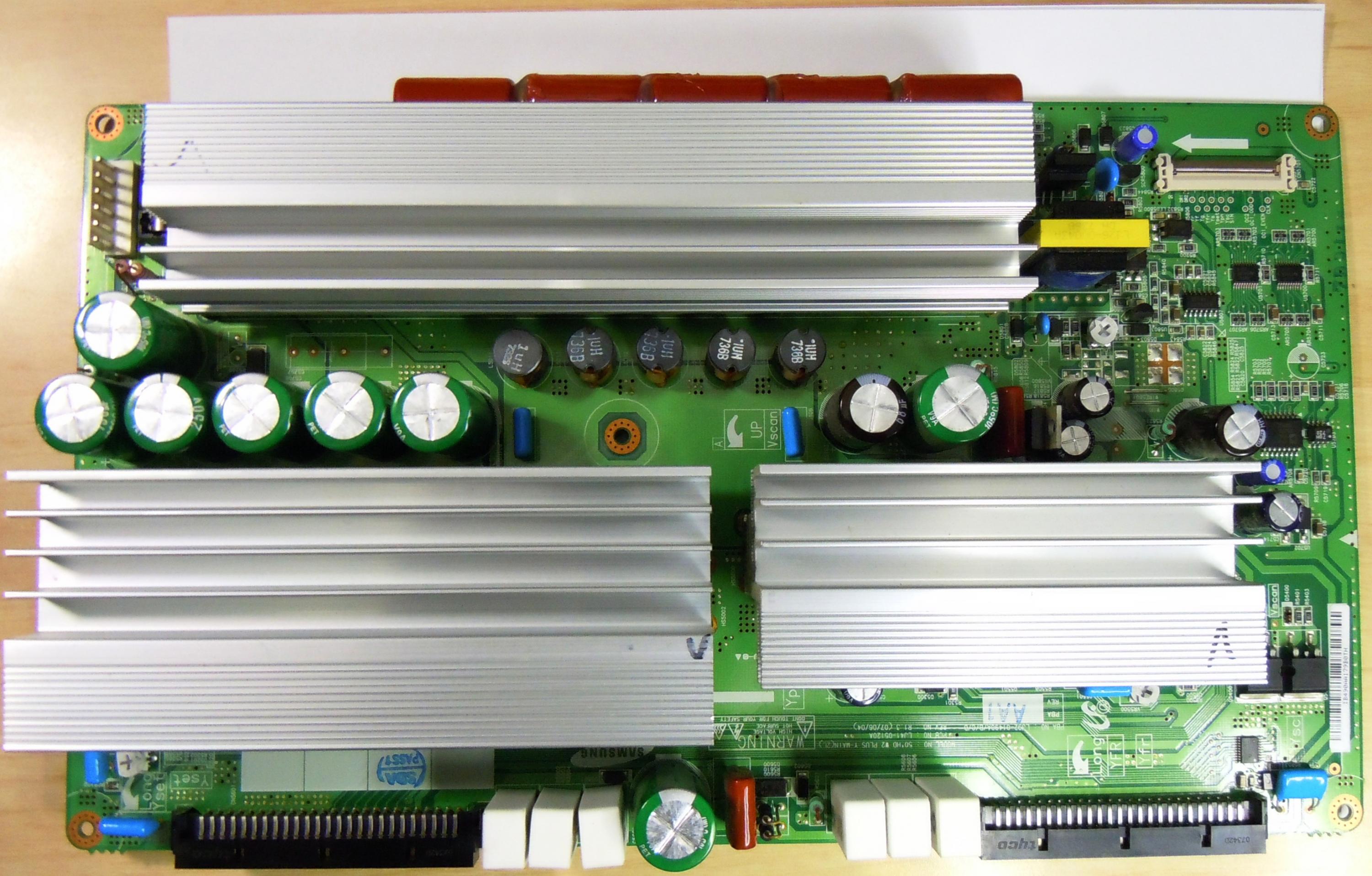

                              Updating where I'm at, I'ved replaced the dead FET.
                              Power on, same result. Obviously at this stage I'm thinking it must have done something to and I did not check the buffers but thinking a bad buffer took out the FET I removed the upper first.
                              Turned on and saw the screen flash. I have a PS50Q7 which is just the generation before so its buffers are physically the same with slight component changes. I believ they are interchangeable so I threw in the top from that.
                              Powered up and have full picture however it's ok but not very good quality and seems very noisy and speckly.
                              I changed the bottom with the other model and no improvement.
                              I've checked the panel voltages and set them to spec, no great change either.
                              So now I'm in need of an experience plasma person to help me out on what direction to take because the boards are just to expensive to keep guessing.
                              I'm thinking I should get some buffers but I don't expect that alone to fix any thing.
                              Do i still have y-main issues with other components or should I be looking at the X-main?
                              The PS50Q7 is suppose to have intermittent black screen and intermittent half black screen issues but I have not it on long enough for it to fail.
                              Currently it has a perfect picture which in comparison to the 50C91 I say exceptional.
