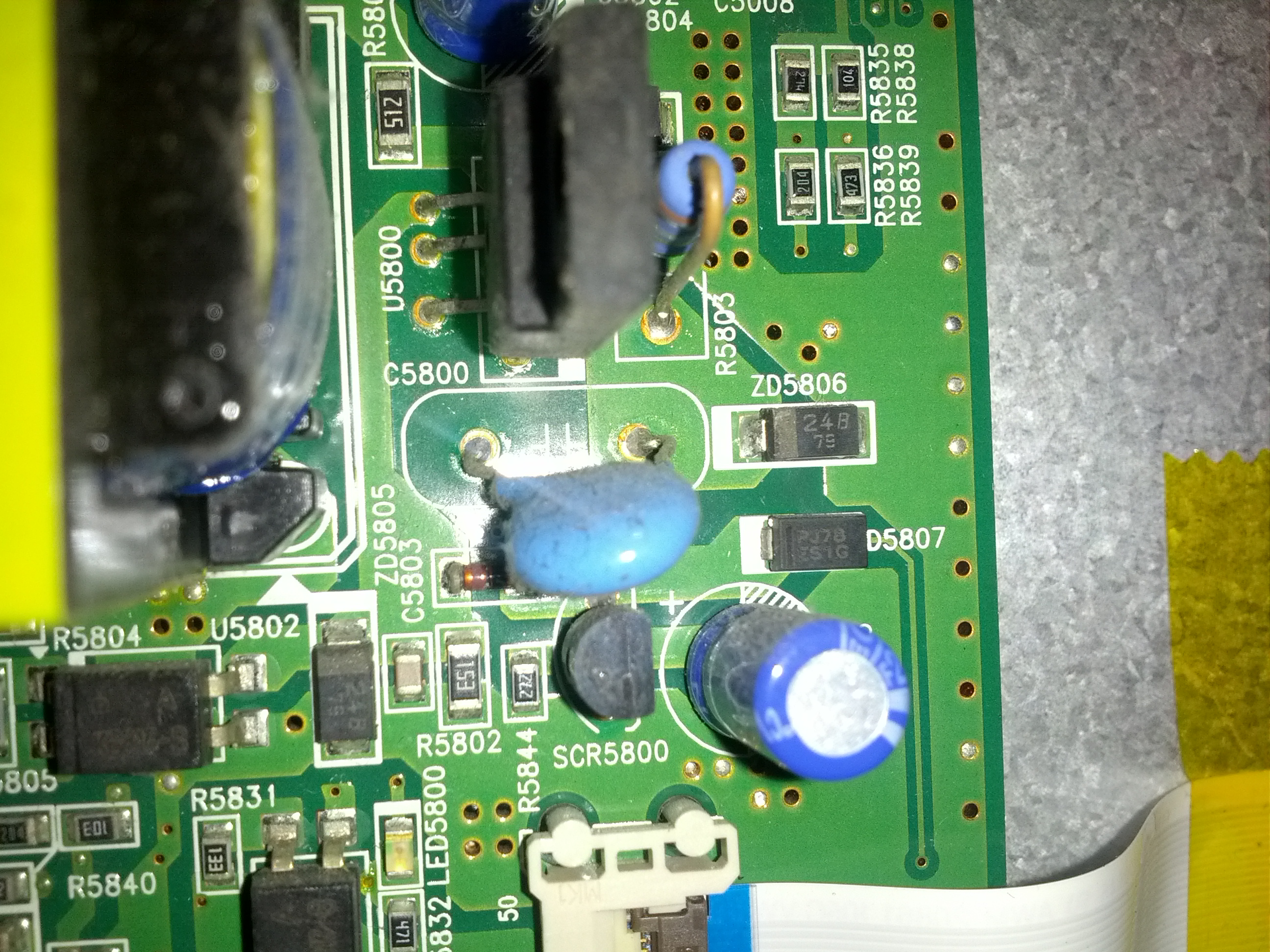

                      Re: Samsung PS50C91HD - No picture, not sure which board is faulty
                      I found this diode which tests as short (ZD5806) other ZDxxxx diodes were fine. I assume ZD is zener diode?
                      What do I replace it with? I've googled the 24b79 that is on the diode = no luck on determining its value.

                        Zeners can be tricky in cct, in the picture it looks like it sits across R5803 which if it is a low value resistor could give you a false indication . I'm thinking it could be 24V zener.

                            Hey I have a PS50C91HDX with similar symptoms.
                            So far I have identified a blown upper Y-buffer and afew shorted zeners on the Y-Main.
                            I see you had trouble identifying the 24B-79 zener.
                            I eventually tracked it down to a Rohm PTZTE2524B
                            Did you have any luck getting yours going?
