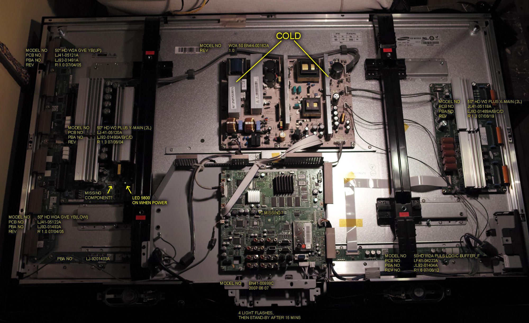

    I picked up a 50" Samsung Plasma display panel. I found it at my local recycling drop off, where I have found and successfully replaced caps on a Wharfedale LCD TV. I have no experience with plasma.
    The unit powers on into stand-by (I here a few clicking sounds like relays, but no picture. (haven't tested sound). It then resumes stand-by after 15mins.
    I would like to replace individual components, but not sure which components/boards to focus on. I understand MOSFETS and CAPS on either Y-sustain, buffer or X-board are commonly faulty. But piecing this information from many fragmented posts in different threads can be time consuming and confusing.
    Since I found this TV had already been opened, I'm wondering whether some strange soldering points indicate a previous repair attempt? some components look as if they're missing, or perhaps on the other side. Also the revision date of the x-board seems inconsisten with the other boards. Two of the heat sinks on the Power supply board are cold when operating.
    Perhaps, this is irrelevent since I would like to get started on testing components. I would appreciate any help with procedures.
    I've attached a photo (dimly lit, but with most boards labelled.) I can supply a better photo tomorrow if necessary.
    Thank you!
    Here are the specifications:
    PS50C91HD
    YB(UP)
    MODEL NO 50" HD W2A GVE YB(UP)
    PCB NO. LJ41-05121A
    PBA NO. LJ92-01491A
    REV R 1.0 07/04/05
    YB(LOW)
    MODEL NO 50" HD W2A GVE YB(LOW)
    REV R 1.0 07/04/05
    PCB NO. LJ41-05122A
    PBA NO. LJ92-01492A
    Y-MAIN (2L)
    MODEL NO 50" HD W2 PLUS Y-MAIN (2L)
    PCB NO. LJ-41-05120A
    PBA NO. LJ92-01490A/B/C/D
    REV R 1.3 07/06/04
    POWER SUPPLY BOARD
    MODEL NO W2A 50 BN44-00162A
    REV 1.0
    X-MAIN
    MODEL NO 50" HD W2 PLUS X-MAIN (2L)
    PCB NO. JL41-05118A
    PBA NO. LJ92-01489A/B/C/D
    REV R 1.3 07/06/19
    DRIVER BOARD (?)
    MODEL NO BN41-00888C
    2007 06 07
    BUFFER (F)
    MODEL NO 50HD W2A PULS LOGIC BUFFER_F
    PCB NO. LF41-04222A
    PBA NO. JL92-01404A
    REV NO. R1.6 07/06/12
    BUFFER - UNKNOWN?
    PBA NO. LJ-9201403A

    That photo is fine for now - much more welcome than no photo at all!
    A few checks to perform:
    - Do you have sound with an external source?
    - Turn out all the lights in the room and make it very dark. Does the screen appear to glow very faintly? There might be an image or it might just be a dark level glow. If it does glow, it is likely the Z-sustain/X-main that is at fault. If it doesn't, it's a Y-sustain/Y-main, buffer or panel fault.
    - Do you hear an audible buzzing sound from the X-main and Y-main?
    - Are there any fuses on the X-main and Y-main boards? If so, check these.
    It is normal to sometimes see components like that missing. They are added for some versions and not others. If someone removed those components it would look a lot messier.

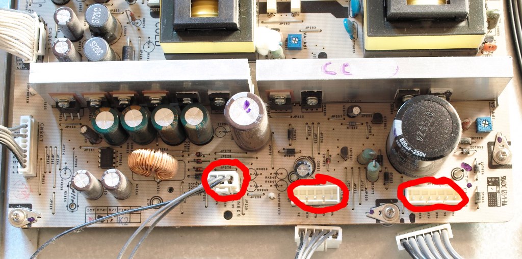

        Also, can you post a picture of the connector coming from the power supply and going to each board? It's going to be the thick 5+ way cable.

            tom66, I have sound working now through the AV in. I've posted a picture of the thick cable connectors.

              Ugh - CapXon on a Samsung. Great for reliability. At least they don't look bulged yet. As you have sound these are unlikely to be the problem as they power the main board which deals with audio.
              I've attached an image. Check the voltage on each of these pins.
              You should get around 200V for Vs and 60V for Va. The exact voltage will depend on what the panel sticker says.
              Careful! This is very high voltage. Don't touch the multimeter probe tips or the power supply while testing it.

                I'm getting:
                203 Vs (205 on panel sticker)
                62 Va (63 on panel sticker)
                Tested all the pins on each connector.
                Although my multimeter is really cheap and nasty.
                What next?

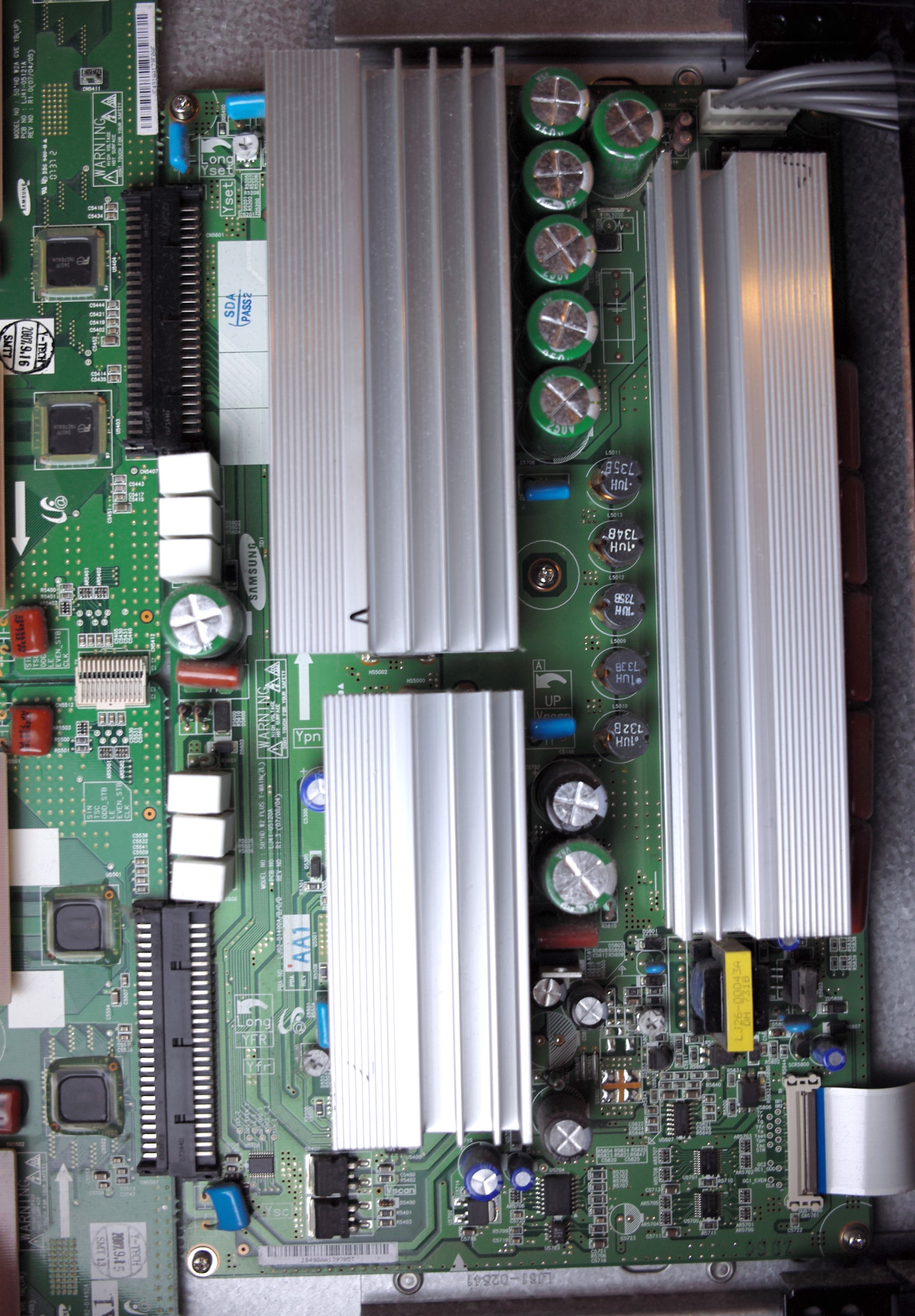

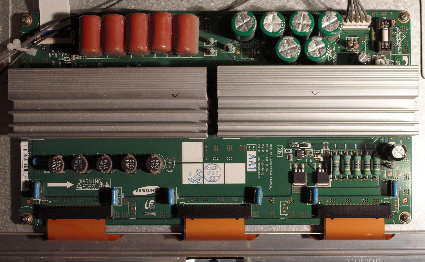

                      Can you post a closer picture of the Y-main and X-main boards? Does this TV have two buffers or just one? It looks like two from here but I can't quite tell. (The buffers go from Y-main to the panel itself.)

                        Attached are pics of the Y-main and X-main.
                        I'm not certain, but I think there are two separate buffers, connected together.

                          Yep theybuffers definitely look connected in some way.
                          Try removing the upper buffer - does a picture appear on the lower half?
                          Then replace the upper buffer and remove the lower buffer - does a picture appear on the upper half?

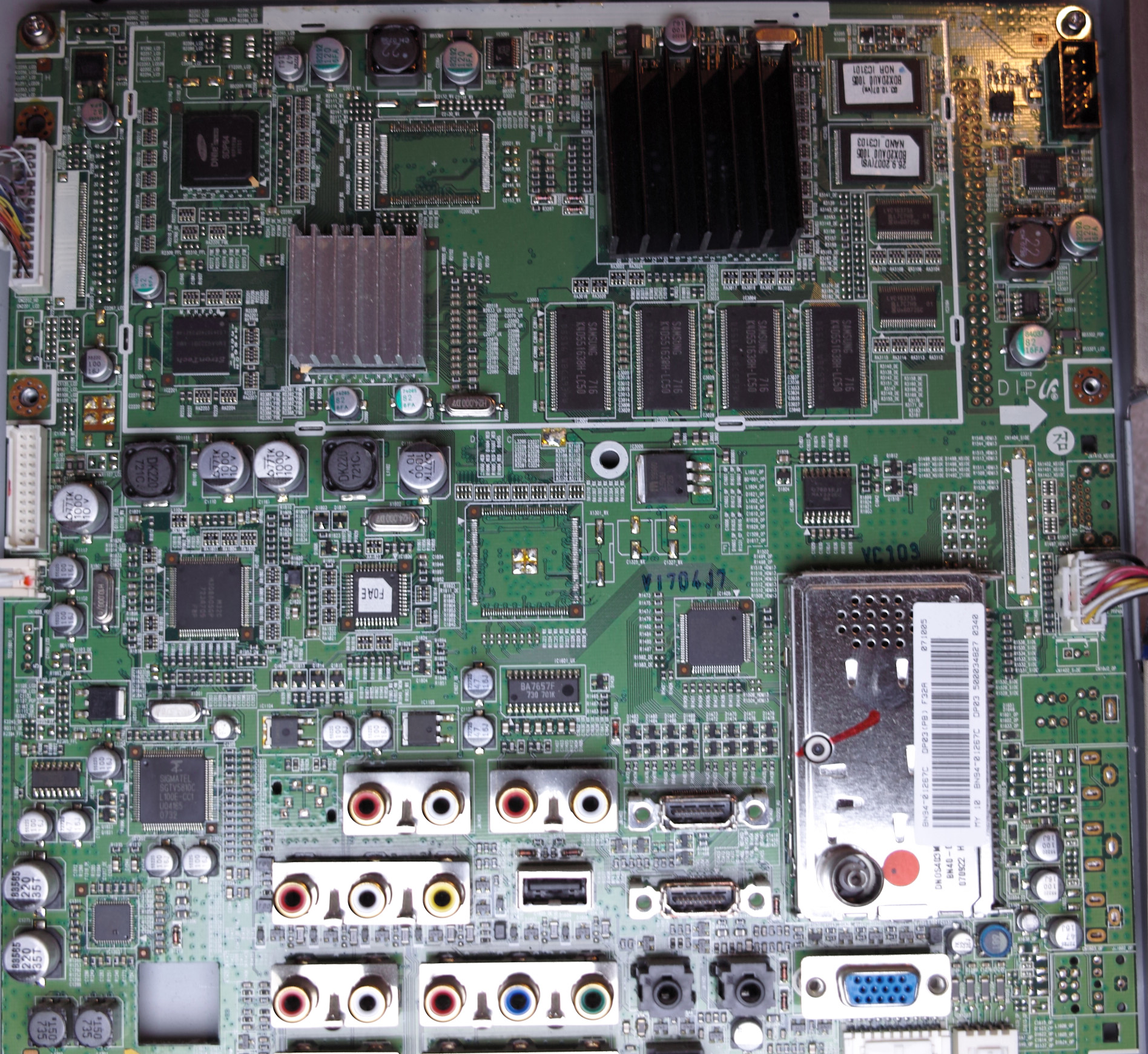

                              Post a picture of the logic board... the fuse is very small.

                                    Ok, here is a pic of the logic board. Hopefuly the panel itself is ok.

                                      Sorry - miscommunication. Under the main logic board there's usually a smaller logic board which connects to the Y- and X-main boards. It also controls the X-buffers. It will usually be physically mounted under that metal box for the main board.

                                        Ah ok. I found that tiny SMD fuse. I just tested it on the board and there is continuity. very low ohms. Do I have to desolder it to check properly?
