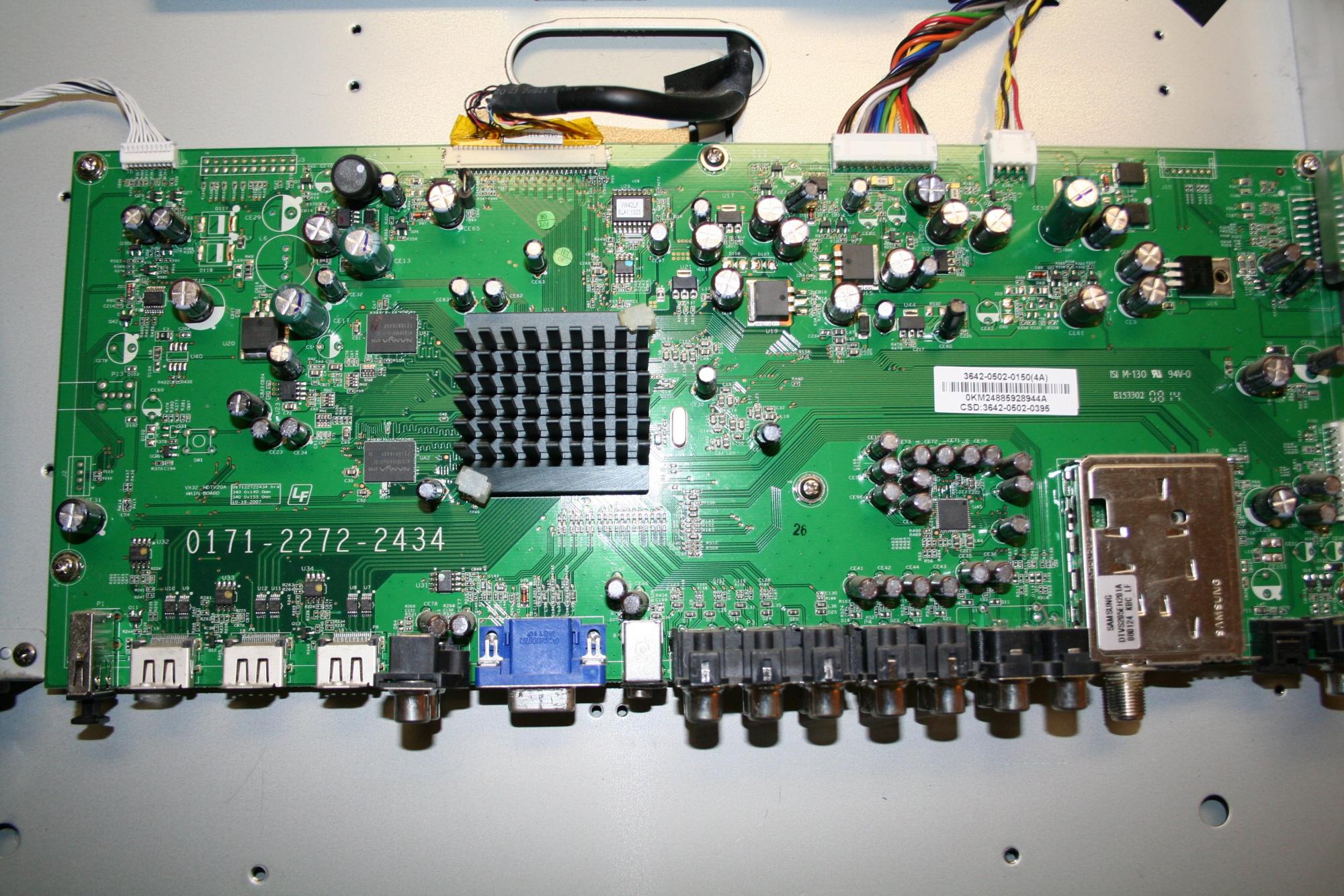

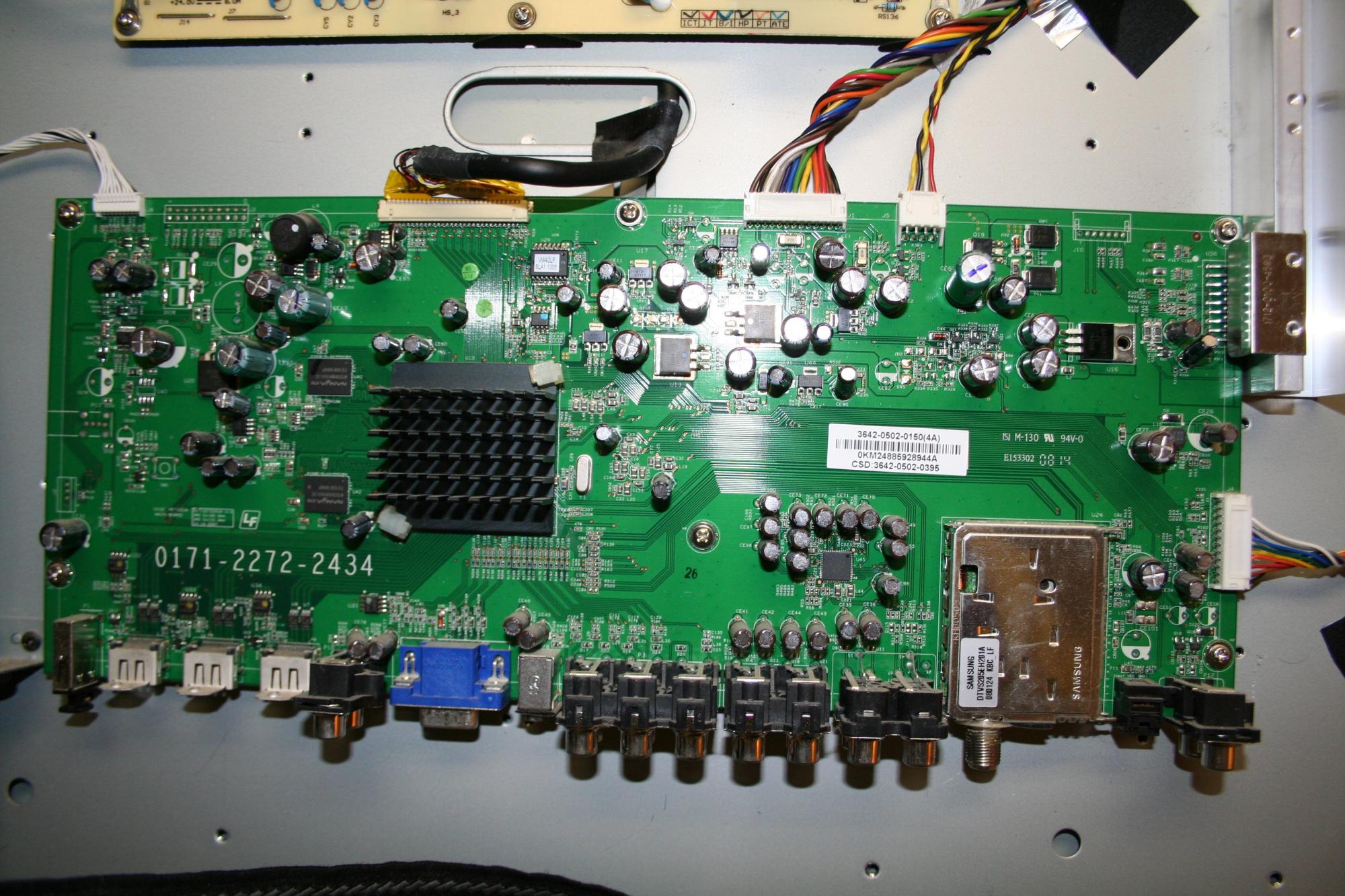

    13) The voltage main board regulator numbers don't match the other threads I've read on this model TV. My G1084 LDOs are V20, V19, and V15. Here are their readings in GR/VO/VI order:
    V20: .569 / 1.814 / 3.277
    V19: 1.270 / 2.527 / 5.14
    V15: 2.06 / 3.30 / 5.13

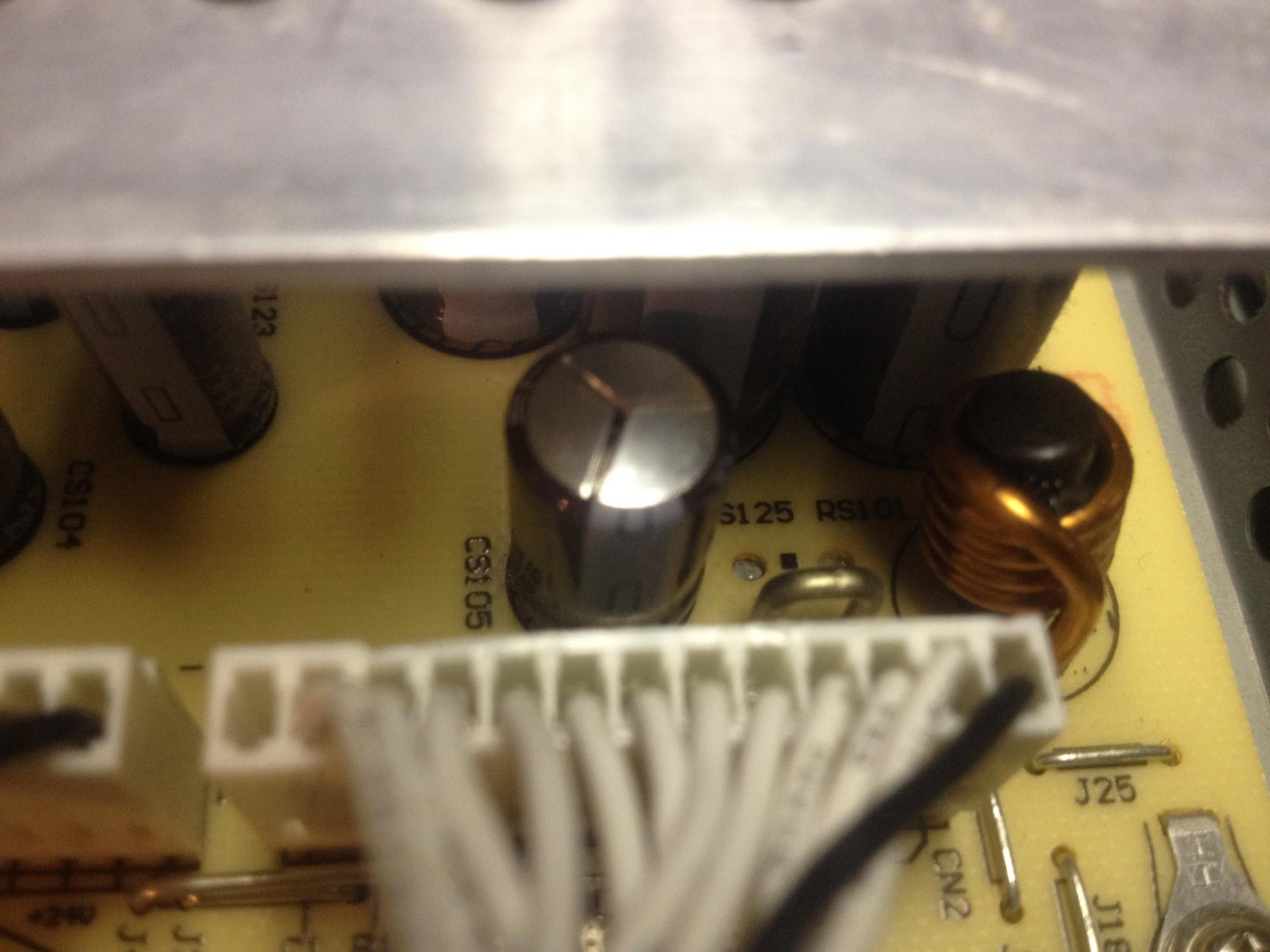

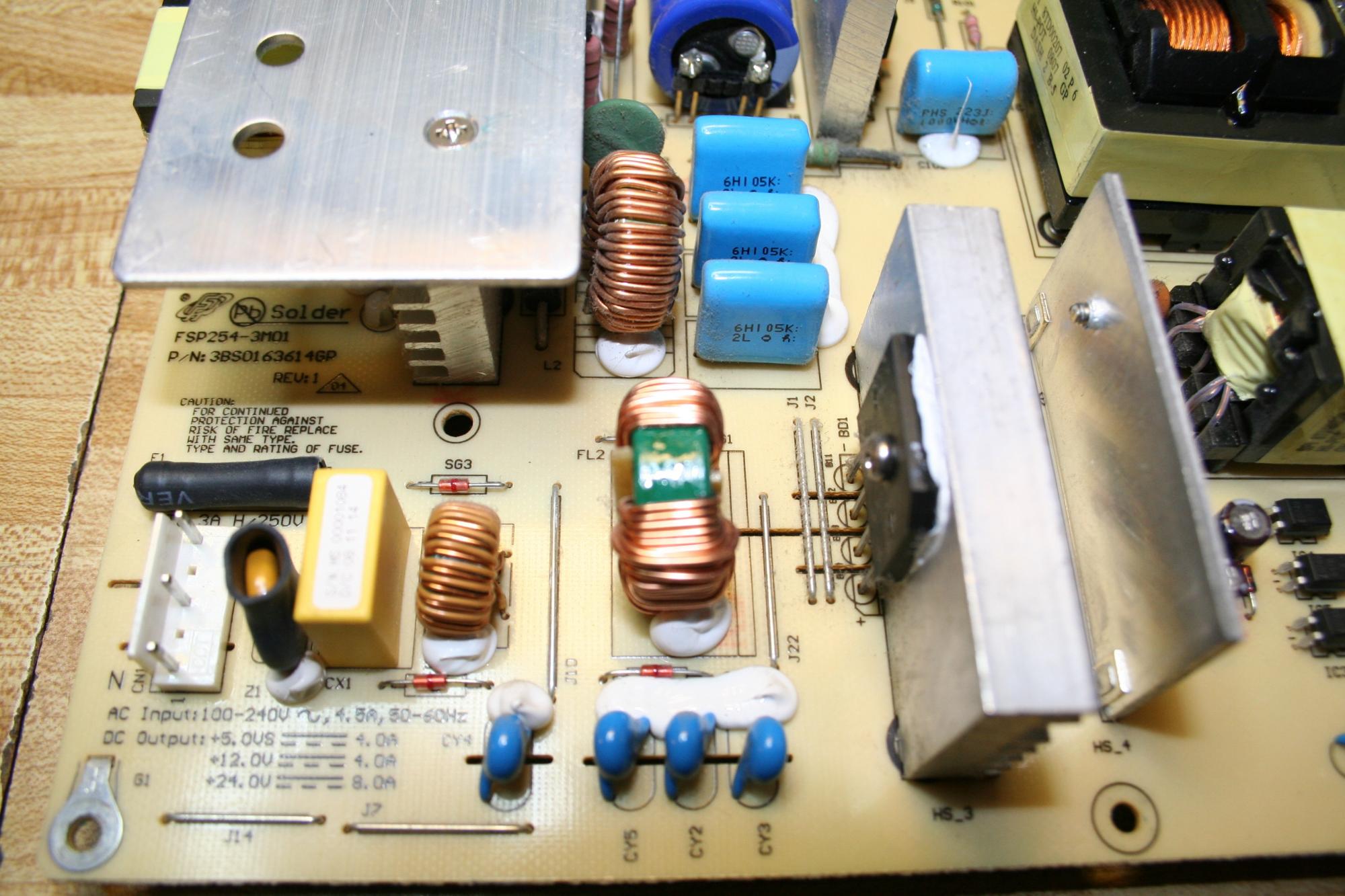

    14) Upon visual inspection, the 330uF, 35v cap on the Power Supply is bulging (see attachment). I took it out and was able to test it on a DMM that only goes to 200uF. It took a charge and went to OL after a few seconds. I ordered a new one and will replace it, but haven't received it.

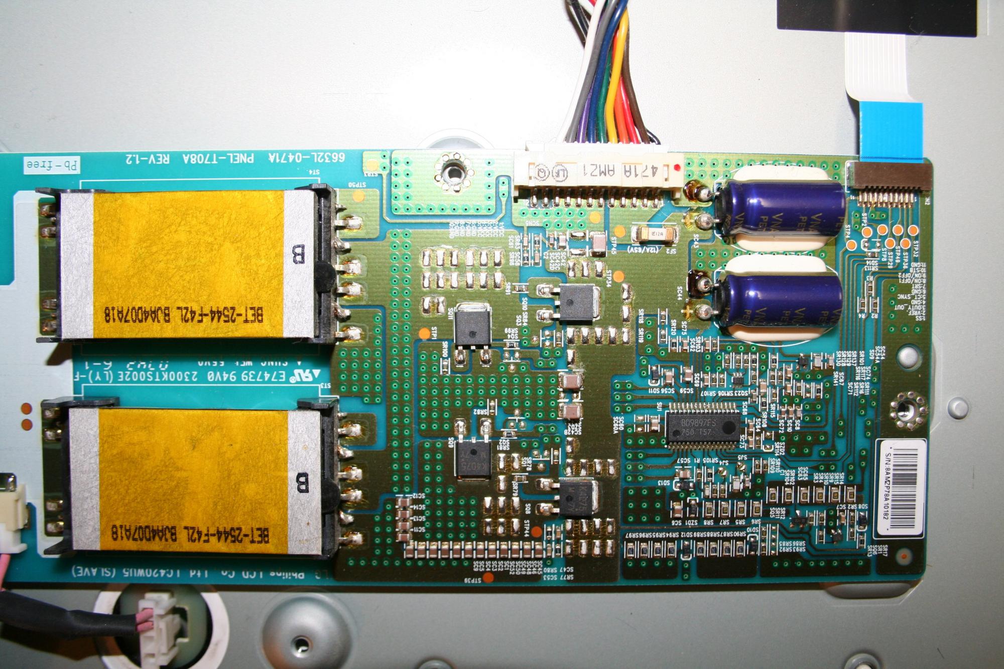

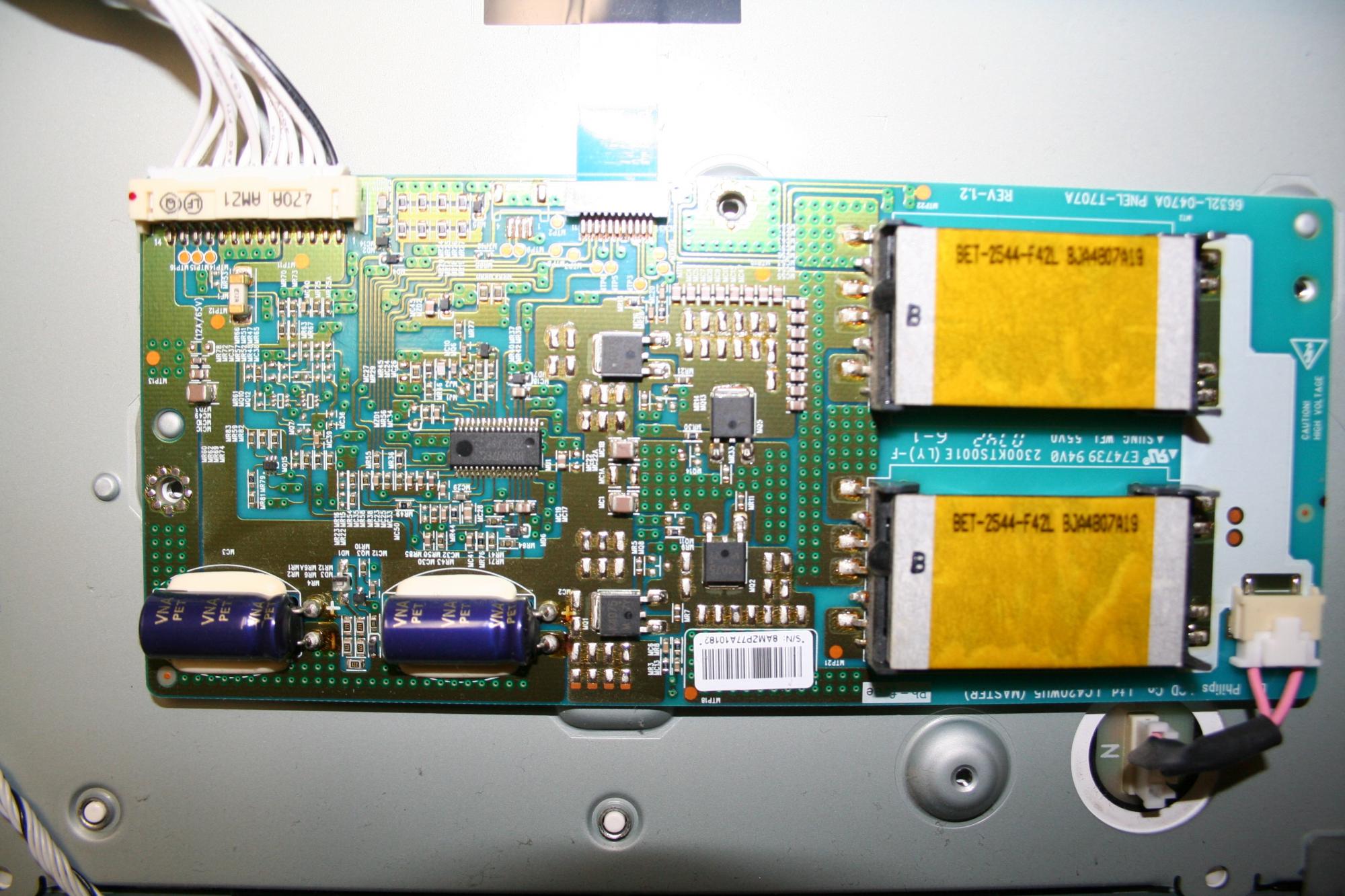

    11) On Master inverter fuse F1 I get .67v when switch is on.
    12) On Slave inverter fuse SF2 I get .65v when switch is on.
    Your inverters require way more than less than 1 volt.
    Those output voltages look okay, but it depends on the part number. For example, an AL1117-33, where the suffix denotes the output voltage, will output 3.3V DC +/- 1%.
    I hoped you ordered a low ESR cap. Something like Panasonic FR or FM series.

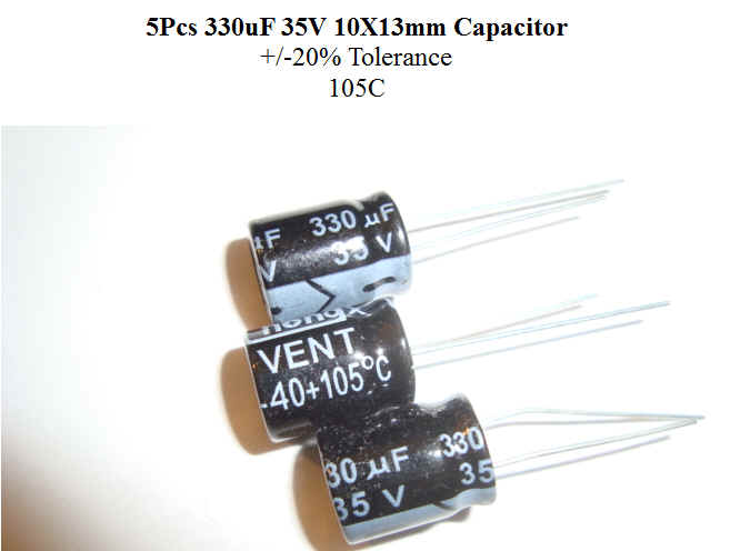

      I'm honestly not sure what brand of caps I bought. I matched the uF, voltage, and temps. I picked them up on ebay for 5 bucks. Will these suffice?

        Will these suffice?
        For test purposes only, maybe. Caps on ebay are generally poor quality or fakes.
        For long term reliability, this is the proper cap.
        http://search.digikey.com/us/en/prod...2413-ND/613774

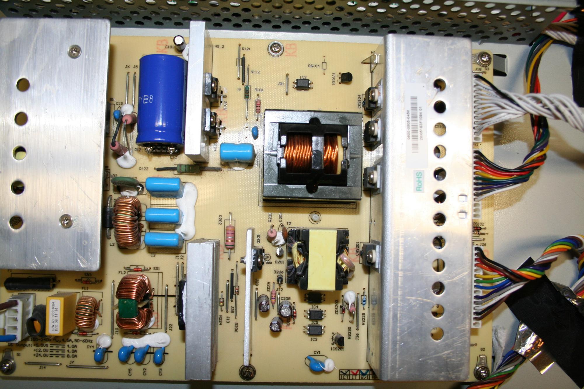

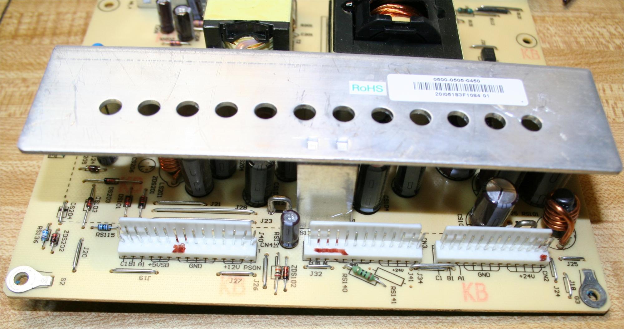

          Can we get good closed up pictures of the power supply board connectors so we can see the labels on them? Also goo closed up pictures of the borrom side.
          Is it FSP brand, model number as shown on the board?
            Re: Another VW42LHDTV10A no picture, no sound
            ChangX - I see them on some Vestel sets but they are generally pretty poor caps. They are just the cheapest caps available as they don't make their own caps, they just stick their name on whoever bids the lowest. Inconsistent quality is probably worse than poor quality.
            Now that cap isn't just failed it's really badly bulged, which is rare. And it looks like a Chemicon which is generally a good brand. It could have been a fault with the power supply - like a rail voltage going too high. That's quite rare though. But it looks like it's under a heatsink, so that could have been the cause.
              It would also help if you filled in your profile with at least the country information so we can suggest suitable suppliers rather than ebay.

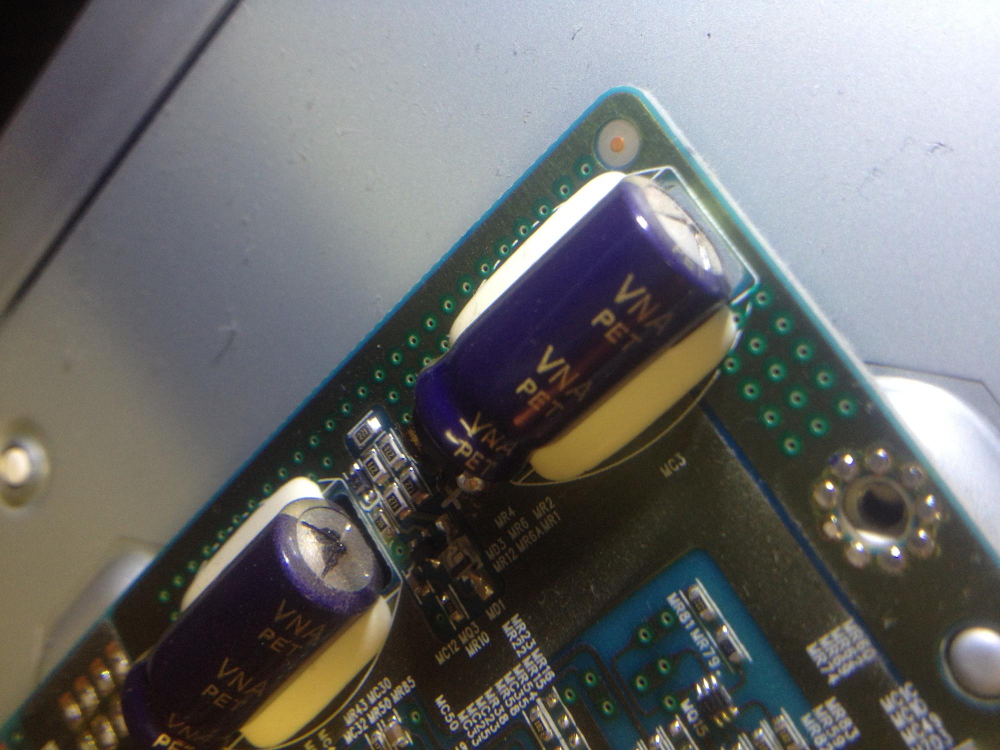

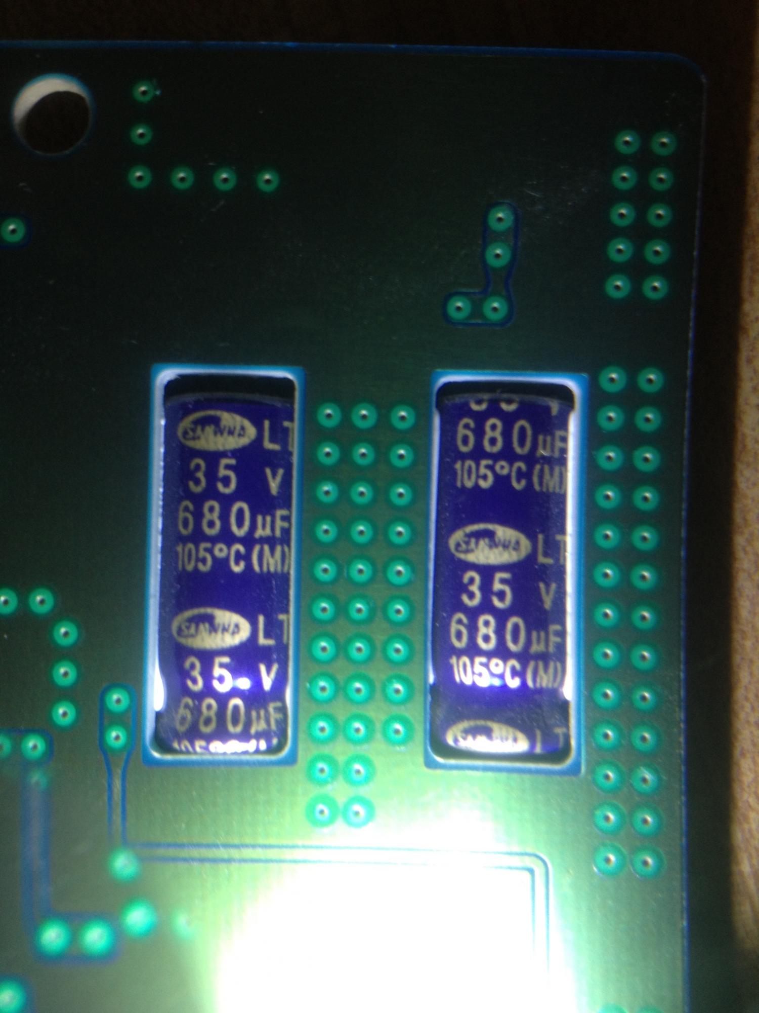

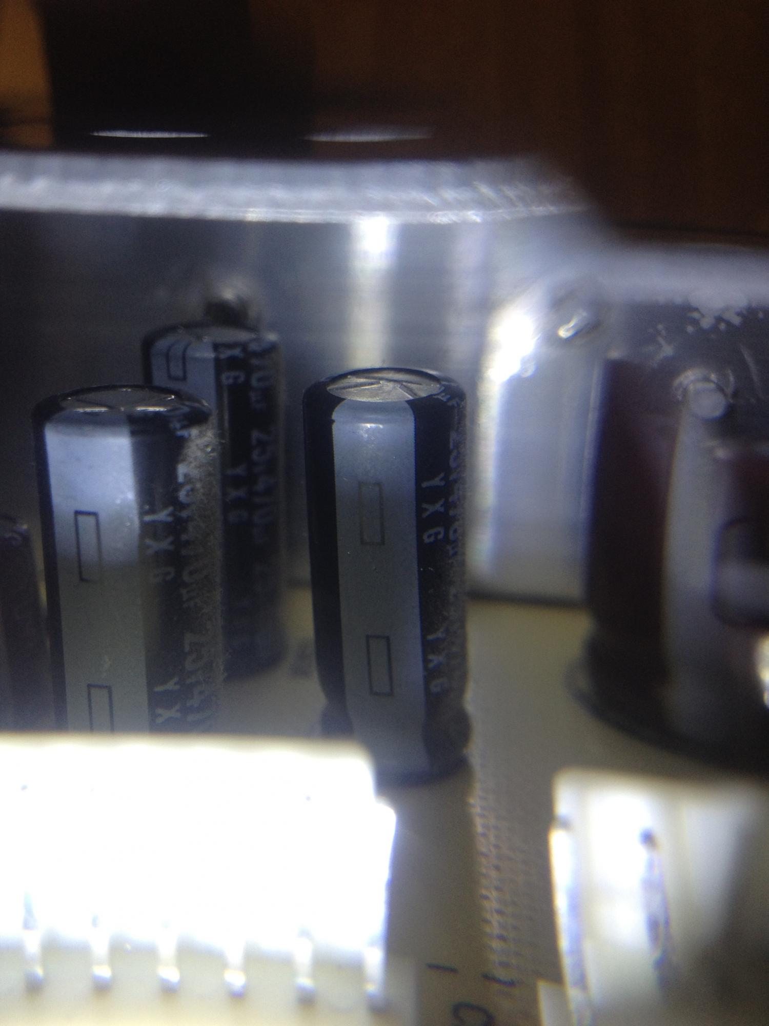

                      Well, it looks like my project just got a bit more complicated. Upon further review of the inverter boards, it looks like all four caps are bulging and two have even leaked? Is it possible that the bulging cap on the power supply caused this ... or vice-versa?
                      Also, there are no markings on these caps, however I read some blogs that say they are 470uF 35v? Are the markings underneath and are they replaceable? A quick search on Ebay is showing refurb inverter boards for $60 each! Not the direction I was planning on going.
                      Is Digi-key the place to get these caps also? Is it Part# P13130-ND?

                        Its just heat, age and possible poor manufacturing.
                        take them off the board - they will have to come off anyway.
                        It should say what they are on the other side if not come back and we can research it.
                        We dont know at present if the digikey ones are correct - what physical size are the
                        they. Height - Diameter.

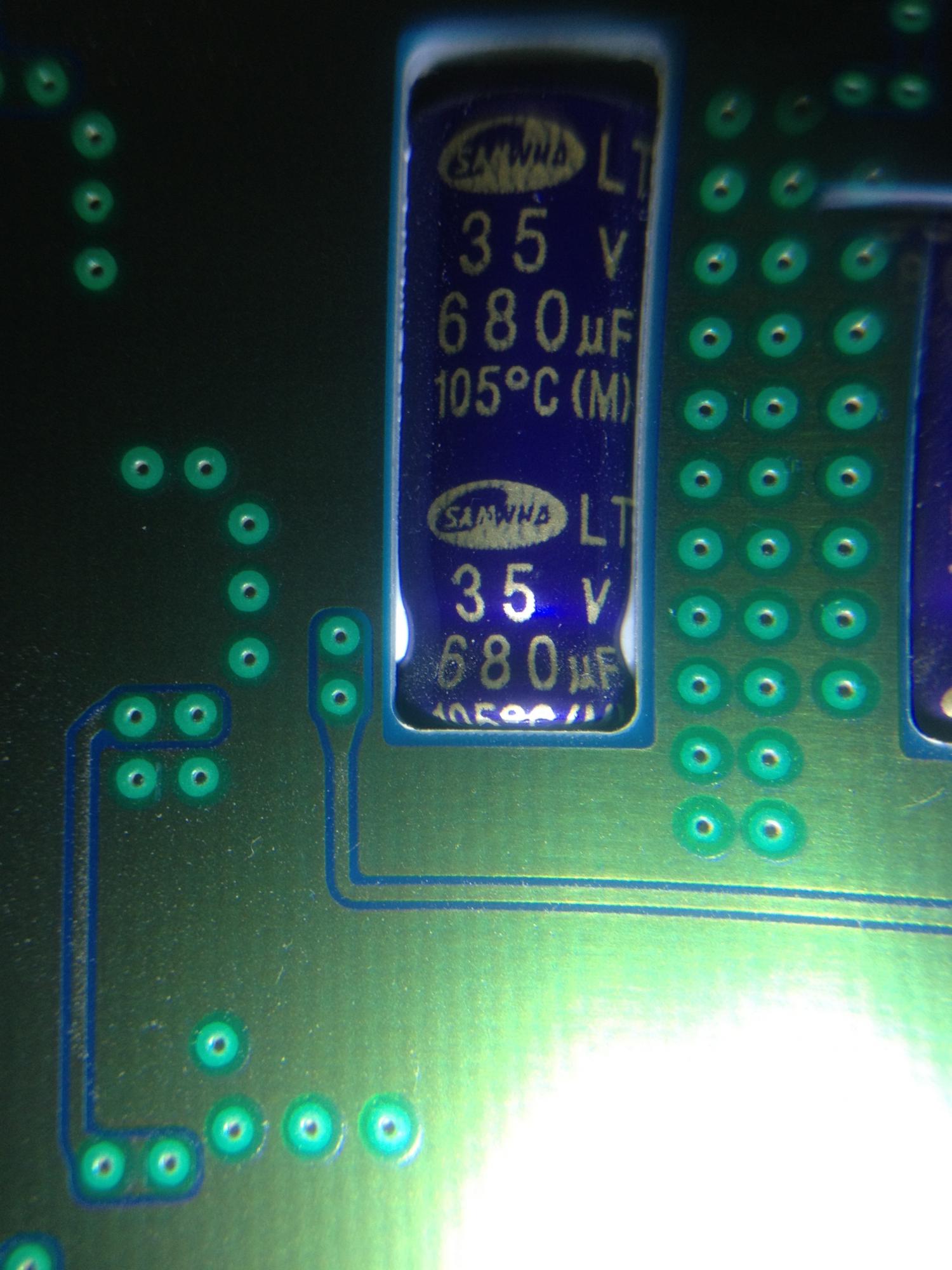

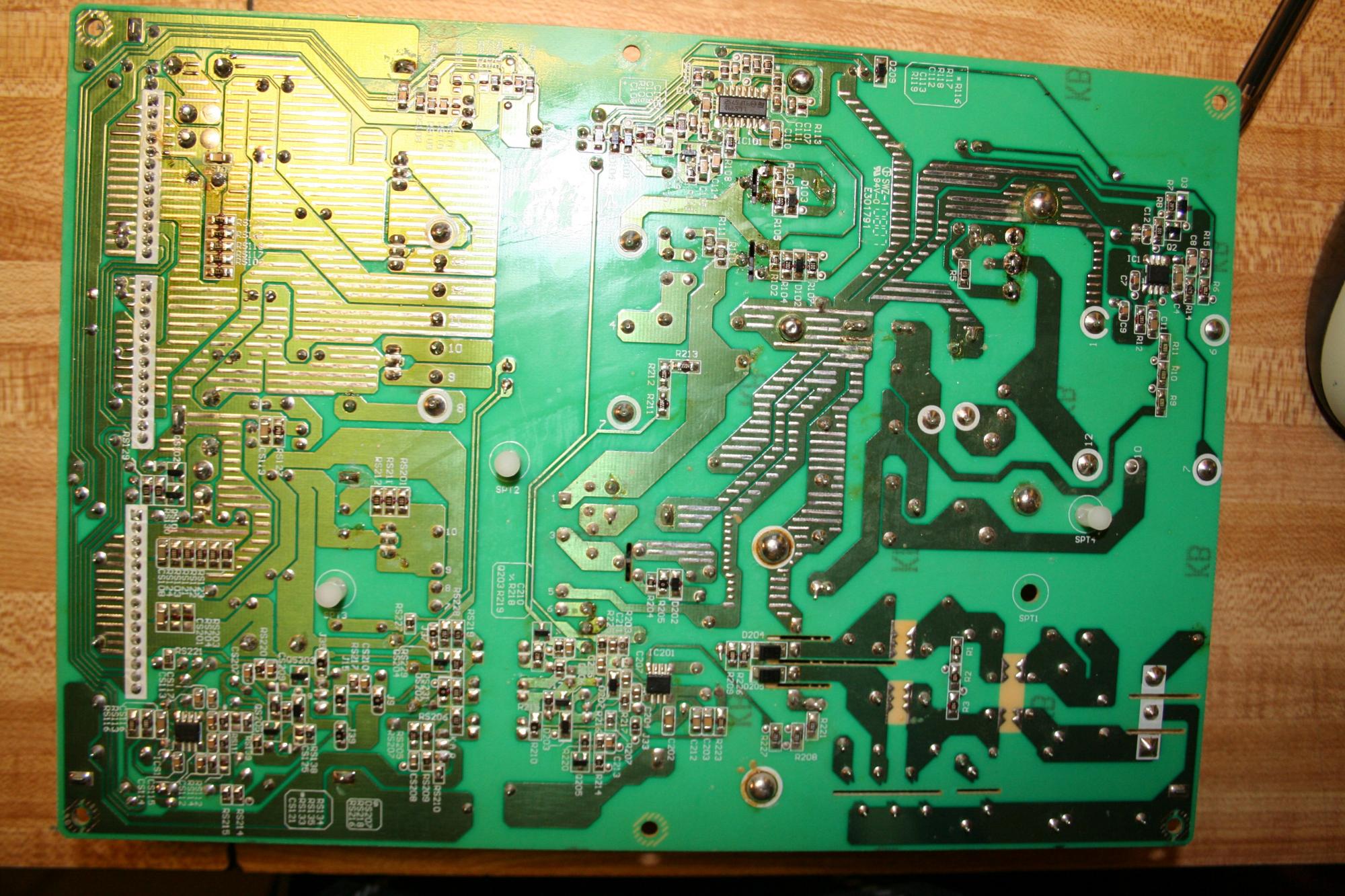

                          OK, I took the board off and can read the detailed information on the back. Looks like a 680uF, not a 470uF like I thought. They seem to be 10mm x 22mm.
                          Also, i might be getting a little paranoid, but I really started inspecting every cap for any type of bulge. I think I found one on the power supply with a very slight bulge, so just to be safe, I'm going to replace that one also. That one says Rubycon, 25v 470uF Y X G and looks like it measures 20mm x 7mm?

                                Ok, so based on your advice, I'd like to recap the inverter boards and the power supply. Looks like I've already ordered the cheapies and don't want to use them. Using the readings on the caps I want to replace, I used your advice and searched digi-key for panasonic FM series caps. Here is my list:
                                Qty Part Number Description
                                1 P12413-ND CAP ALUM 330UF 35V 20% RADIAL
                                4 P12417-ND CAP ALUM 680UF 35V 20% RADIAL
                                3 P12405-ND CAP ALUM 1000UF 35V 20% RADIAL
                                3 P12389-ND CAP ALUM 470UF 25V 20% RADIAL
                                3 P12366-ND CAP ALUM 1000UF 16V 20% RADIAL
                                1 P12386-ND CAP ALUM 330UF 25V 20% RADIAL
                                As you can see, I don't know too much about ordering caps, so can someone verify that I'm on the right track here? I tried to measure each cap size and use the closest mm size available ... do they have to be exact?
                                Thanks again for all of your help!

                                  those inverter boards look very familiar, recently I have replaced the chip and the four fet transistors on the slave board. Measure the fets across and see if do you read ~8.5k, if less then most likely the chip or maybe even the fet it's gone. On Ebay they sell this kit.

                                    The two you have advised detail of are ok
                                    BUT size wise unless they are an exact match only you can tell.
                                    If it is under a heatsink 3 mm difference in height might mean it is touching so no good. Diameter wise if you have a lot bunched together and each one is 2 mm fatter it will be struggle to get them in.
                                    Having made your choice of caps go back and see where they are and check
                                    if the space/height is an issue.
                                    The Digikey part numbers are correct for the voltages & uf stated alongside
                                    so if that description is from your list and not from the digikey site and the size is ok as explained above you are good to go.

                                      I noticed on the inverter boards, the solder is on the top and there are no holes to put the leads through. Any tips or techniques on how to solder the new caps on the board?
                                      Hopefully, there is nothing wrong with the chip and fets because I think that solder work is out of my league. lol.
