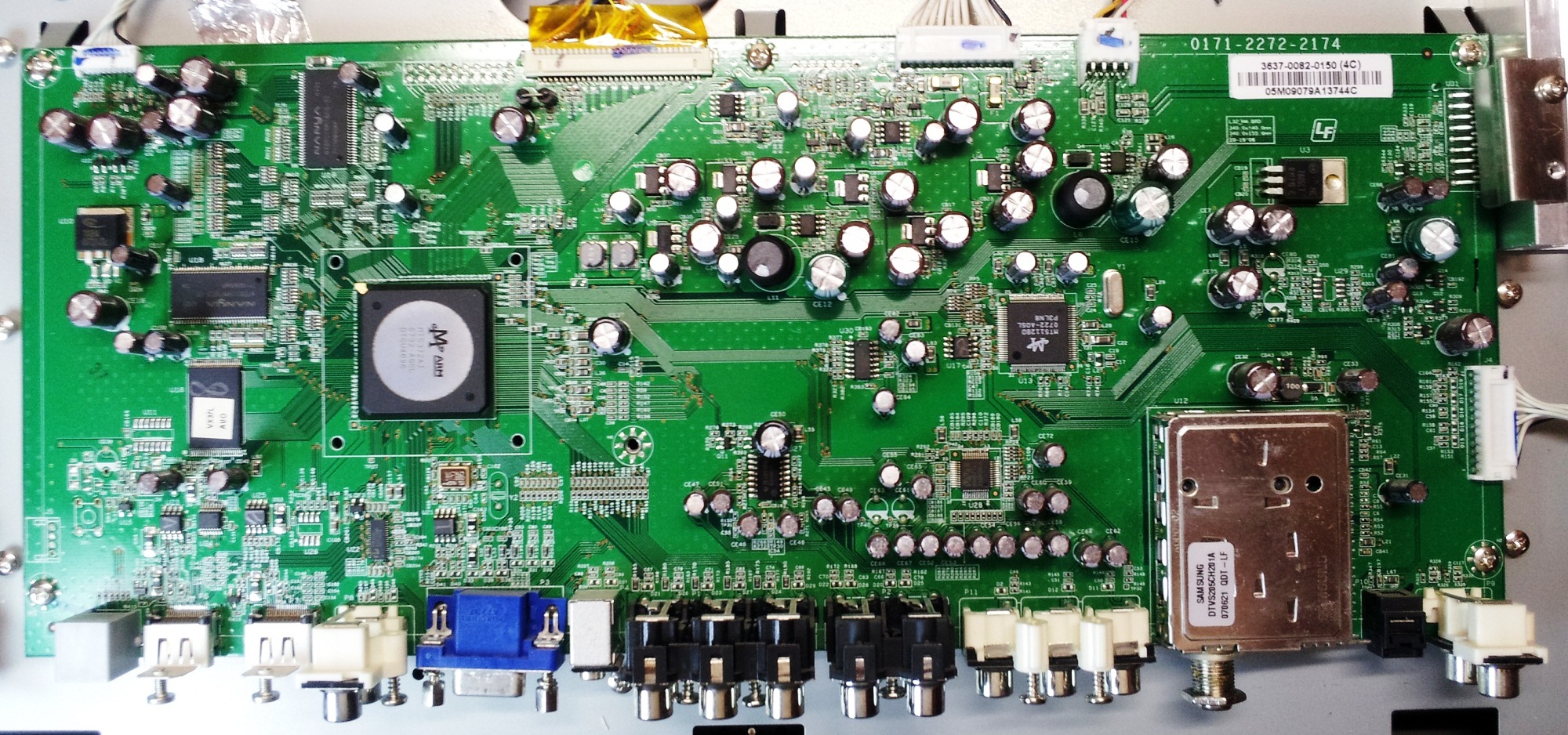

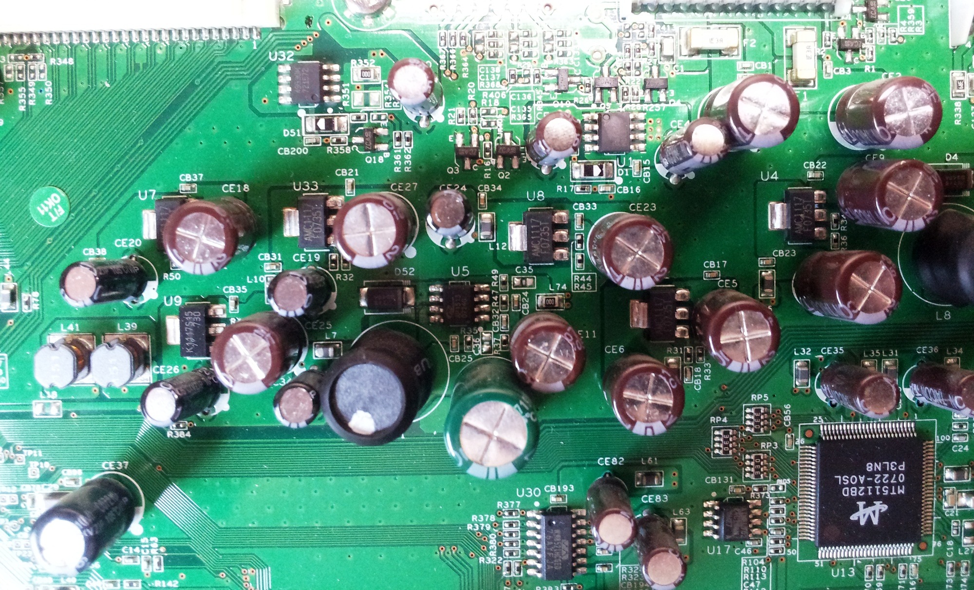

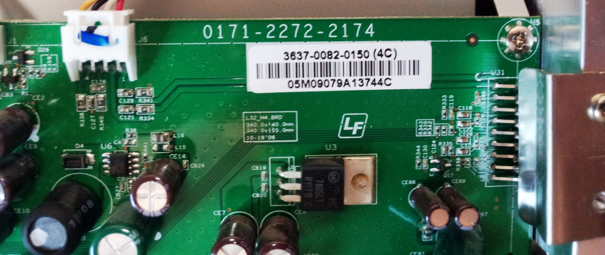

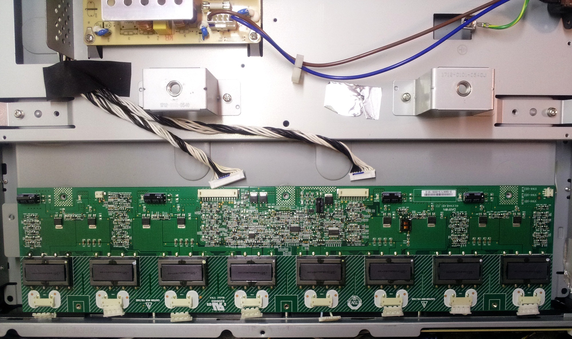

          I'm not feeling good, so I couldn't do any measurements, I have just took a couple of shots with the phone.

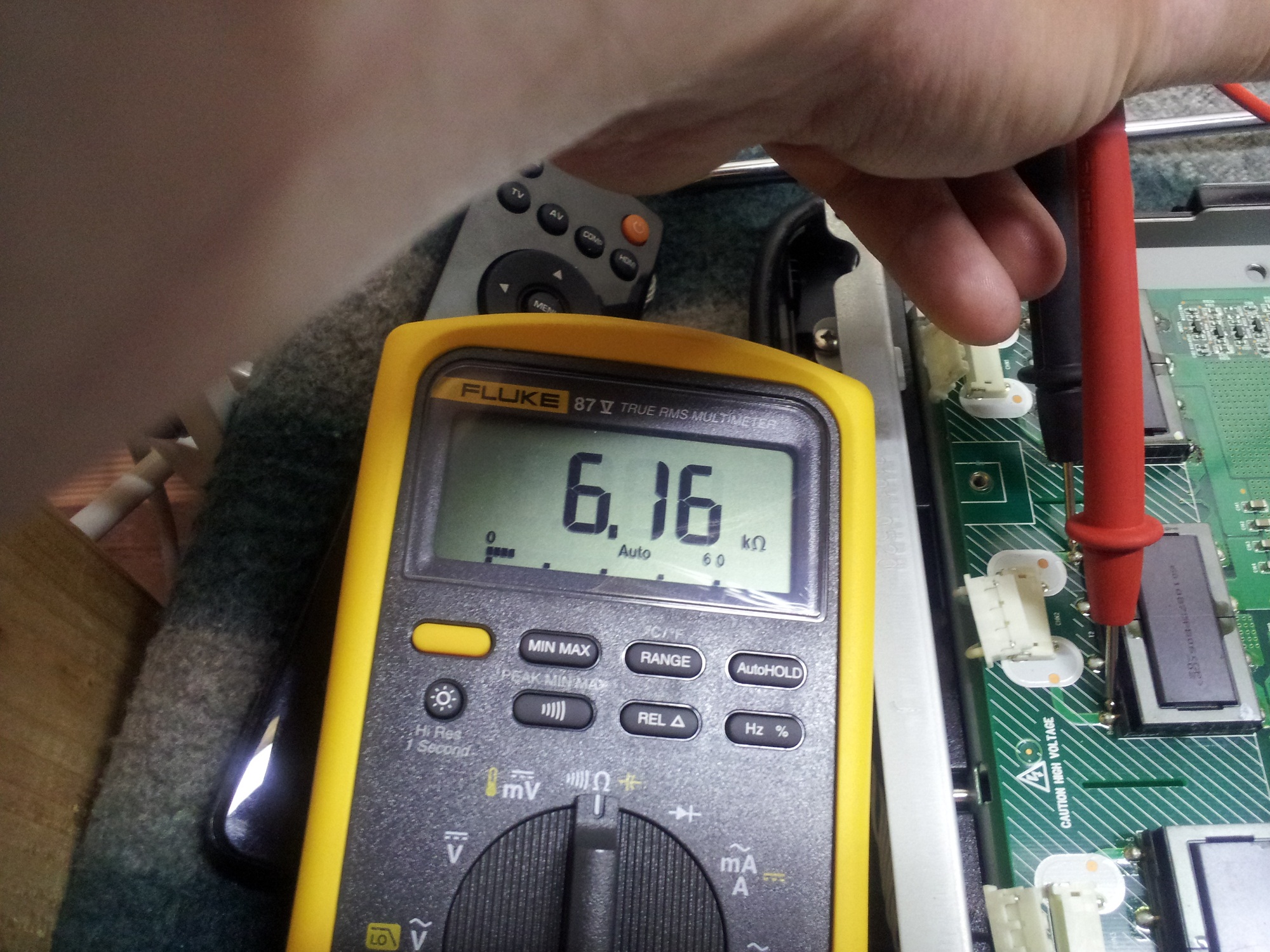

            I had a breakthrough with mine, though not sure what I did that "fixed" it to a point.
            I guess I have tried using budm's suggestion to use the min/max on my meter, but course I didn't know what I was doing because it was maxing out with OL, but after this the TV stayed on with white logo.

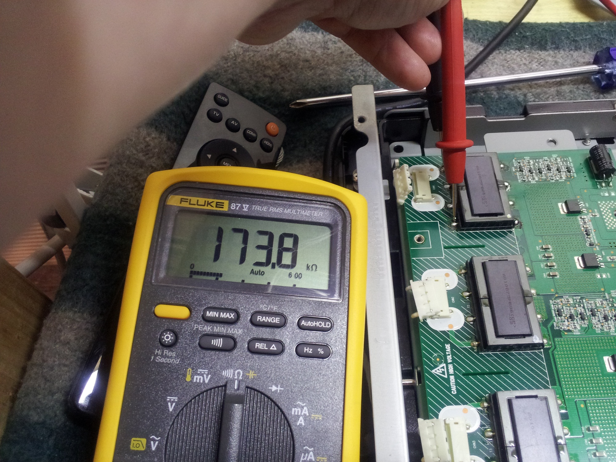

            My primaries were 1.6xxKOHM and the secondaries were 6.1KOHM except T1's which was 158KOHM.
            So I guess this is my problem.
            Now where can I find this transformer?
              Re: Vizio VX37LHDTV10A

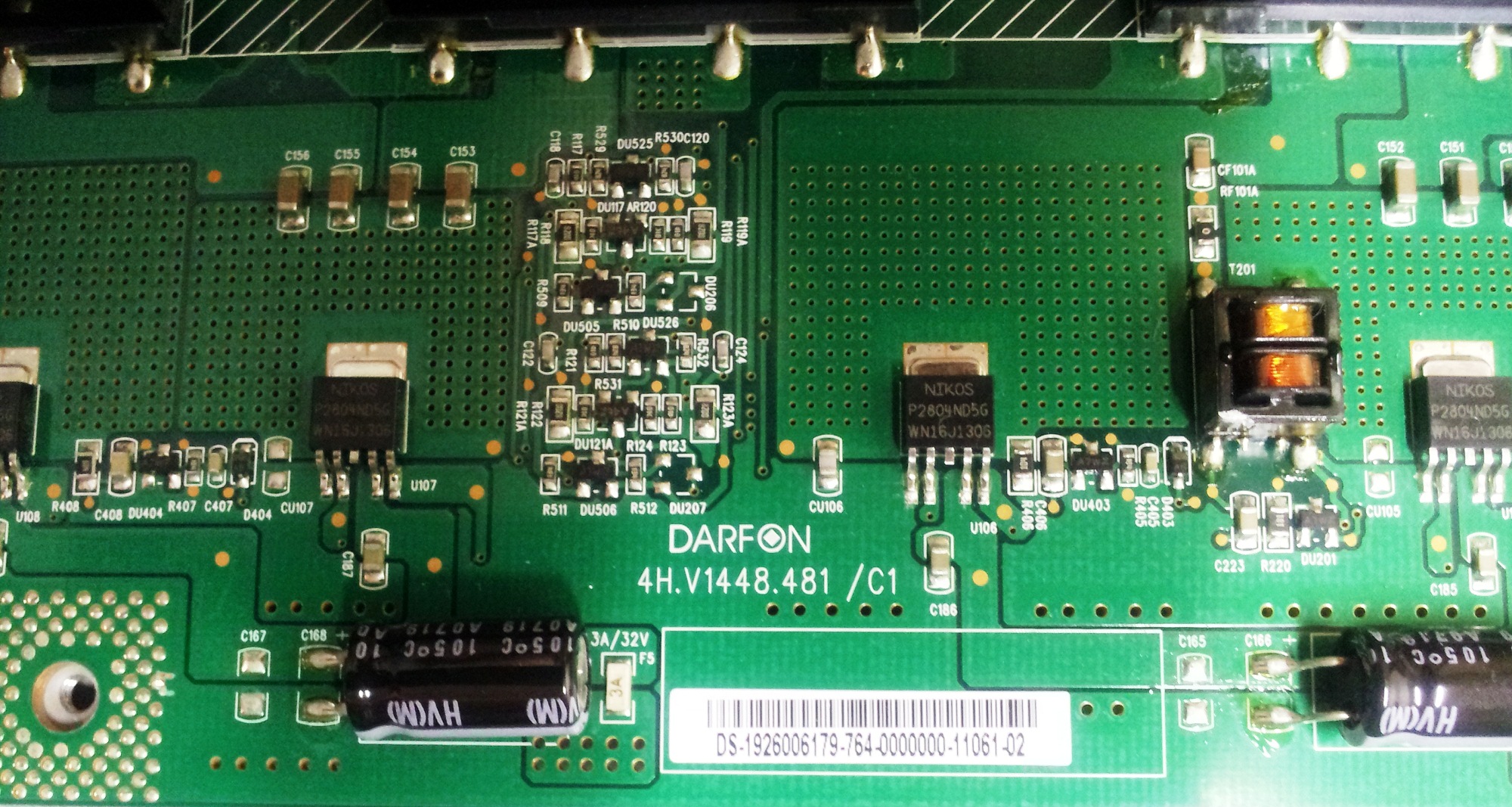

              Can you post the pictures of both Inverter boards? I want to see if they are the same as what I have at home. you are talking about the inverter transformer right?
                I have only one board on the left side.
                Now that I have put back the board in it's place, I'm getting even higher value.
                  Ah, Darfon inverters - these fail like nothing else - and it's usually the transformers. Enter the part# into eBay to find replacements.
                      One retiredcaps bonus point for a picture of your new Fluke 87V!
                      $9.99 + free shipping. USA seller.
                      http://www.ebay.com/itm/120903712163
                      From the auction ...
                      "If you have a failed 4H.V1448.481 inverter board then there is a good chance one of these is bad. If you have an ohmmeter you can find out which one is the problem, simply measure the resistance between the two terminals at each bulb connector and they should all read very close to the same value, about 6k, one will have a higher or lower value indicating a failure. I can not guarantee that this transformer is the only problem, but on the boards I have seen it was always T2 or the second one from the top and replacing it fixed the board."
                        Wow, thanks for that. I guess only the first number/letter combination matters(6010B), right?

                          The two VX37L I have uses two Inverter boards, the main board and my power supply (the connectors are the same as your) are not the same as you either.
                          Darfon is rally known for using bad transformers.

                            I have purchased that transformer that retiredcaps posted(thank you again) and I will see if it fixes this TV(finally). I'm fixing way to many Vizios, but they are easy money.

                                I'm thinking about fixing them, but if I remember well I wasn't getting 12/24V from those. Most likely it's a primary side issue or again could be just some capacitors blown like in this one.

                                  Finally I fixed it!!
                                  I have replaced that T1 transformer and all it's OK.
                                  Thank you all for helping me, specially budm.
