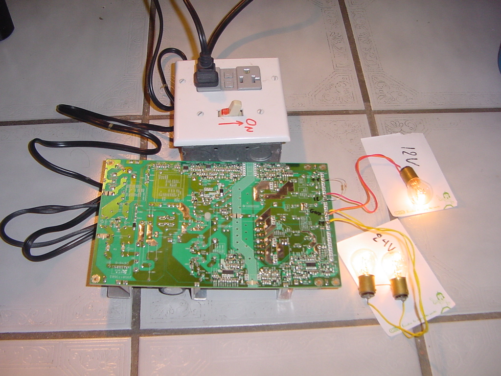

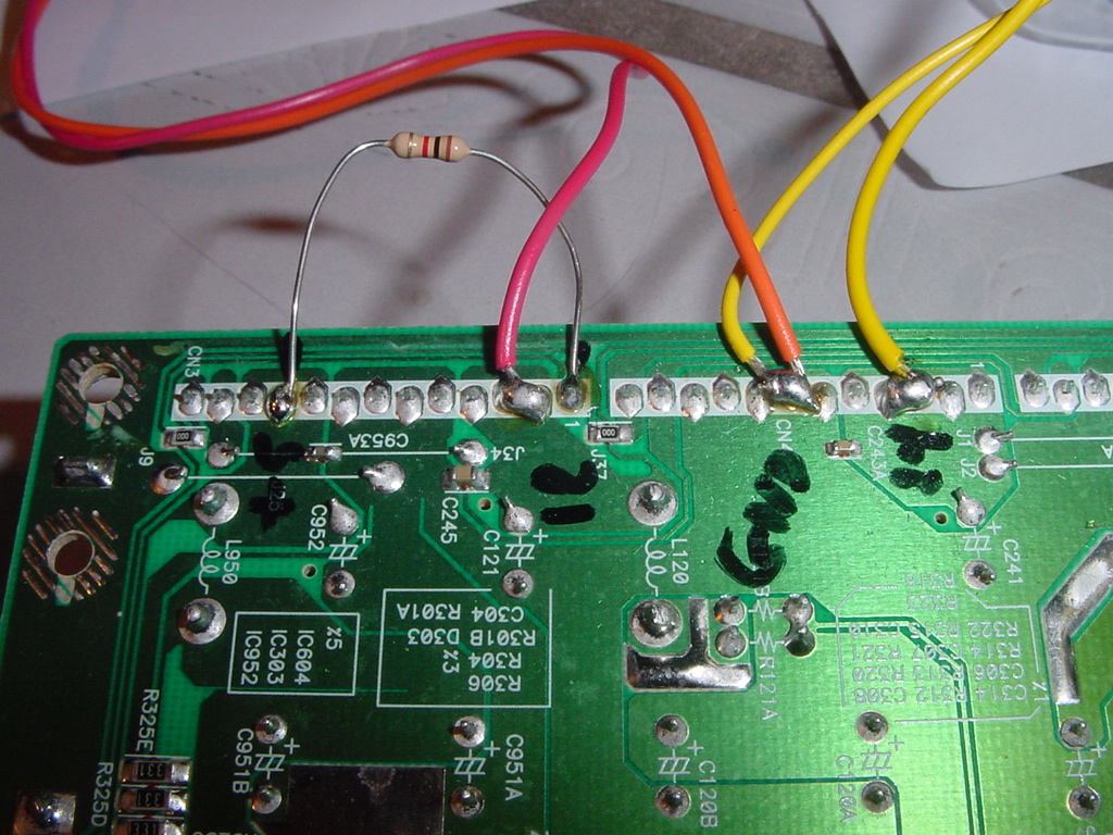

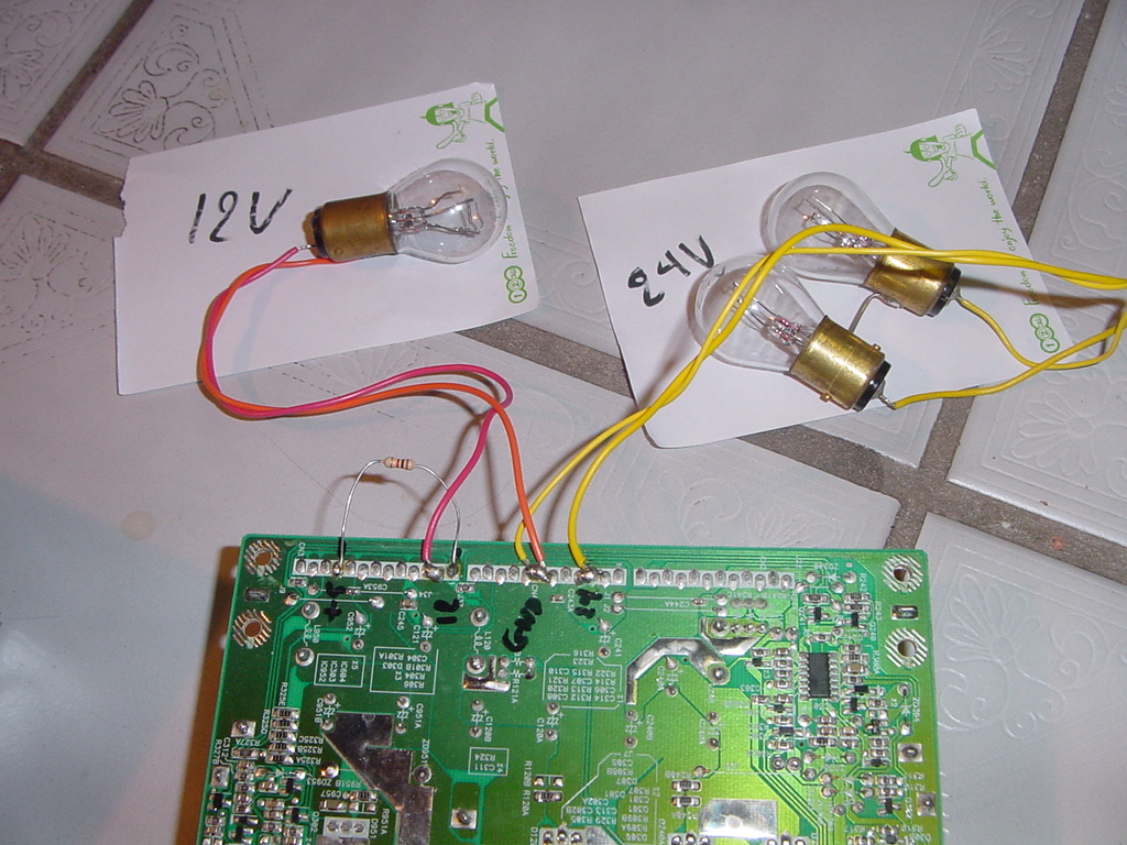

                I have just made the pictures:
                  Re: Vizio VX37LHDTV10A
                  OK, you did hook it up correctly, that is how I test my. The PS_ON is a steady DC for the 12/24vdc to stay on, if you remove the 3.3v, then the 12/24v will go off. I use momentary push switch (Normally open) to activate/deactivate the P.S.
                  If you hear buzzing and wrong voltages, then there is problem in this section without even using full load, then we have to check more for where the problem is.

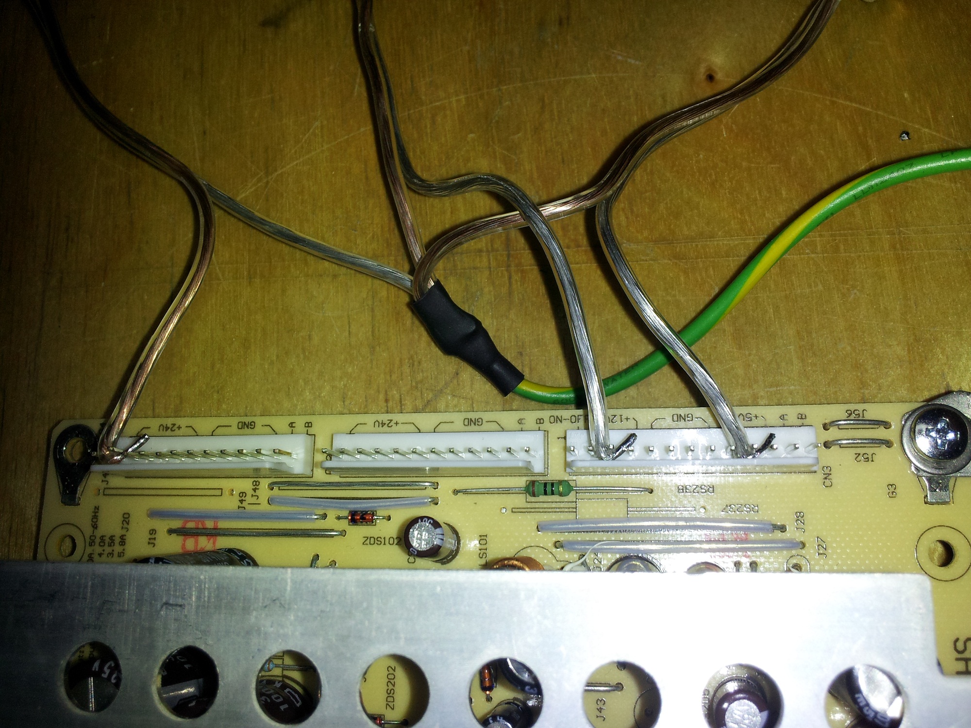

                                      I'm still trying to fix the original power supply.
                                      On the 12v rail without any load I have 13.3V and with load I have 21.7V.
                                      How is that possible?
                                      On the 24V rail I have 20.9V without load and 0V with load.
                                      Loads are bulbs.

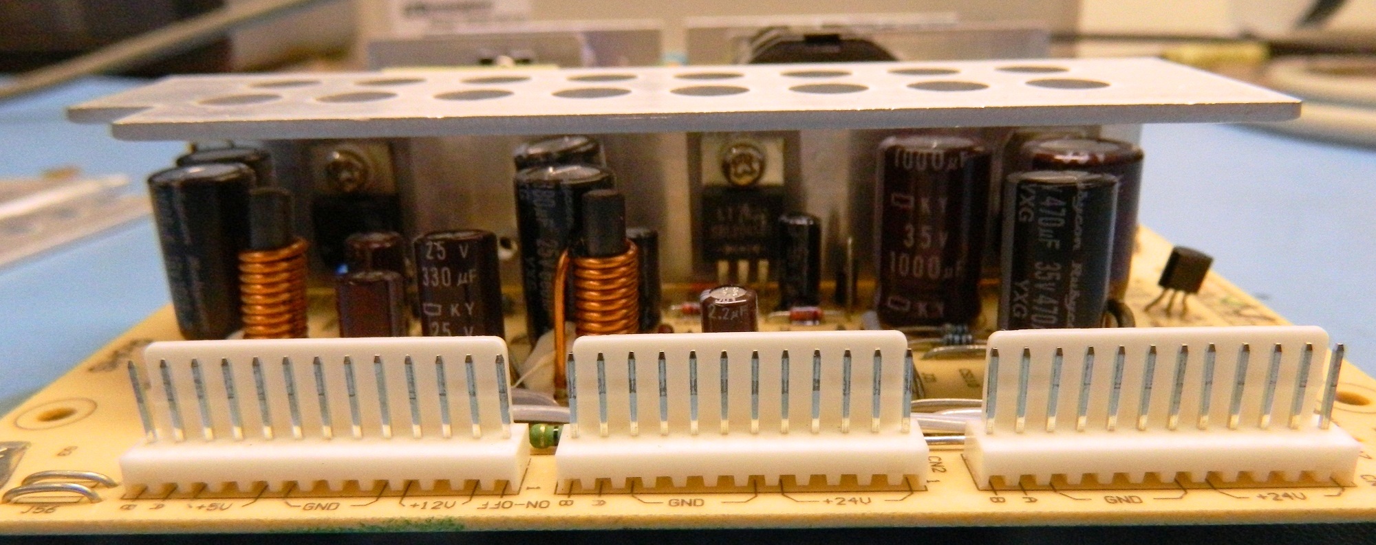

                                          Boy, I do not really know what is going on with your setup and the TV. I just setup the power supply for VX37 and took some pictures for you.
                                          What happen if you put the power supply back in but do not connect the power cables to the Inverter boards, will the VIZIO LOGO stay white?
