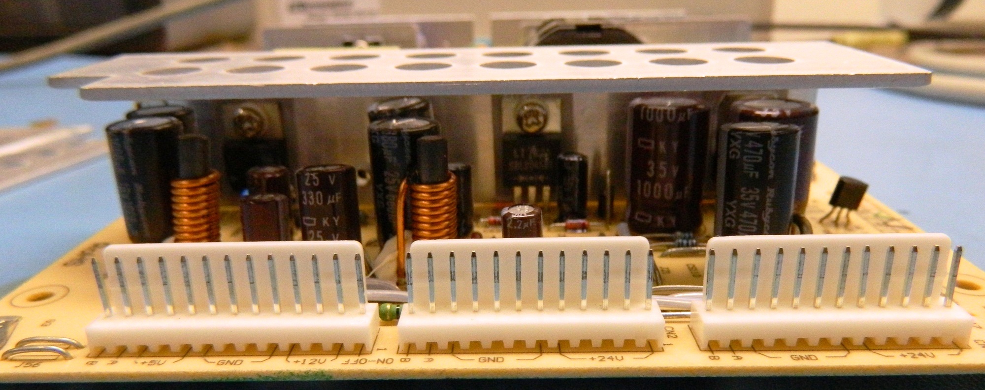

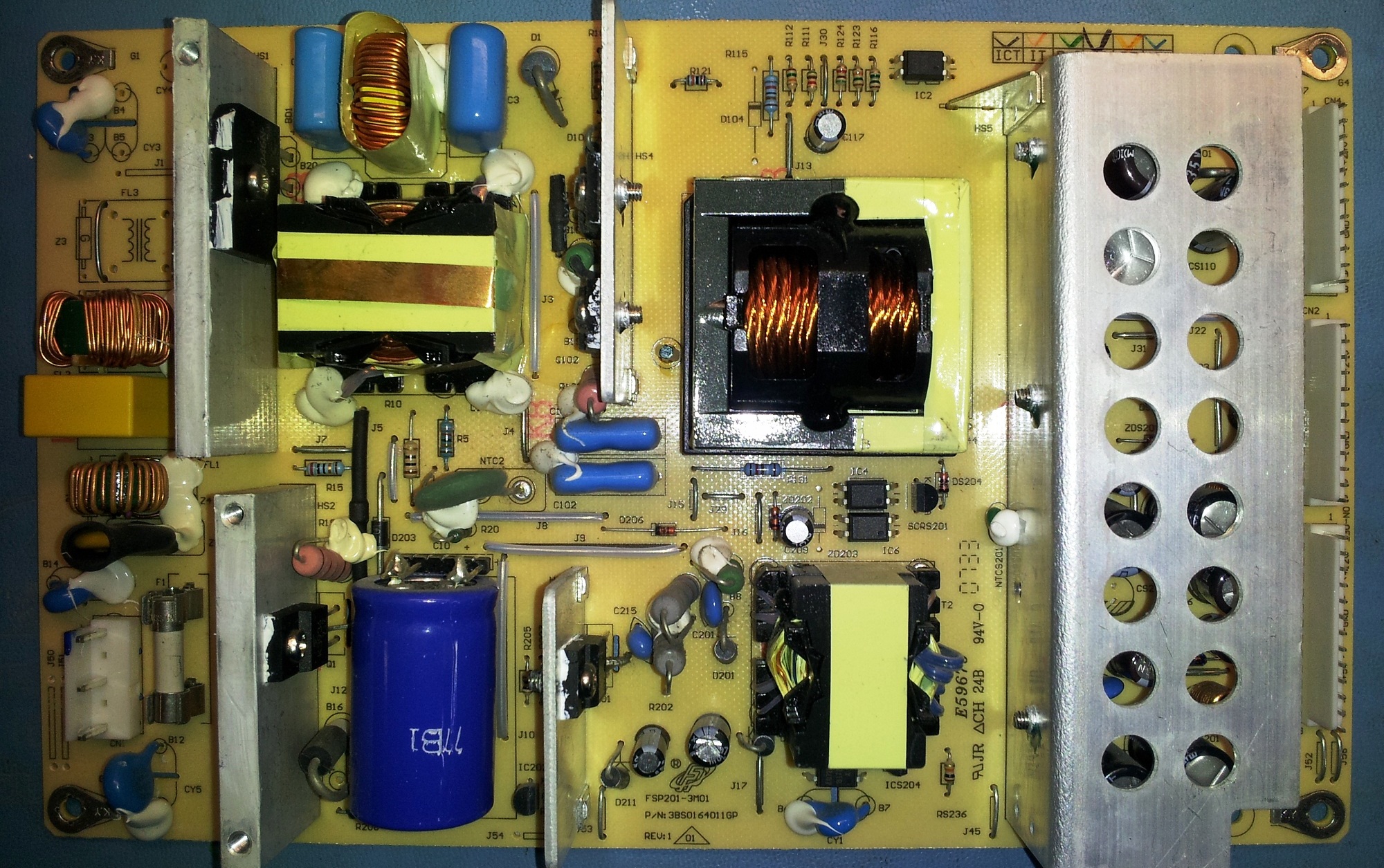

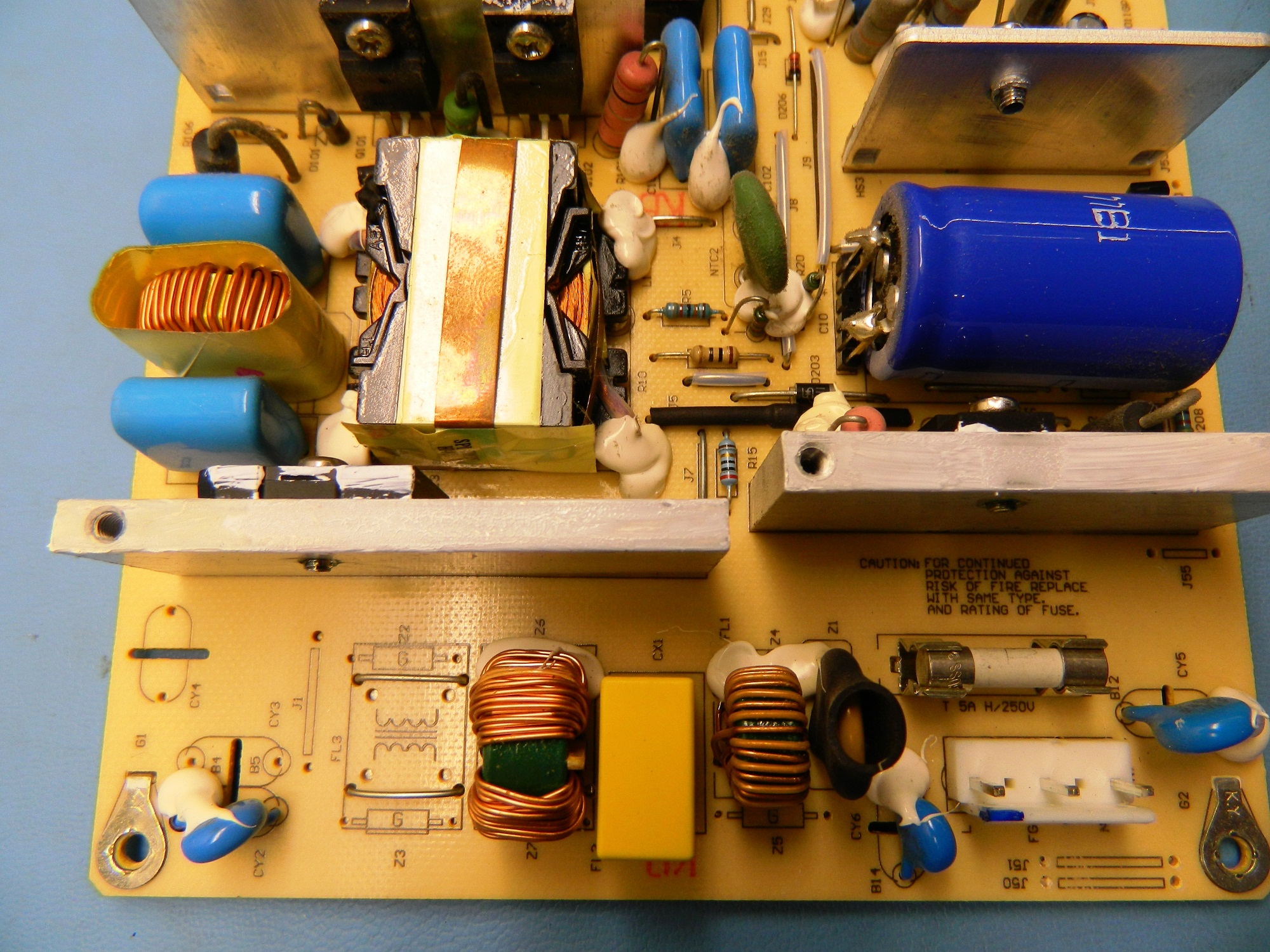

                        Re: Vizio VX37LHDTV10A
                        Can you post a photo of your power supply? Clear and in focus, and from the top as well as the bottom. I'll try to highlight some checks you can do.
                          Here they are:
                                By the way, can you also post the picture of the output connectors so we can read the Voltage labels?
                                Never mind, I got the pinout from FSP website:
                                http://www.fspgroupusa.com/fsp2013m01/p/684.html
                                See what I can figure out.
                                  here it is:
                                    This is how I test the power supply module, I hook up 6v lamp to the 5VDC stanby power supply out put, 24vdc lamp (two 12v lamp in series) to 24vdc output, 12v lamp to the 12vdc output. When you apply the 120v to it, you should on ly see the 6v lamp on, when you apply 3.3~5vdc to the PS_ON, then the 12/24vdc lamps should come on, this is the typical setup after you inspect the FSP power supply module. Sometime you have to check if PS_ON is active high or active low control signal type by tracing out the traces on the board.
