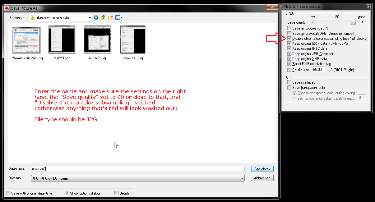

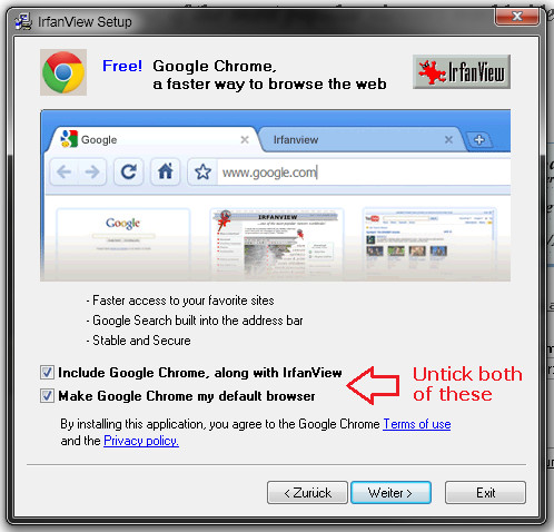

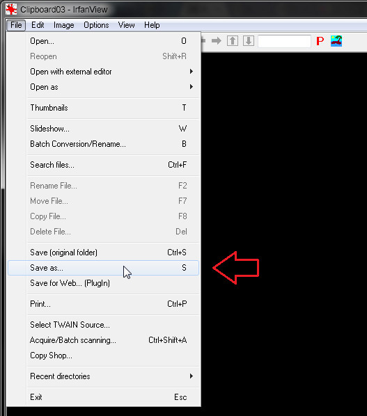

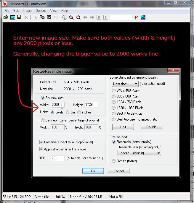

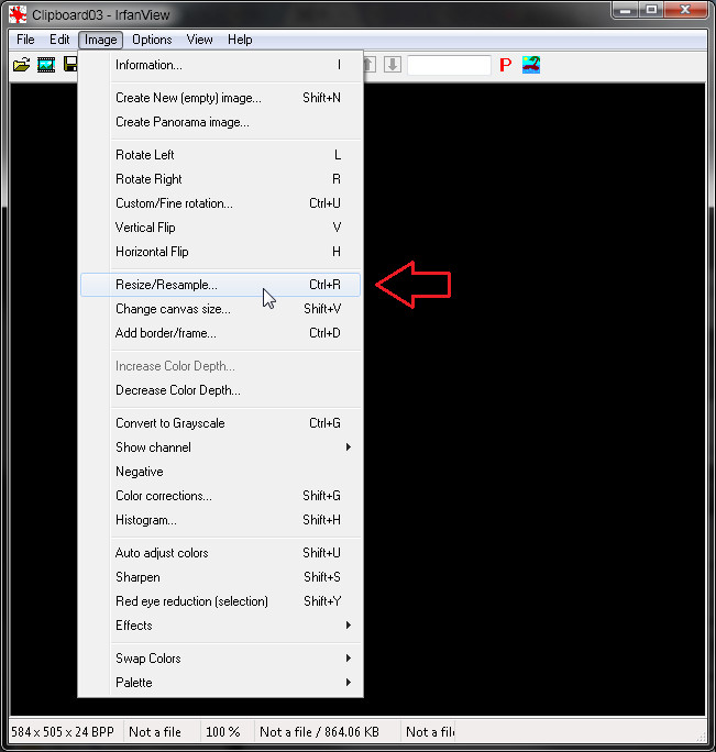

                                      If uploading photos via forum attachments fails, it's usually because the pics are too big (more than 2000x2000 pixels or the files are larger than 3.81 MB).
                                      You can use a free image viewer like IrfanView to resize them if needed.
                                      If you decide to use that one, just make sure you untick the additional software it wants to install with it (usually Google Chrome). See first attached screenshot.
                                      Once you're in Irfanview, open the picture you want to resize, click on "Image" in the toolbar and select "Resize/Resample" (or just use the Key-Combo CTRL+R).
                                      Enter "2000" in the field below the larger number.
                                      i.e.: if current size shows "2304 x 1728 Pixels", you'd use the first (width) field.
                                      Hit OK, check the result and if it's fine (not stretched or anything), you can save it, using either File -> Save As or by just hitting "S" (does the same thing).
                                      The attachments under my post show examples of this.
                                      If you want to, you could also use the "Batch conversion" menu entry in the "File" menu, instead of resizing every image by hand. However, the settings menu of that looks a bit daunting to a beginner (tons of options).
