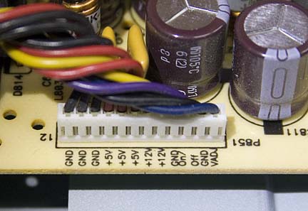

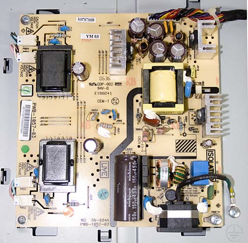

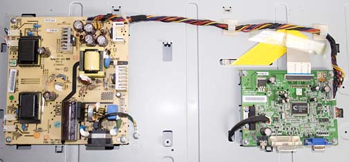

I would like to eliminate the AC power section and run DC voltage. I've replaced the CCFL's with LED's (12V DC). The conversion looks excellent. It would be a nice bonus if I could get rid of the AC board.
This is a HP W22 monitor ( I have three ), two more to fix.
I want to power the monitor from one AC/DC power brick. If it's not doable this is still a win.
Thanks for any guidance.
