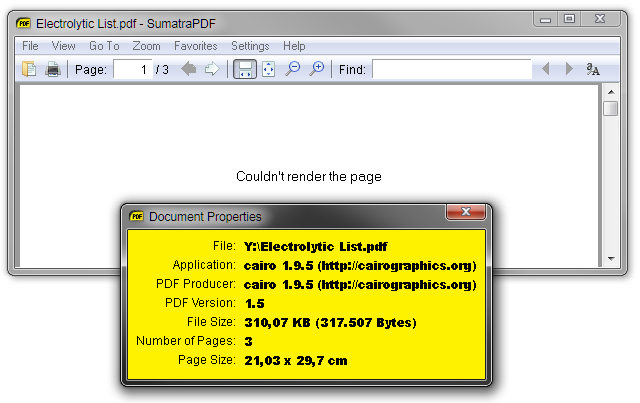

                      • Scenic
                        o.O
                        • Sep 2007
                        • 2642
                        Re: Need advice on good replacement caps.
                        Originally posted by mariushm
                        PS. I've grabbed the Samwha datasheets a while ago and posted them here: ftp://helpedia.com/pub/temp/datashee...et%203/Samwha/
                        Sorry for going a bit off-topic, but could it be that the "electrolytic list.pdf" is somehow damaged or in a non-standard format? All I get when I try to open that is "Couldn't render the page" in Sumatra PDF.
                        All other PDFs seem to work just fine.. weird
