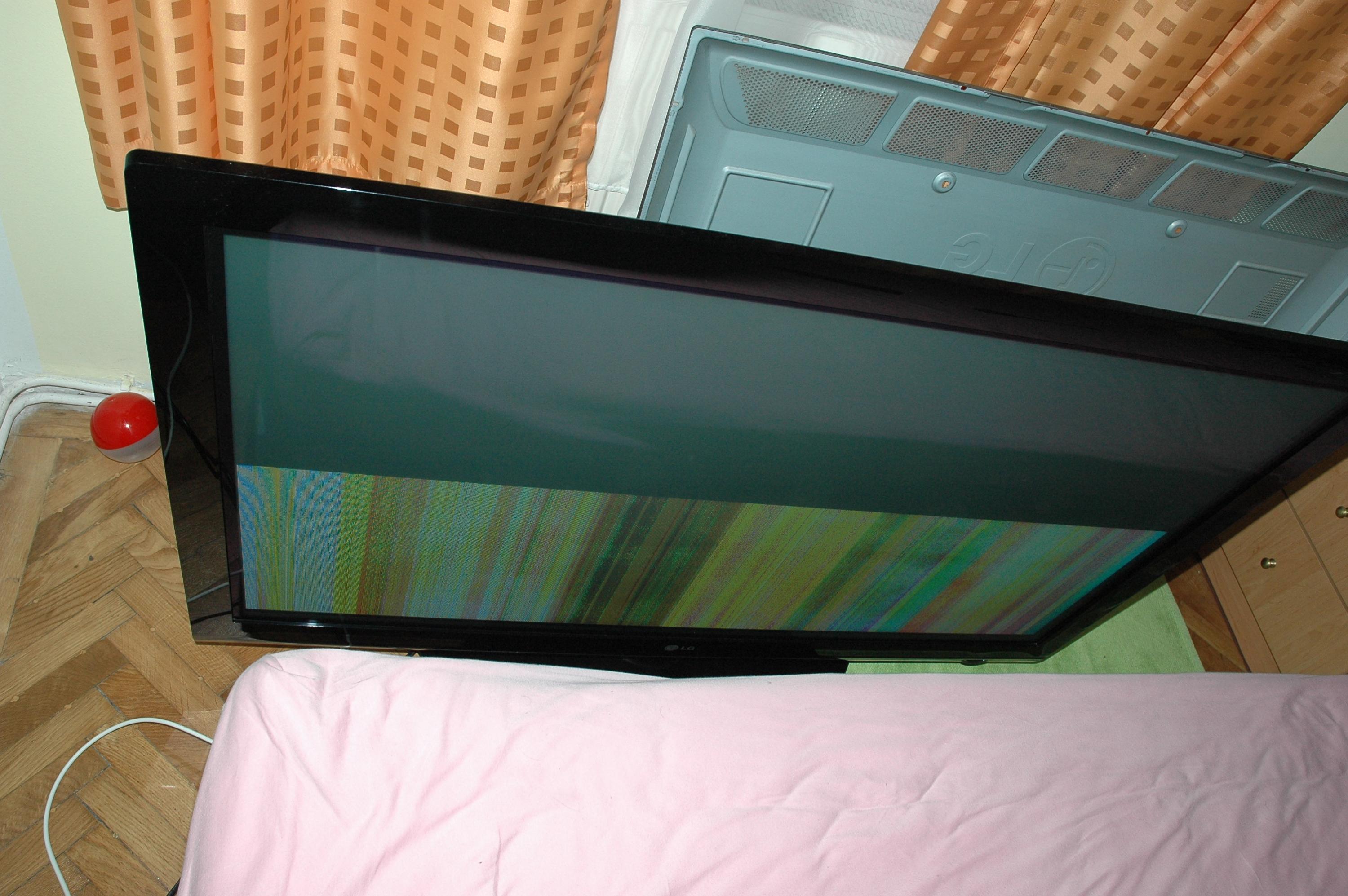

                                Hello i have a same problem... I got LG 50PG3000 plasma tv as a gift from my brother because he bought a 3D tv... TV worked fine for him and when i brought it home,i have no picture...I just said .I cant believe that it is broken because transport was 30 minutes long... Sound works... I followed this instruction above and i removed back panel,removed one of buffers,first the bottom one-nothing... Then i removed the top one and i get the picture but just lines only... What should i do? It is just strange situation... I will upload a pictures... Thanks in advance!!!
                                Sorry for my english,i am from Austria...

                                  Since you have a lit up screen with messed up picture on bottom half, your top buffer board is likely bad.
                                  Y-sustain, Z-sustain, control board, power supply, main board and bottom buffer are likely OK.

                                      Assuming that is the top buffer (and not the bottom one), that is all you should need.
                                        Re: LG 50PG3000-ZA help needed please.
                                        So one more question,sorry for anoying... Is this (half) screen that i get ok? i cant get normal half picture? that part from ebay,is THAT that i need ? i ask because i dont want to buy and tv not to work again,because i am a student too thanks so much
