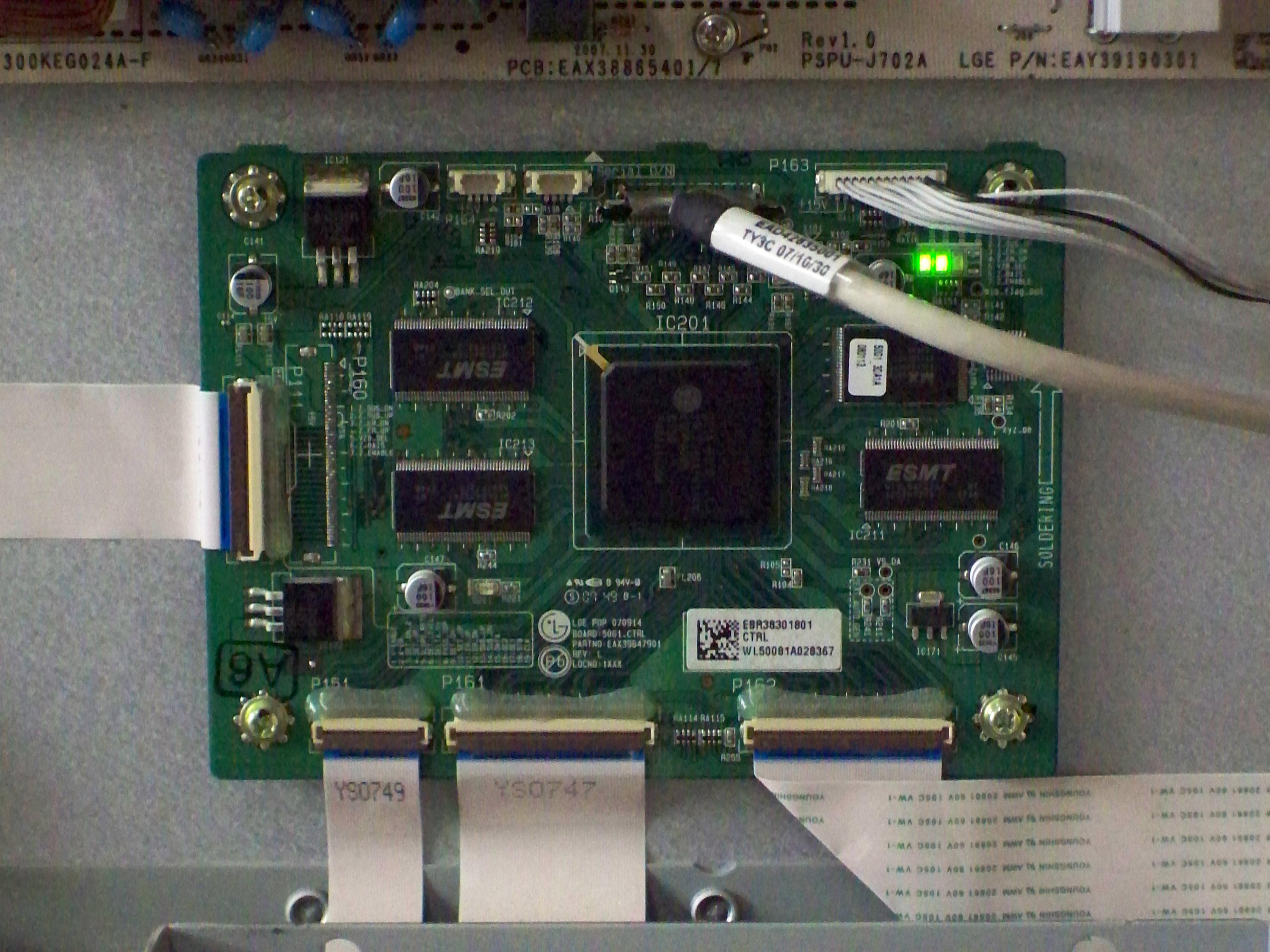

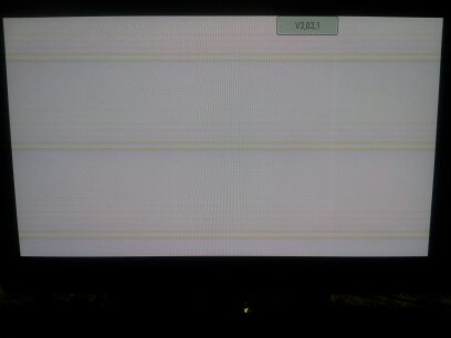

                        I purchased my 50pg300-ZA plasma when I was stationed in Germany (I now live in the US). When I called tech support they told me that my tv didn't exist...
                        I have replaced two bad caps (one bulged,, one leaking) and still have the same problem.
                        Problem:
                        White / grey screen with a box that shifts across the top of the screen that says v 3.03.0 . I can get to the service menus using the remote / tv button hold combo but cannot scroll / move after getting there. The front LED blinks to show that it is receiving the RC signal but... nothing. I can also see 1 (sometimes 2) green leds on the control board and all heat sinks get warm when tv is on.
                        I can also get a source menu to pop up and when attached to cable tv i get a garbled picture as if I am on the wrong channel but cannot change it.
                        The tv turns on automatically when plugged into power and can only be turned off by unplugging it.
                        I do not know if it is coincidental or not but this started to happen when I pushed an erroneous button on a universal remote. (I have since tried EVERY button on that same remote to no avail)
                        Hopefully this is enough info to help get me pointed in the right direction...
                        Thank you in advance for any help that you can give.

                          Update/corrections:
                          I have a 50pg3000-ZA
                          It says V3.03.1
                          The control LED's have changed. Yesterday it was the middle and/or the left, now it is the middle or right.
                          I tried to make a RS232 cable and send ASCII code but that didn't work either.
                          *Note that the horizontal lines are frequency lines due to the camera.

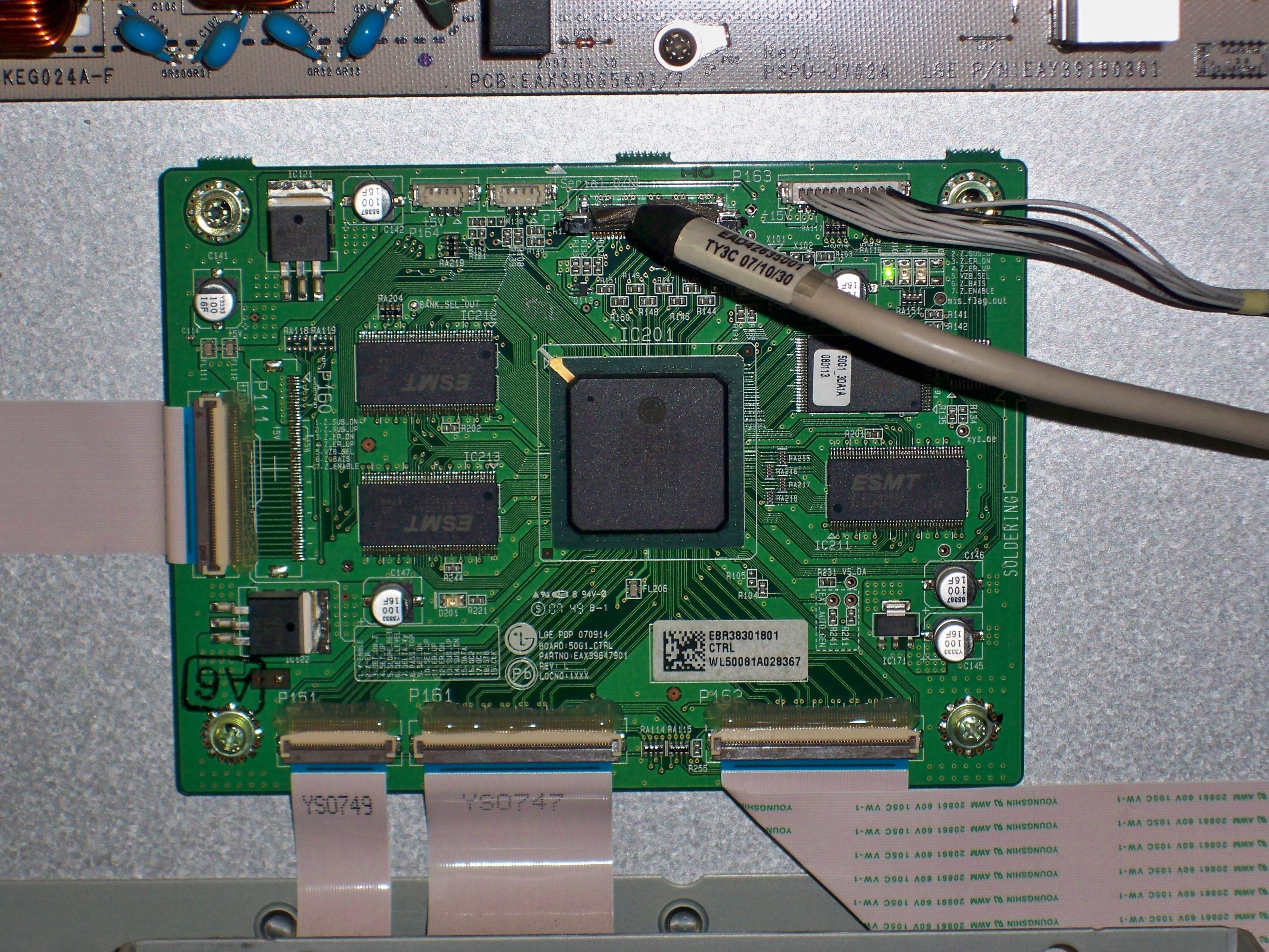

                                Is the fault that the screen is in inverse? Have you tried changing ISM Method in user menu from INVERSE to NORMAL? Also, can you post a picture of the control/logic board?
                                  #56
                                  Re: LG 50PG3000-ZA help needed please.
                                  The fault is that these are the only screens I can get. I cannot change anything. When I push buttons on either the TV or the remote the green light on the TV will blink to show it is receiving a signal (every button except the power button) but nothing changes. I will open it back up and get pics of all the boards today.
                                    #57
                                    Ctrl board 1.5 minutes after power-up . After 35-40 . After 1 hour 10 min . I left it on for an additional hour and the led's didn't change.

                                          #60
                                          Checked: Va, Vs, -Vy, VSC and Zbias. Required a little bit of tweaking but all are within +- .1
                                          I do not own an o-scope so I cannot look at or adjust the wave forms...
                                          Still no change...
