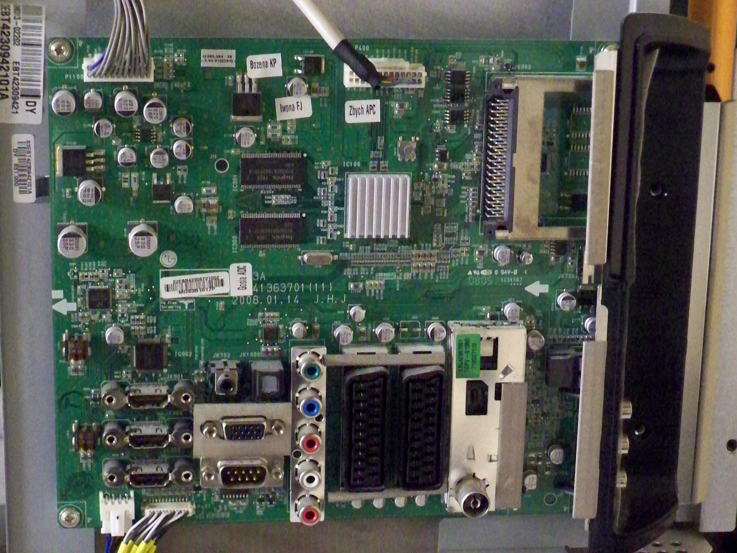

                      Re: LG 50PG3000-ZA help needed please.
                      tom66.... Did you mean this board?
                        #71
                        That's the main board. Control board is next to it, connected by a cable.
                          #72
                          So the pics in post #57 were the correct ones?
                            #73
                            That is control board.
