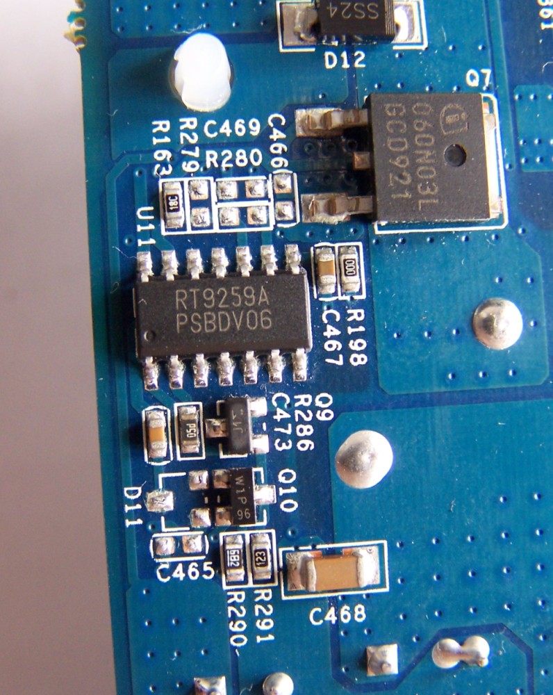

    need to know the value of a smd cap

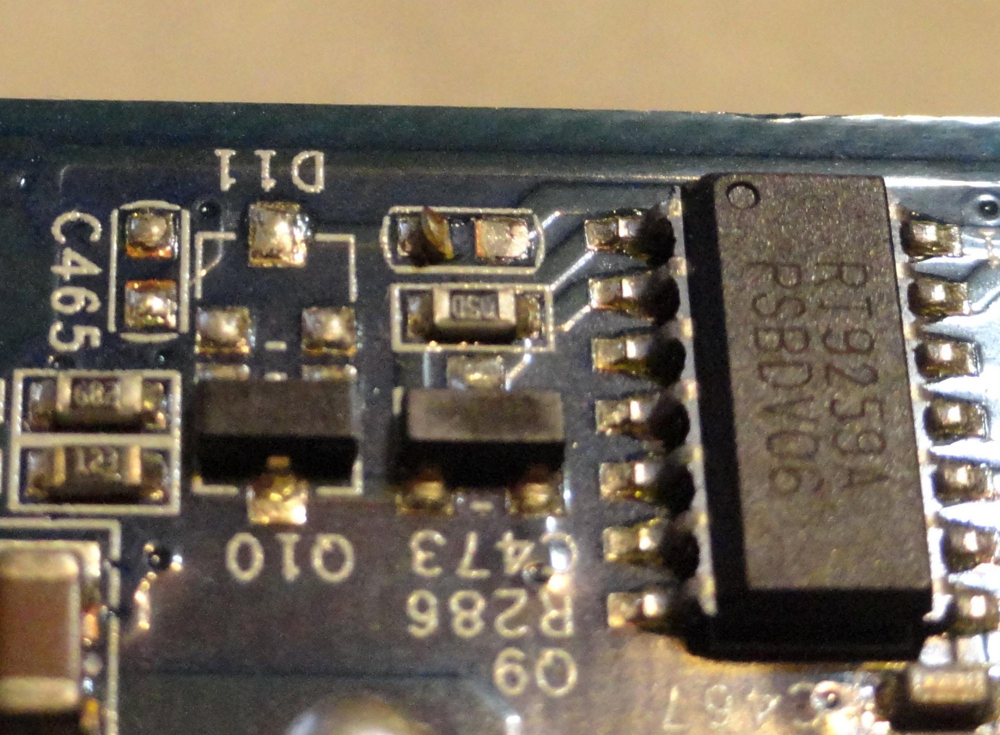

    I have a galaxy gts 250 video card given to me and it has no video. But the cooling fan kicks on so i started looking at it closer and i found a piece of smd cap wedged between to legs of an ic. The ic being this one www.richtek.com/download_ds.jsp?s=327 it was wedged between pin 1 and 2 or 2 and 3 not real sure but any way i was wondering if there was a way to tell the value of this cap here are a few pictures of the damaged area

    I think the better question might be... Where are D11 & C465?
    Pics on the web don't show them there. See attached. Pure luck to find a pic of that area so clear and large.
    If they were not there, then C473 is unnecessary. It connects to nothing.
    Looking at the "hanging chad" of a contact, it seems it may have been hit trying to remove/install the board. Perhaps?
    What pin does the right hand pad of C473 connect to on the 9259 IC?

      Pins D11 & C465 are not populated on my board either. The right hand pad of c473 goes to pin 1 boot of 9259 IC and the left hand pad of c473 goes to pin 13 phase of 9259 IC.
      This is what it says about pin 1 in the pdf. Bootstrap supply for the upper gate driver. Connect the
      bootstrap capacitor between BOOT pin and the PHASE
      pin. The bootstrap capacitor provides the charge to turn on
      the upper MOSFET.

        Unfortunately, SMD caps are unmarked and unremarkable visually. A 1uF may look identical to a 20uF.
        Either find a trashed board somewhere or experiment with some values. Maybe start at 1uF to 5uF ?

          The bootstrap cap value is not important; 1uF should do. Bigger is better.
