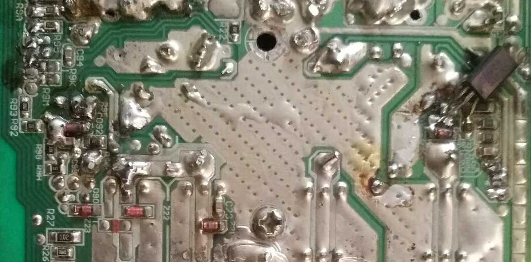

    be quiet! E6 750W power supply causes the computer to not boot and displays fault codes 19 and 00
    When I turned on the power, I found a large triode on the back.(A928),There are obvious signs of burning。
    After detecting that A928 is short-circuited and replaced, the computer starts up normally.

        i think it was designed to be an SMD component but the manufacturer ran out of smd's and just placed an TO-92 one.
