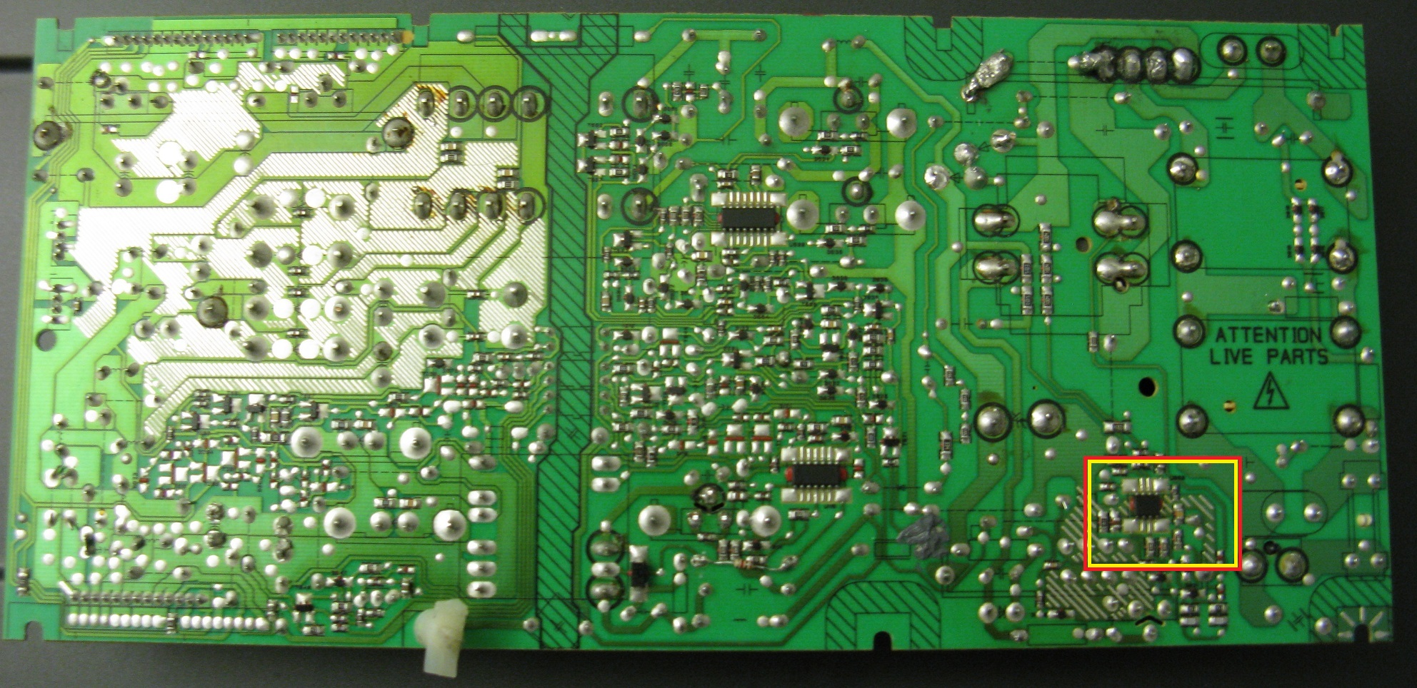

                                    Re: Philips 32PFL5322D/37 power supply repair
                                    Originally posted by kueberco
                                    I have the five volt supply but no 12 volt supply. Is there a way to "cheat" it output the 12 volt supply? Thanks
                                    If your only getting 5v check the PFC controller chip on the back of the power supply. I was only getting 5v and almost nothing on all the other pins and that chip was shorted. I replaced that chip and the tv fired to life. It should have L6562D etched on the chip if it's a 32PFL5322D/37. Check between pin 5 (ground) and pin 6 (Zcd).
                                    Mine was reading 37ohms replaced it and the tv fired to life.

                                      #158
                                      Thank you Mr. Bill! I replaced the chip and the set came to life!!!!
