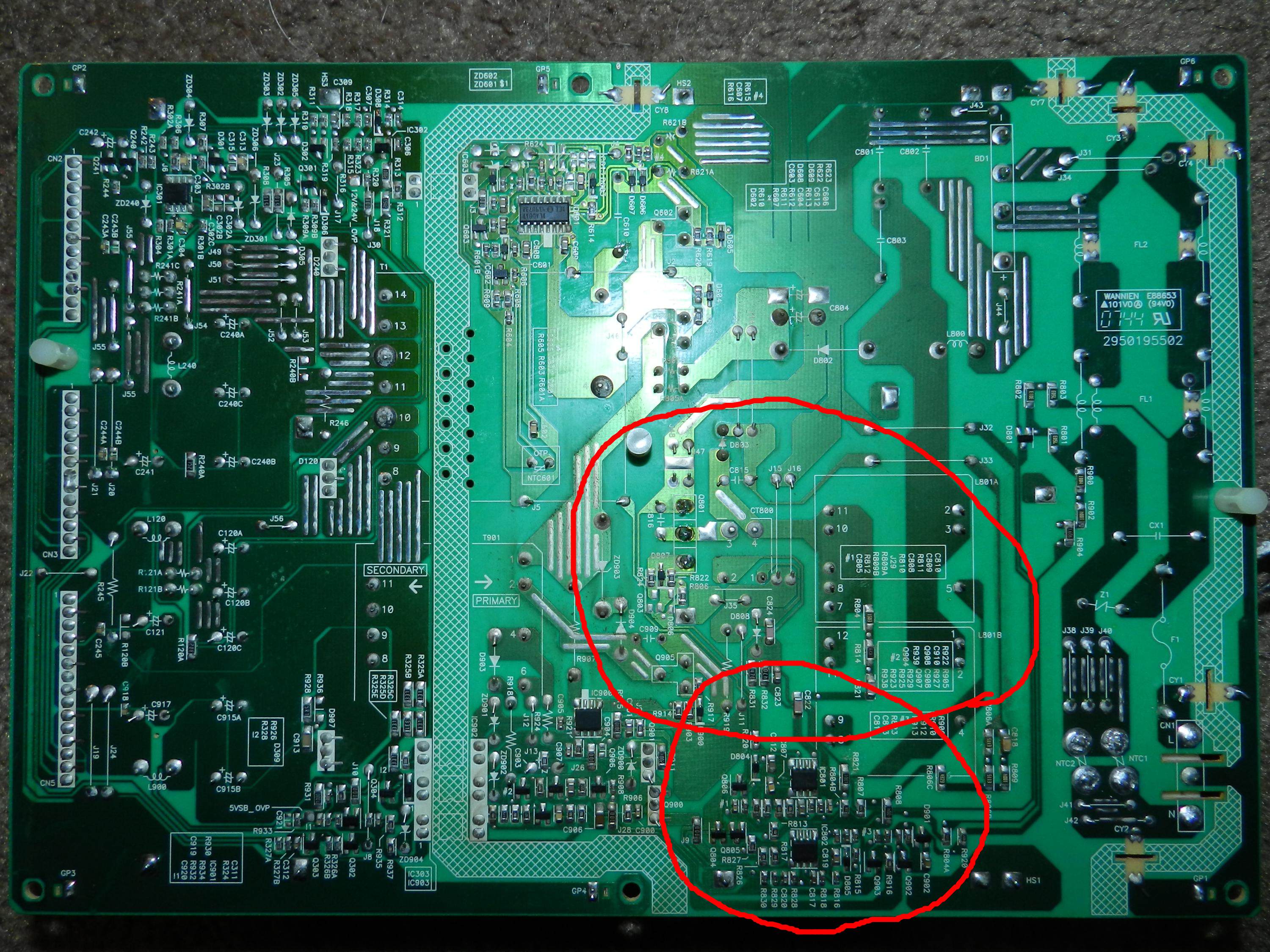

OK, that is not too bad of the problem then, more likely just bad PFC Voltage booster IC.

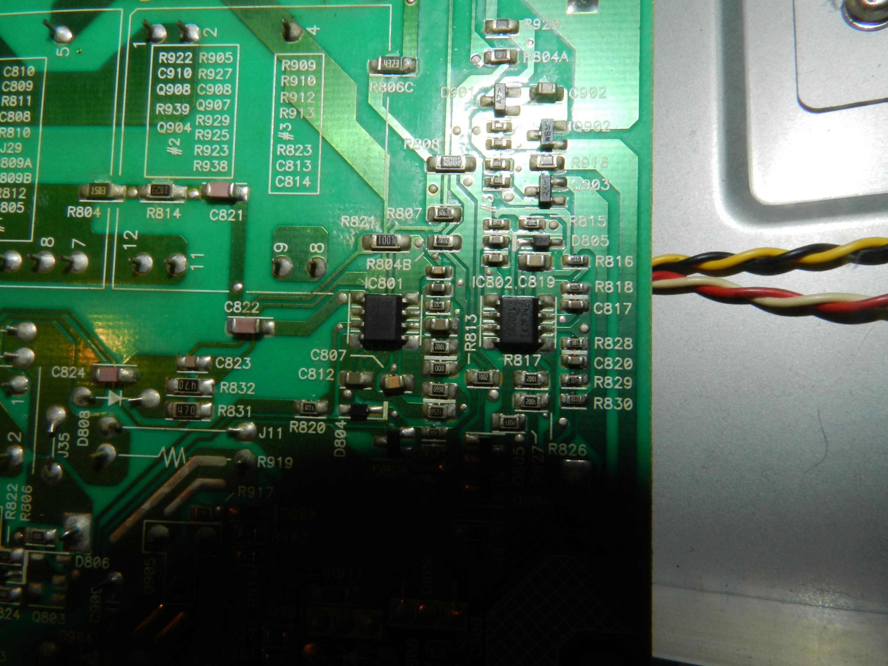

please take good closed up pictures, and try to read the P/N of those two 8-pin SMD IC for me.

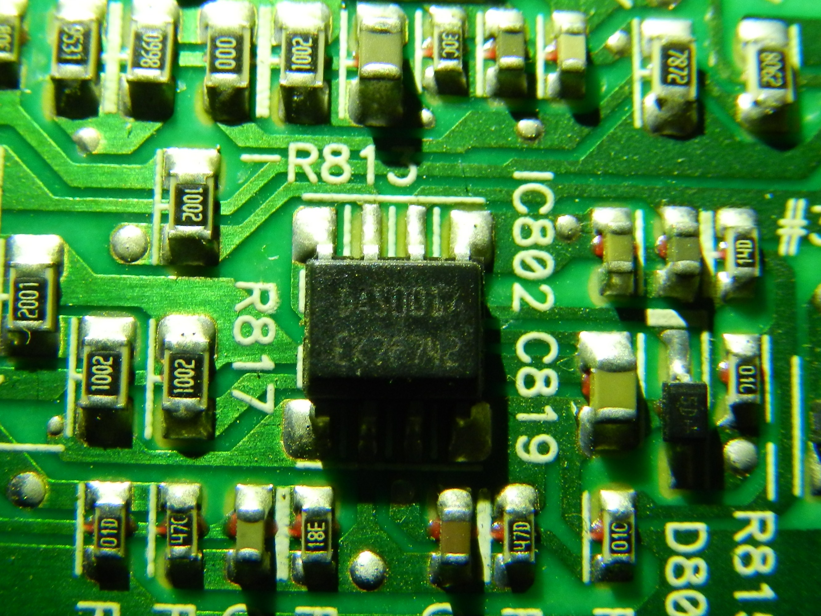

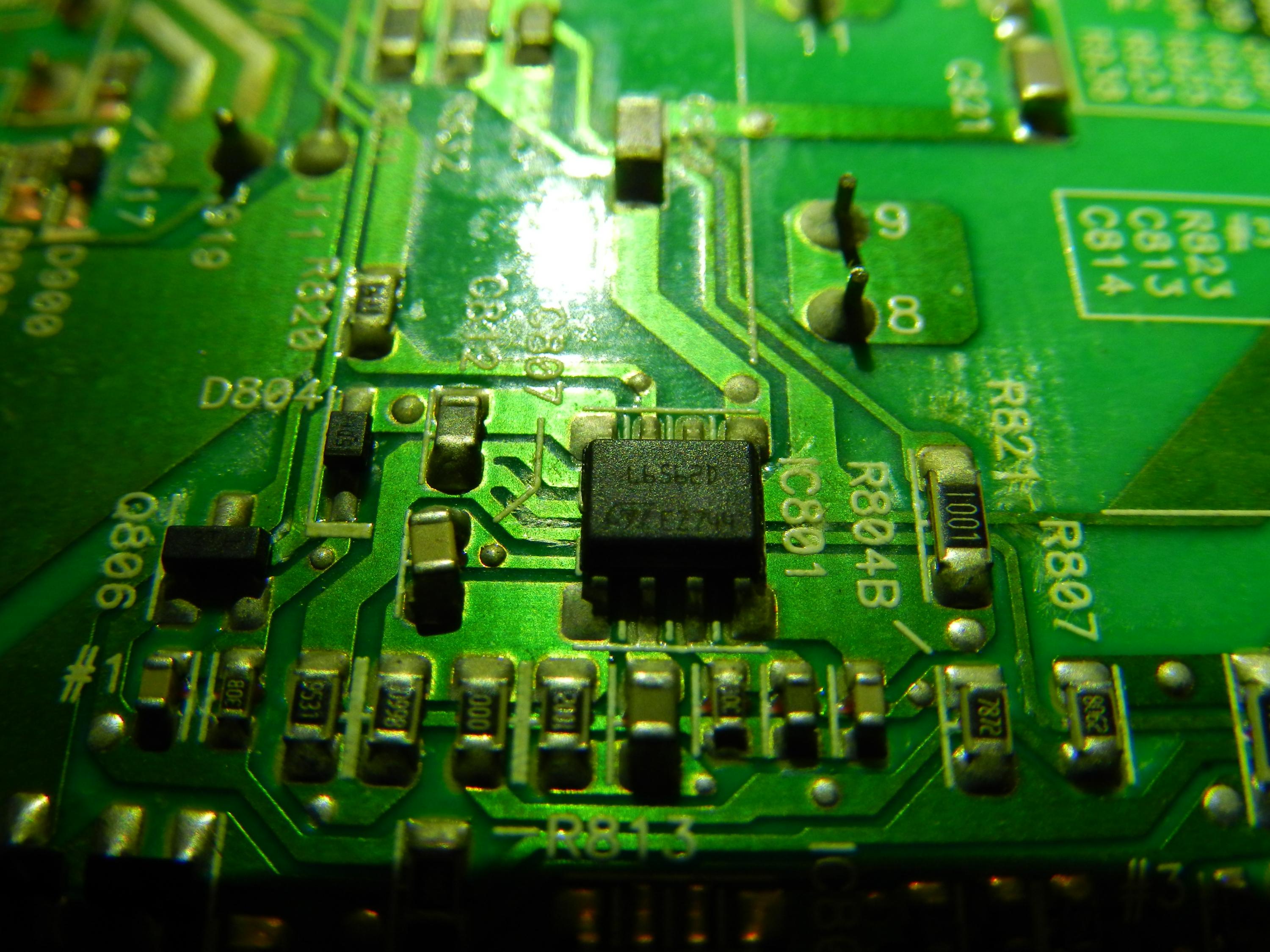

Ok my camera struggled to get real good picture that close but it looks like the lower ic part number is das001 top line , bottom line ek7f742. Still working on other one its difficult to see
That's it! L6562 PFC IC, it is one of common failure IC. No power to the board, take the resistance reading between the IC ground pin6 (black probe) against all other pins, the red probe on other pin one at a time and report the resistance readings.
