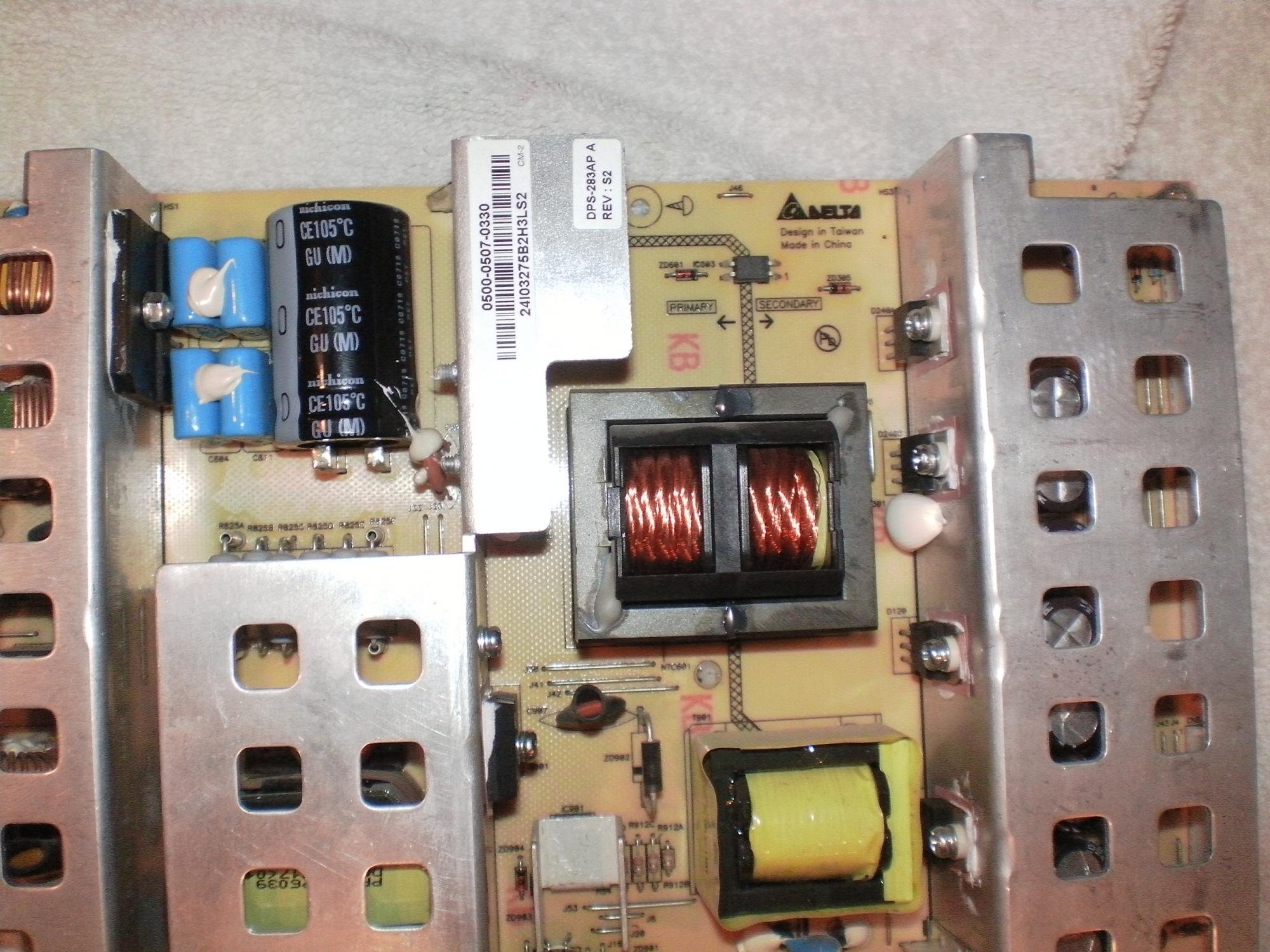

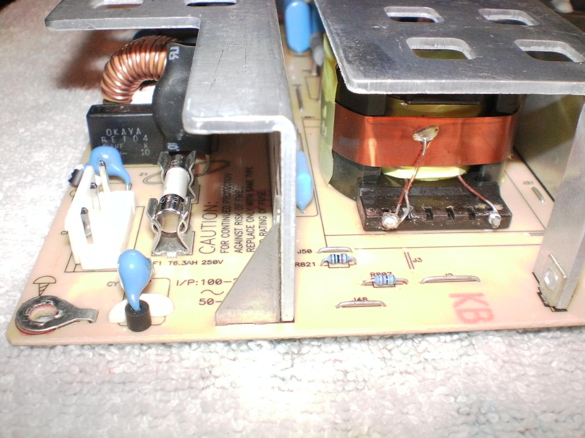

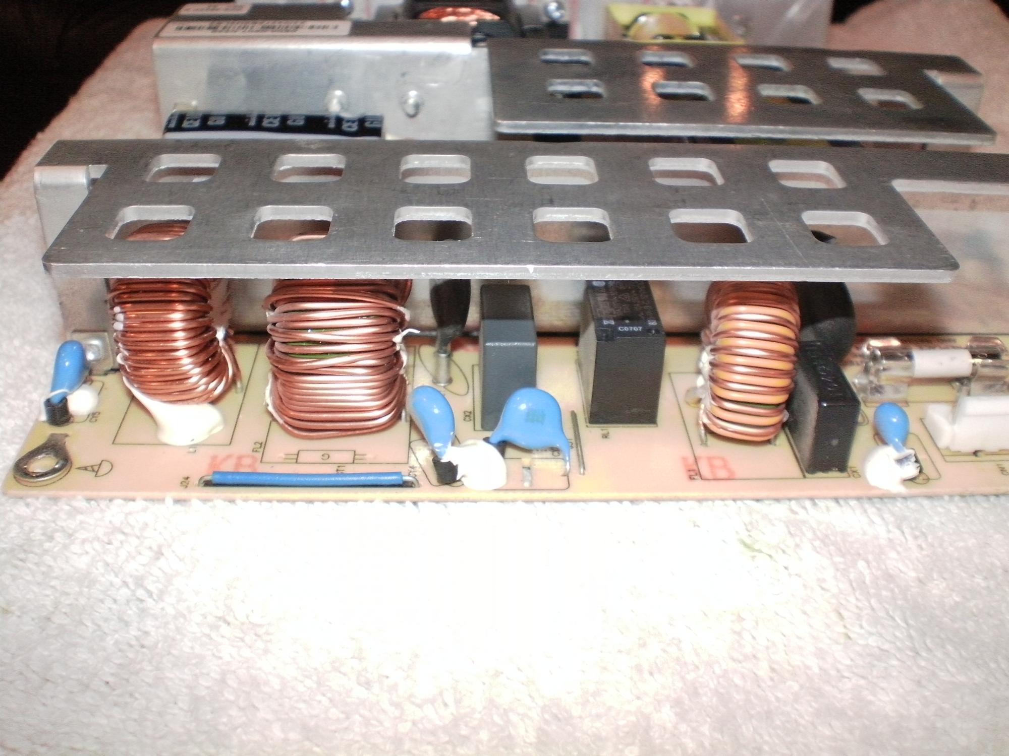

            Re: VZ42L No Amber light, no stand by 5v

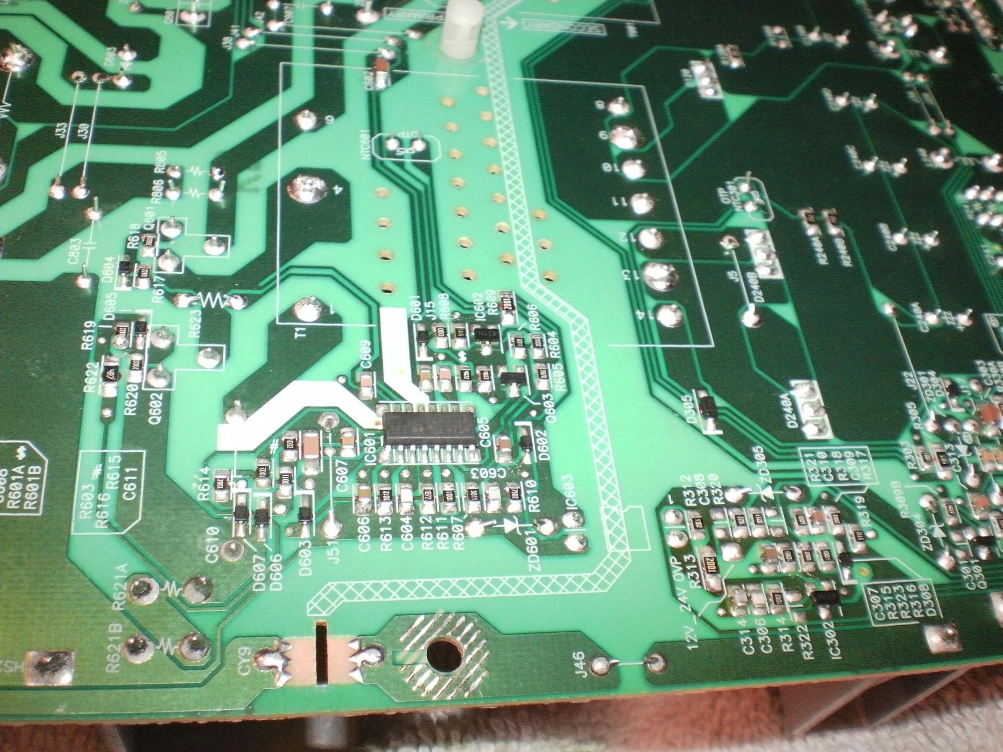

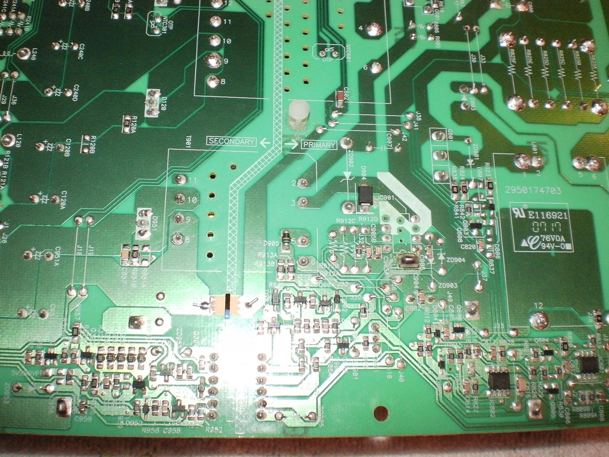

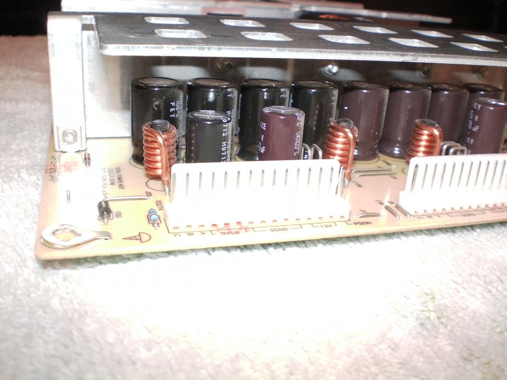

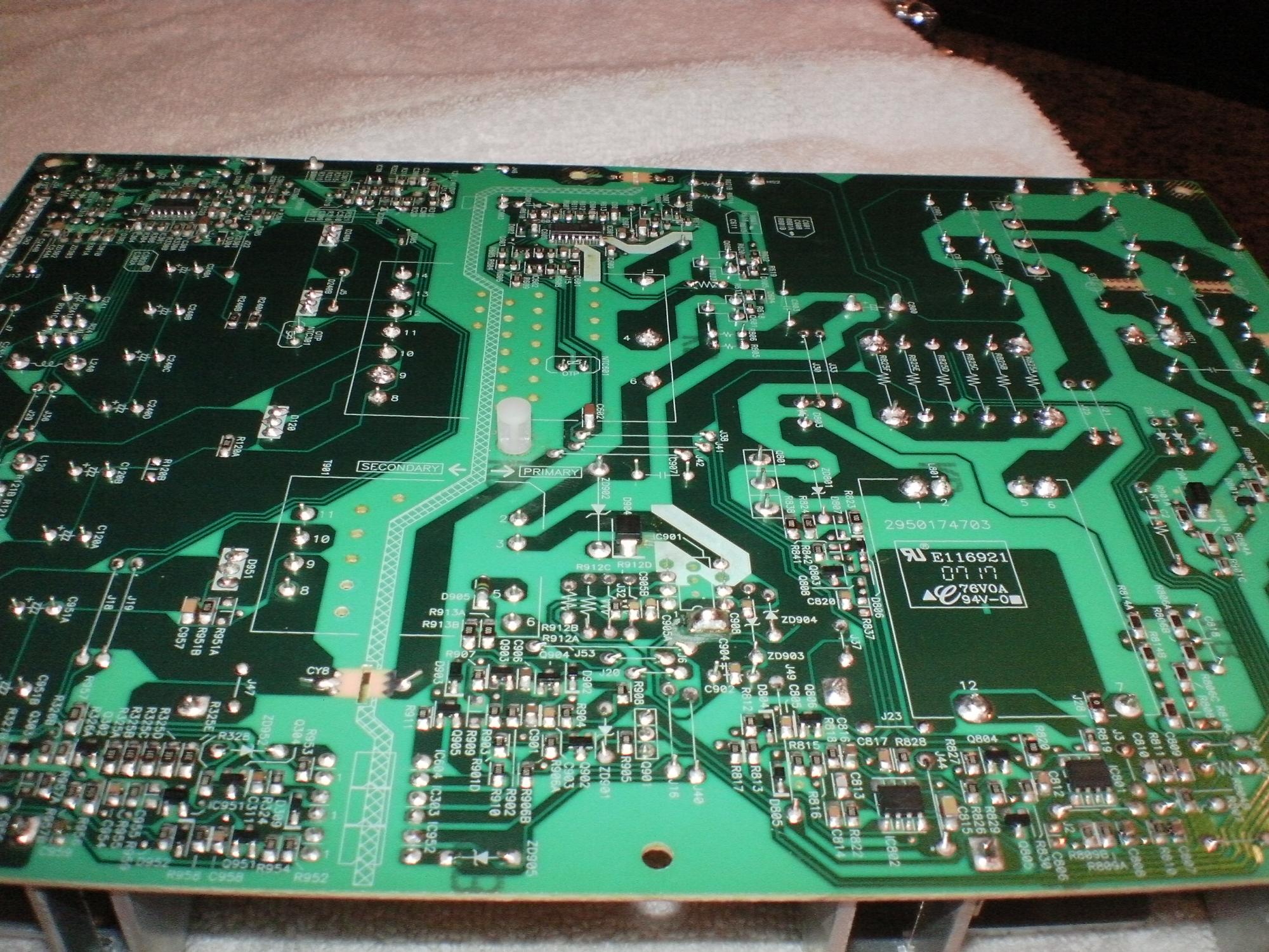

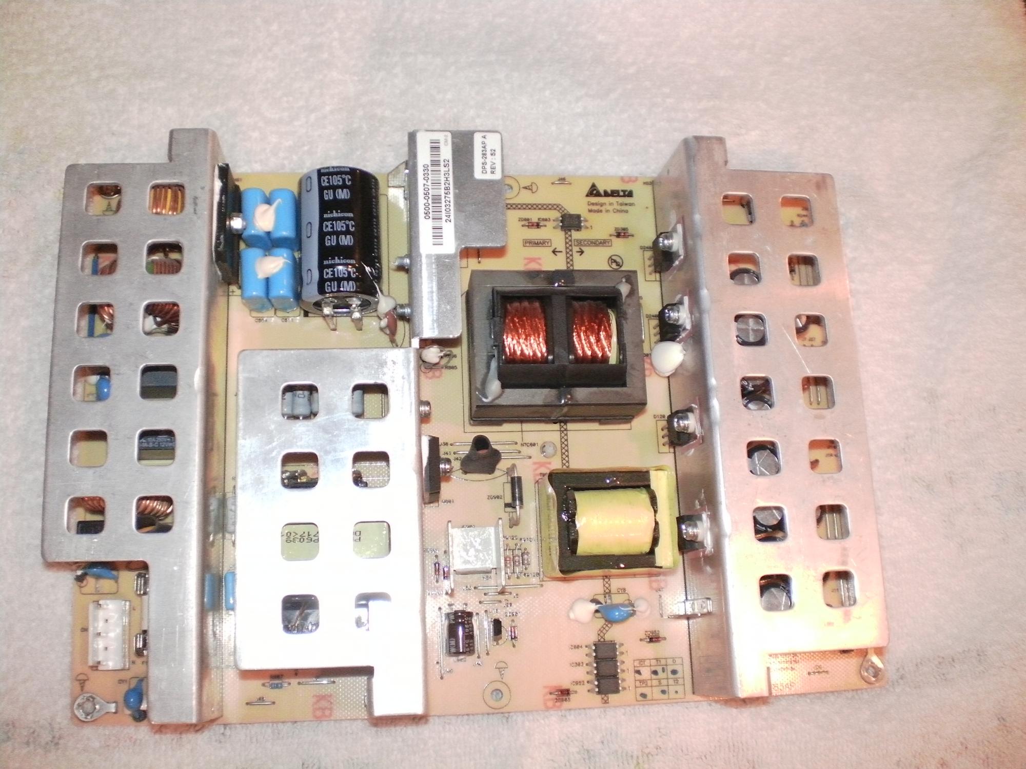

            Here are some pics of the power board. Let me know if i should re-take some, or different angles... Thanks for the help

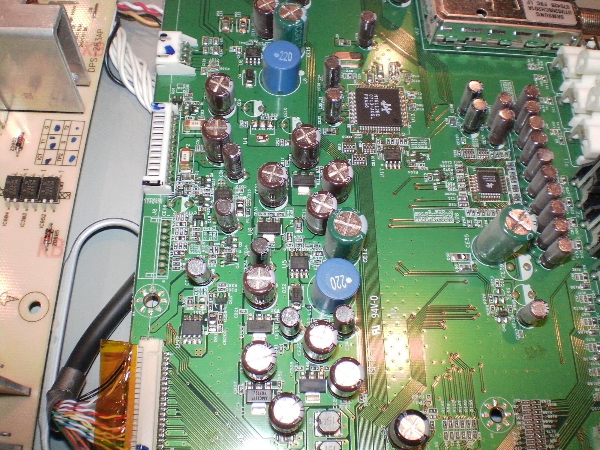

              Those are excellent focused pics. Now we also need pics of the main/logic board. This is the board where your HDMI, component cables, etc plug into.
              PS. This is one of the few TV/models to use name brand japanese quality caps on the power board (Nichicon, United Chemi-con, and Rubycon). Having said that, I have seen the same United Chemi-con cap bloated KY bloat underneath the heatsink by the connector) at least twice in other threads.

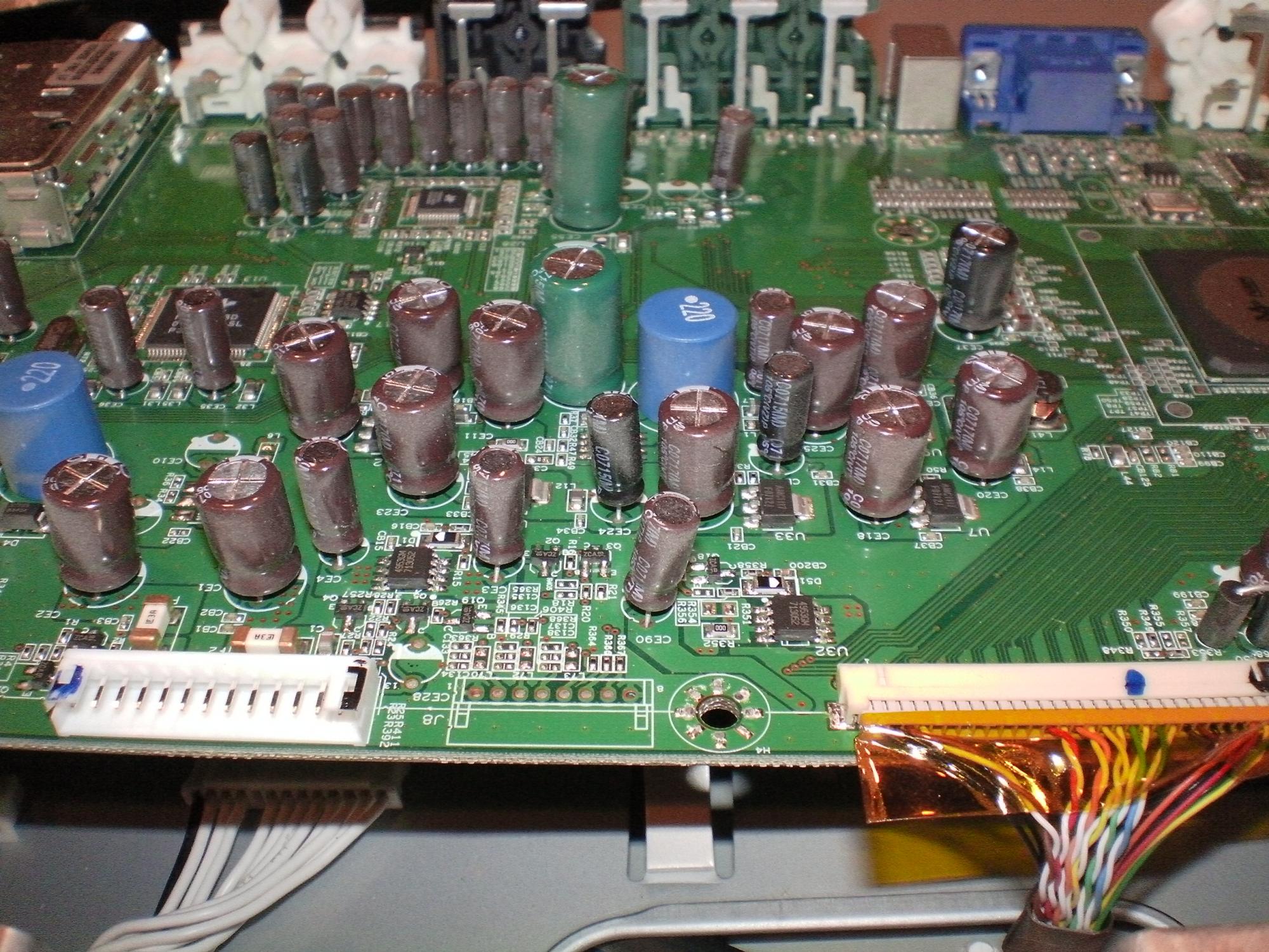

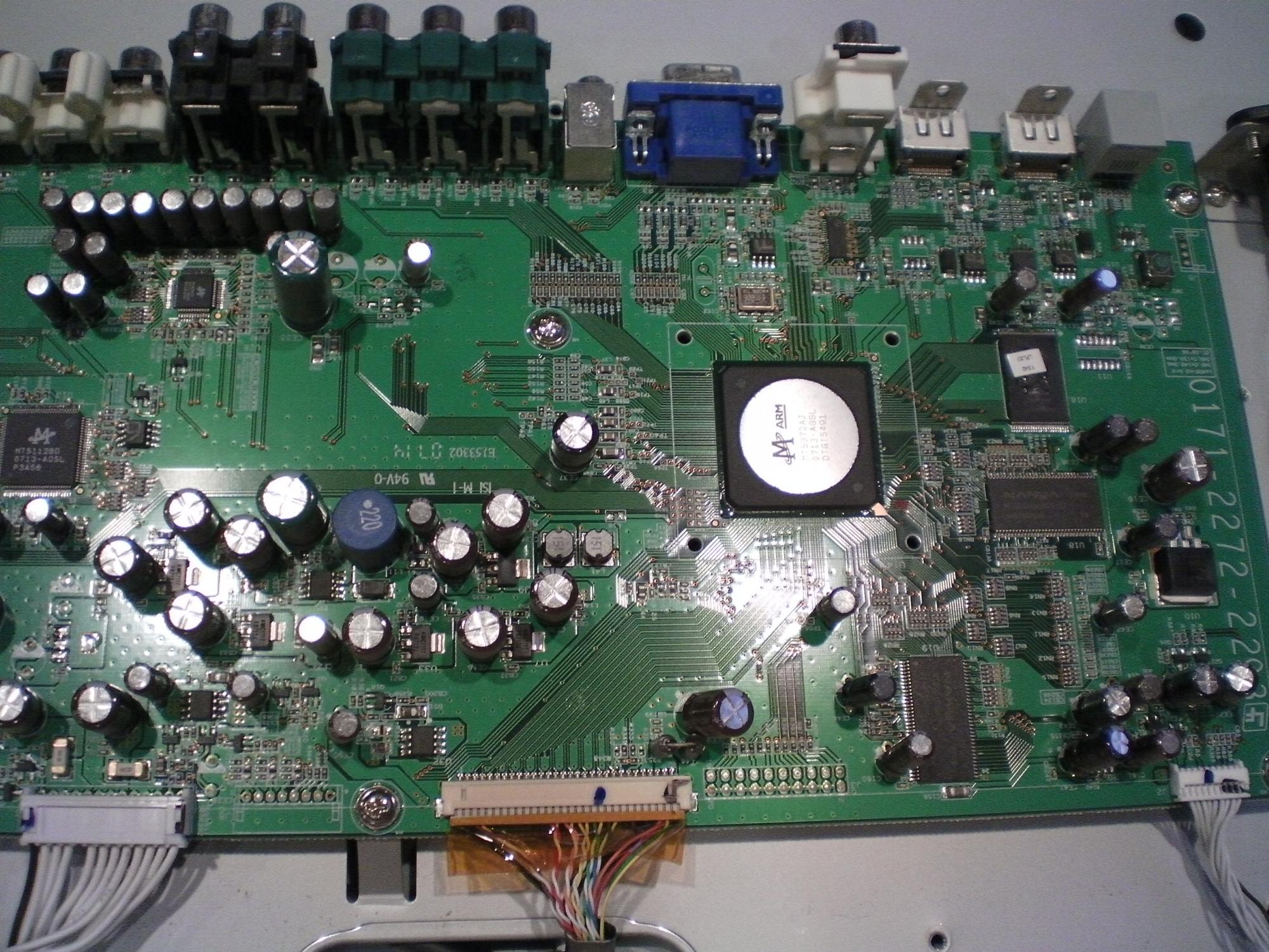

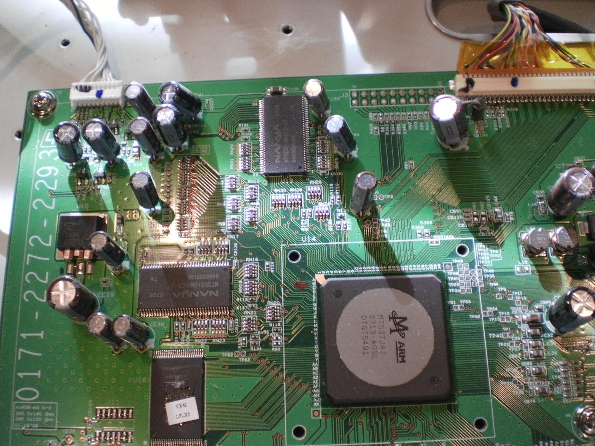

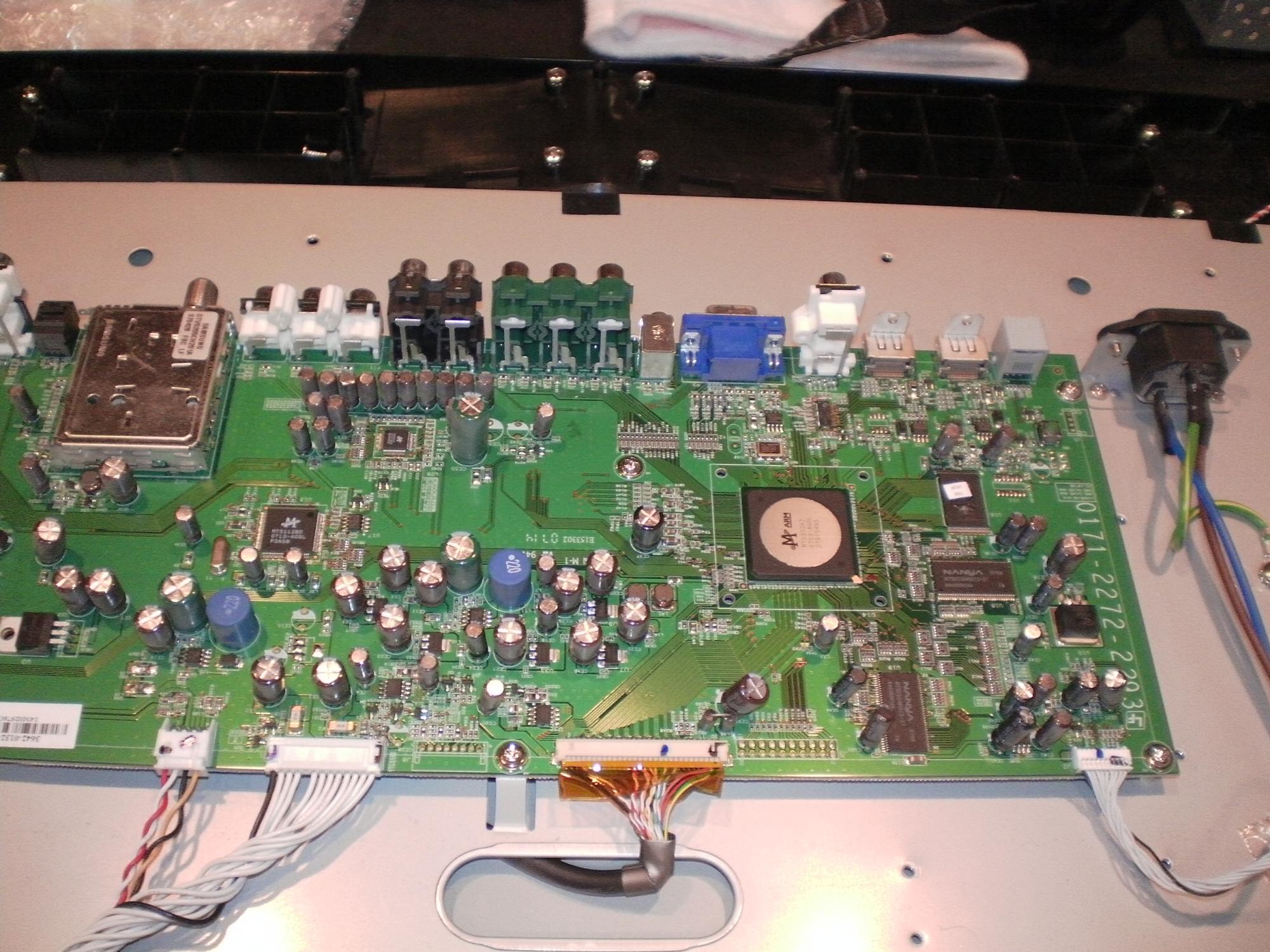

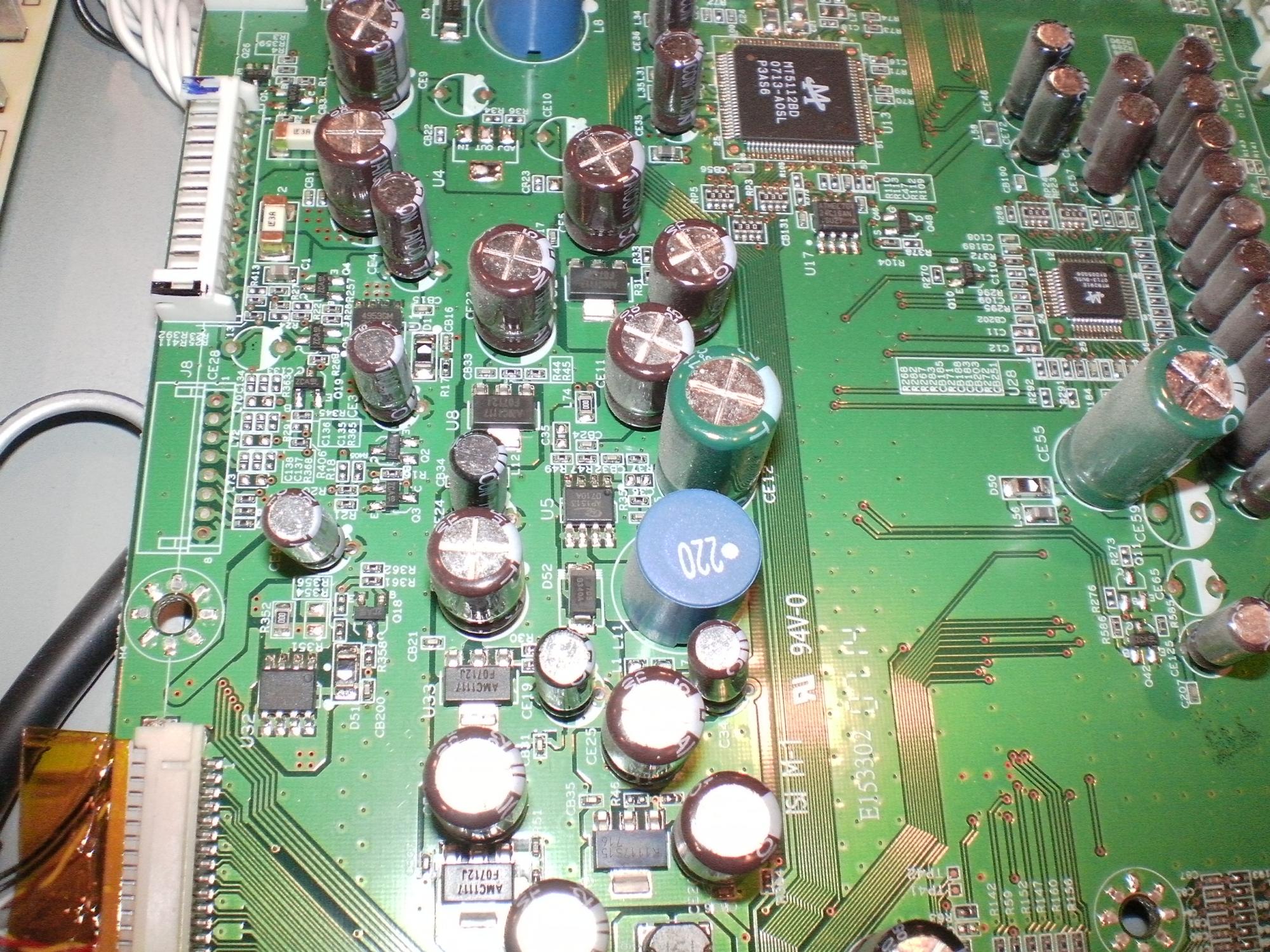

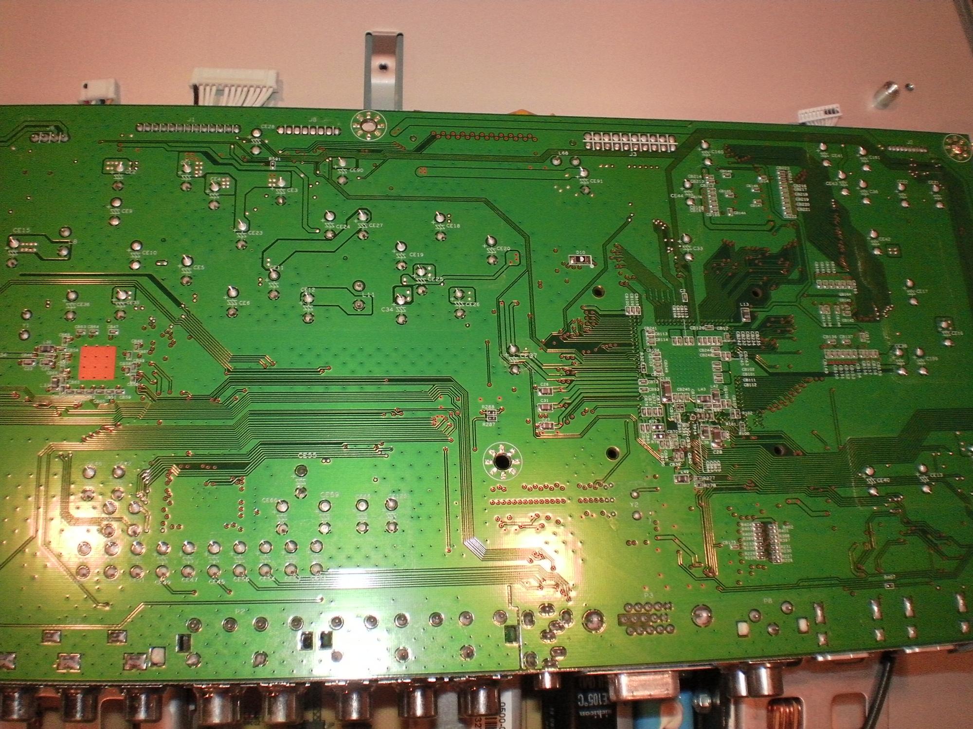

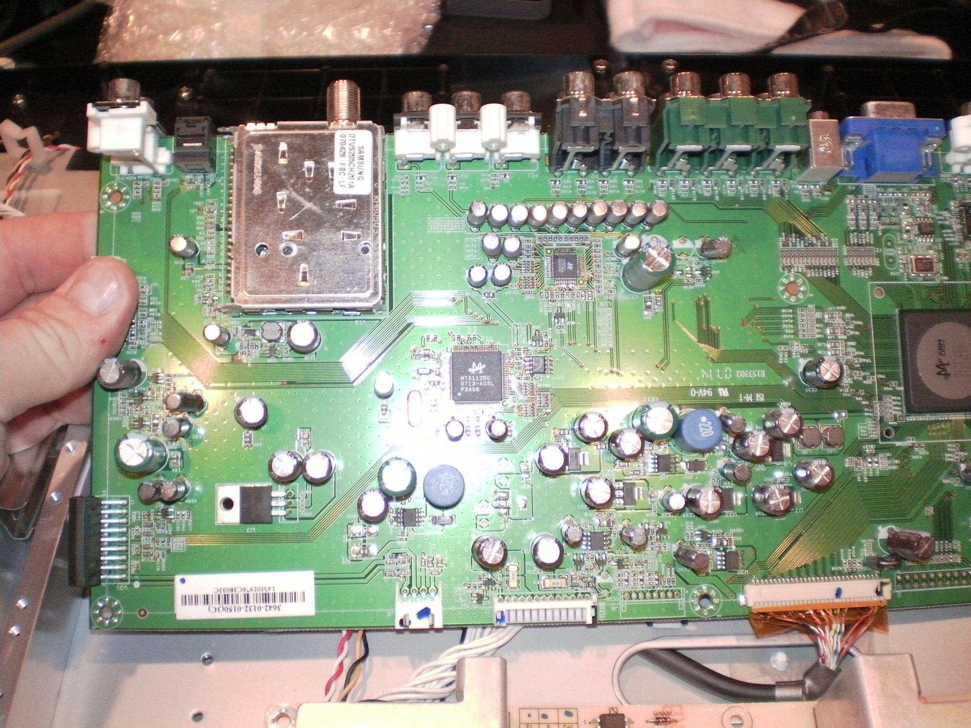

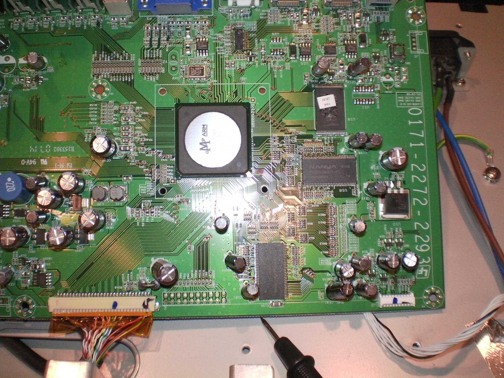

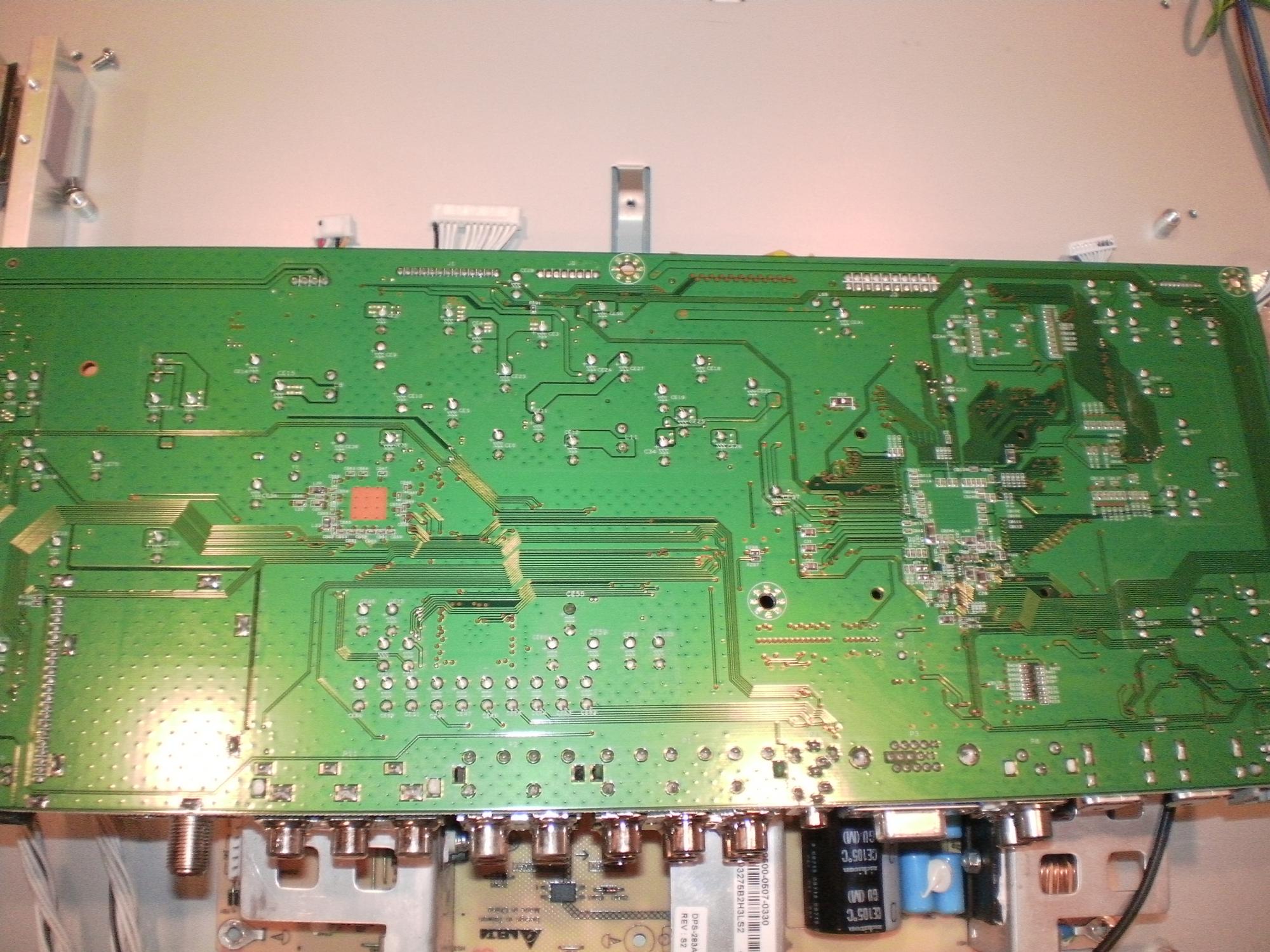

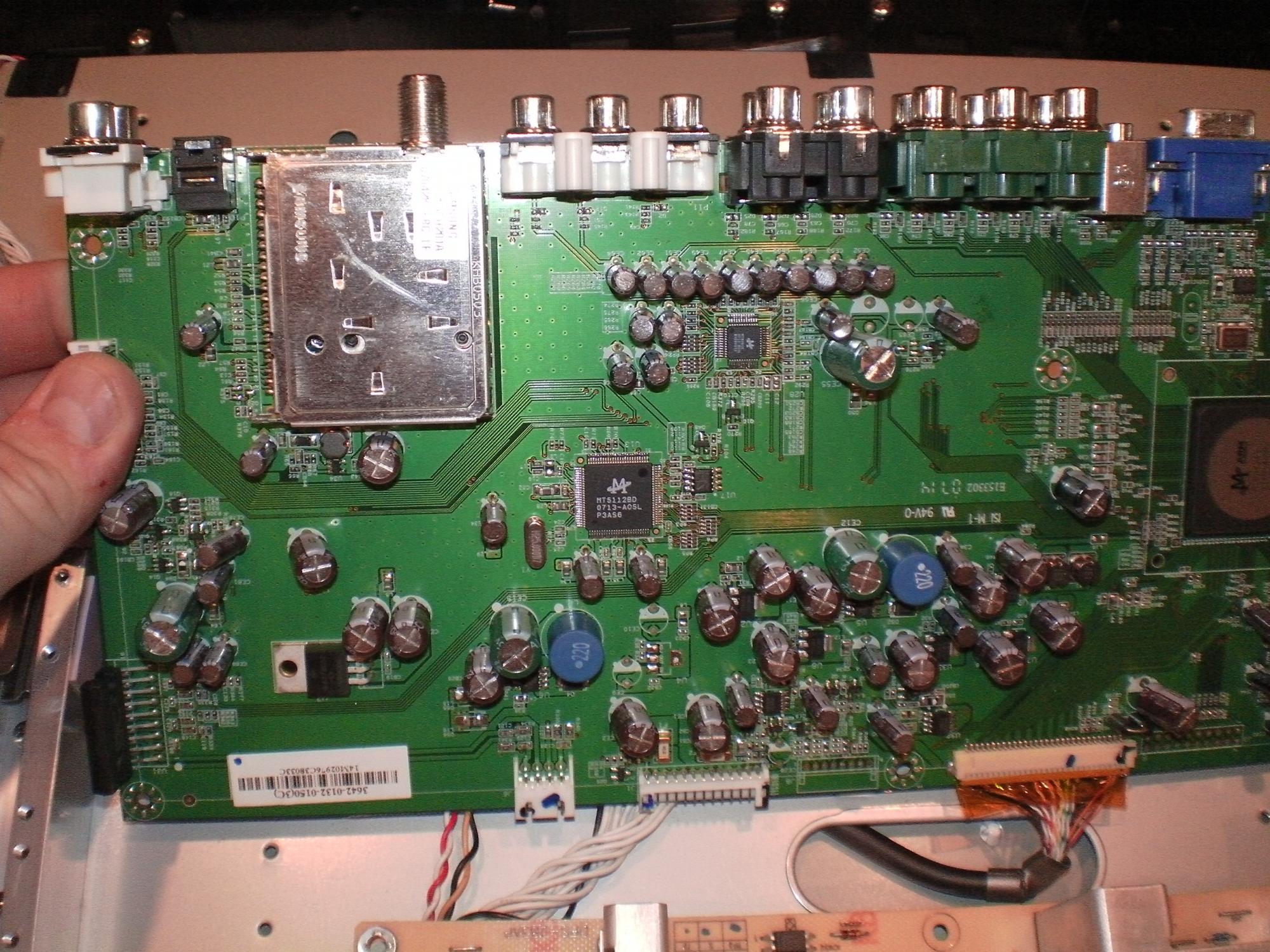

                Here is the main board, bottom and top. I see U33, remind me how to check with multimeter, I am a novice with it, but have tested continuity and volts, but how to check this U33?
                Thanks again for any assist\

                • retiredcaps
                  • Apr 2010
                  • 9271

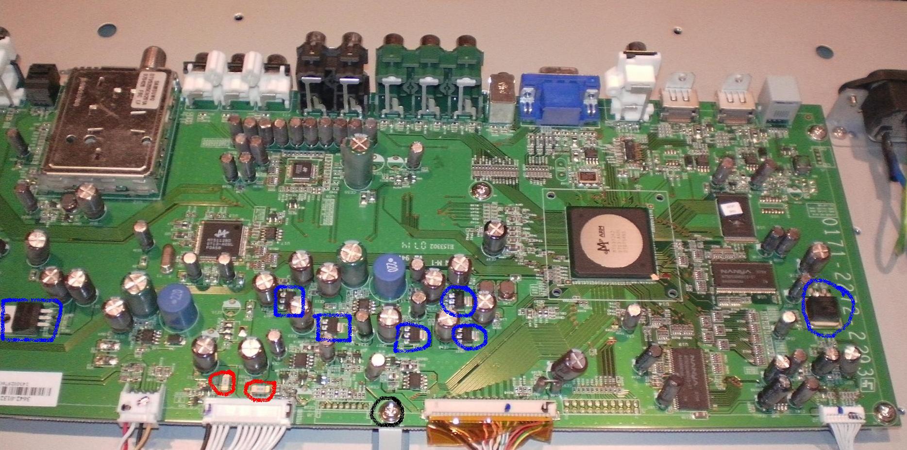

                  In the picture below,
                  1) the ground screw circled in black is where your black probe will go. For all voltage measurements, this will be your ground.
                  2) put your multimeter to 20V DC if it is manual range.
                  3) With power on, lcd plugged in, and boards connected, you are going to measure all the components circled in blue.
                  4) The fat tab will be "up" or "north". The left most pin will be pin 1 with respect to "up". Number the pins 1, 2, and 3 (ignore numbering the fat tab).
                  5) With your black probe on the ground screw (see #1), put your red probe on each voltage regulator starting with pin 1, then 2, and finally 3.
                  6) Record the pcb designation, part number, and pin voltages. For example, we want to see
                  U33
                  part number AS1117-33
                  pin 1 = 0
                  pin 2 = 3.3
                  pin 3 = 5.0
                  7) Power off and unplug lcd. Wait 3 minutes. Then put your multimeter to 200 ohms and measure the resistance of the 2 fuses circled in red. If they are good, both some measure less than 1.0 ohms.

                    tried all of the tabs you suggested and nothing all zero. Then I unplugged and tried the 2 fuses and only the far left one (vertical) registered (.9). The right one (horizontal) 0. What ya think?
                      "0" as in "OL" or "1" on left hand side? Same reading when your probes are not touching?
                      • windfreik
                        • Sep 2011
                        • 18
                        it shows a 1 on the left hand side.... Same as when probes are not touching on that horizontal fuse.
                          So, that fuse has failed. You can replace it and if it blows again you will need to locate the fault on the board (or replace the entire board). Those fuses tend to fail randomly, without apparent cause.
                          Are there any markings on the fuse?
