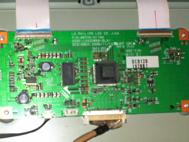

    Originally posted by sienoki
    this is best pic at mo
    heres another
      Re: LG 42LC46 problem
      I see at least one regulator on the board.
      Get out your multimeter. Set it to 20VDC. Place the black probe on the metal chassis; for example, a part of the metal frame like a spare screw hole. Then, turn the TV on (and make sure the picture is good.) Measure the voltage on each pin (using the red probe) - for the middle pin, measure the tab as they are connected to each other and it's easier to measure, and report the readings. Then, wait for the picture to go bad, and measure again.
      Use a loupe to read the part number and report that back.
        heres another
        the regulator markings are rt9164a..15pg9fr0z
          Datasheet: http://pdf1.alldatasheet.com/datashe...K/RT9164A.html
          "15" indicates 1.5V output, so we should see 1.5V on one pin.
            the middle leg is1.49
            the left 1 is 0.00
            the right 1 is 3.25
              the left 1 is 0.00
              the right 1 is 3.25
              That's fine. Was that during failure or normal operation?
                    no change in them readings after picture gone
                    Okay so the regulator is fine.
                    Next step:
                    - turn TV off at wall
                    - disconnect left ribbon connector (for left side of screen)
                    - turn back on you should have picture on right but not on left (left hand might be random noise, or just white or black.)
                    - wait 10 mins does problem occur?
                    - turn back off, plug left in and repeat with right.

                      with left ribbon off left is white and right no picture just flickering dark grey screen vice versa
                        #31
                        Strange, never seen that behaviour before, okay that means my test there won't work. (Some t-cons work with half the display, due to marginal components...)
                        Next test is to leave the set on with ribbons connected until problem occurs, then unplug the LVDS cable, leave T-con for 30 seconds, and plug the LVDS back in, seeing if you get a picture.
                        Also, do you get sound during failure?

                                    Done 1st test again with replacement t-con just same results so i tried the original t-con board..left ribbon in place i could see some of the picture but the background was white not greyed out like the replacement?right ribbon in place it was trying for a picture but not white background..weird
                                    I wont beable to get my hands on any advanced testing equipment so it looks like im stuck with a dead set
