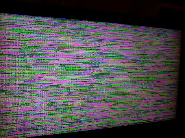

    Hi guys n gals..im a newbie here so a big hello n happy new year.
    I bought this model lcd tv from a friend ..it was completely dead..after opening it up there was 4 10v 2200uf caps bulged..so i replaced them with rubycon same values.It powered up fine and worked ok for 10mins then the picture would go but sound remains..the backlights would also stay on.
    If i take the t-con board out then turn on i get the same result no picture only sound..could replacing the t-con board fix my issue..any help in my matter would be greatfully received..thx

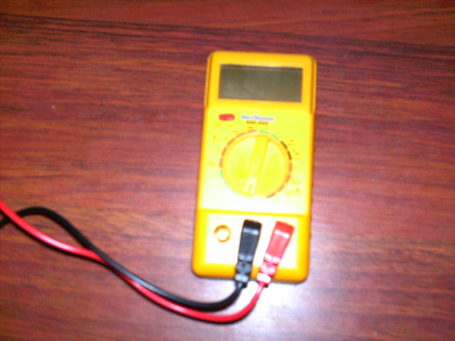

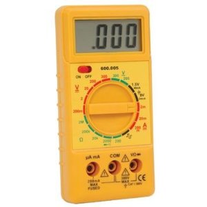

          I bought a cap..diode tester from farnells on clearance shelf but dosent even work..i have a standard multimeter..thx

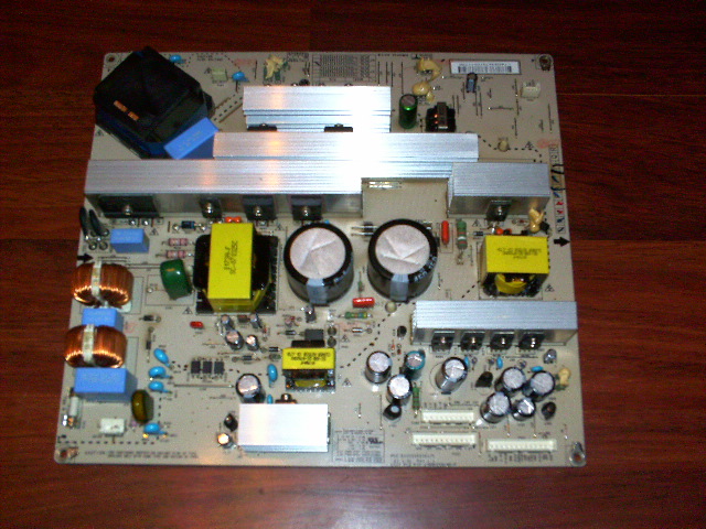

            Hi..i have since replaced all caps on my psu..after 10mins still same so i then left it on for 30mins and picture is like photo..if i buy this t-con card and still same probs could some kind and patient soul walk me through how to use my multimeter and where to start as i am totally new to all this..thx

              Can you list the ranges/settings your meter has - does it have a 20V or 40V range?

                    Re: LG 42LC46 problem
                    Okay, those caps are fine.
                    Set the multimeter to the 20V range and measure all the outputs on the power supply.

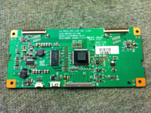

                        The replacement t-con arrived today..installed it but still no joy

                        Now its time to start with my multimeter..on my psu there are 3 pin outs together..2 with the block wires going to the main board and 1 not in use..is that the test pin out..if it is i took readings when the unit is powered on(scary)as i dont to blow myself up..anyways readings are as followed
                        3.4v=3.47
                        GND=0.00
                        6.5=6.33
                        GND=0.00
                        12v=12.25
                        GND=0.00

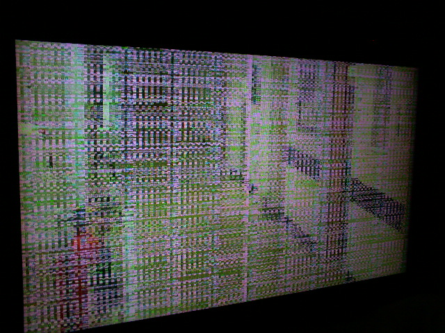

                            this is the picture after 20mins

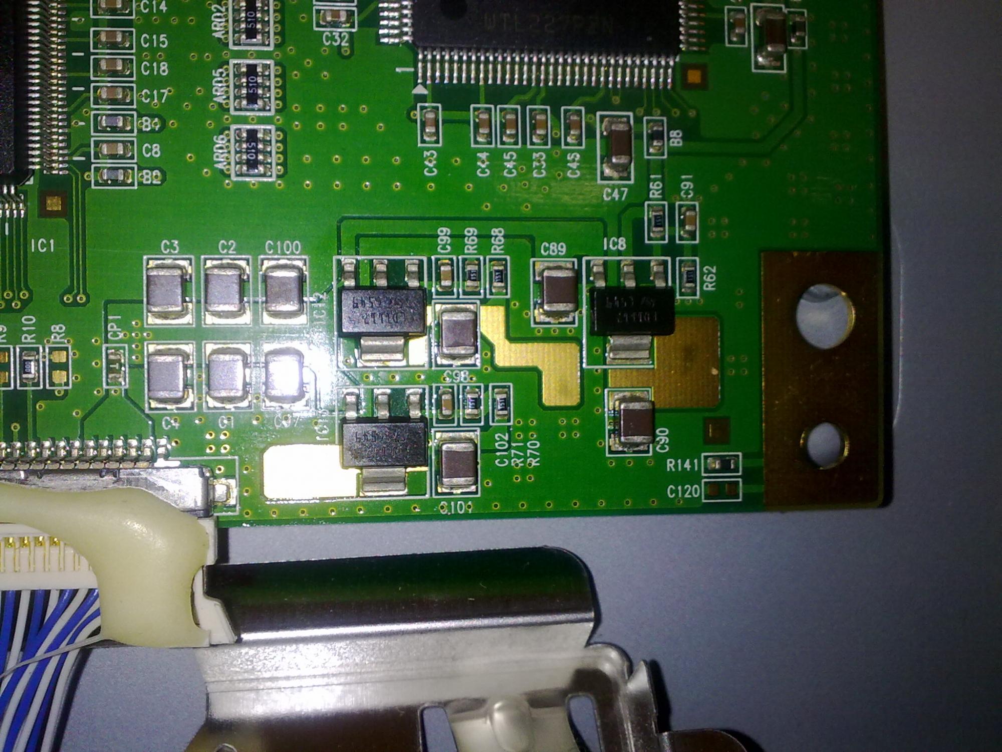

                                Post a close up picture of the T-con... you may need to remove the shield.
                                I have a Samsung that has a strange picture occasionally, caused by a dodgy LDO (voltage regulator.)

                                    Even a crap picture might be enough to identify regulators on the T-con...
                                    Here are what regulators look like. The three leg + large tab black devices are LDOs. In this set they are adjustable regulators, all of which are set to 2.5V.
                                    The bottom one on this T-con failed, causing various colour lines on the screen + no visible image.
