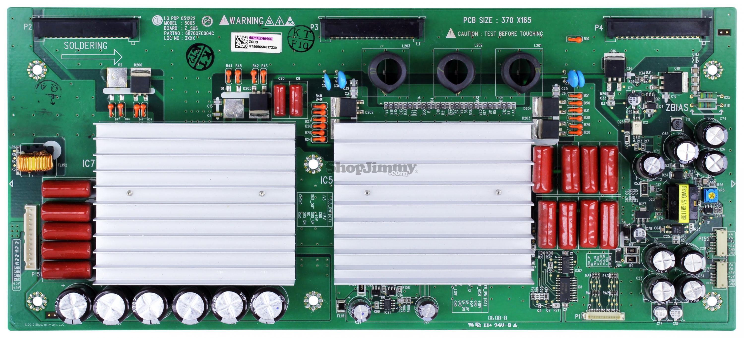

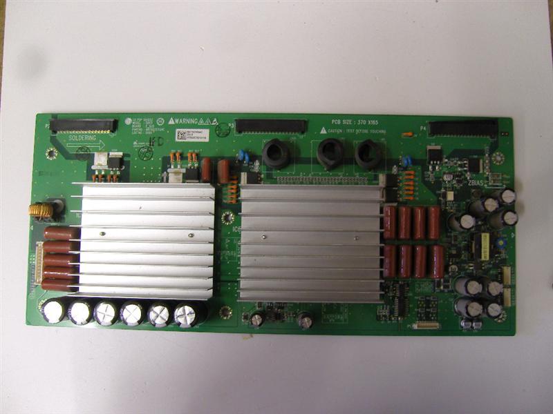

              Dont have a pic of mine but here is the board that is in the tv

                All the models it can fit. Apparently there are more from what Im reading (Zenith, HP, Sony, Maxent, Polaroid etc). 6871QZH044A or 6870QZC004A is the part number.

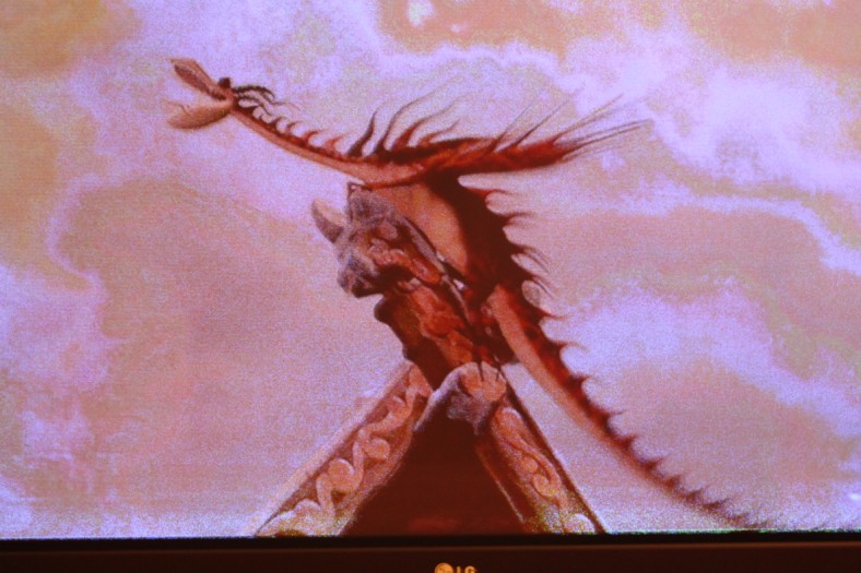

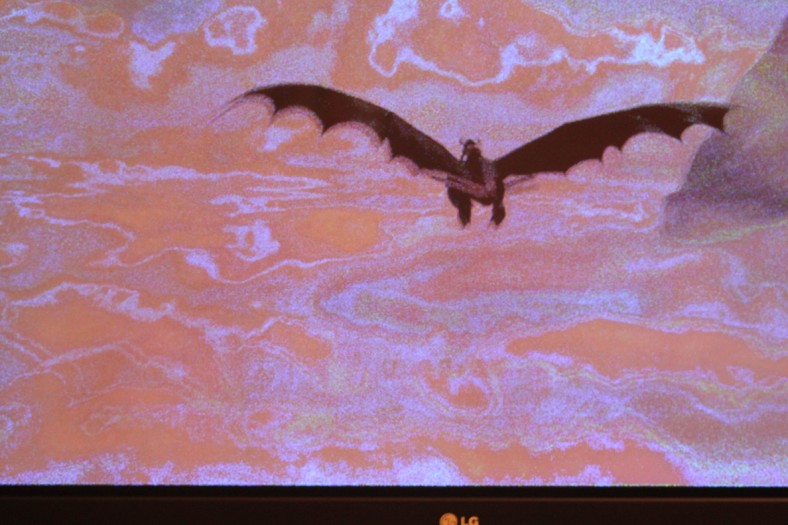

                  I have a lg plasma TV 50pc3d, issue: discolored, dark display. Picture's

                      It'll be the IPM on that cold heatsink of the z-sus. I Think the ERC IPM is the bottom one if I recall, and a fairly common failure on a set at around 15-20 thousand hours use.
                      They can fail Open circuit (as in your case probably) as well as short, but the short usually ends up making the set dead or blowing the board fuse....
