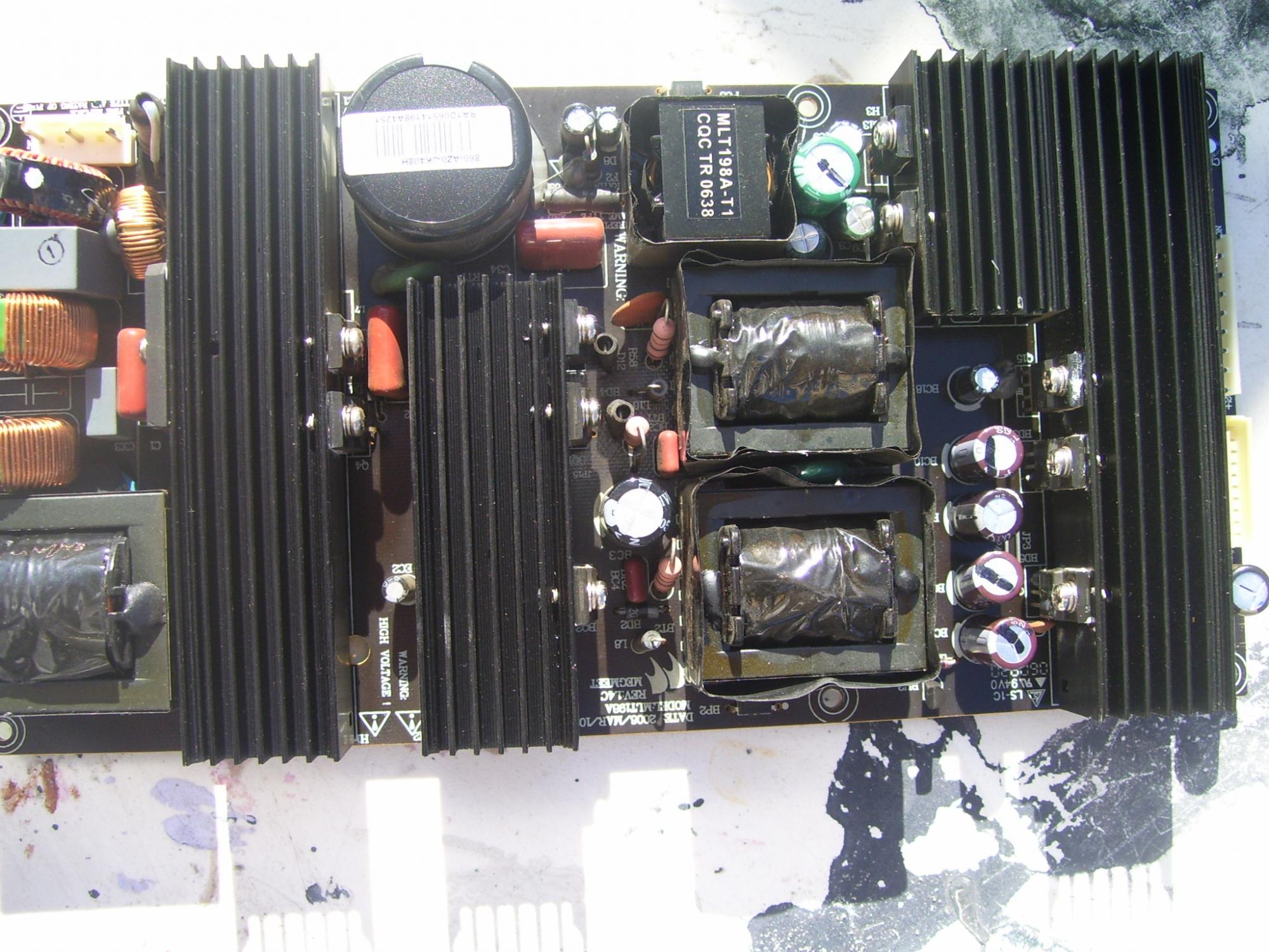

    Hello guys,
    I got a ps model MLT198a with no 24 volt only get 1.82v , sb is good @ 5v and 12v i get 11.88v any ideas on the 24v?

    This appears to have two regulated sections of the main supply. The obvious conclusion is that one is bad. Since none of the pictures indicate which output is the 24v rail, you are on your own.

      These Megmeet power supplies have never been a favourite of mine.
      Under the secondary heatsinks there is often a capacitor or two. Check if this capacitor is bulged.
      Does the 1.82V appear immediately after switch on, or does it take a while to ramp up?

        Megmeets run flippin' hot and bake the caps dry.
        The best way to start is to replace all the caps.

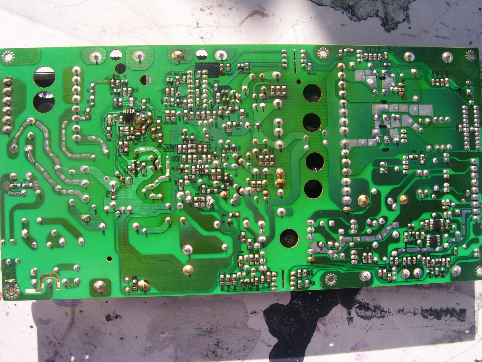

                  Re: 4241-tlx MLT198A power supply
                  look at back side of bc4 orange cap. might have cold solder joint

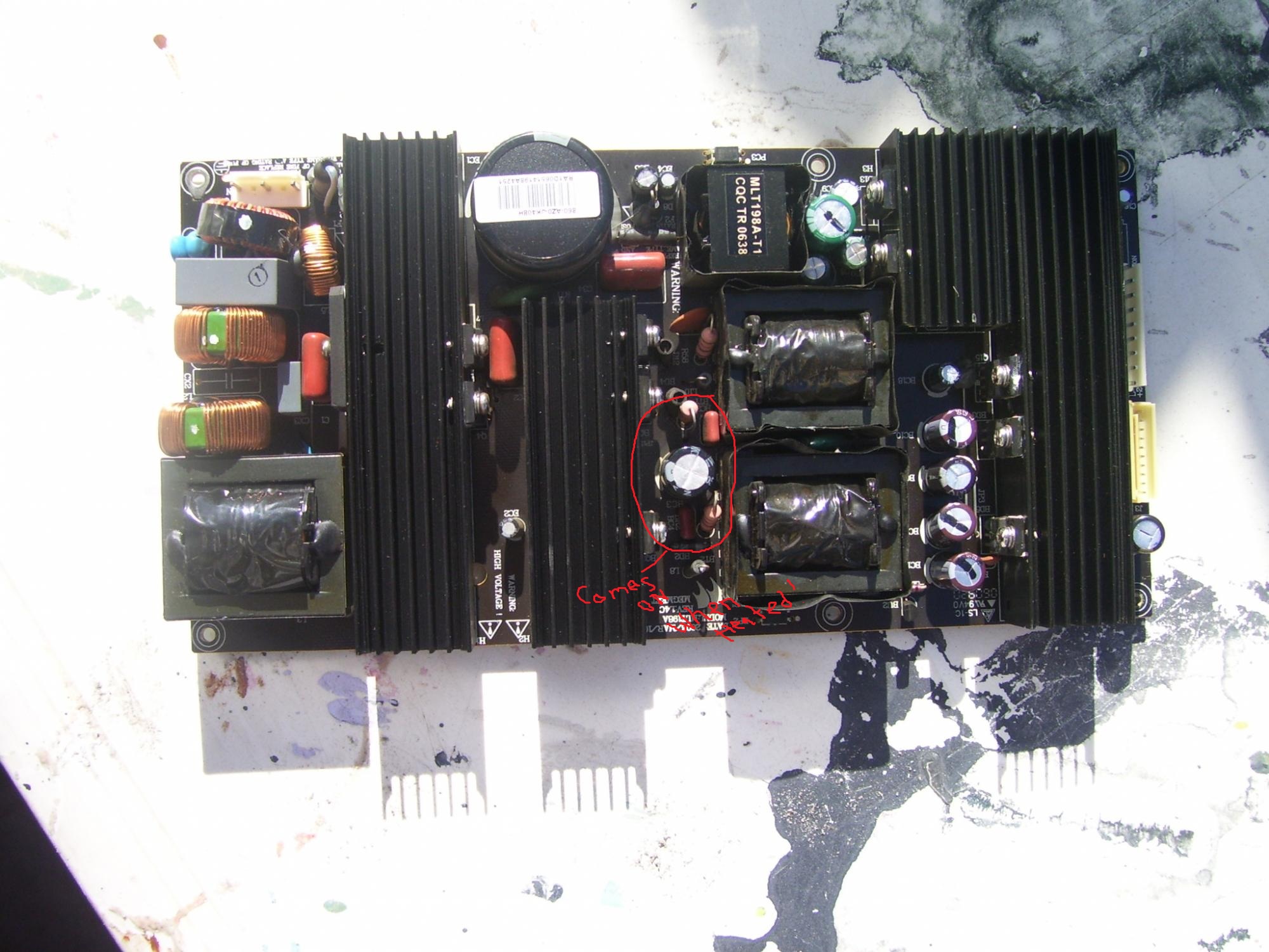

                    i changed the cap 450v 10uf, need help figuring out how to test the other componets but tv works after heating unplug it stays off til heated again,
                      More likely the start up cap that got heat up for the STBY power supply. The ESR will go down so the circuit will function until the ESR goes back up when the cap cool down.
                      There are more caps under the heat sink that will need to be replaced also as shown in my pictures. The 10UF/450V is for the 24VDC SMPS section.
                      Do you have 5VSTBY? or you do not have the 24V?
                      The start up caps are the two on the right side of the STBY transformer, one is EC4:
                      http://s807.photobucket.com/user/bud...ml?sort=3&o=17
                                Fixed 42" Tevion same psu same fault, the fuse between the primary cap and the transistor for the 24v rail was open. Replace it and the caps and the fuse all sorted. Shame the OP was an ass and never updated us ! Hopefully I can help someone !
