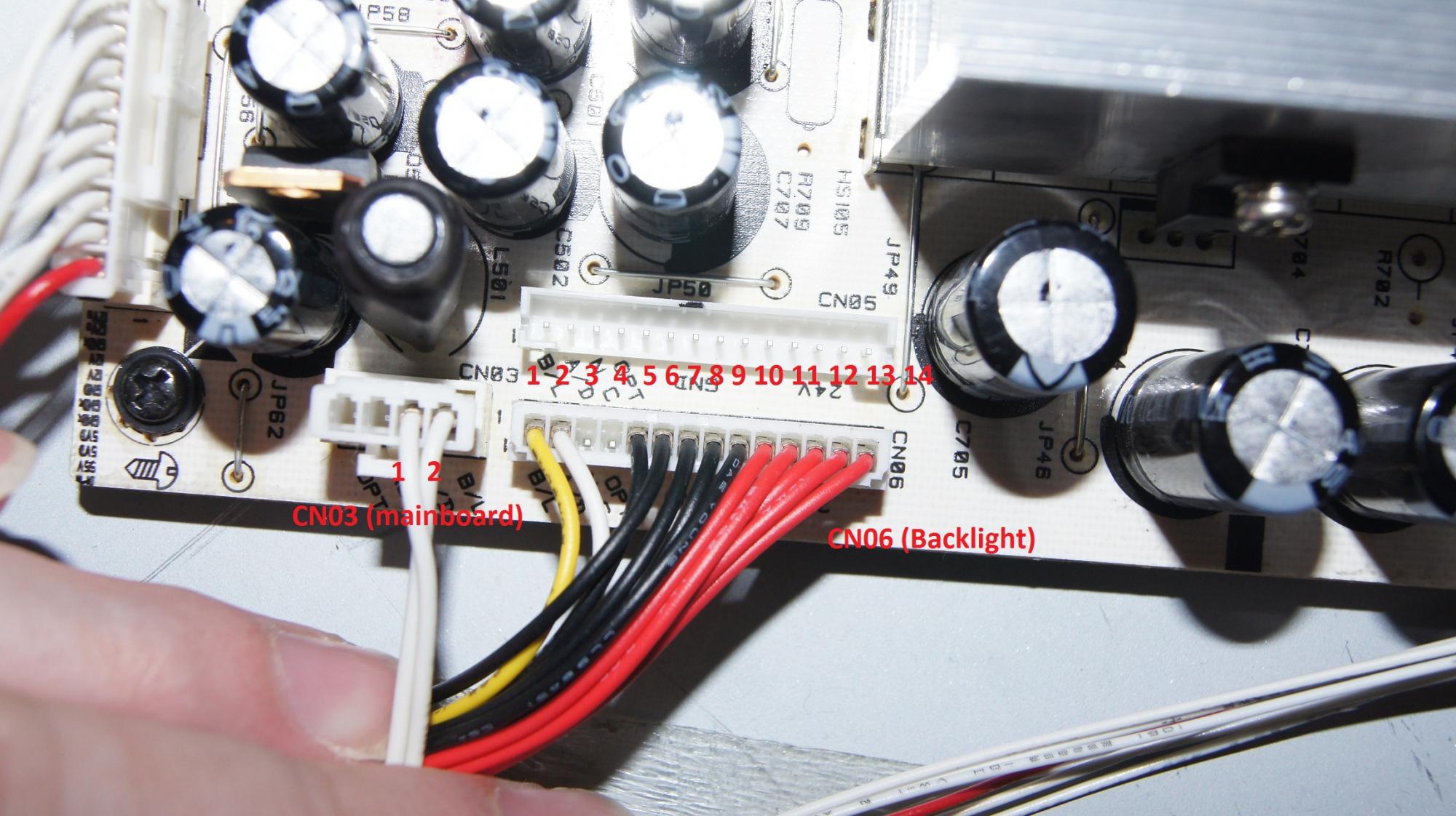

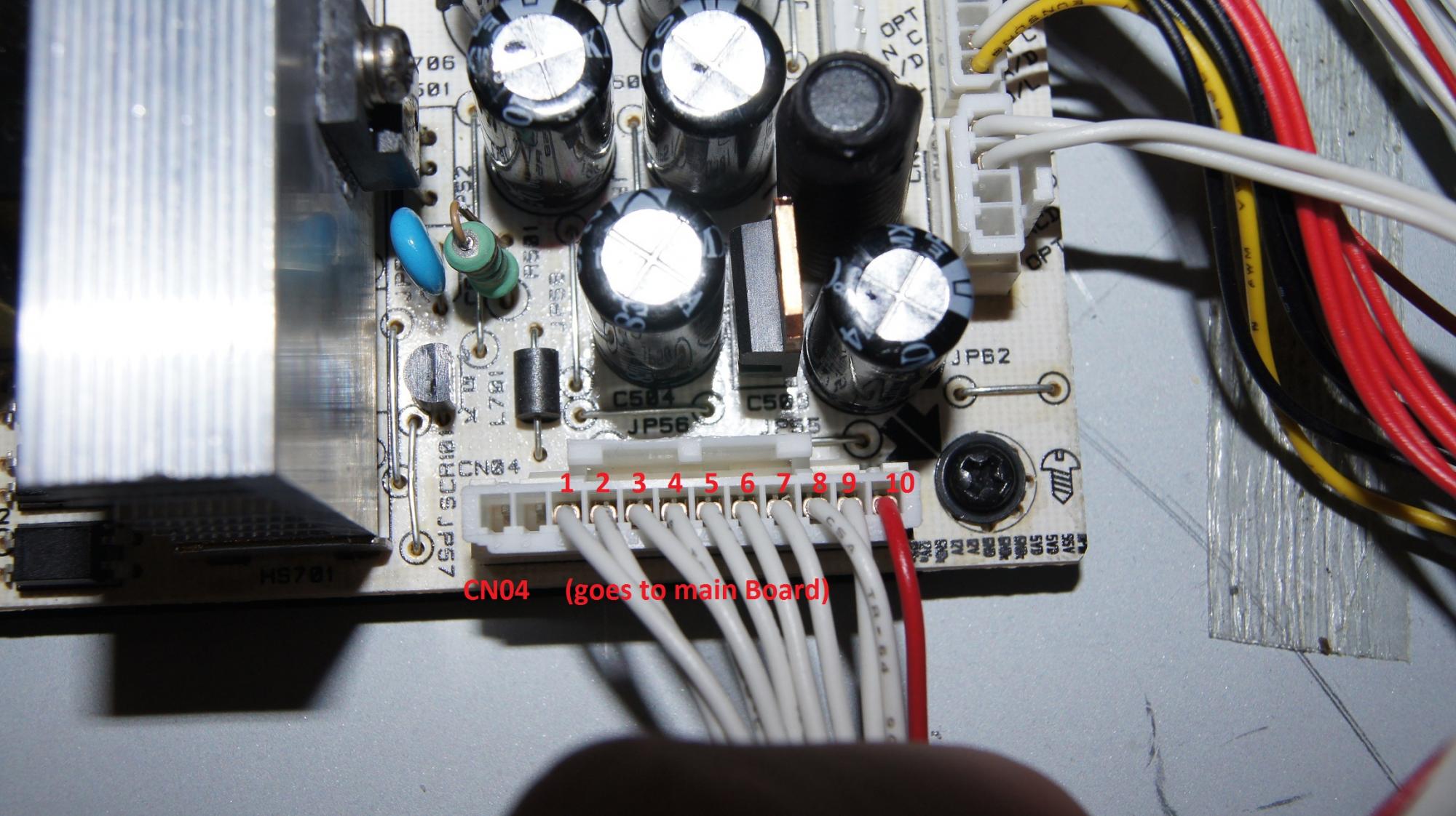

          okay guys sorry re tested everything, found some unusal results to say the least.
          CN04
          1 0
          2 -351.7 mv
          3 -351.7 mv
          4 0
          5 0
          6 0
          7 -349mv
          8 -349mv
          9 5.24 v
          10 2.94v
          However with the power off doing a continuity test and touching a common ground pins 1-8 all show as a ground????
          CN03
          1 4.2mv
          25.2mv
          CN06
          1 7mv
          2 4.2mv
          3 Blank
          4 Blank
          5 gnd
          6 gnd
          7 gnd
          8 gnd
          9 .4mv
          10 .4mv
          11 .4mv
          12 .4mv
          This again is unusal pins 9-12 show as a ground aswell ?
          have uploaded pictures let me know where to go from here guys.
            Re: 42inch Touch Screen wont power on
            Originally posted by epicfatigue View Post
            CN04
            9 5.24 v
            10 2.94v
            We are still getting 5V SB. Pin 10 is power on/off.
            If you hit the power off/on button, see if pin 10 drops to 0.0V. It should change between 0.0V and 2.94V if the main/logic board is working properly.

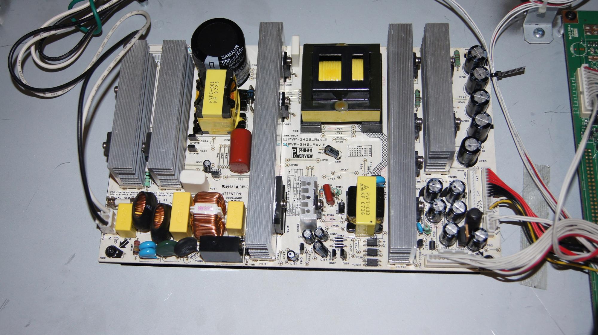

              hey mate here is rear trans testing
              How is this transformer numbered? Please post a close up picture of the back with its numbering.
                I pulled the IC off on the small Heatsinc it is DH18 B DM0465R
                Is this IC101 on the board? When talking about components, please always list where it is on the board via pcb identifier so we know where to look. The more info you give, the less we have to guess and ask for clarification.
                  Sorry guys i did this with the cables pulled out because i thought when the relay clicked it would turn the power off...
                  i redid all the tests and the volts are slightly diffirent
                  CN04
                  1 2.6mv
                  2 5v
                  3 0.53v
                  4 0
                  5 0
                  6 0
                  7 .5v
                  8 .5v
                  9 5.24 v
                  10 4.49v
                  I tested for volatage drop on pin 10 when pushing on off no change voltage stayed solid.

                  CN06
                  1 .5v
                  2 .5v
                  3 Blank
                  4 Blank
                  5 gnd
                  6 gnd
                  7 gnd
                  8 gnd
                  9 -.4mv
                  10 -.4mv
                  11 -.4mv
                  12 -.4mv
                    This is located on the Powersuply IC101 located behind small transformer parallell with the large transformer. inbetween lrage heatsincs.
                      ON the main board i followed the power button switch and it has 4.49 volts and drops to 0v when pressed. However on the opposite side where pin10 (on the power supply) connected to the main board we are seeing no 0v drop.
                      Does this determine there is a fault with the main board? is there a way i can short pin 10 to see if the power supply fires up to indeed confirm this theory?
                      Would you like pictures of the main board?
                        Do you have a 2.2k - 4.7k resistor; or can you acquire one (e.g. from RadioShack)?
                          Hey i live near a Jaycar so i can get anything electrical they stock just about anything using this to short ?
                            Use the standby rail to pull the PSON line to about 5V. The 2.2k-4.7k prevents any damage from potentially excessive voltages (PSON might only want 2-3V), although that would be a very rare possibility I would suggest it anyway.
                            Get a 1/4W (quarter-watt) 5% resistor of any value from 2.2k (2200) to 4.7k (4700) ohms.
