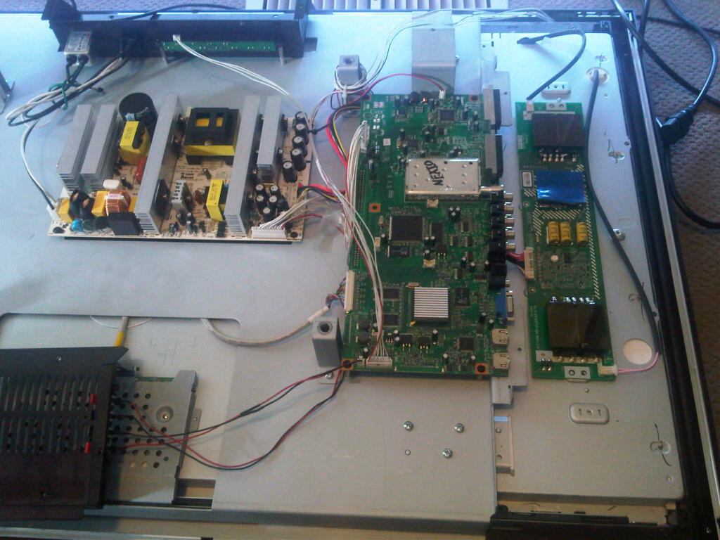

      Sorry for my lack of information just got the tv.
      Here is a little more information.

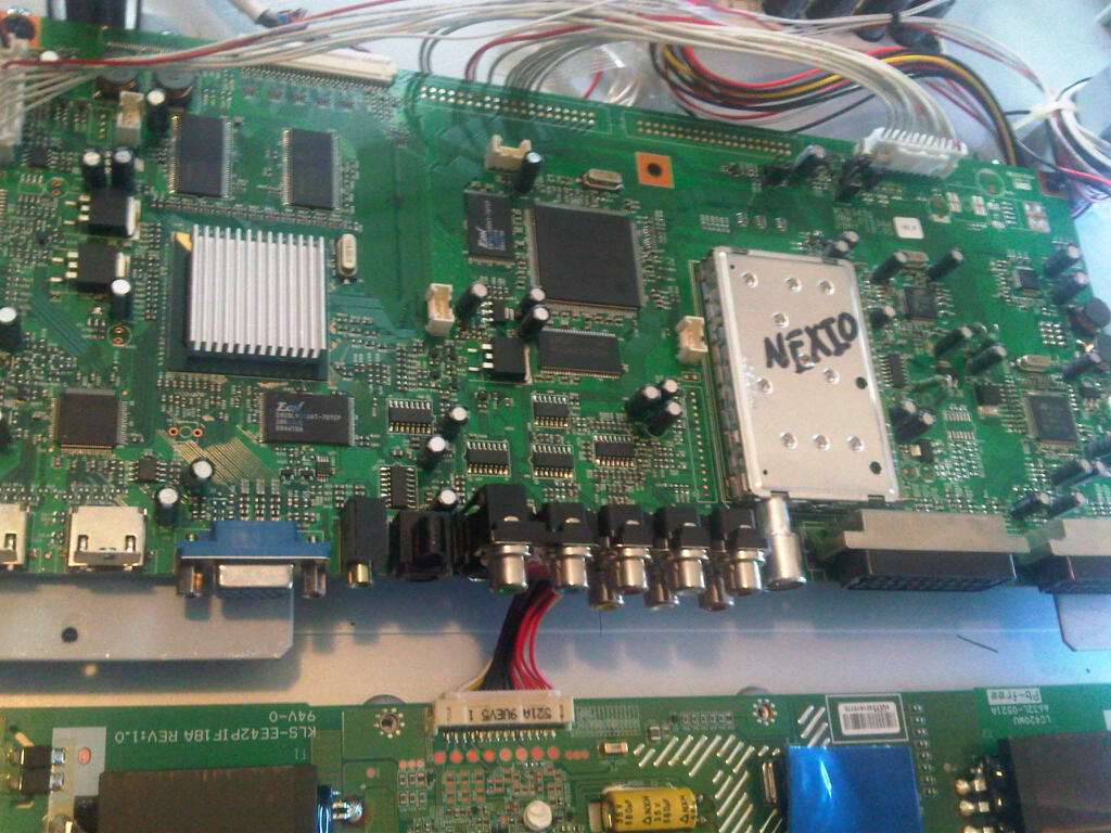

      The unit is 7000 and is just out of warrenty.It is a industrial unit it was used in a show case.
      It is unknown because it is a tv inside a tv.
      My guess is its either a samgsung or an LG.
      As the power suply is only used in those models.
      The tcon card is an LG the power invertor is an lg.
      The main board has fujitsu & sumgsung ics on it and a Thompson TV tuner.
      The tvsceen has been pulled out of its case anD esembled inside a IR touchscreen unit.
      Hence why its so expensive I don't have the recipt because the company I work with gave it to me and upgraded to 80 inch ones. There was 8 of these in the case they all stopped working at the same time.
      My guess is a surge of some kind.

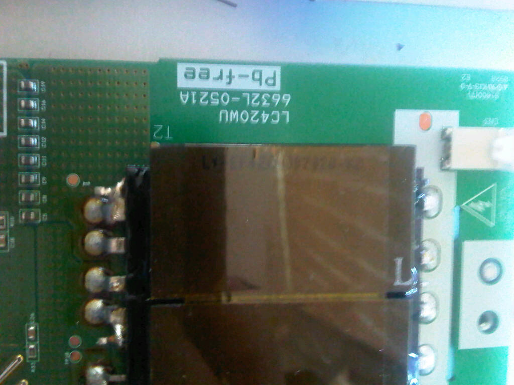

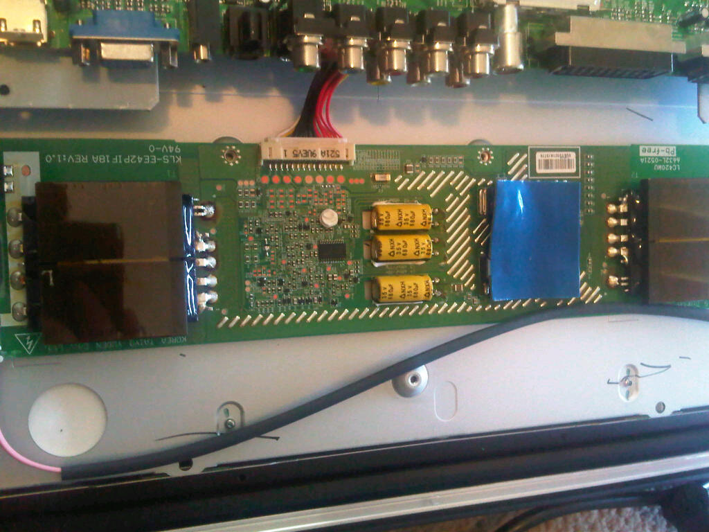

      The power invertor looks like all the solder joints have gotten hot at one stage. Is this a common problem or could it be cased by a faulty component.

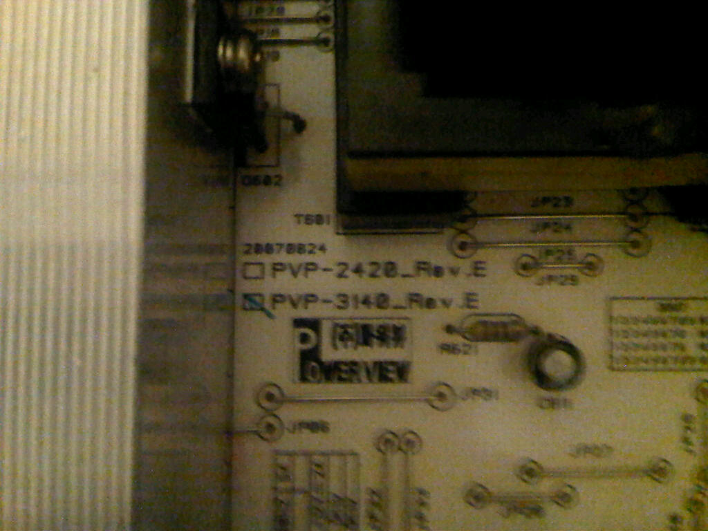

      LG invertor = LC420WU
      Power Supply = PVP-3140
      Mainboard has not identifiable marks on it.

            Is it common for a Powerinvertor to show the discolored solder?
            and if the powersupply tests fine what is gennerally the weaker link the Mainboard or the invertor board? (know this is probebly a unrealistic question)
            • retiredcaps
              • Apr 2010
              • 9271
              Re: 42inch Touch Screen wont power on
              That is probably left over flux from the soldering/manufacturing process. You can probably remove it with iso alcohol and q-tip.

                  Retiredcaps missed one obvious starting point - measure the AC input.
                  The output connectors of the power supply seem too be labeled. A clearer shot of those connectors would be helpful.

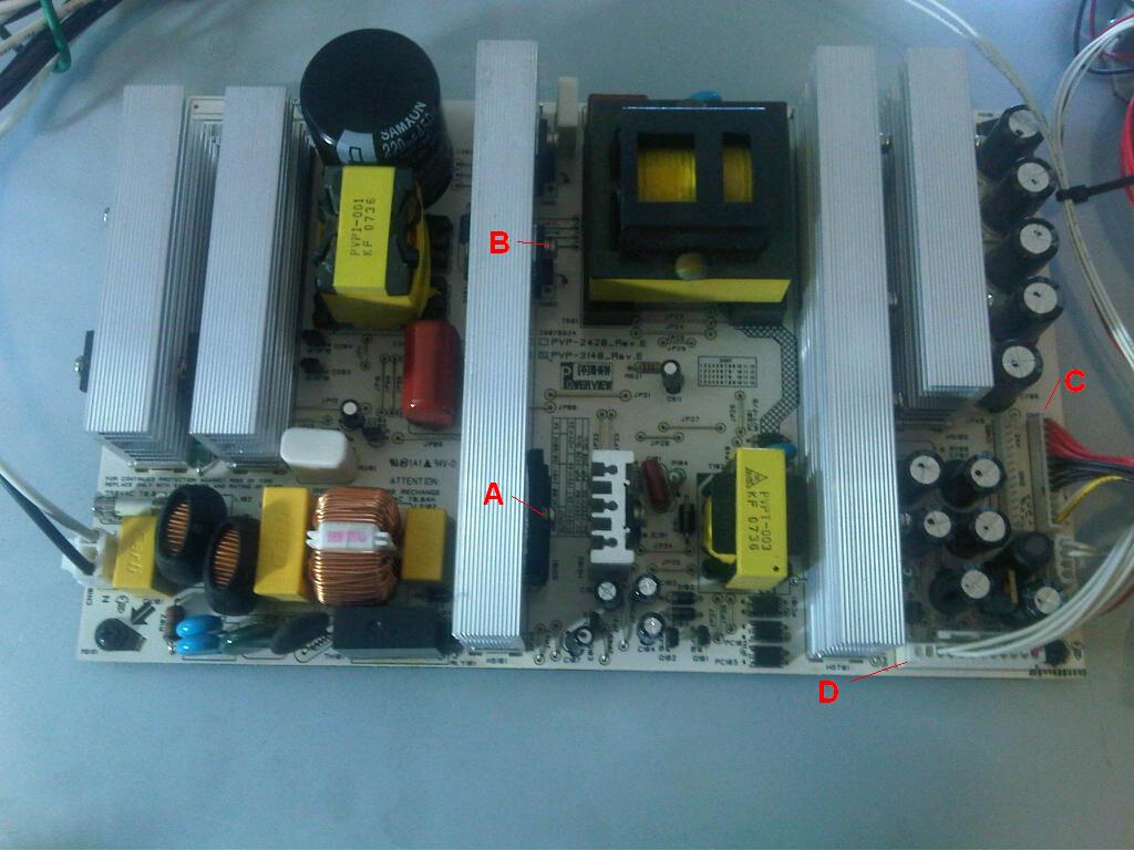

                          Okay Guys finally got this bugger of a multi meter back.
                          Iv been doing a little bit of reading to help me as its been years since i have touched electronics as i moved into a different field.
                          Now first Up I tested the fuse for continuity it checked okay.
                          The only fuse i could fine was the one as the power goes from the wall into the power supply, seems unusual to me shouldn't there be more ?
                          Next Up Redcaps you asked me to measure the bridge rectifier.
                          Now i had a look and i have a couple of questions before doing this.
                          If i remember correctly the bridge rectifier has 4 prongs and is generally attached to the heatsinc ?
                          This is located on the hot side is this the correct one? or can the bridge rectifier be 3 prongs? as there are many of these located on hot and cold side?
                          Marked on IMG 4 Prong(A) 3 Prong (B)
                          (Note there are 1x (A) and 12x(B) )
                          Second when you say measure the power comming out of the DC power supply in the bottom right hand corner do you mean (C) or (D) or both?
                          And do i measure these all from a common ground?
                          • retiredcaps
                            • Apr 2010
                            • 9271
                            I suggest getting an actual Ohms reading. Multimeter vary greatly and beep "continuous" for readings anywhere from < 30 Ohms to < 1800 Ohms. That means if the fuse readings 29 Ohms, it will be continuous. Really crappy multimeters will be continuous if the reading is 1799 Ohms.
                            In my early days, I measured a picofuse at 33 Ohms and thought it was good because it beeped. Now I know a good fuse should measure less than 1.0 Ohms.
                            I like to see people respond, "the fuse measures 0.6 Ohms".
                            Fuses start with the letter "F" on the board. See
                            http://en.wikipedia.org/wiki/Electro...e_designations
                            Fuses come in all shape and sizes so I rely on the "F" to help me spot them.
                            Yes and see the above URL (bridge rectifier is BR or sometimes BD).
                            Yes.
                            That might be your power mosfet. You can also check it for shorts by measuring 1-2, 1-3, and 2-3. Report the Ohms reading.
                            Both C and D. Use the ground screw on the bottom right hand corner for ground.
                            If every pins measures 0.0 V DC, then we need check the hot side.
                            To check the hot side, measure the DC voltage largest capacitor (the Samxon 220uF 450V). Black probe goes on the negative leg of the cap. Red probe goes on the positive leg of the cap. If you are in North America, the DC voltage reading should be around 165 V DC.
                            This is 120 V AC x 1.414 (rectified) = roughly 165 V DC.

                              • epicfatigue
                                • Dec 2011
                                • 68
                                Main Fuse checks = .1 ohms
                                Bridge rectifier
                                1-2 = .916 M
                                1-3 = 3.62 M
                                1-4 = 1.13 M
                                2-3 = 381.1 k
                                2-4 = 4.50 M
                                3-4 = 4.50 M
                                CN06 (C on my diagram)
                                Pin 1 Legand Says 24V - My reading 0
                                Pin 2 Legand Says 24V - My reading 0
                                Pin 3 Legand Says 24V - My reading 0
                                Pin 4 Legand Says 24V - My reading 0
                                Pin 5 Legand Says 24V - My reading 0
                                Pin 6 Ground
                                Pin 7 Ground
                                Pin 8 Ground
                                Pin 9 Ground
                                Pin 10 Ground
                                Pin 11 Blank
                                Pin 12 Blank
                                Pin 13 my reading 0
                                Pin 14 My Reading 0
                                CN04 (D on my diagram)
                                Pin 1 LEgand Power - My reading - 2.947V
                                Pin 2 LEgand GND - My reading - 0
                                Pin 3 LEgand GND - My reading - 0
                                Pin 4 LEgand 5V - My reading - 157.9mV
                                Pin 5 LEgand 5V - My reading - 157.9mV
                                Pin 6 LEgand 5Vs - My reading - 5.23V
                                Pin 7 LEgand GND - My reading - 0
                                Pin 8 LEgand GND - My reading - 0
                                Pin 9 LEgand 12v_C - My reading - 49.4mV
                                Pin 10 LEgand 12v_C - My reading - 49mV
                                Pin 11 LEgand INV_d1 - My reading - 0
                                Pin 12 LEgand unknown - My reading - 0
                                When i measured this i ensured all lead are unpluged except the voltage comming from power socket.
                                When all leads are plugged in a relay clicks in power supply and nothing happens.
                                I looked high and low for another fuse marked F and could not see one.
                                What is my next step something is clearly wrong here
                                • retiredcaps
                                  • Apr 2010
                                  • 9271
                                  CN06 (all the colors) looks like it powers the inverter board. No power means no backlight.
                                  5Vs is your standby which is working.
                                  Pin 1 = power could be working. Some TVs use 0 V and some use > 2 V to signal power on. Let's assume it is working.

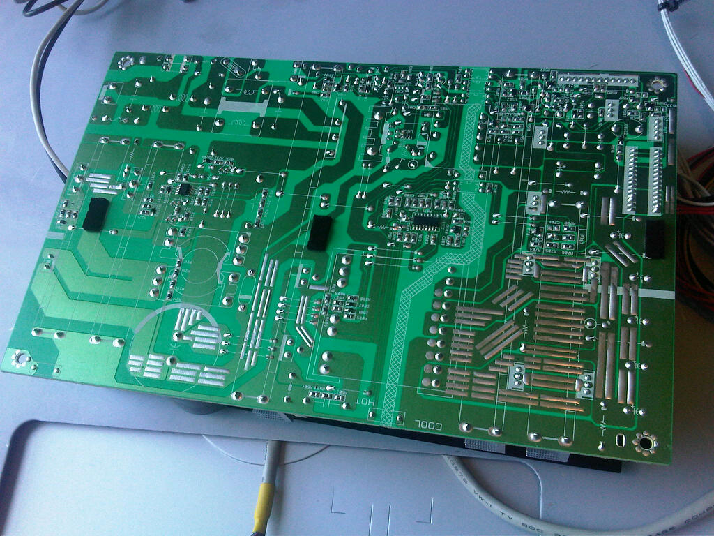

                                  So now the problem is that the SMPS is not starting since we are missing 5, 12, and 24 V DC.
                                  We will need a picture of the backside of the power board. We are looking for a 8 legged IC (or more) that is the smps chip. We need the part number and its datasheet.
                                  This chip could be bad or the startup cap (usually a little one in the range of 22uF to 50uF) is bad.
                                  PS1. There is a small white SMD fuse on the inverter board just next to the yellow colored cap.
                                  PS2. What type of multimeter (I'm curious).

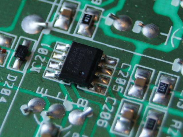

                                    looks like FPG68H (8 could be B) FAN75278 (8 could be B)
                                    • retiredcaps
                                      • Apr 2010
                                      • 9271
                                      1) It is Fan6527b which is a PFC controller.
                                      2) Please post a picture of the entire backside as well.
                                      3) Anymore chips on the back?
                                      4) If there are no more chips on the backside, the SMPS could be integrated with the power mosfet. This would be one of the transistors mounted on a heatsink on the front side.

                                        Hey yes there is another chip on the back, has 16 legs and is located near the cold side of the board.
                                        Ill just get the Camera out and take a close up of it only way i can read the markings.
