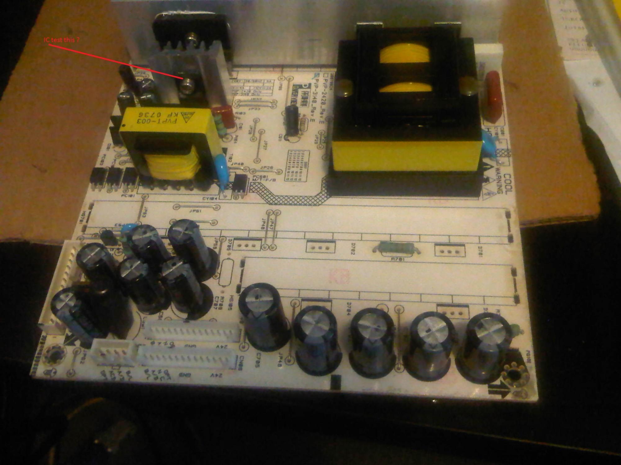

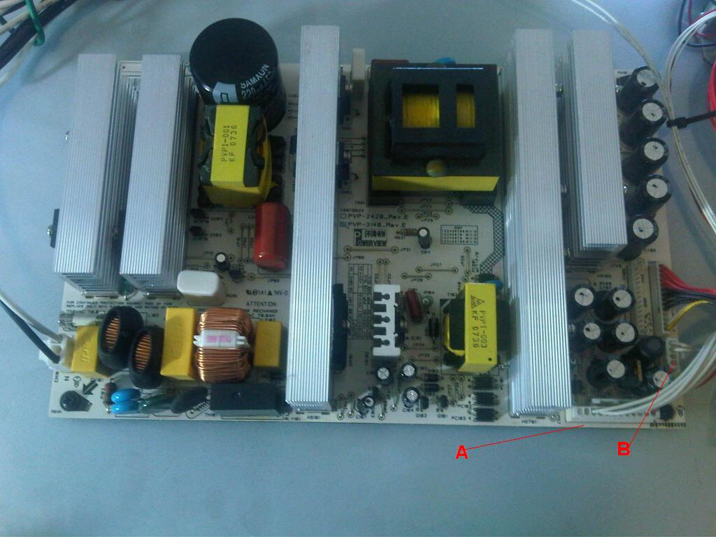

    Re: 42inch Touch Screen wont power on
    Originally posted by tom66
    Okay, let's take a different angle of attack. Replace the diode with the new one. Post a picture of the connector going from the PSU to the main board.
    A+B both go to the main board .
    However if you notice before it there is a small heatsinc this contains a 6pin IC chip is this worth testing?
      Have you tested the voltages out of that connector?

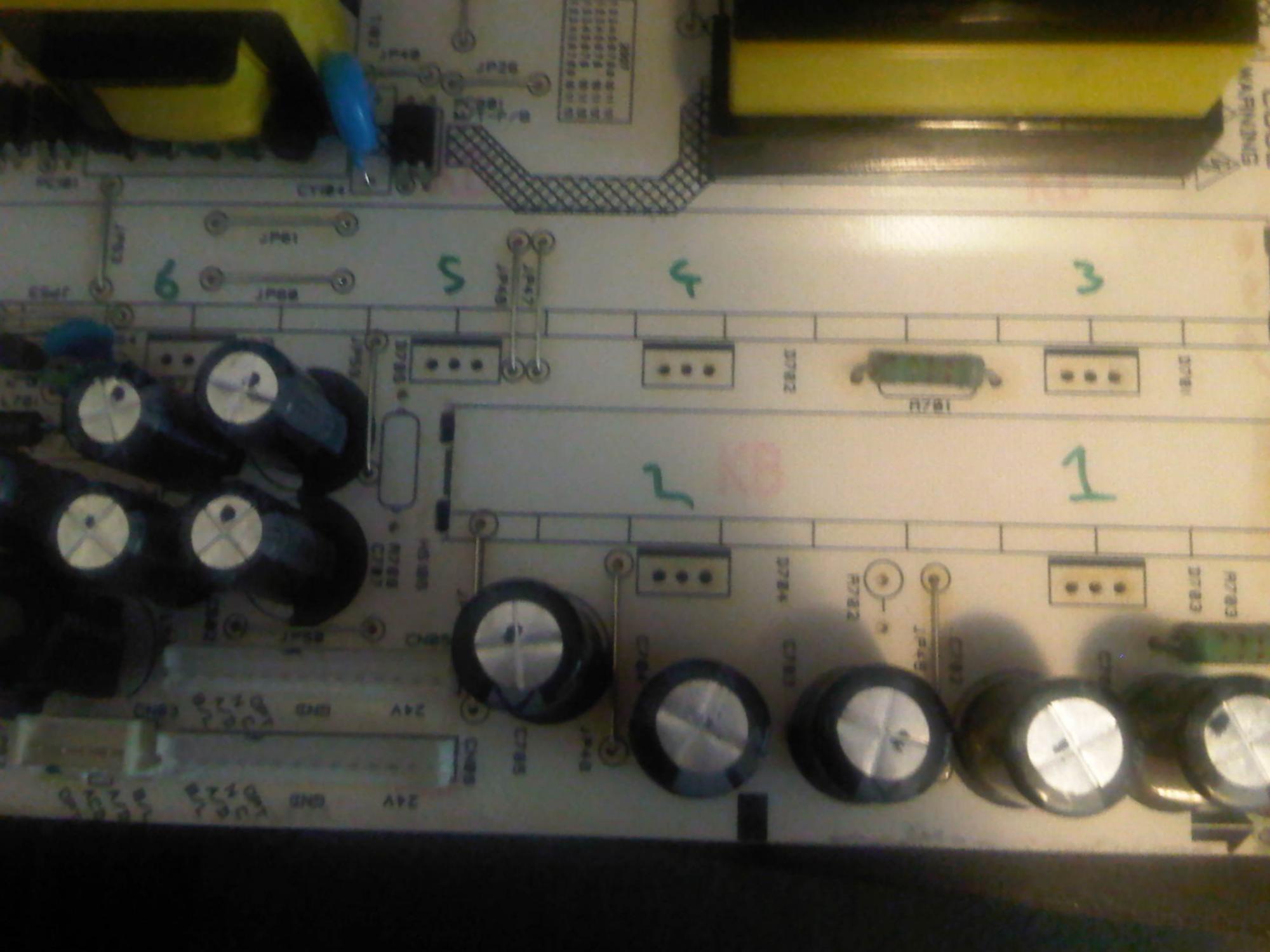

                  Hey all sorry back from holidays and still on them so have some decent time to do testing.
                  All voltages tested the same as they did before from the power points so guessing the diode wasnt the problem.
                  Marked as diagram

                  1-2 .243
                  2-1 ol
                  2-3 ol
                  3-2 .244
                  3-1 ol
                  1-3 ol
                  (2)
                  1-2 .196
                  2-1 ol
                  2-3 ol
                  3-2 .196
                  3-1 ol
                  1-3 ol
                  (3)
                  1-2 .196
                  2-1 ol
                  2-3 ol
                  3-2 .196
                  3-1 ol
                  1-3 ol
                  (4)
                  1-2 .193
                  2-1 ol
                  2-3 ol
                  3-2 .193
                  3-1 ol
                  1-3 ol
                  (5)
                  1-2 .193
                  2-1 ol
                  2-3 ol
                  3-2 .193
                  3-1 ol
                  1-3 ol
                  (6)
                  1-2 .195
                  2-1 ol
                  2-3 ol
                  3-2 .195
                  3-1 ol
                  1-3 ol

                    A) One still unanswered question from post #25.
                    1) See if pin 12 (vcc) is shorted to pin 10 (gnd). Any resistance reading less than 30 ohms suggests it is bad. If yes, I believe that indicates L659 is bad.
                    B) With the new diode in now, redo tests 3 and 4 in post #25.
                    New test.
                    c) On the biggest yellow transformer (the one above the Powerview logo), there are 17 pins on that transformer.
                    Number them however you like, but upload a picture with your numbering scheme so we know what it looks like. With power off and lcd unplugged measure the resistance and report all readings for the following pin combinations.
                    1-2, 1-3, 1-4, etc, etc, 1-16, 1-17
