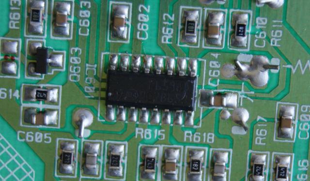

    Chip looks like
    L 6 5 9 (and 2x symbols that look like a light bulb and a capital D)
    (84 inside a circle) 9 0 7 B 6 5 0

            Chip looks like
            L 6 5 9
            May have spoke too soon about not finding the part number. Digikey has this "L6599A"
            https://cdn.badcaps-static.com/pdfs/...d758189067.pdf
            I'll need someone with more experience to confirm, but if it is correct part, then we are interested in measuring pin 12.
            Pin 12 is the vcc. It needs between 10 and 11.4 V DC to turn on. From page 32, it looks like that should come from a 10uF capacitor. That 10uF capacitor could be the one just below the big SMPS and just to the right of the Powerview logo?
            Tests
            1) See if pin 12 (vcc) is shorted to pin 10 (gnd). Any resistance reading less than 30 ohms suggests it is bad. If yes, I believe that indicates L659 is bad.
            2) Since you will have to do board acrobatics to get readings, find a piece of cardboard to rest the board on so you don't accidentally short out anything.
            3) Carefully measure the DC voltage across the 10uF startup cap. Note the voltage and if it is steady of fluctuating. Black probe on negative leg and red probe on positive leg of cap.
            4) Measure the DC voltage on pin 12. Be CAREFUL not to let the probe slip and short out the IC. Again, note the voltage and if it is steady of fluctuating. Use pin 10 for ground.

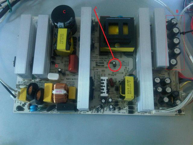

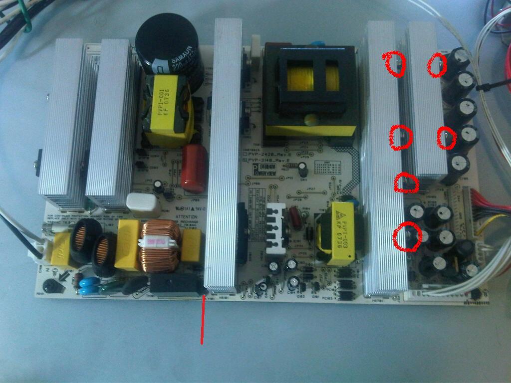

                      Hey so the 4.7uf 50V cap located on Diagram as A recorded 23.7mv
                      Regon B all the caps recorded 0 V
                      Should i measure C and D voltage?
                      Whats my next step i feel as if i am making progress.

                        Re: 42inch Touch Screen wont power on
                        If A is indeed the startup cap, that voltage is way too low.
                        As expected because the SMPS hasn't started.
                        C will be 165 V DC. We know it works because we get 5 V standby. D might be the startup cap for the 5 V SMPS, but I'm not sure. It wouldn't hurt to measure it.
                        Also, waiting for post #25 tests 1 and 4.
                          C= 330v
                          D= 120mv
                          and fuck me i touched the powerinvertor with my hand lmfao that shit hurts.
                          i shall check #25 shortly as i have to feed my dauhter

                              Before you look for Vcc/start up problems, check the output diodes for shorts. I was chasing around a problem like that on a DVD player (Vcc measured very low, about 1-2V) and it turned out the shorted diode on the secondary was not allowing the supply to bootstrap and supply the "run" power. If Vcc is still giving issues and diodes are not shorted, check the zener (if present), resistor and cap... Good luck.
                                  Good suggestion.

                                    :O found a shorted diode should i look for anything leading to it or after it?
                                    or just go ahead and replace it and hope she works?
                                      #38
                                      I can barely see the diode you are referring to. How did you test it? Looks like that's on the primary side, as you still have standby power that is odd...
                                        it allows current both ways, i used my diode checker on the meter.

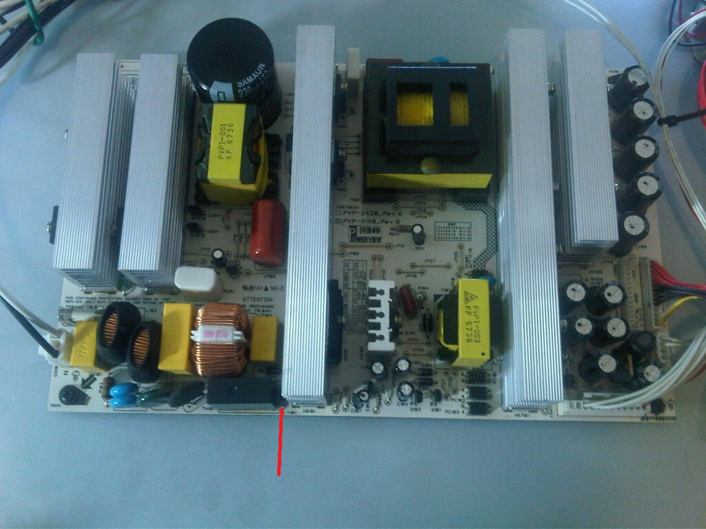

                                          2) I think tom66 means these output diodes (circled in red). They have a marking that looks like
                                          pin 1 is on the left, 2 in the middle, and 3 on the right. Set your multimeter to diode and test pins 1-2, 2-1 and then 2-3, 3-2.
