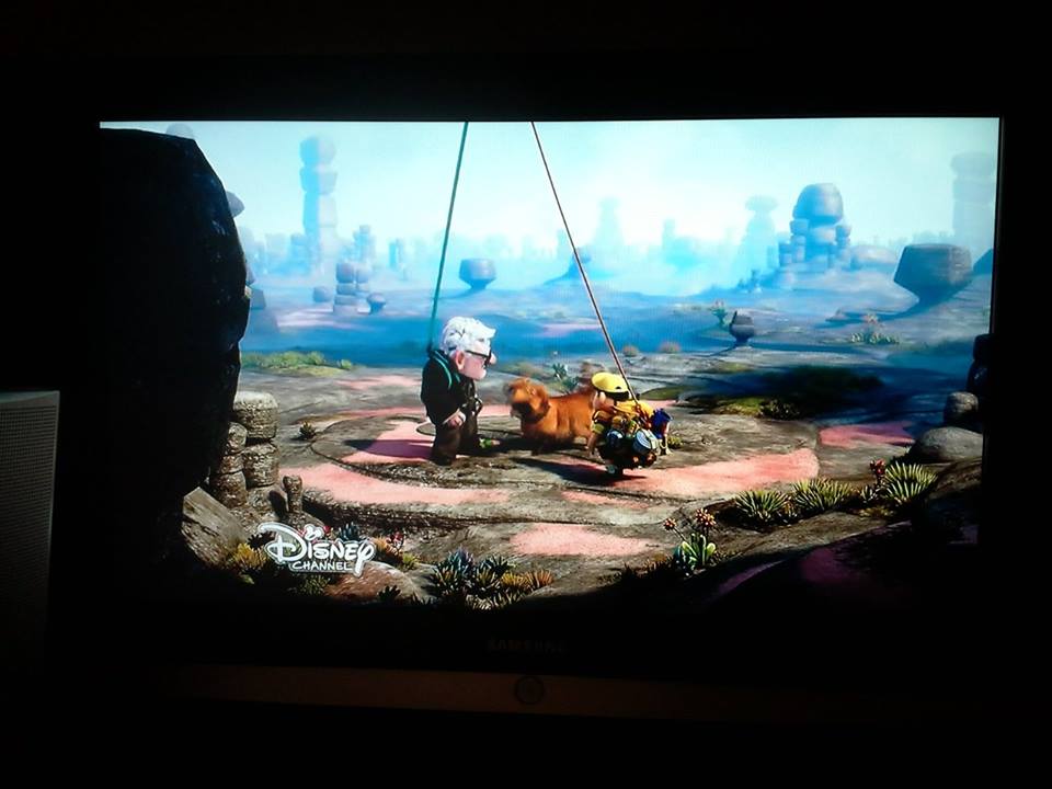

    would TCON solve this problem I'm having same problem (no picture has sound) I recently ordered the caps (equivalent) installed them since i've noticed 2 were bulged and decided replace them all from clean slate...it was great for good 10 mins...until it came back how it was no picture and but sound with lines on the screen as illustrated on my pic..
    go for the tcon, theyre pretty reasonably priced, if it dont fix it, then you at least eliminated it and you have a spare if you ever need it.

      Re: Samsung LNS3241D - No picture, sound and backlight OK
      yup, I fixed my LN-S3241D Samsung LCD.....been trying to figure out with lot's of help with the Forums and clue's on youtube, from no picture with sound with vertical lines to the new LCD again I have...answer to mine was the TCON, though I started out with the capacitors which one was slightly buldged...then turned it on and was good for only 10 mins..then went blank with vertical lines again...searched for TCON which was my second obstacle as I learned it from amateur tv techs on youtube..thanks peeps, it was interesting speculating the problem..infact I may make a hobby of it and start fixing other peoples tv problem...thankfully I happened to find/search a former tv repairman whom is retired but still works at home fixing t.v.'s stumbled on him on craigslist here in MN than ordering 75 to 80 dollars on ebay which he sold it to me for 20 bucks...Installed it and was happy to get my LCD back to work infact looked nice! Here's my result within 3 weeks learning from peeps!......
