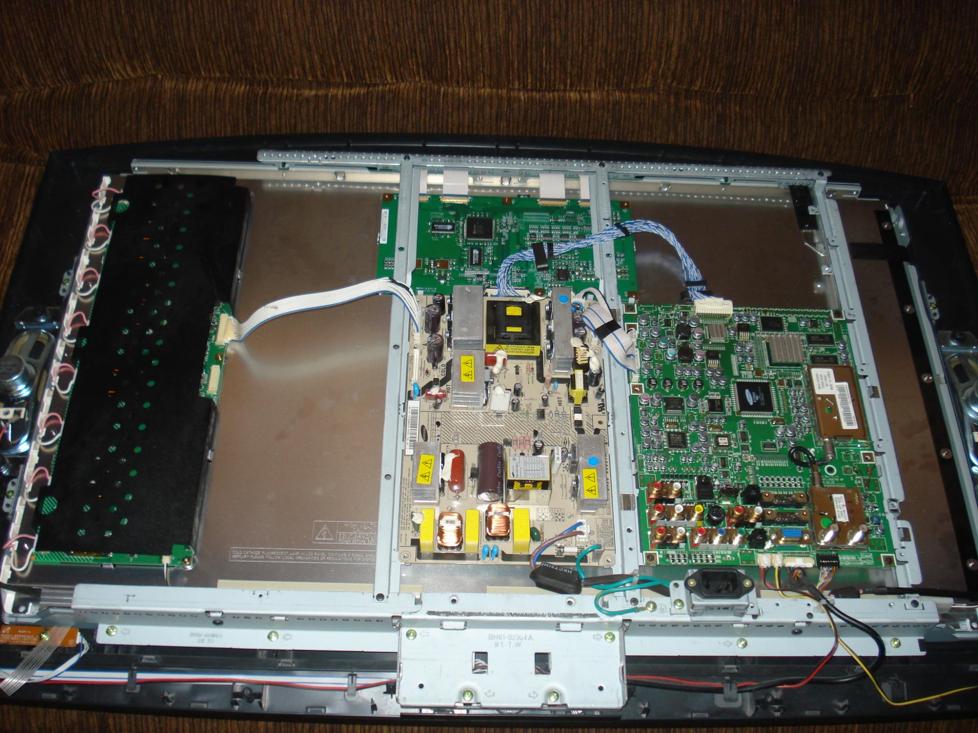

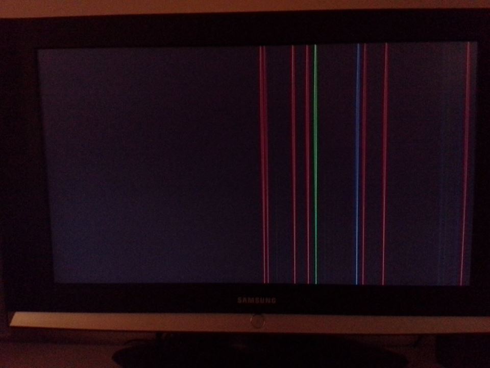

    Samsung LNS3241D - No picture, sound and backlight OK
    Four year old LCD TV first started showing problems with intermittent vertical lines across the entire screen; of varying number, width, and color. Now it turns on and stays on, but there is no picture, not even for a second; does not matter what source. Even the menu items do not display. The audio is fine and the backlight is on.
    I replaced a bulging 470uF, 25V cap.
    24VDC checked going to the inverter board.
    5.4, 12, and 13VDC look good going to the main board.
    LVDS cable and end connections appear okay. Contacts cleaned.
    Fuse F1 on the Tcon board is good.
    Is there any thing else, fairly easy to check, to narrow down the problem? I do have access to an O-scope from work, but do not have a lot of money to throw around. Any help would be greatly appreciated.

    The symptoms indicate a bad tcon. The intermittent vertical lines across the full screen indicate it's not a bad panel.

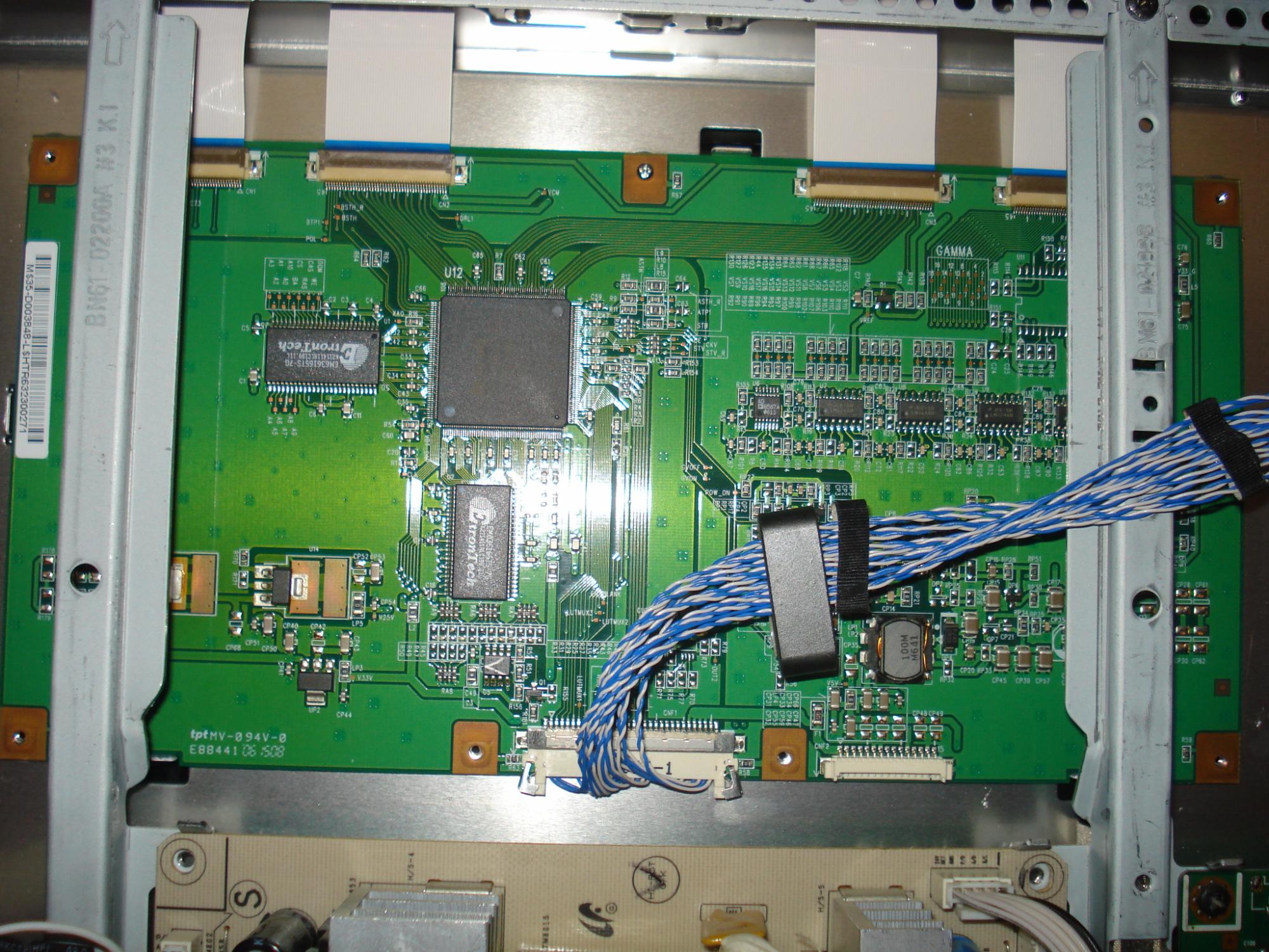

          Can you take a picture of the T-con and post it here?

            Thanks Tom, Attached is a pic of the Tcon board...
              Re: Samsung LNS3241D - No picture, sound and backlight OK
              I see one fuse, F1, on the board, to the right of the connector. Can you test that fuse?

                I did measure F1 Tom. Resistance is near zero with the power off. I measure 5VDC on both sides with power on. Thanks for the feedback.
                It may be interesting to note that the TV behaves exactly the same with the LVDS cable (I believe that is the cable to the T-con from the main board) connected or not.
