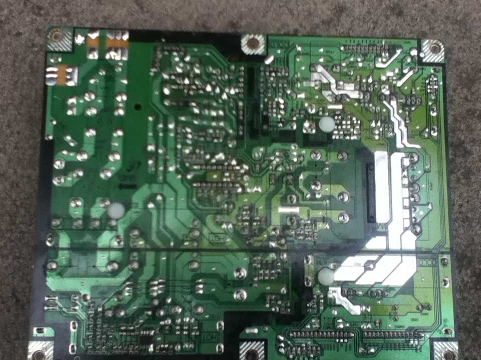

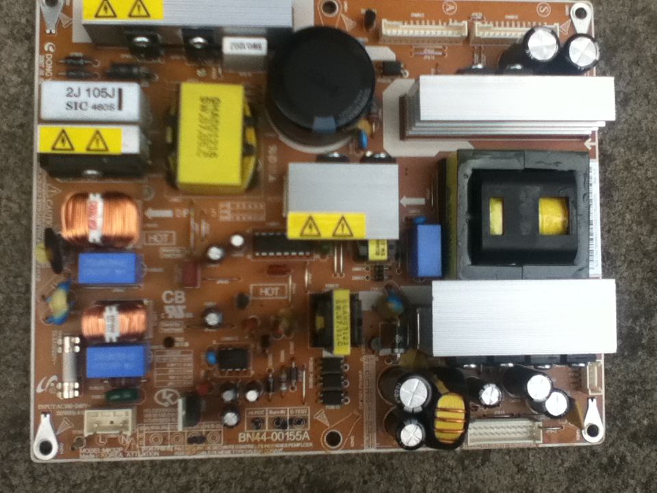

    Hi All,
    Safety resistor RM801 burnt out on switch on. Apart from that no visible distress on any other components on power board or inverter board.
    Replaced this and Mosfets QM801, QM802 (FQPF9N50C), with more hope than conviction. Checked all diodes in situ and they appear fine.
    Powered up initially without mainboard, inverter or backlight connected. After connecting these items in sequence, TV worked as normal. I probably turned TV on and off about half a dozen times over the next 3 hours and everything was ok. However, next morning, on switch, another crack and burnt out RM801.
    It appears a surge is knocking out RM801. Any suggestions welcome.
    Electronic knowledge about 30 years out of date.

    This is why we always ask for clear focused pictures which you have nicely provided. You have at least one, possibly more, bloated capacitor. The obvious one (a 10V) is the to the right of BN44-00192A.
    Capacitors die from age, heat, and shoddy build quality. Capacitors DO NOT have to be visibly bloated in order to bad. They can be out of tolerance uF (a 1000uF measures 20uF) and/or have high ESR (ohm). A multimeter will be insufficient to test for ESR. For that you need an ESR tester which costs between $50 and $300.
    Also, some of the glue has turned brown and could be causing a problem.

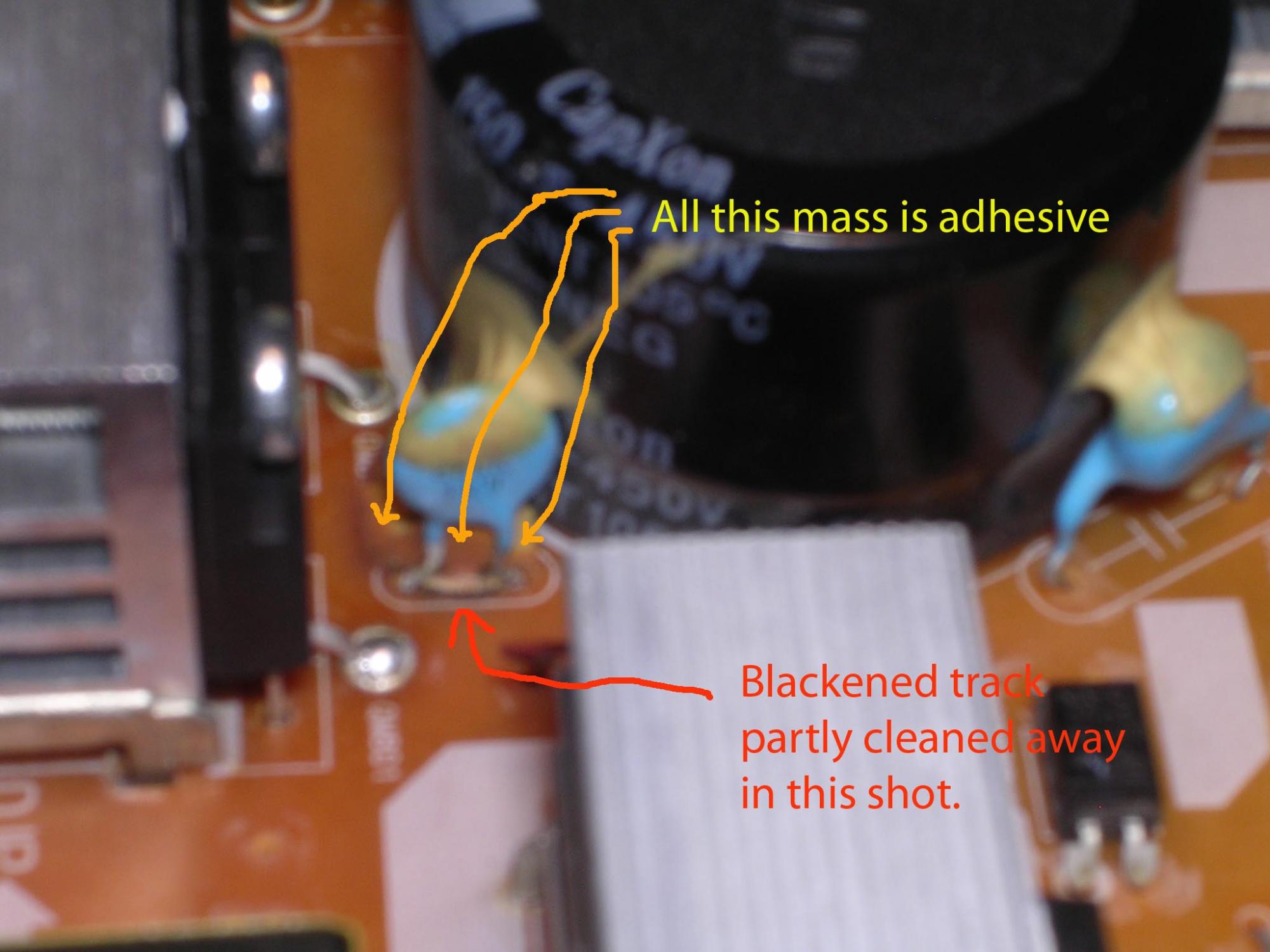

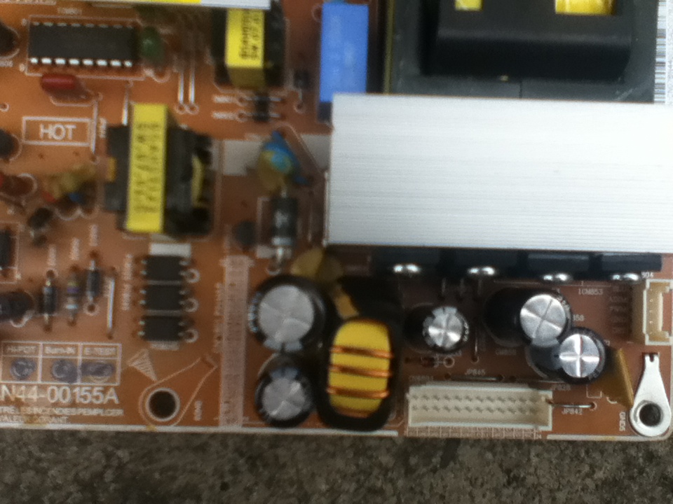

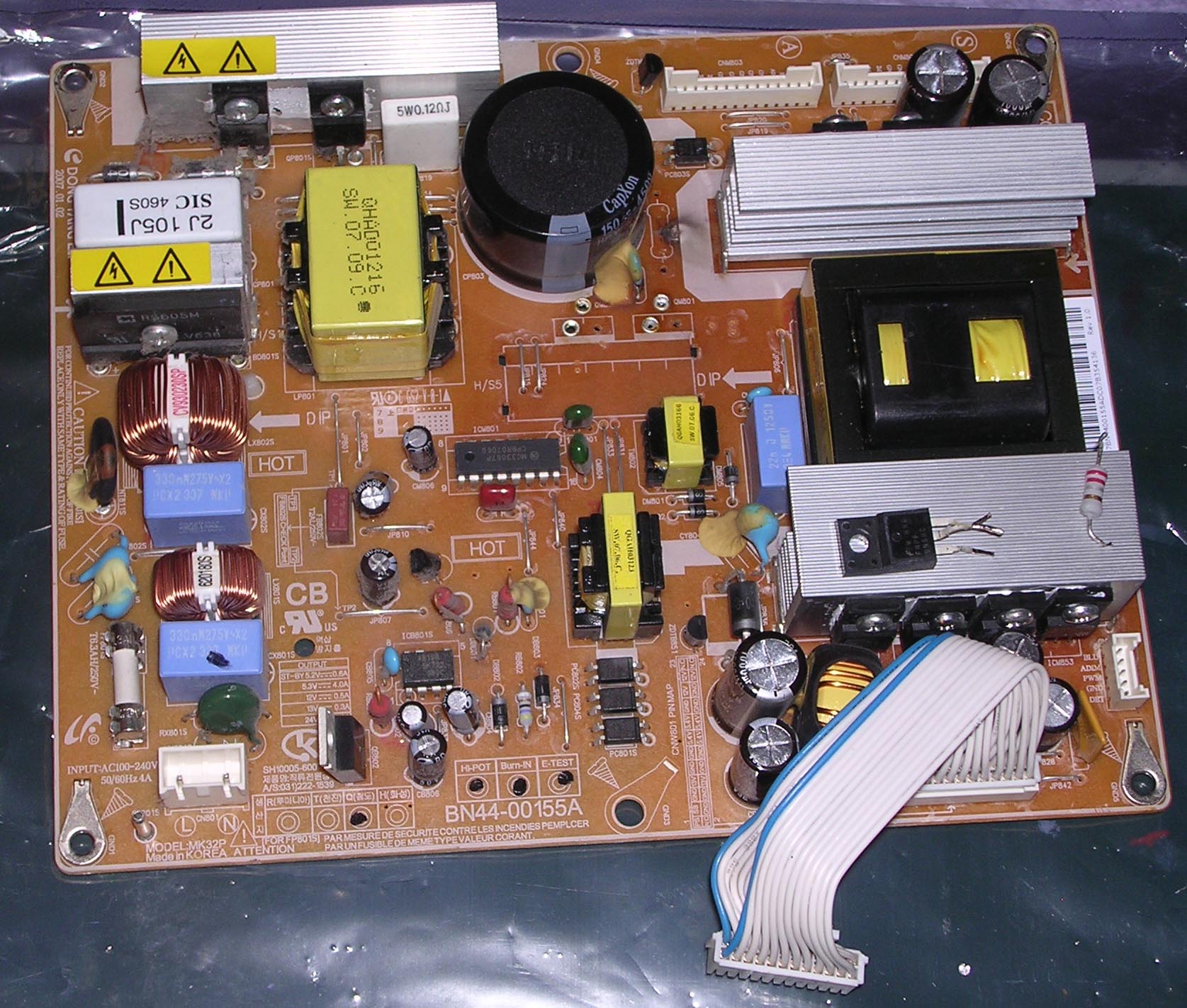

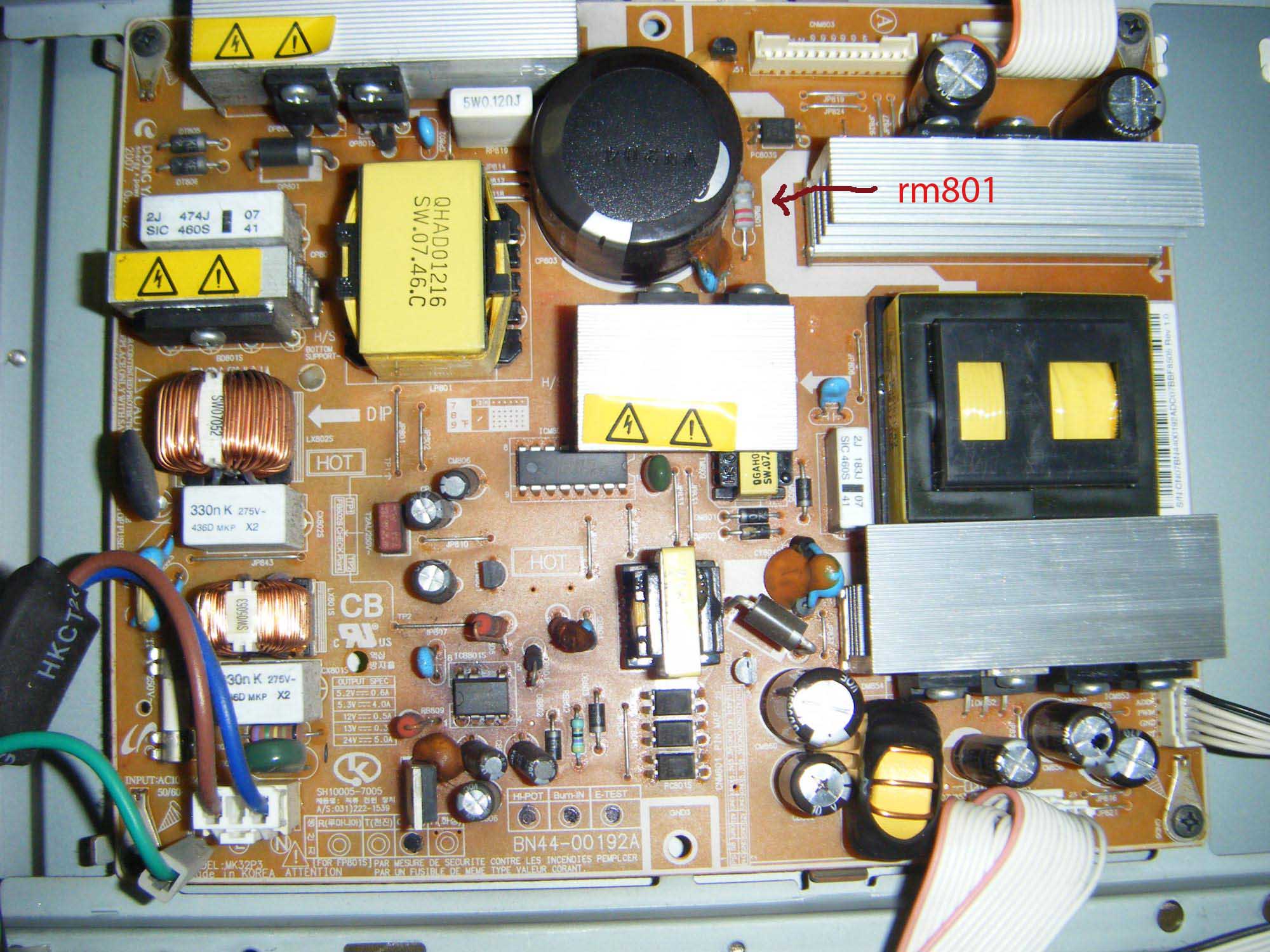

        Re: Samsung LE32R88BD/ BN44-00155A
        Take a pat on the back Mr retiredcaps.
        Your observations appear to be correct in a round about way.
        When you referred to BN44-00192A (instead of BN44-00155A)
        I was puzzled and assumed you had got some threads crossed and took little notice of your comments.
        I can know see I had posted the wrong image (of a BN44-00192A),
        which I must have downloaded in my research. The two boards look remarkable similar, (maybe just a different Europe/ US designation}.

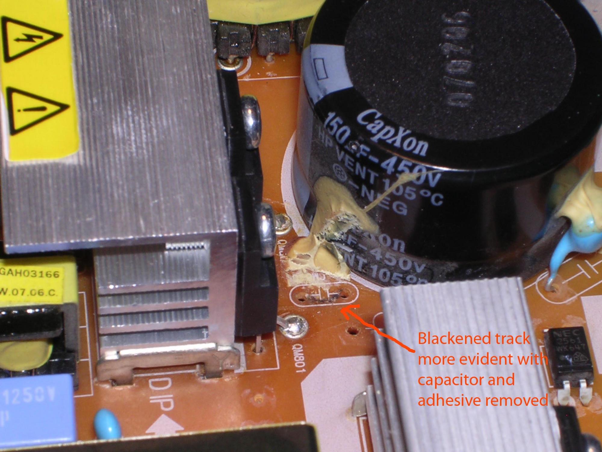

        The point is, I decided to check the board again visually. I noticed a faint black line on the circuit board where the yellow adhesive fixes blue capacitor CM810,(44nf 1KV) to it.I figured that if this was some sort of leaky conduction path across the capacitor lead out wires it was capable of passing enough current to blow safety resistor RM801.
        After chopping away a the adhesive and removing the capacitor I scraped away the (carbonated?) black line, (track). With capacitor reinstalled and a new resistor in place, TV was back in business. It's still early days yet, (two), but as the theory appears sound, I am quietly confident.
        As an extra precaution, I have removed adhesive from around other components where a leaky path could develop.
        Attachments show actual board BN44-155A and problem area before and after capacitor removal.
          It wouldn't be the first time. When helping multiple people, it is easy to get confused.
          Please report back in another few days. I'm sure people are curious if that is the root cause and it may help others in the future.

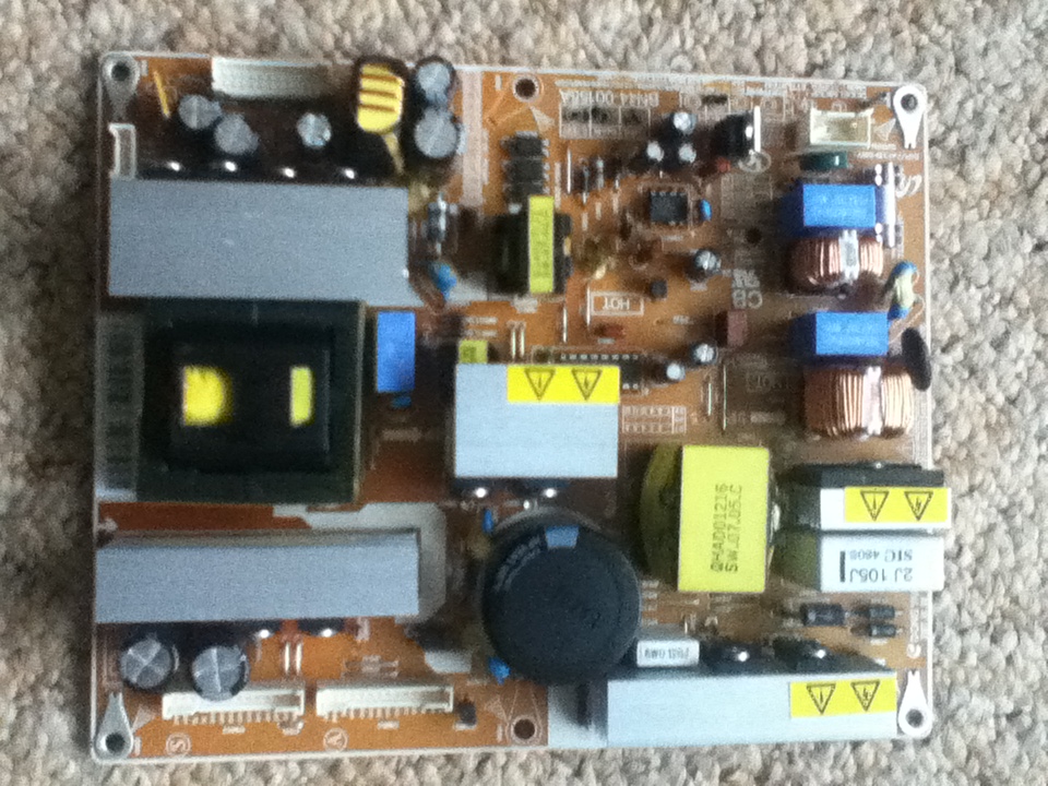

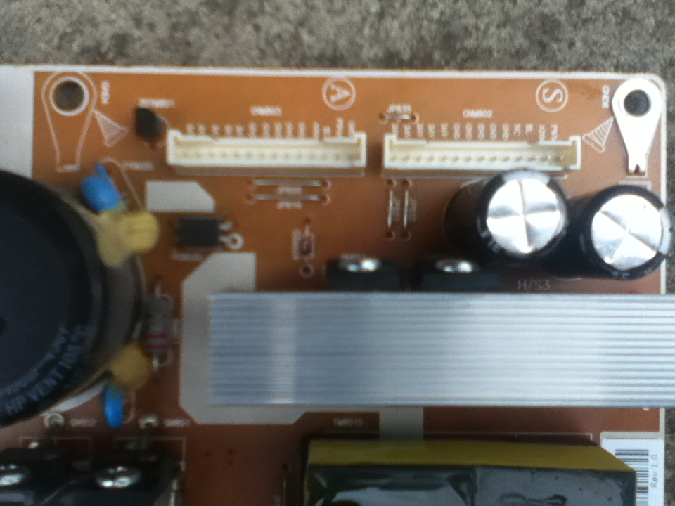

                                I have attached the images, and the fault is that the standby light keeps flashing.and I have got all the equipment as I am a bench engineer

                                  I dont know if its the change in weather but UK is producing the worst photos I have seen or rather cant see, for weeks- Have you looked at your photos. The idea is we look at them for suspect faults or known weak components then ask you to test them. Please practice with your camera and try for better ones. Looks like its too dark today in Bolton if its anything like here so wait for a bright day and take them outside if you cant get decent light near a window.
                                  You also need to be more descriptive - we cant see what its doing. Standby light flashing tells us very little.
                                  OK you will probably have to wait until you get the pics then put the set together unless you can remember : When you first plug the set in what does it do if anything
                                  Does the standby light come on then and start flashing straight away? what colour is it Does it continue to flash for say 5 minutes? Does it flash a sequence - long flash- gaps or just flash the same rate whatever.
                                  Were there any sounds - clicks - hissing -humming.

                                      I think I should give a big hug to Bornintheuk and Retiredcaps:
                                      I had a dead Samsung LE26R88BD (red stand by led flashing but no power on) with a BN44-00155A board to repare.
                                      When first looked at the BN44-00155A board I was very happy because I saw a bloated cap (2200ยต 10V).
                                      I changed all of the 13 caps on the board but still not working....
                                      Then I fall on your thread and the desciption of Bornintheuk's story.
                                      I checked the safety resistor RM801: blown and capacitor CM810: carbonated track between the two legs.
                                      After changing RM801 and cleaning all the carbonared tracks and removing all of this damned brown glue the TV started working again.
                                      Thank you very much again, you helped me a lot and I will think about you when I drink a round of first quality beer that the owner of the TV will offer me in reward!!!
                                        Great job.
                                        When you see those yellow glue (it turns brown and become conductive and also will eat away copper traces), remove them ASAP.
