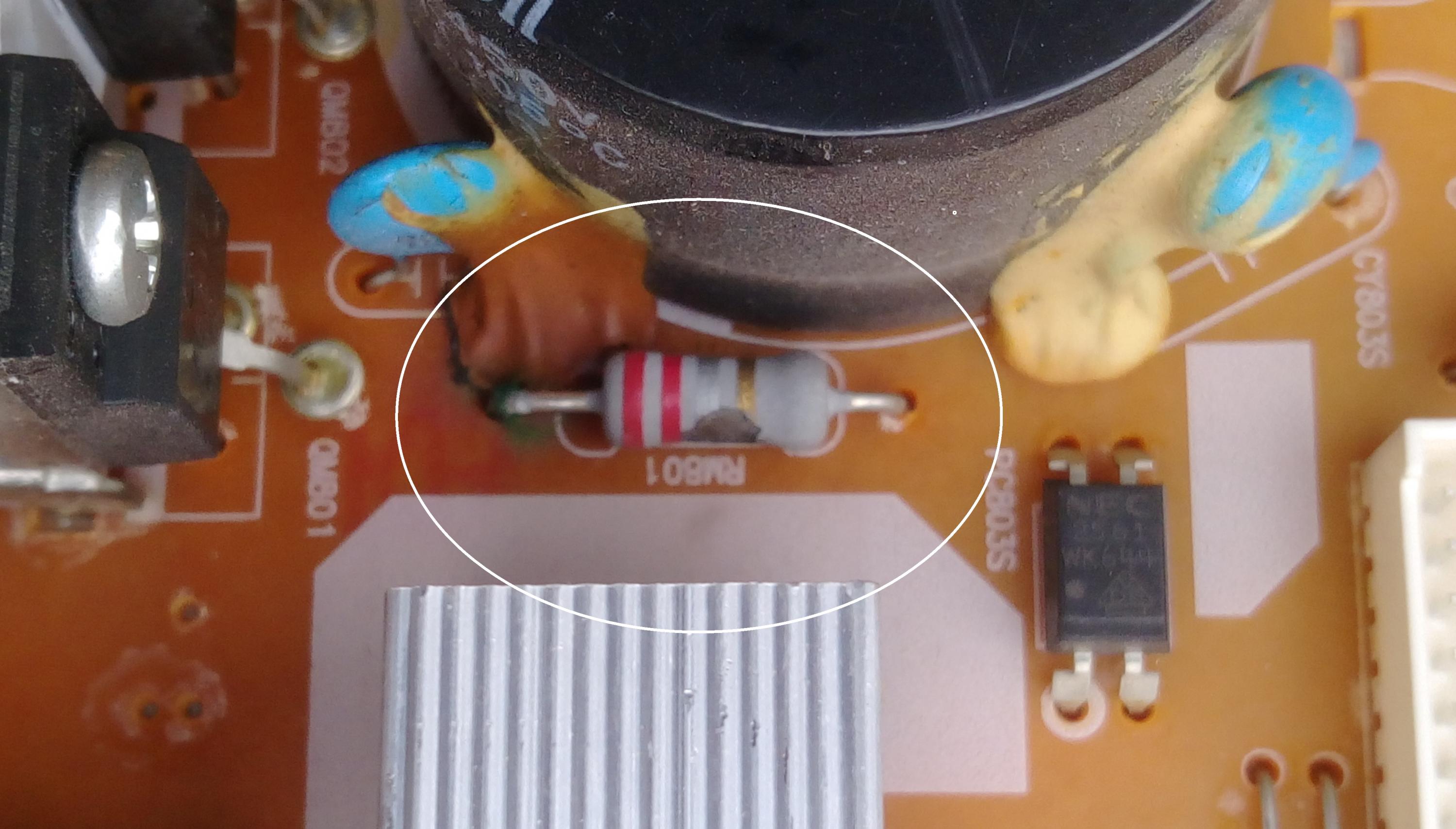

      Have checked my meter, resistance reading between probes at 200 ohm setting is 00.3
      Removed all cable connectors from both boards.
      Tested RM801 on original PSU, but get different readings at different times. After several seconds, sometimes I get a 1. reading at all settings, other times, at highest 20M setting only, reading varied between 4.5 - 4.68, then again between 12-14 (both on 20M setting), then 0.2 on 20M but gave 1.49 at 2M.
      I also tested RM801 on the used replacement PSU, got a 1. on all settings below 20M, but at 20M onetime I got 13.62, then 5.7, then again a 9.4-9.9 (reading moved up and down whilst probes on contacts). Only ever get a 1. on any setting lower than 20M.
      BTW, I also tested another board resistor (RB802) and got settled reading on that one on both PSUs, so don't think it's my multimeter faulty.
      None of the readings (when I can get one) are anywhere close to a low 0.22ohm reading, do this mean BOTH PSU are duff with bad RM801 (and maybe also other) components?
      Have attached pic of replacement board, showing close-up of RM801 with outer coating damaged - am I unlucky in just having purchased another bad PSU board? (did get a full refund from seller).
      If so, do you think failed PSU is definitely the root problem (and not the main control board)?
      I'm not great at soldering, can't test any Caps, and so replacement boards is easiest, and I can get another used PSU cheap - under £20 ($30) but don't want to keep buying parts and not fix the issue.

        Re: Samsung LE32R88BD/ BN44-00155A
        https://www.badcaps.net/forum/attach...1&d=1563451977
        That resistor is blown, that bad glue is also not removed and you can see corrosion on the left leg of the resistor due to that bad glue, glue also becomes conductive.

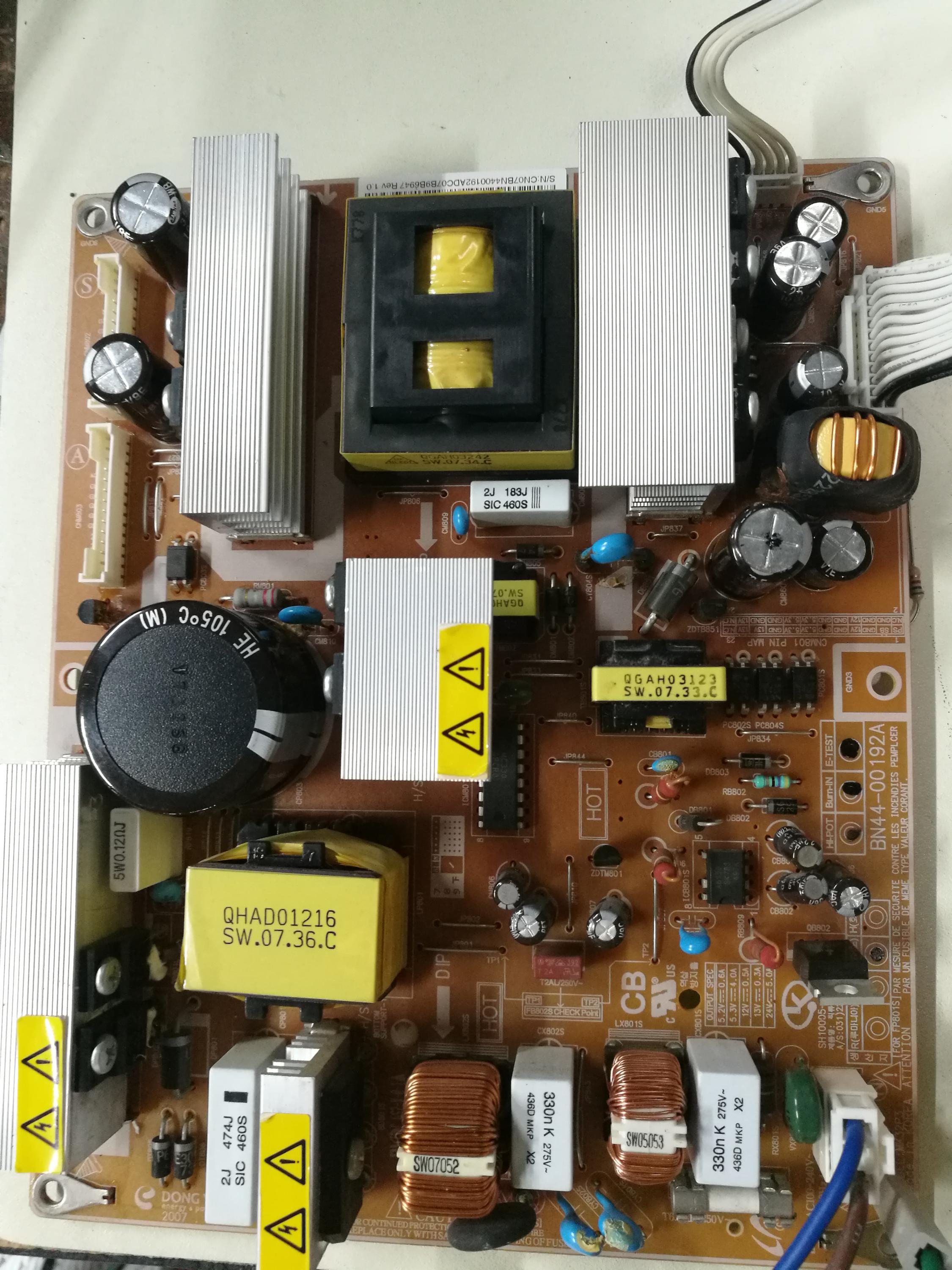

          The blown resistor shown was on the secondhand PSU board I purchased, so do you think the RM801 was also blown on my original PSU, from the first pic I had posted, and the meter readings I gave?
          But I haven't cleaned off glue, or tried replacing resistor on either PSU board, , as I'm not skilled at PCB soldering repairs, so is easier to just get another used (but hopefully working!) replacement PSU.
          So are you certain it will be the PSU at fault and not the main control board?
            #285
            "Tested RM801 on original PSU, but get different readings at different times. After several seconds, sometimes I get a 1. reading at all settings, other times, at highest 20M setting only, reading varied between 4.5 - 4.68, then again between 12-14 (both on 20M setting), then 0.2 on 20M but gave 1.49 at 2M."
            Well, based on that information, that resistor is bad, and it may have gone bad because of shorted MOSFET's, caps, etc.
            We cannot tell much to know if other boards are OK or not until you get good working power supply first.

                It is power supply due to the fact that 0.22 Ohms resistor is bad as you have tested it.
