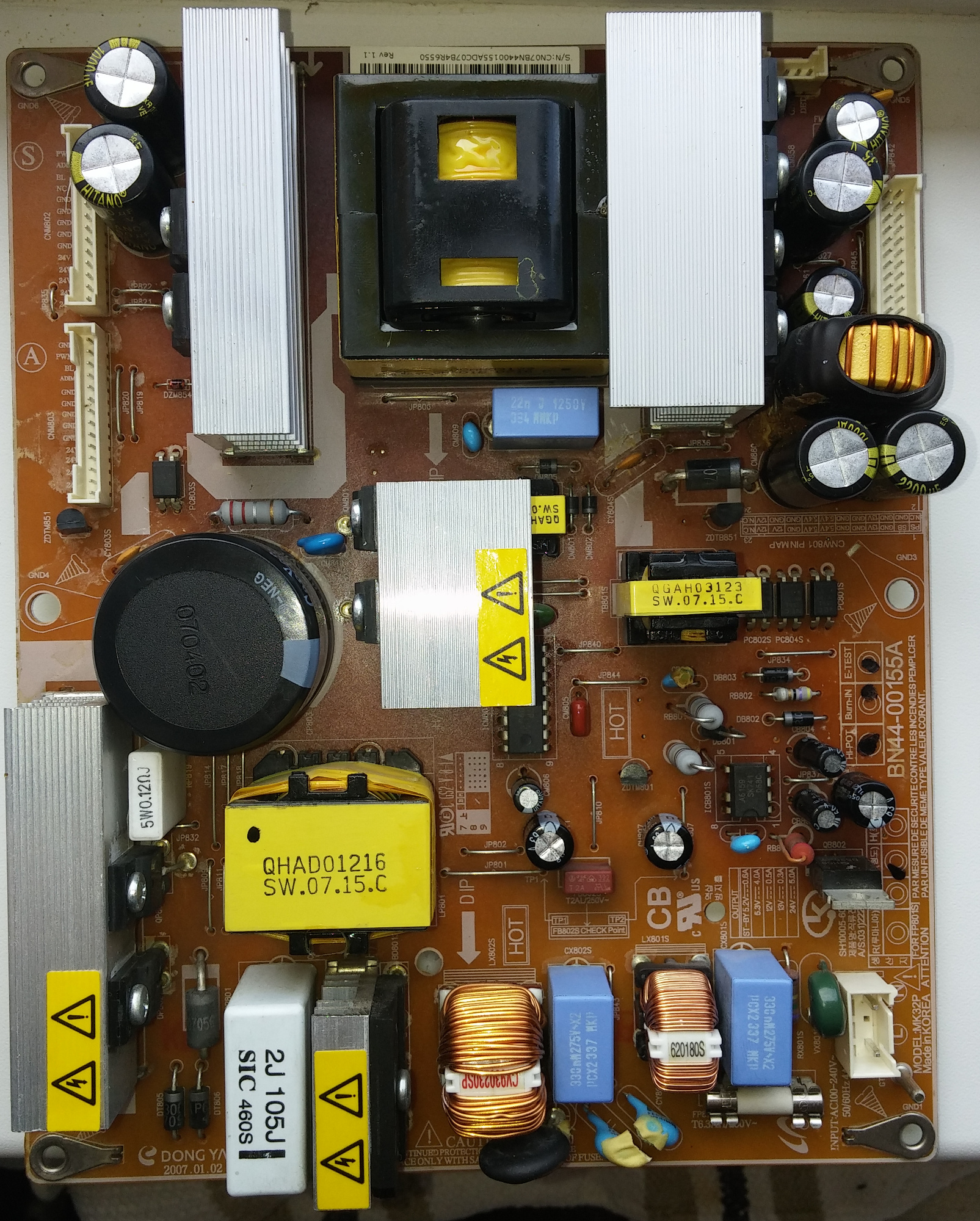

            #105

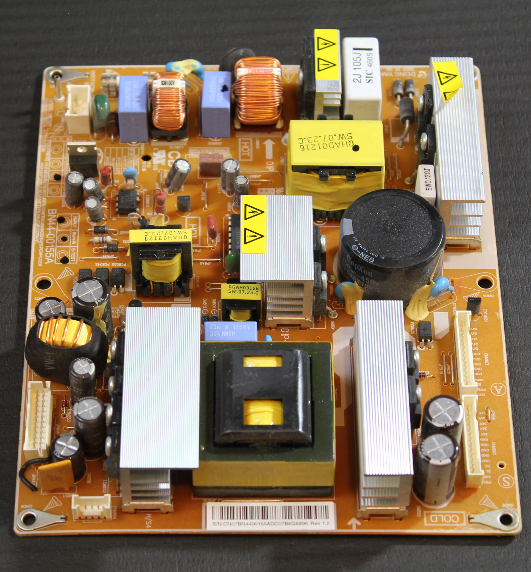

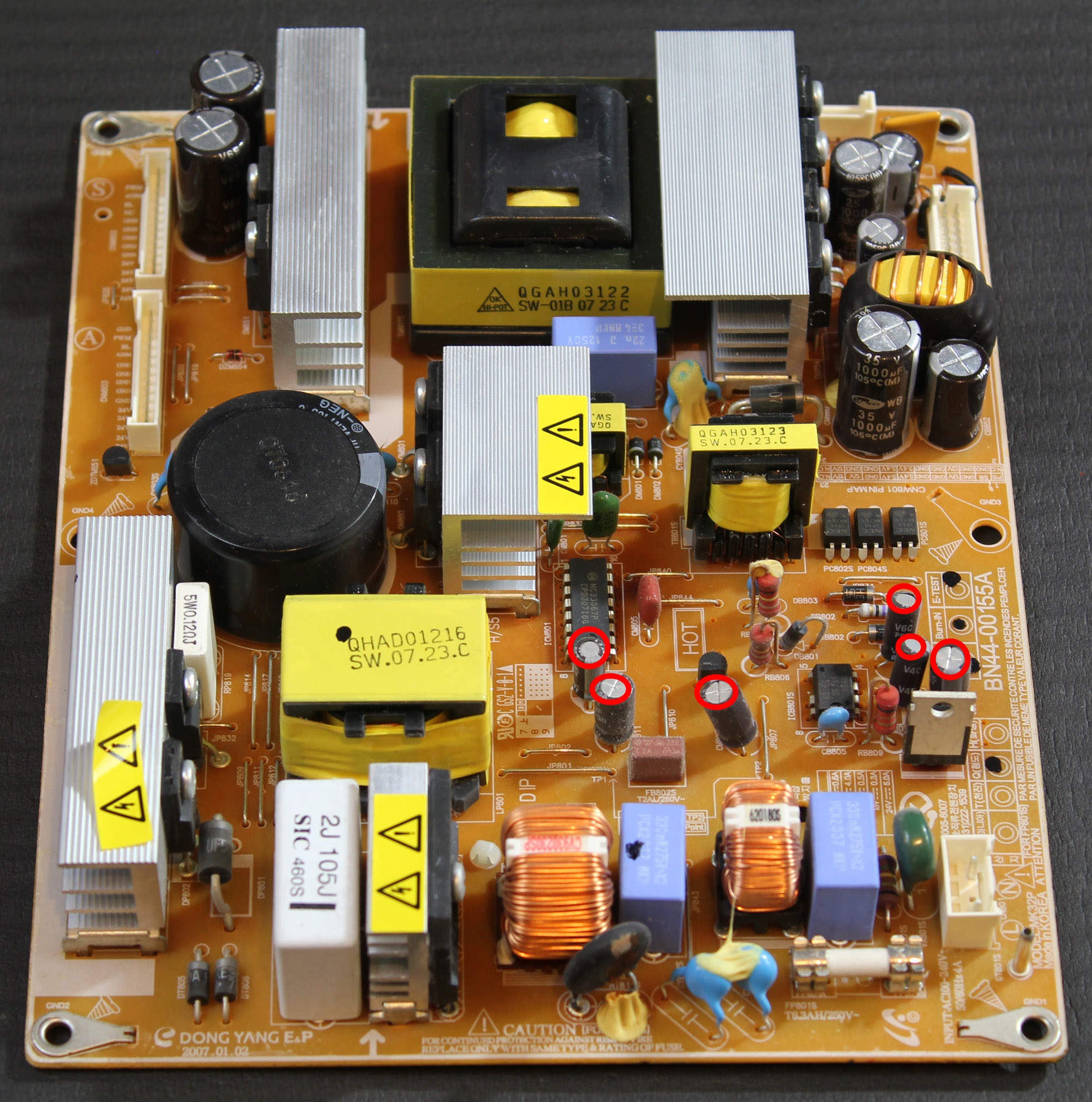

            Looking for source for RM801 fusible resistor 0.22 ohm 1 W
            Hi everyone,
            I just fixed a BN44-00192A power supply board for a Samsung 32 inch LCD TV in great part relying upon the collective wisdom of this forum, so thanks very much!
            In my case, the fusible resistor RM801 was blown. This is the fusible resistor that connects and protects the primary line upconvert circuit from a short in the main switching supply circuit.
            I have not been able to find a source for a suitable replacement for RM801, which is supposed to be a 0.22 ohm, 1W fusible resistor. Digikey has a listing for a Yageo part with these specs but no stock and a 5000 piece minimum. Bourns has a line of fusible resistors, but they don't go below 4.7 ohm.
            So, can anyone point me to a supplier for a suitable RM801 replacement? Or does anyone have a spare (or two) they would be willing to share at cost? (I hope I am not breaking forum rules here. I don't think badcaps sells these.) Please help guys, you have to save me from this:
            (See attached image file.)
            Yes, that is 5 x 1.0 ohm 0.25 W regular resistors in parallel. Ugly, but the power supply works.
            A few comments on this repair for the record:
            1) There were a few bad caps, but they probably didn't cause the failure.
            2) All the glue was brown and was definitely traced/burnt in the vicinity of RM801 and the nearby small blue cap CM810. I believe this was the cause for the complete failure. I removed all of the glue on board. Fortunately no damage to the circuit board in this case.
            3) Cleaning up the glue, replacing RM801 and a few of the cold side large caps and the TV is working again. There were no blown semiconductors or other components.

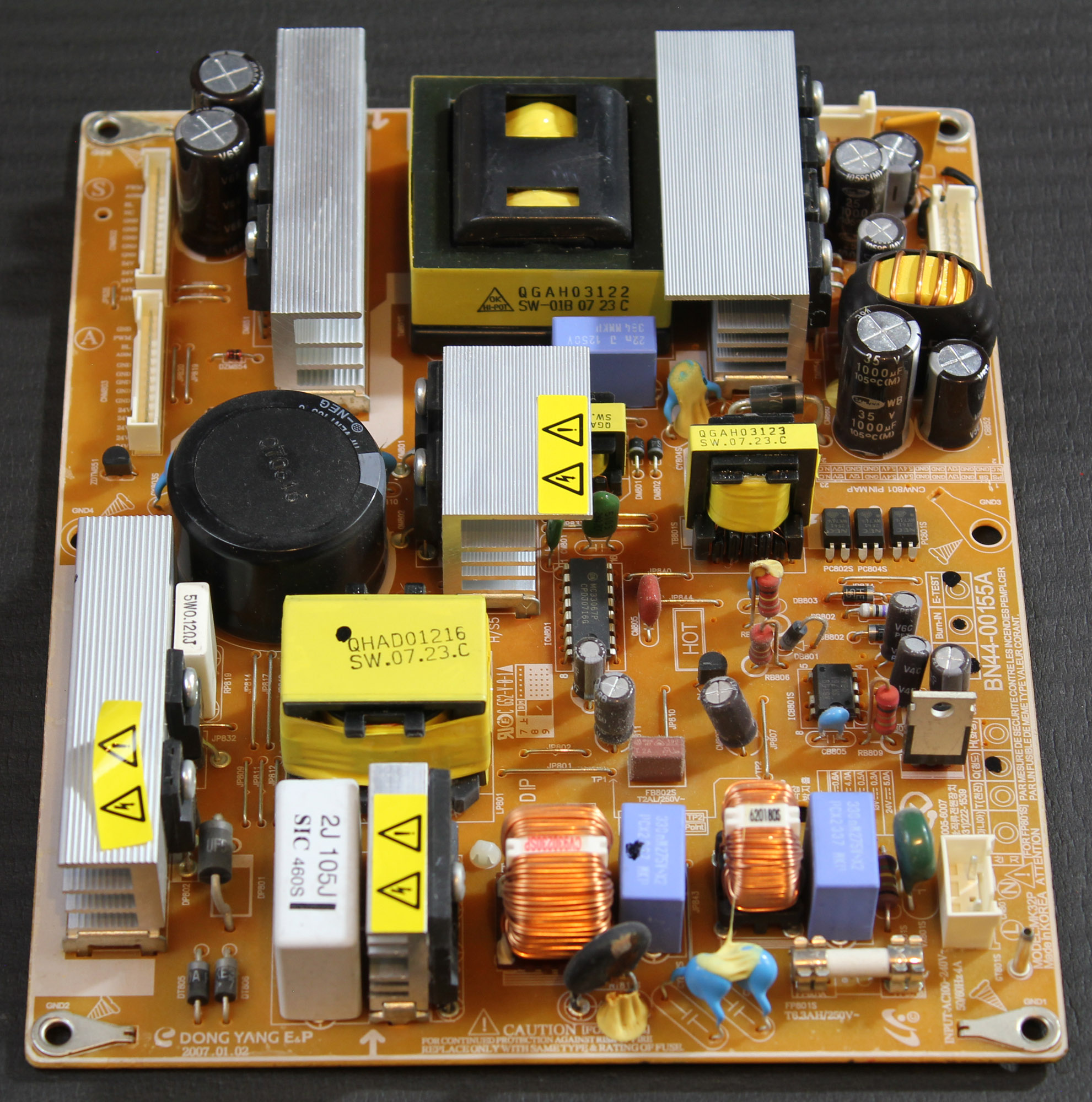

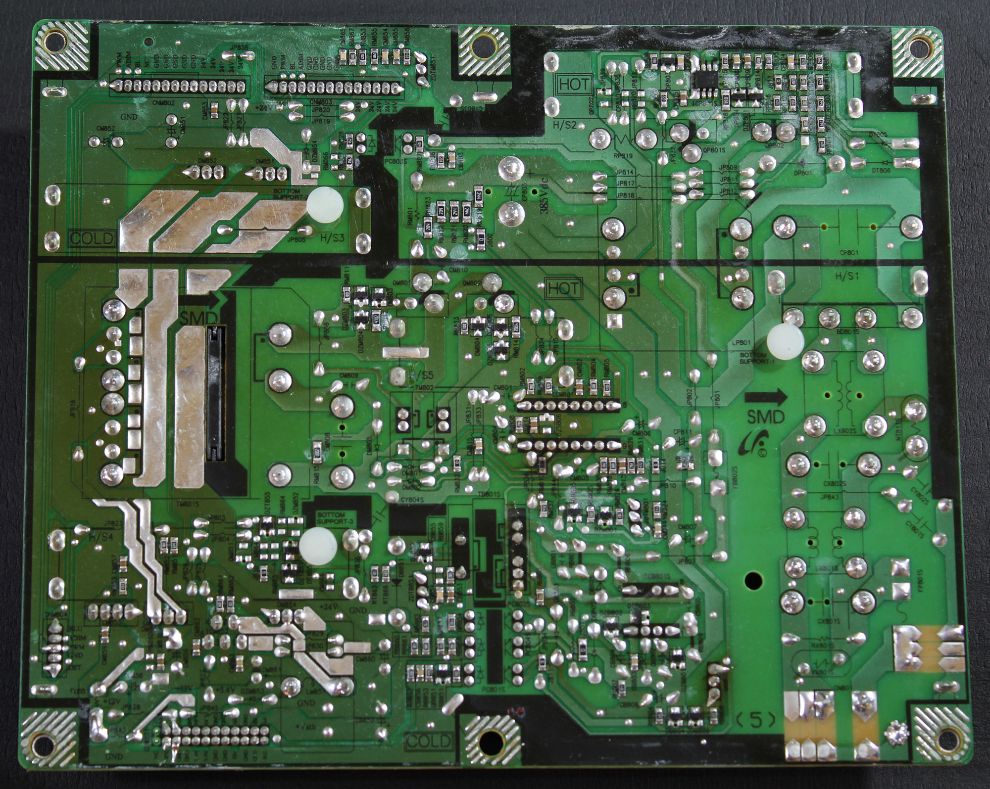

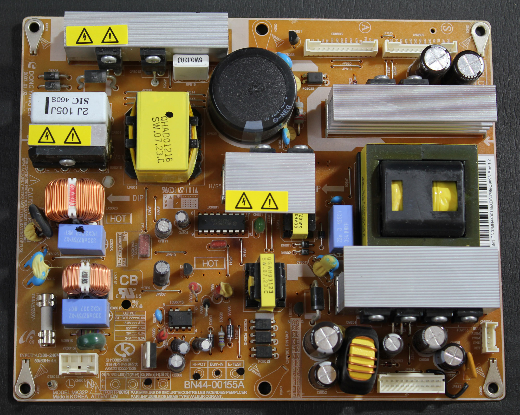

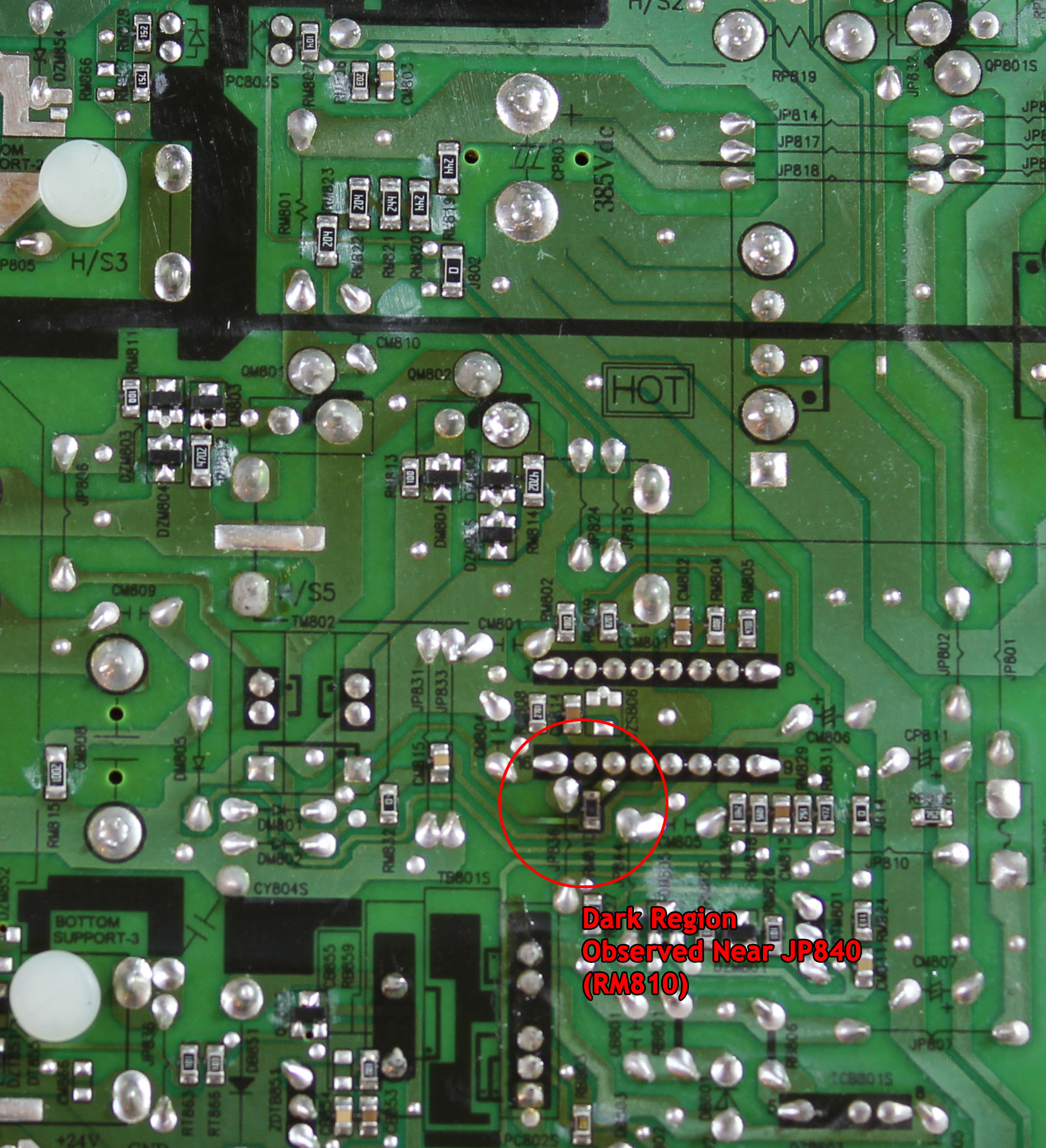

              #106
              Re: Samsung LE32R88BD/ BN44-00155A

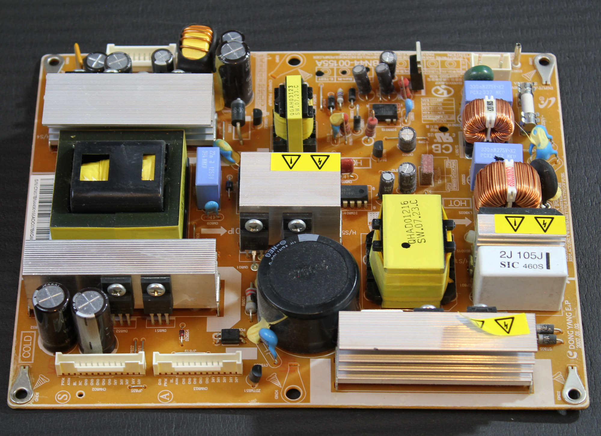

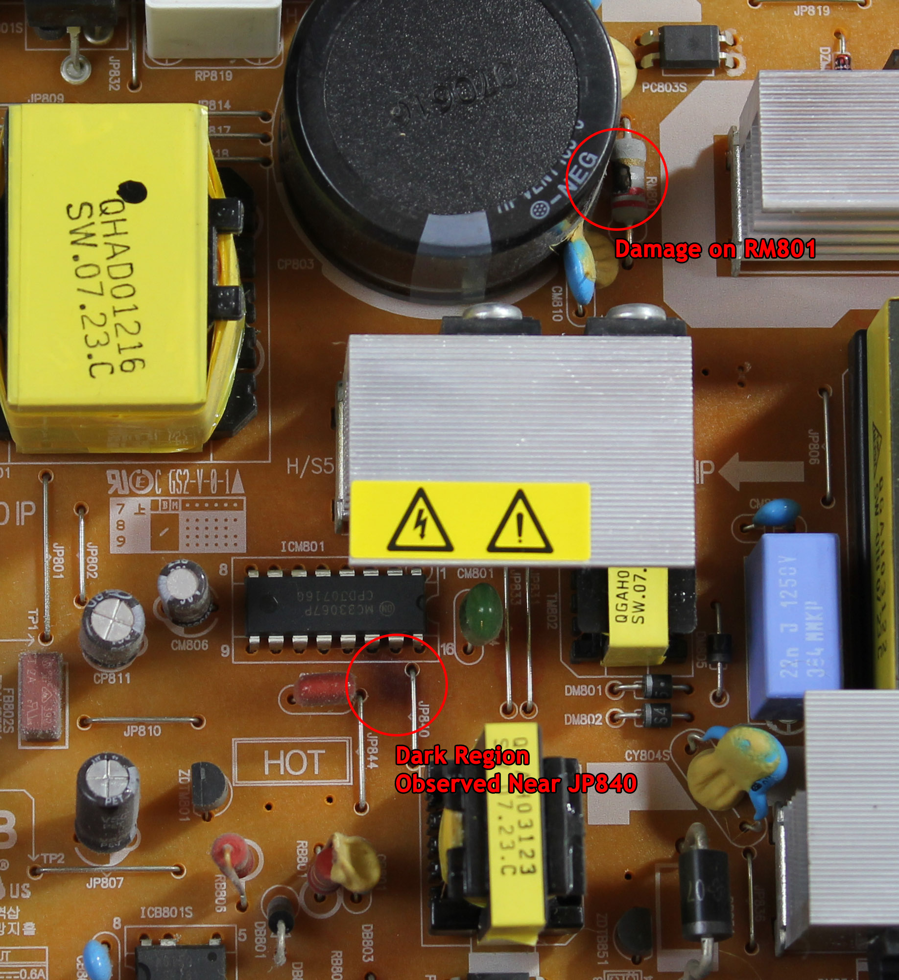

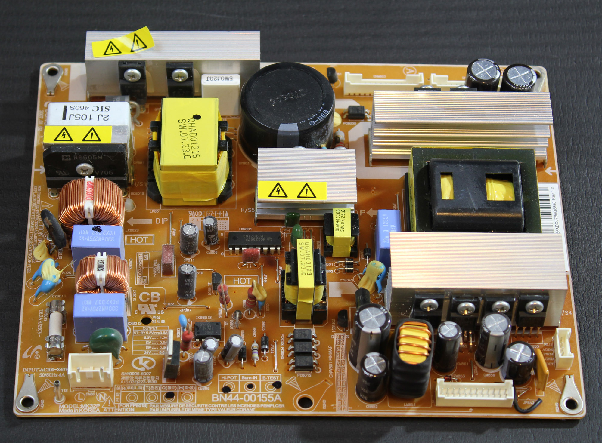

              Hi everyone,
              I too have been struck with the BN44-00155A power supply issue. I've read through the whole tread as well as any other resources I can find online. My electrical engineering abilities are fairly limited, and honestly I don't feel comfortable inspecting the board while supplying power to take output measurements yet. I thought I would at least share my the symptoms of my board and a few things I was able to spot as potential problems in case someone else spots similar on their boards. I had some trouble finding high-res pictures of the board for reference, so I'll provide the ones I took in case anyone else is looking for something to compare against.
              Suggestions are welcome, but considering the age of the TV and the likelihood that I'd need to replace all the capacitors, the resistor, and then at least one SMD component, I fear this looks like a 'rabbit hole' scenario that is almost certainly beyond me.
              Symptoms:
              Samsung LCD TV will not power on. Standby light flashes when power button is pressed.
              Observations:
              The resistor at RM801 is visually damaged.
              The top and glue holding thermistor (5D13) at NT811S is damaged and discolored. (I removed some of the glue to read the component ID.)
              There is a suspicious dark spot on the front of the board near JP840. On the back of the board, the area around RM810 is darkened and traces display a rainbow-like shimmer.
