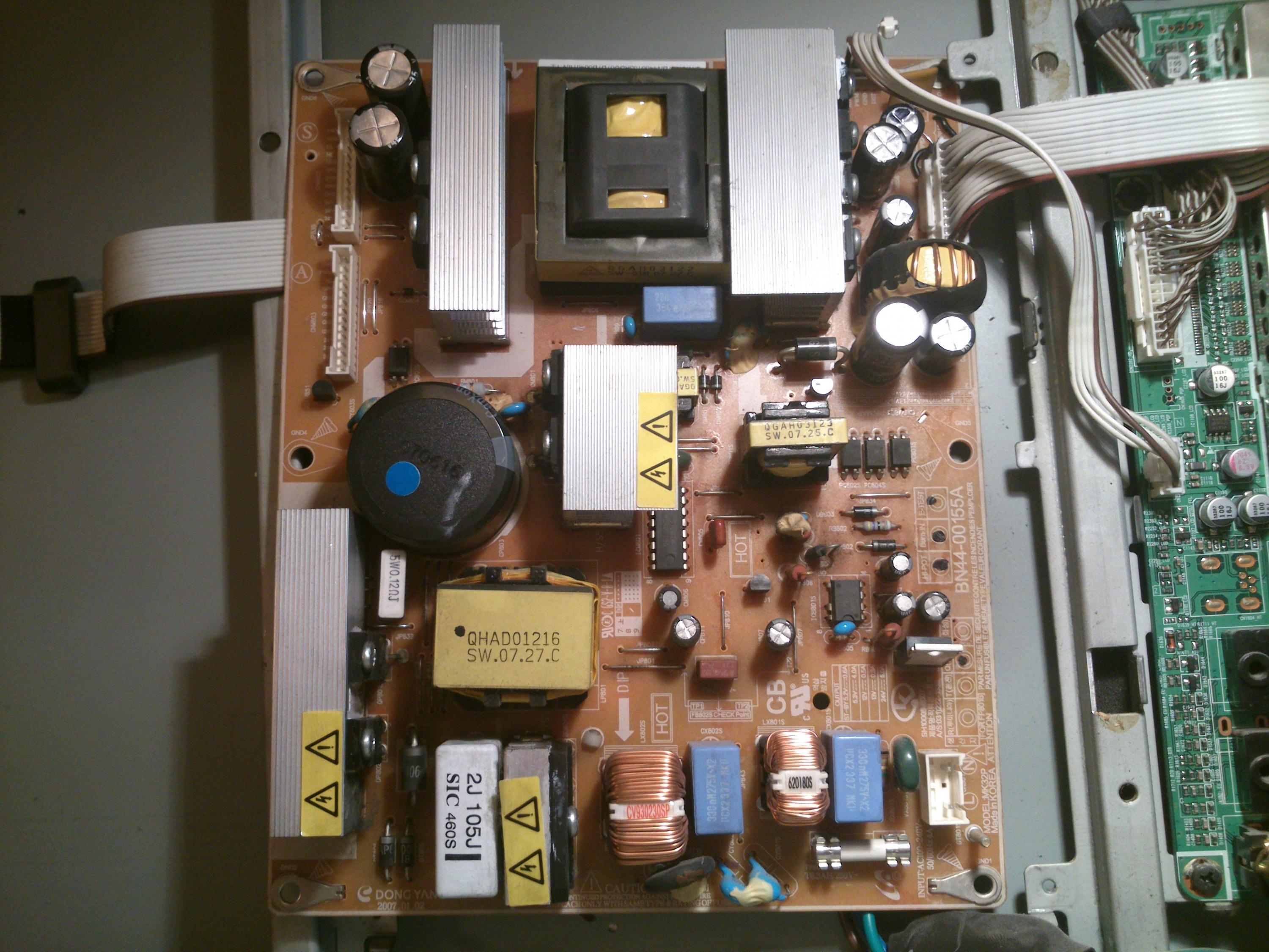

    Try heating power board and main board to see if fault is temperature related, most likely it is.

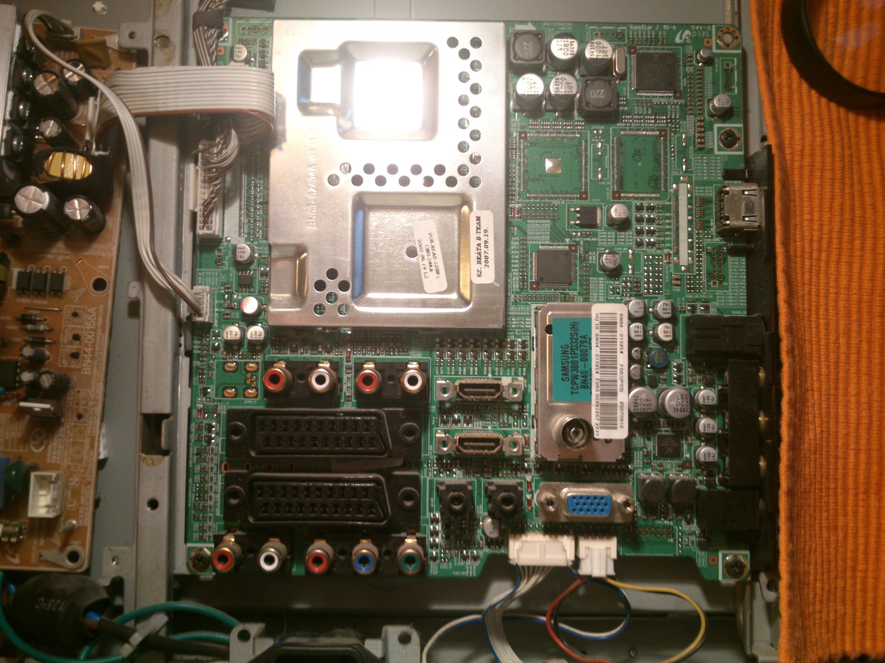

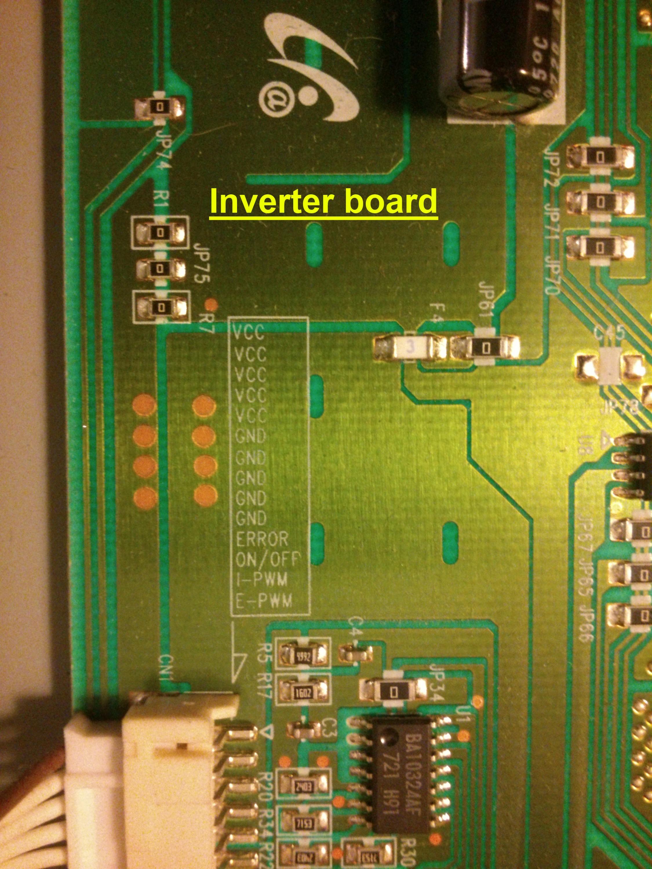

        Re: Samsung LE32R88BD/ BN44-00155A
        Lets find out first if the BL_ON signal and 24VDC are present at the inverter connector when the backlights go off. There should be some labelling close to the connector to identify the pins on the inverter connector. I do have a feeling that you may have bad inverter transformer.
        • Visant
          • Jan 2012
          • 7
          • Serbia
          #44
          I just measured between GND and VAC on inverter board connector and it says 24.4V steady.
          But between GND and ON/OFF it varies between 0V and 5.25V very randomly
            #45
            "GND and VAC" You mean DC? I expect the ON/OFF pin to have >3VDC and steady, this signal is generated by the main board. What you can do is to disconnect this wire between the main board and the inverter board (we do not want to back feed the signal back into the man board), then use 1K resistor between the ON/OFF pin of the inverter board and the 5V Standby by to force on the backlights, they should stay on.

              #46
              I mean pin marked " VCC" on inverter board
              Ok,where do i find 5V stanby feed ?
                #47
                CNM801 pin3 on the power supply board, it is 5.2VSTBY. YYou should download the diagram for the power supply board, see post 25.

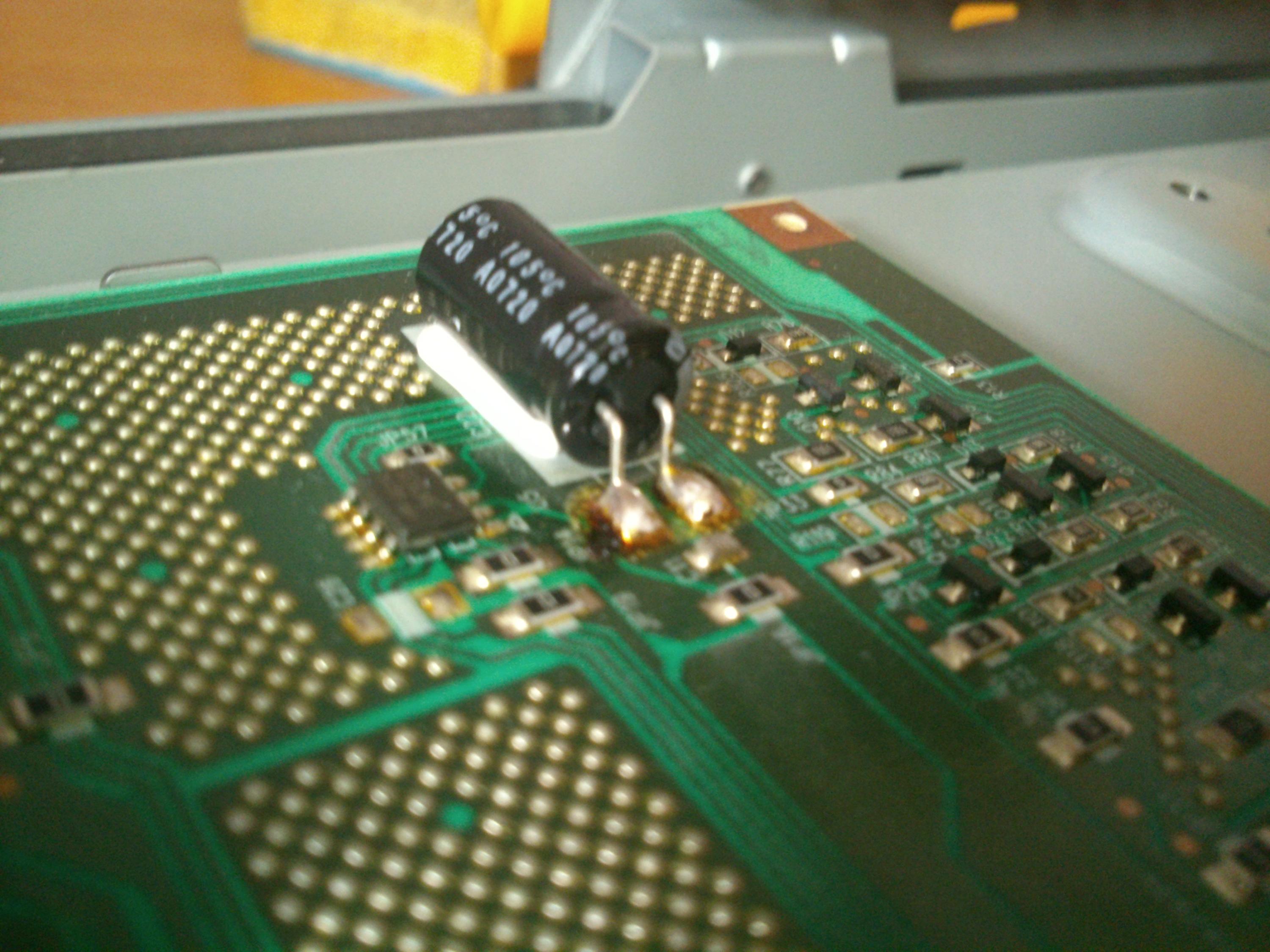

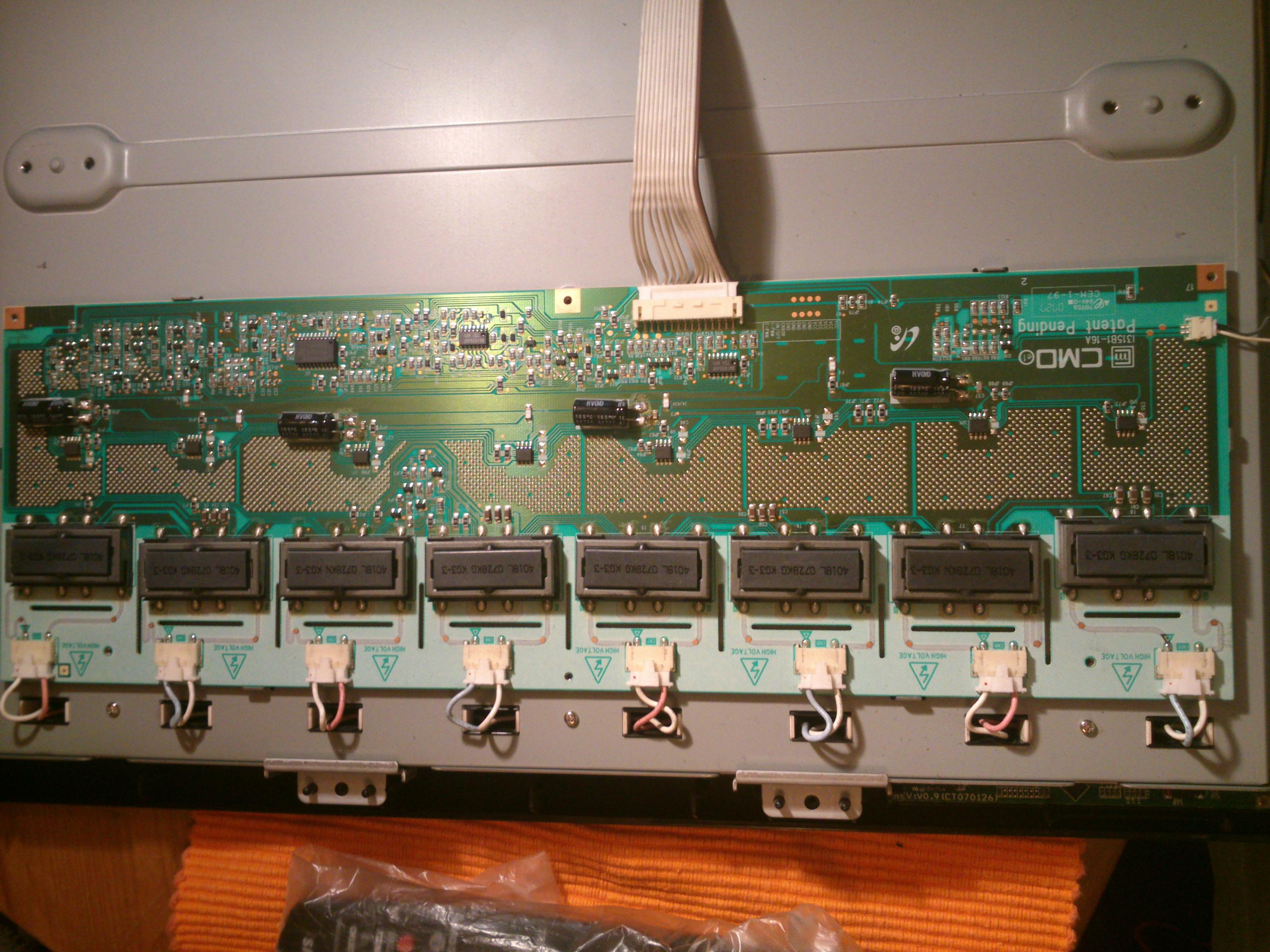

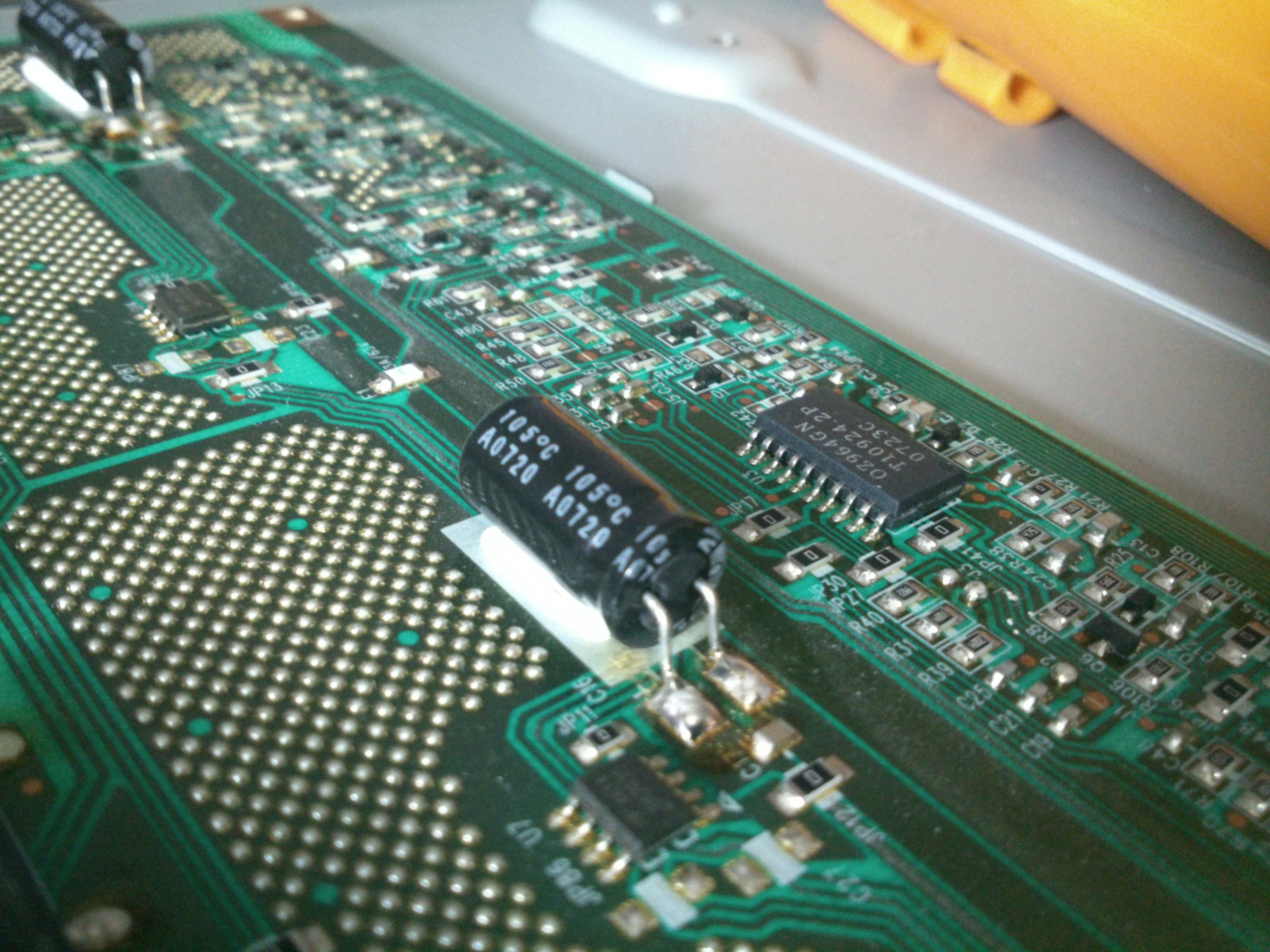

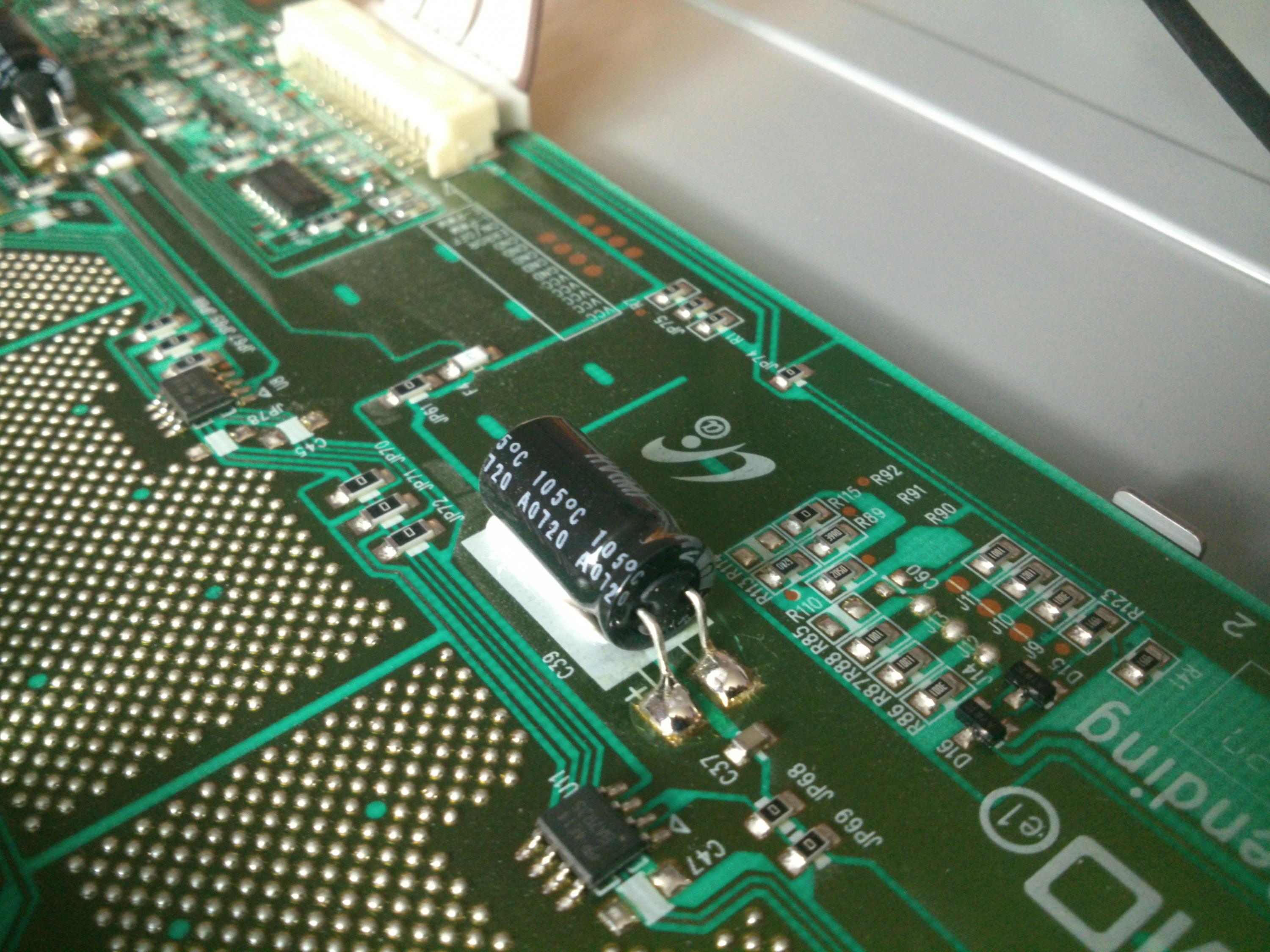

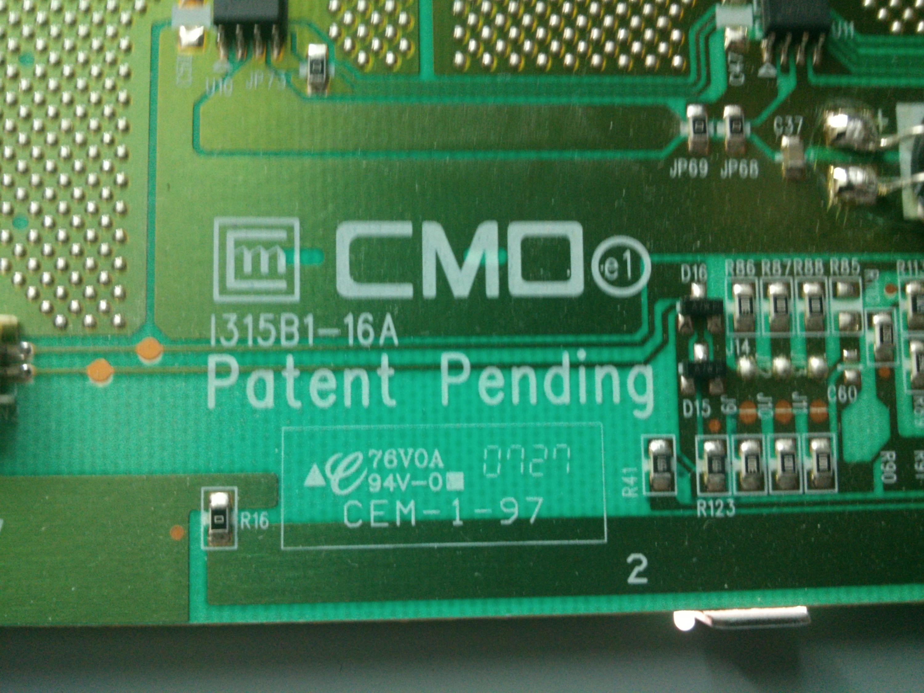

                    TV back light now shuts down in about 20 minutes ,just second before back light shuts down i hear 1 second noise from inverter . i took a picture of capacitors on the board ,i don't know their value so i am not happy about taking them off because i don't know if they are available in my electronics store
                    Inverter is marked l315B1-16A
                    i found out that the capacitor value is 270uF 35V
                      #50
                      Check 24V to inverter is stable.
                        Constant 24.3V When backlight on .It has been 2 hours and still no sudden backlight off situations

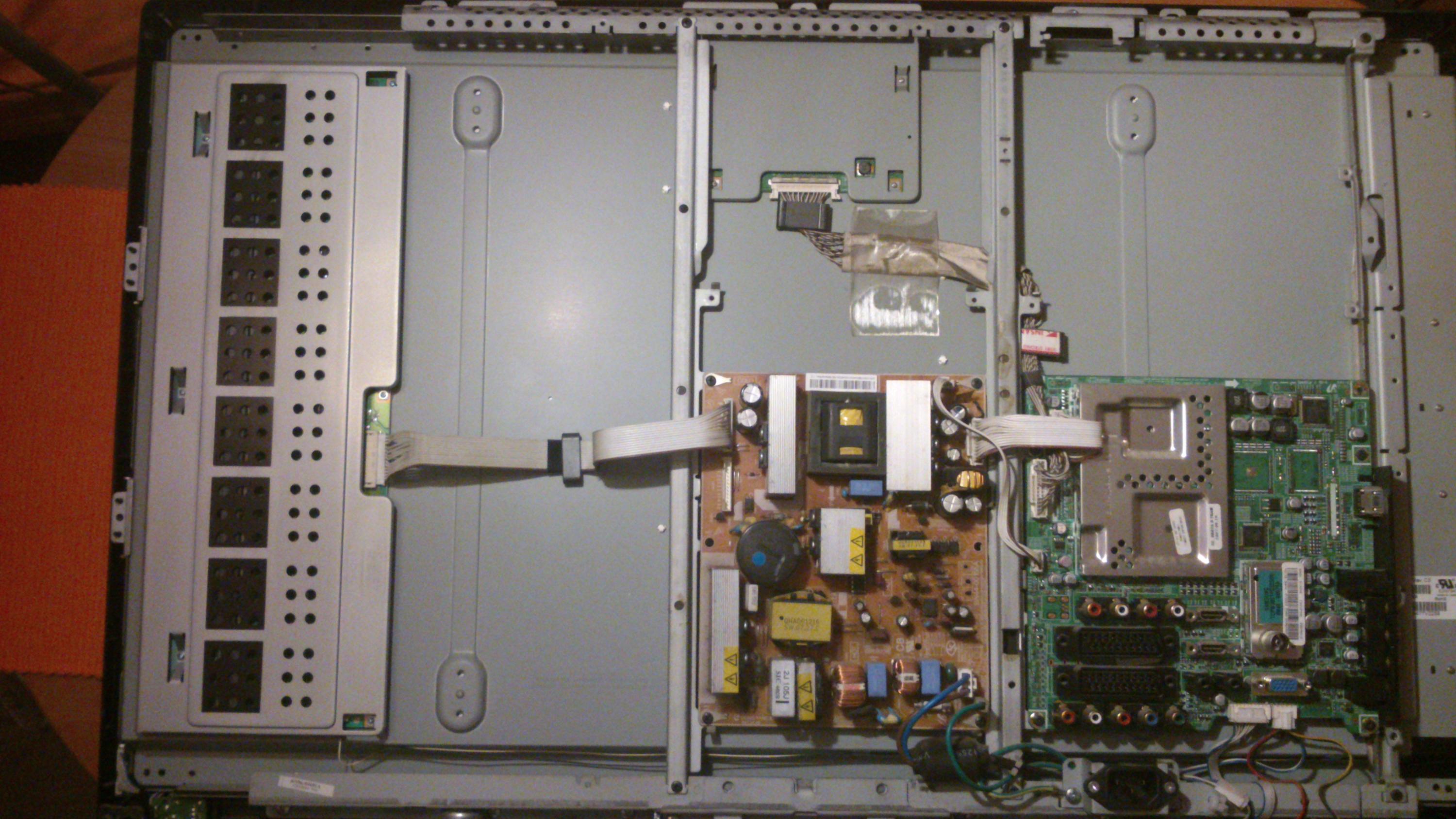

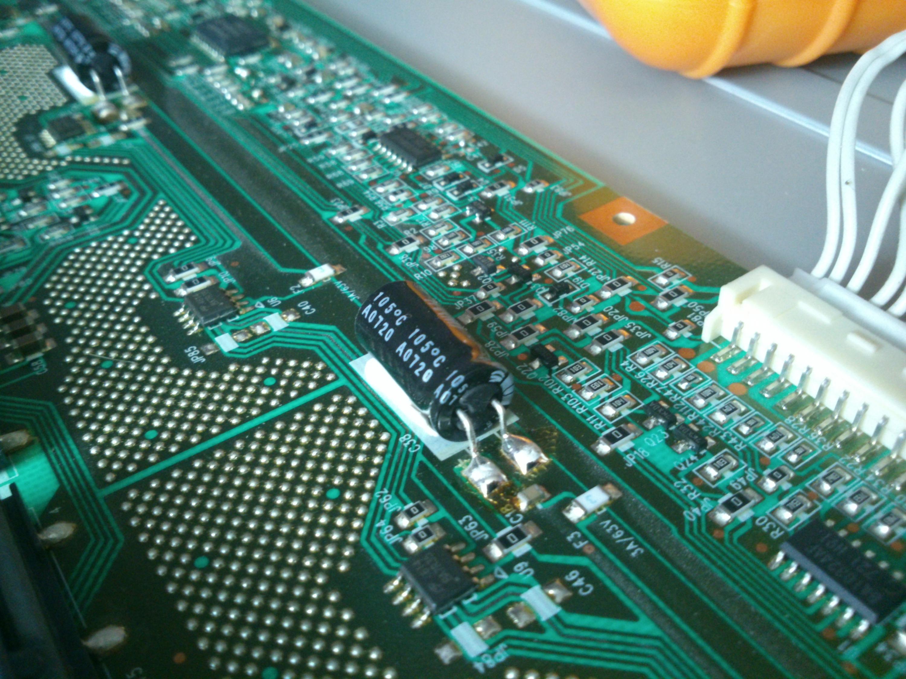

                          Perfect. I had the same issue and solved it according your description below. Thank you for this post.
                          Originally posted by bornintheuk
                          Take a pat on the back Mr retiredcaps.
                          Your observations appear to be correct in a round about way.
                          When you referred to BN44-00192A (instead of BN44-00155A)
                          I was puzzled and assumed you had got some threads crossed and took little notice of your comments.
                          I can know see I had posted the wrong image (of a BN44-00192A),
                          which I must have downloaded in my research. The two boards look remarkable similar, (maybe just a different Europe/ US designation}.
                          The point is, I decided to check the board again visually. I noticed a faint black line on the circuit board where the yellow adhesive fixes blue capacitor CM810,(44nf 1KV) to it.I figured that if this was some sort of leaky conduction path across the capacitor lead out wires it was capable of passing enough current to blow safety resistor RM801.
                          After chopping away a the adhesive and removing the capacitor I scraped away the (carbonated?) black line, (track). With capacitor reinstalled and a new resistor in place, TV was back in business. It's still early days yet, (two), but as the theory appears sound, I am quietly confident.
                          As an extra precaution, I have removed adhesive from around other components where a leaky path could develop.
                          Attachments show actual board BN44-155A and problem area before and after capacitor removal.

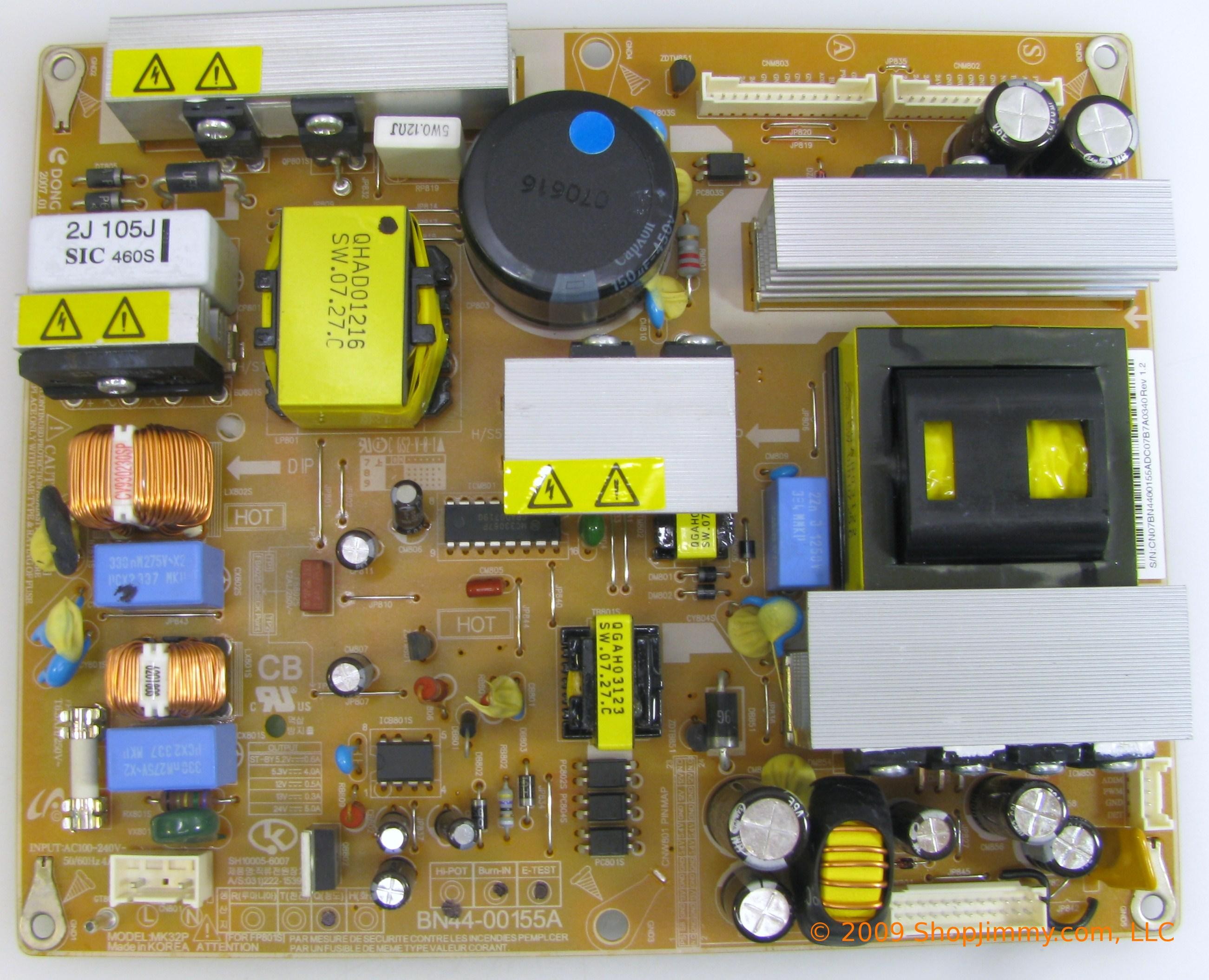

                                      I used Google Translate but do not quite understand the voltage readings.
                                      Picture courtesy of Shop Jimmy.
