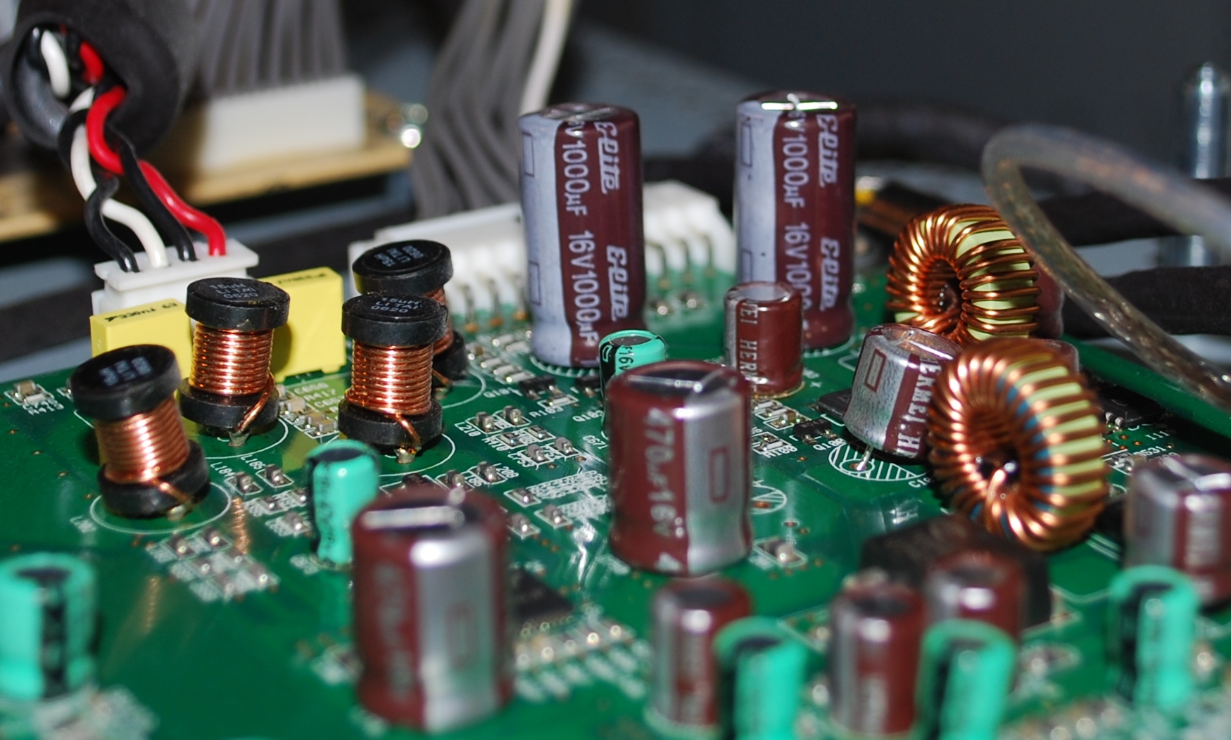

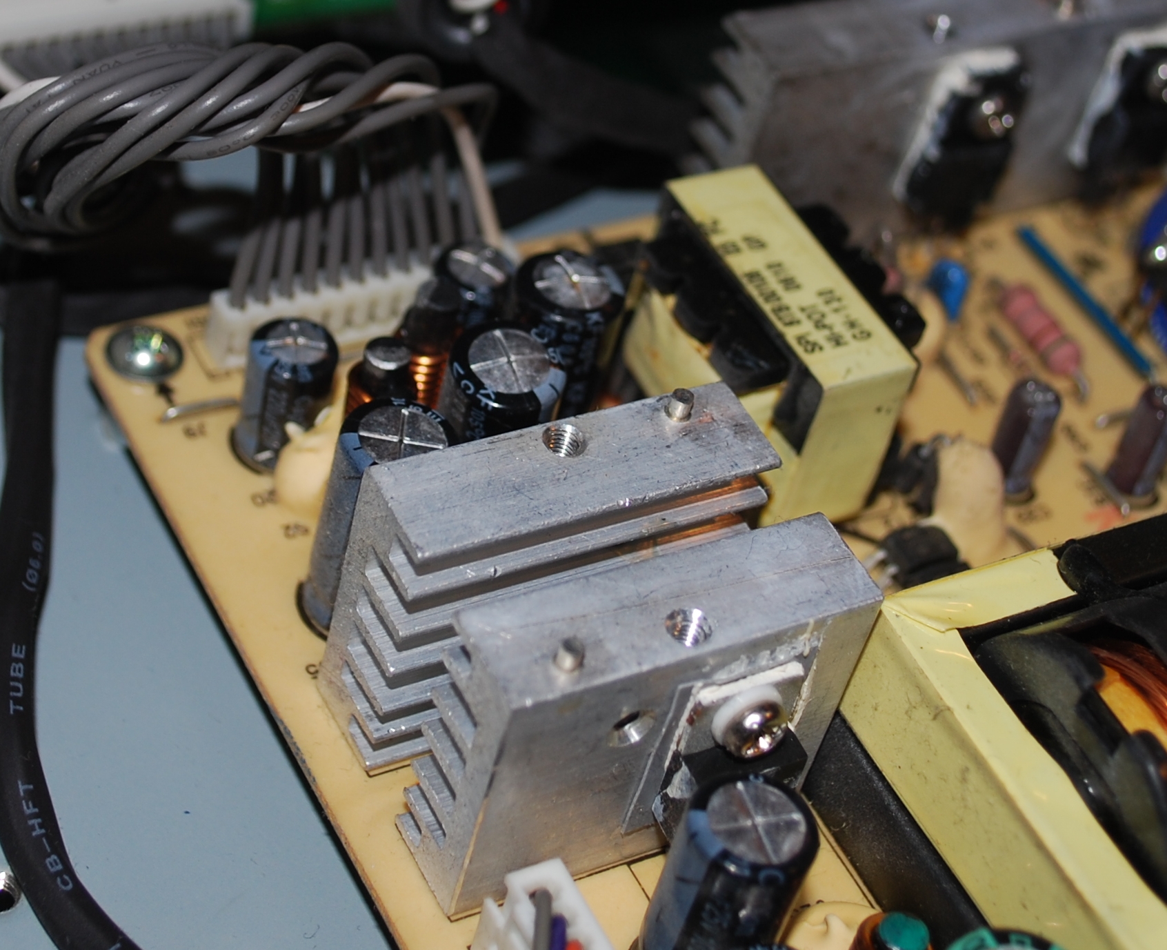

    Got it with power issues - previous user said it wouldn't turn on. I trust his observations. I also can't test ESR ... yet.

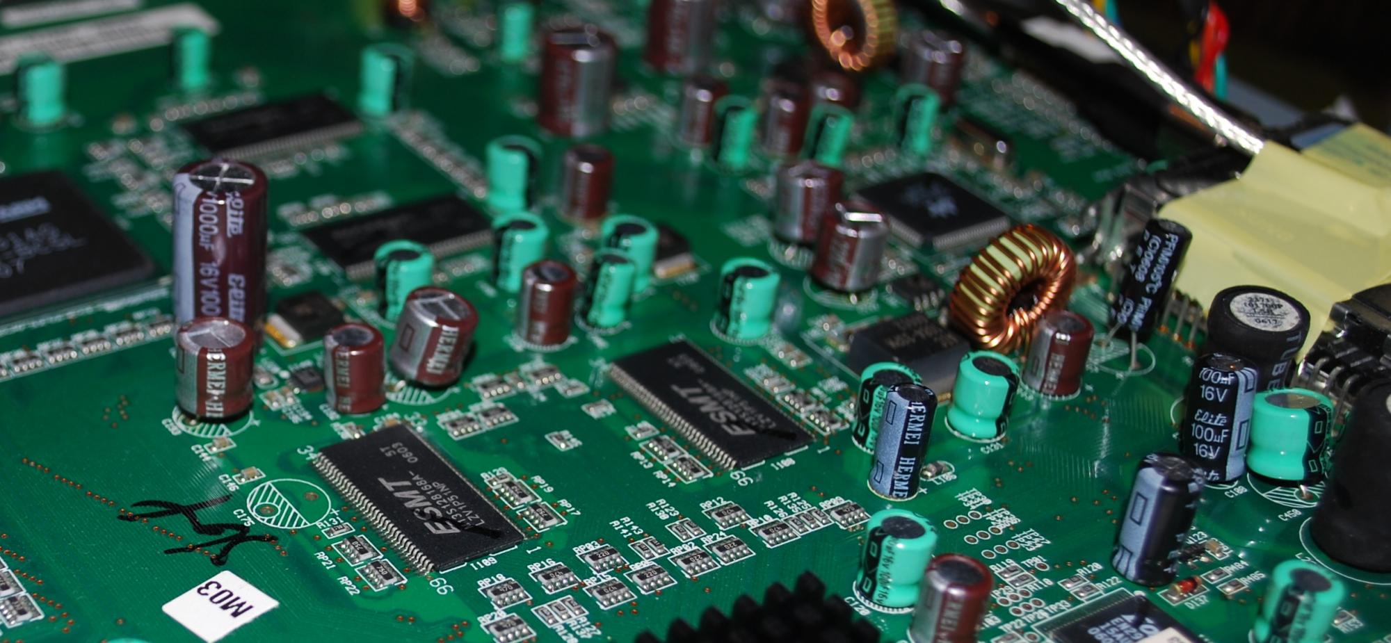

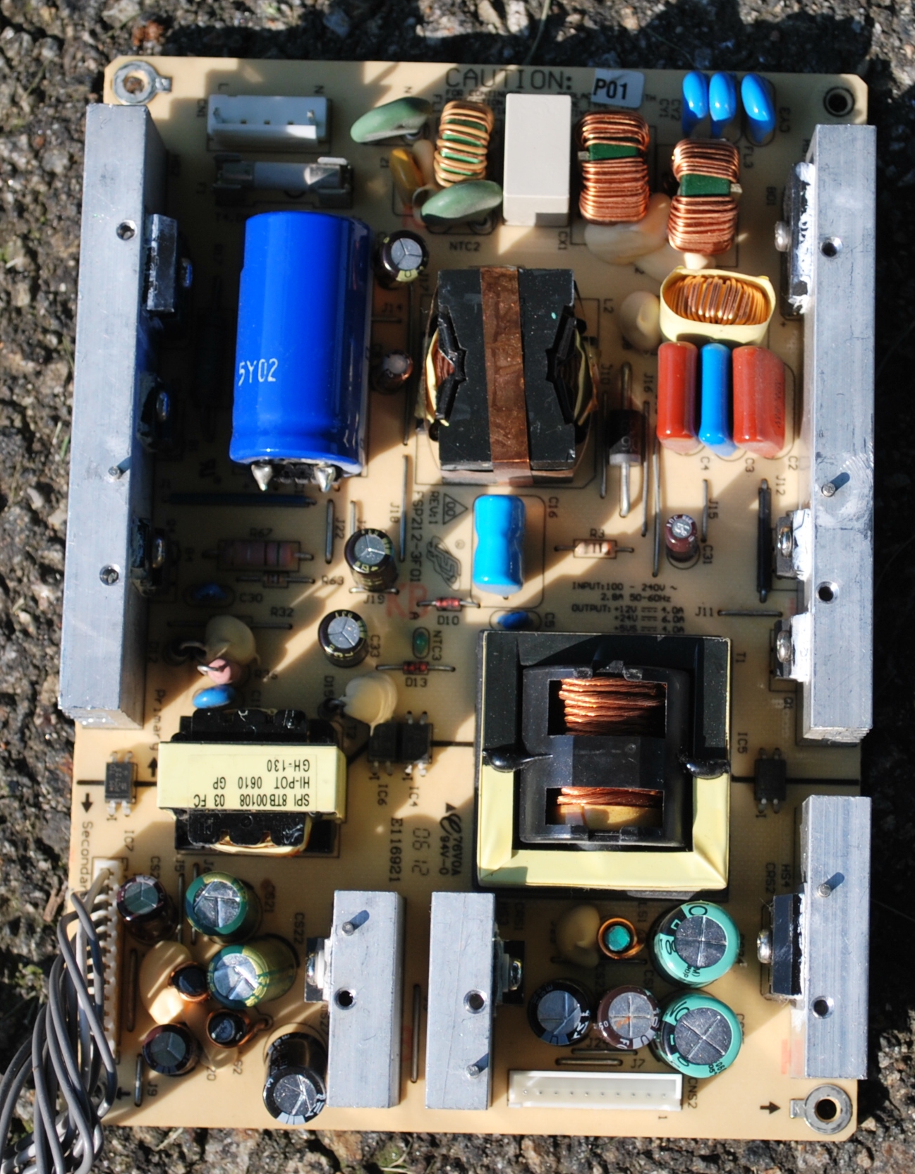

    Might not need to do so after looking at the power board. Here's what I found:

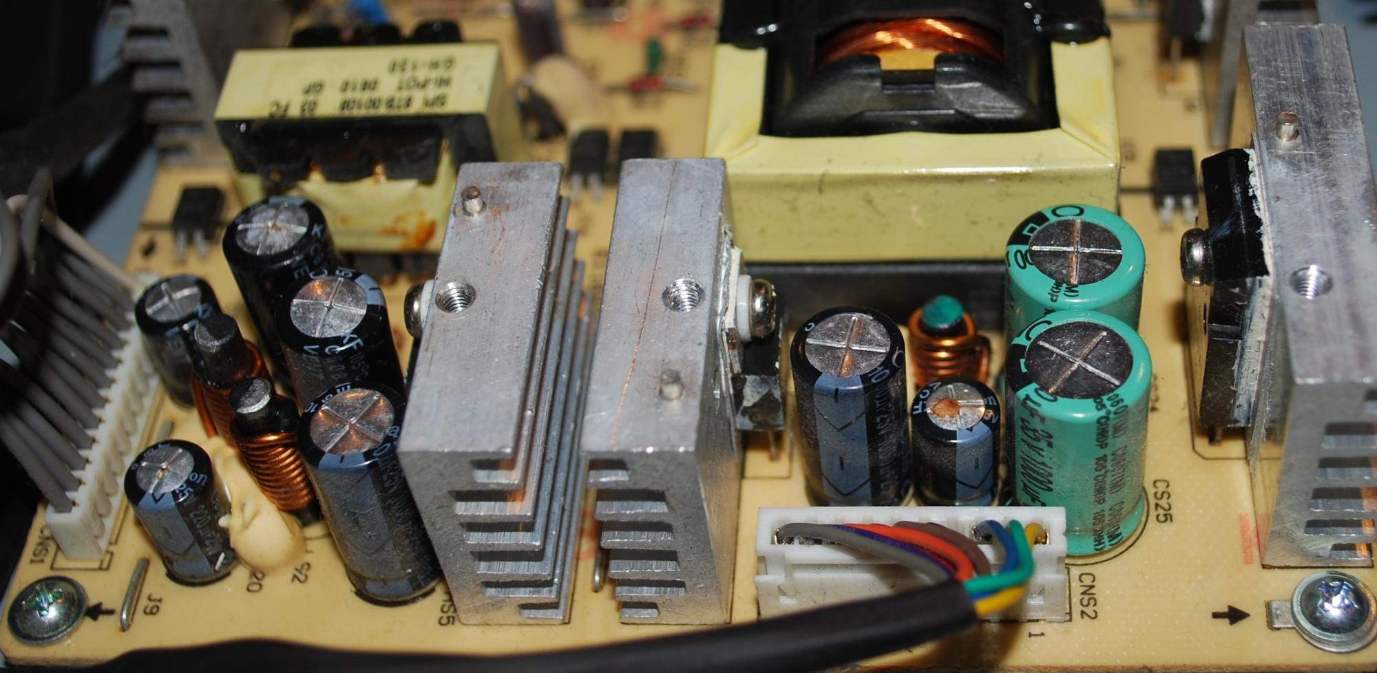

    CapXon 220uf 25V (all 3 popped)
    CapXon 1000uf 25V (both not popped - 20mm high, 10mm diameter)
    CapXon 1500uf 16V (both popped - 20mm high, 10mm diameter)
    I'm wondering if the Taicon capacitors need replacing (1000uf 35V). They're 20mm high and about 13 mm in diameter. I see "C0607(M)" imprinted on the side.
    The smaller capacitors are:
    33uf 35V (3)
    2.2uf 50V
    10uf 50V
    I'm thinking of replacing just the CapXon capacitors with reputable replacements that are the same in physical dimensions, capacitance, and voltage.

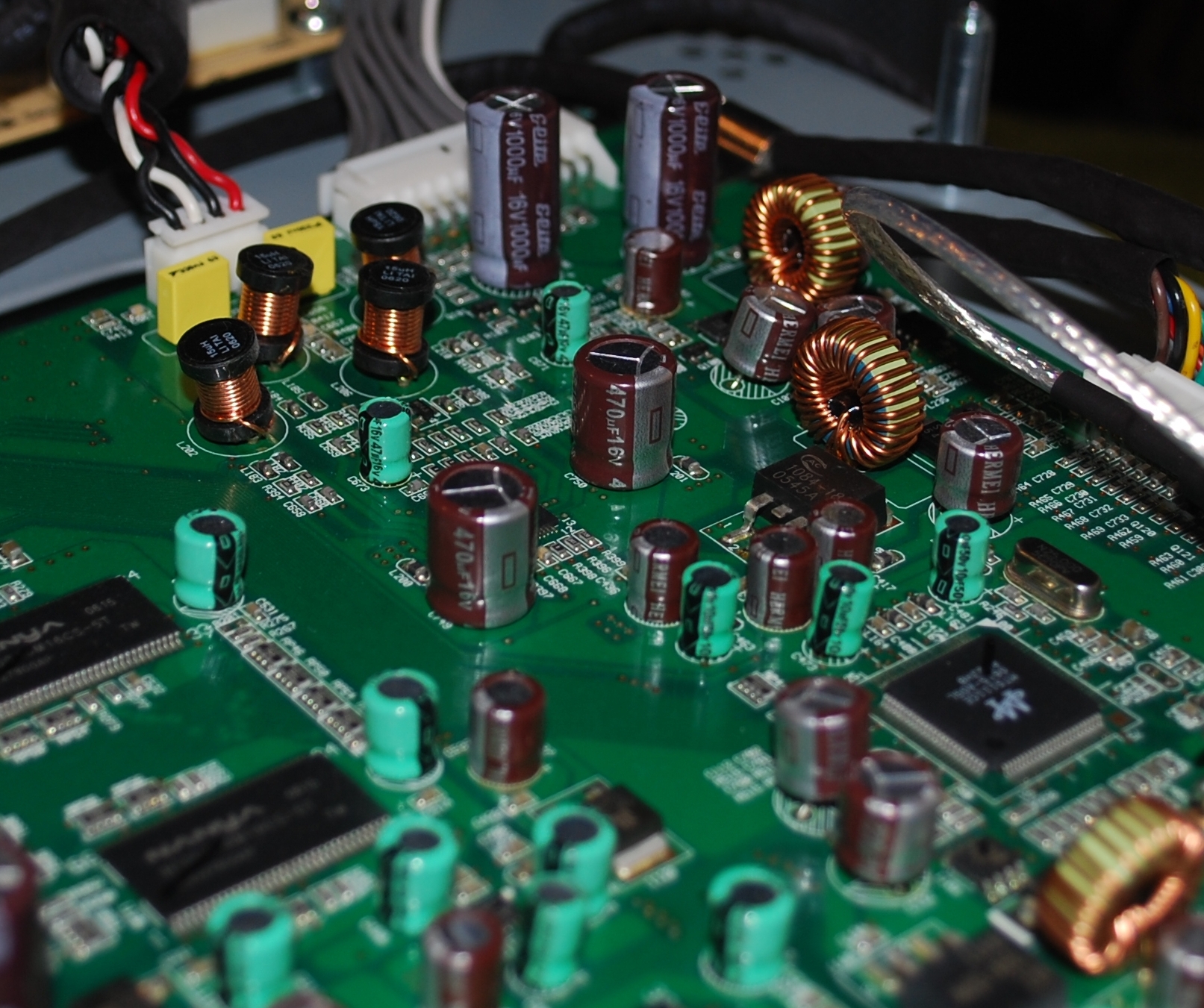

    I also see Elite capacitors on the video board. That makes me wonder.
    What else should I examine?

    Re: Replacing Capacitors on Viewsonic N2751w
    Replace ALL the electrolytic capacitors on the power board except the largest one which rarely, but not never, fails. Capxon caps bulged or not don't have the greatest track record or reputation. Use Panasonic FR, FM, or FC (in that order of preference).
    The caps on the logic board don't undergo the same stress or heat so you can leave them alone.

          ALL means ALL on the power board. The little caps play an important part of the whole system. In particular, there is a SMPS startup cap (little - between 22uf - 47uF @ 50V) that is key to the entire power supply properly starting.
          The little caps shouldn't cost more than 20 or 25 cents each.

                I replaced all but the Taicons (1000uf 35V) and the three 33uF (35V) caps.
                I still have no reaction from powerup, so I'm going to spring for the 33uF (and 1000uF) replacements. All the other replacements were from Rubycon, NCC, and the 1500uF caps were from Sanyo.
                I tested the 4A 250V fuse and got continuity.
                What's the likelihood I'll be looking for the root cause somewhere else other than the capacitors?

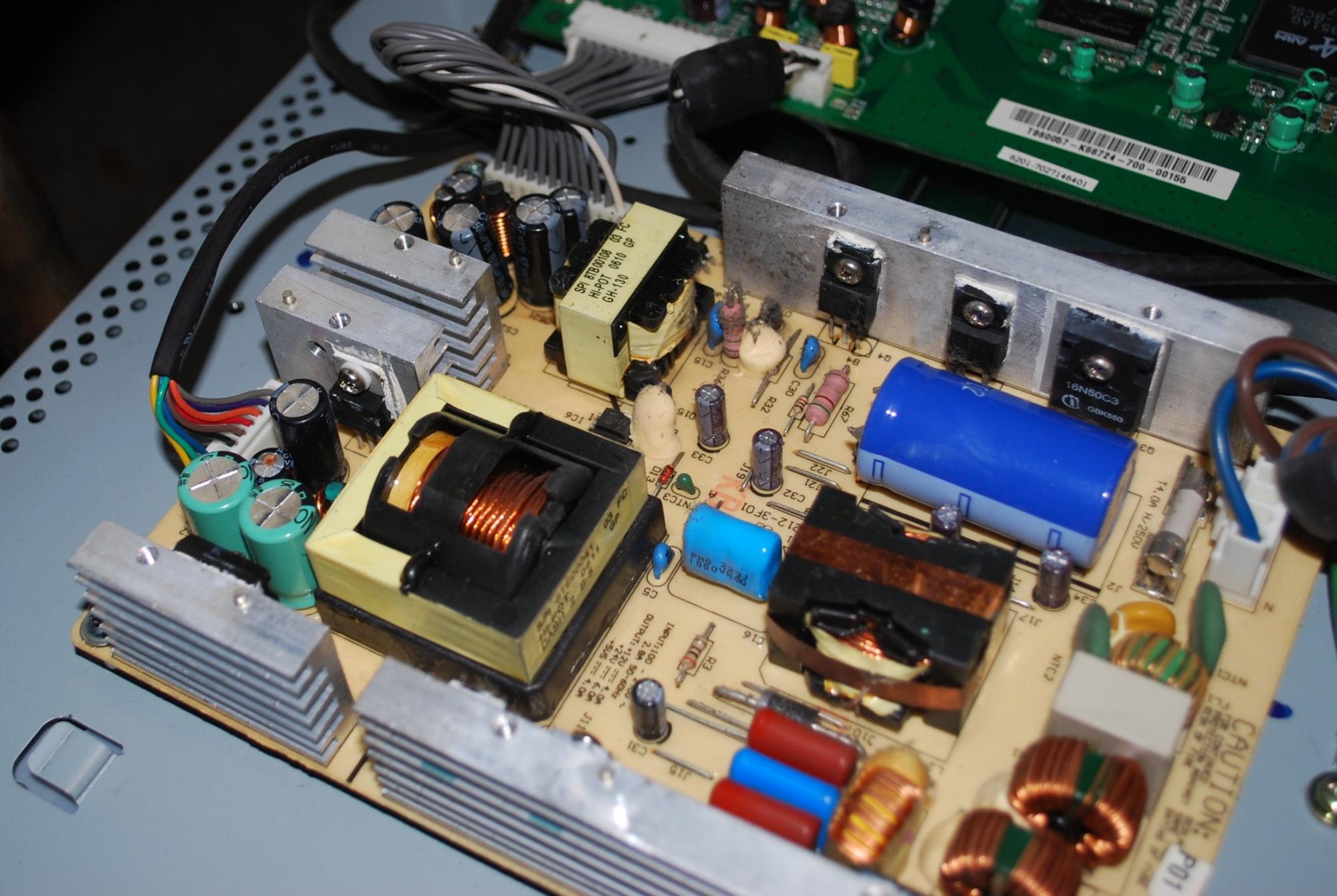

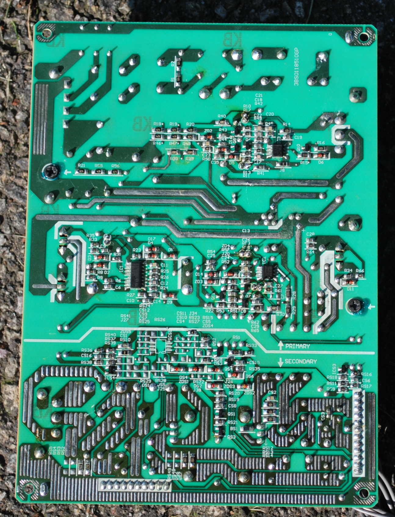

                  Hi - you will need to post some more photos if we have to look elesewhere.
                  Please post good clear pictures of each board, straight on, front and back and close up of connectors, (max resolution 2000x2000 and 2MB) using the manage attachments button, which is found by clicking "go advanced" under quick reply.
                  Examples of what is needed
                  https://www.badcaps.net/forum/attach...1&d=1290283049
                  https://www.badcaps.net/forum/attach...7&d=1280167246
                  You can test for power at the BIG Cap. Multimeter on 600vDC
                  You have to observe polarity so positive probe on positive leg of Big cap
                  and negative probe on negative leg of big cap. - Dealing with high voltages
                  so care required and heatsinks should not be touched. Post result.

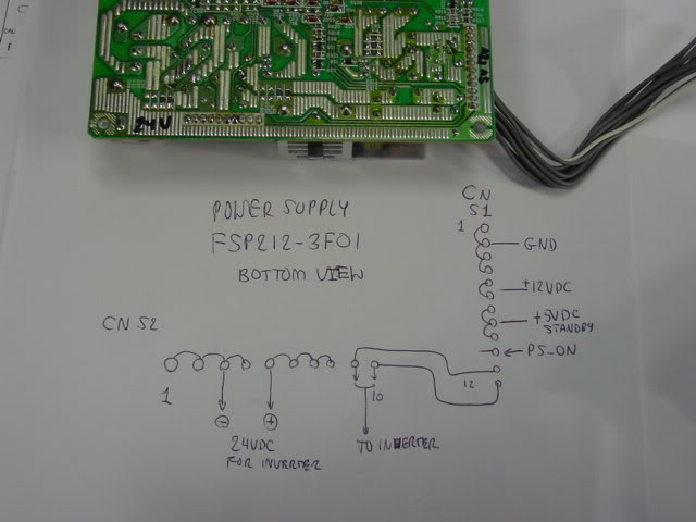

                        Please see attached pictures for the 5VDC standby test point on the board.
                        You may have real bad problem with bad transistor and Zener diode also.
                        http://photobucket.com/images/pwr%20...20fsp212-3f01/

                          Can you do this- to establish we are getting primary voltage.
