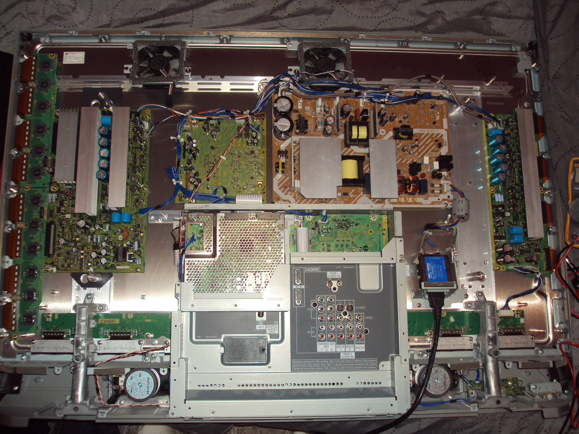

                  Re: panasonic th-42px60u power problem no light

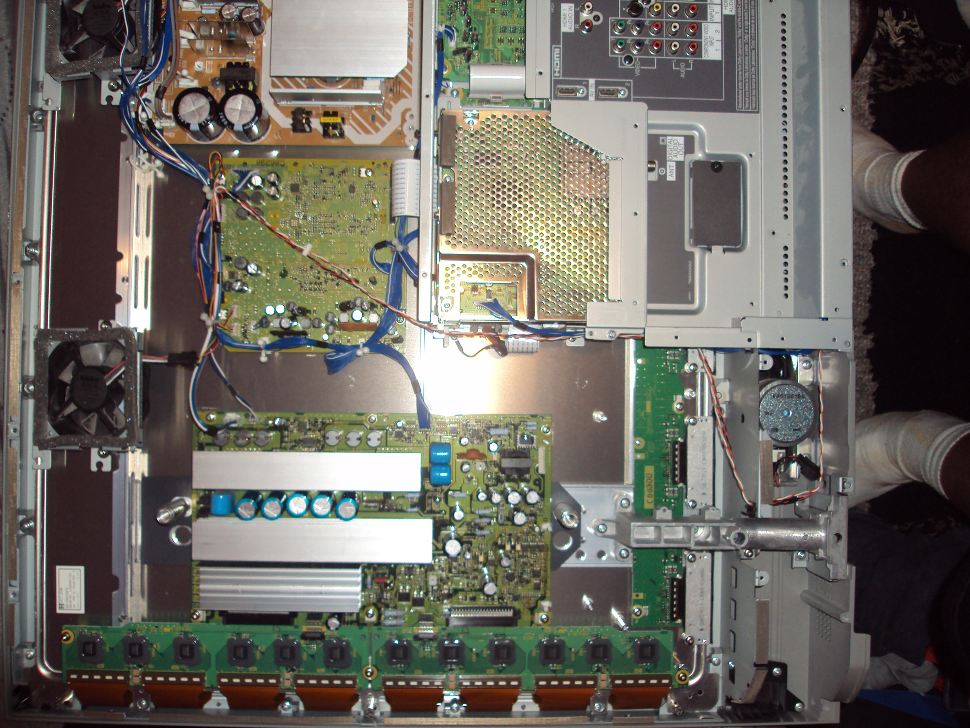

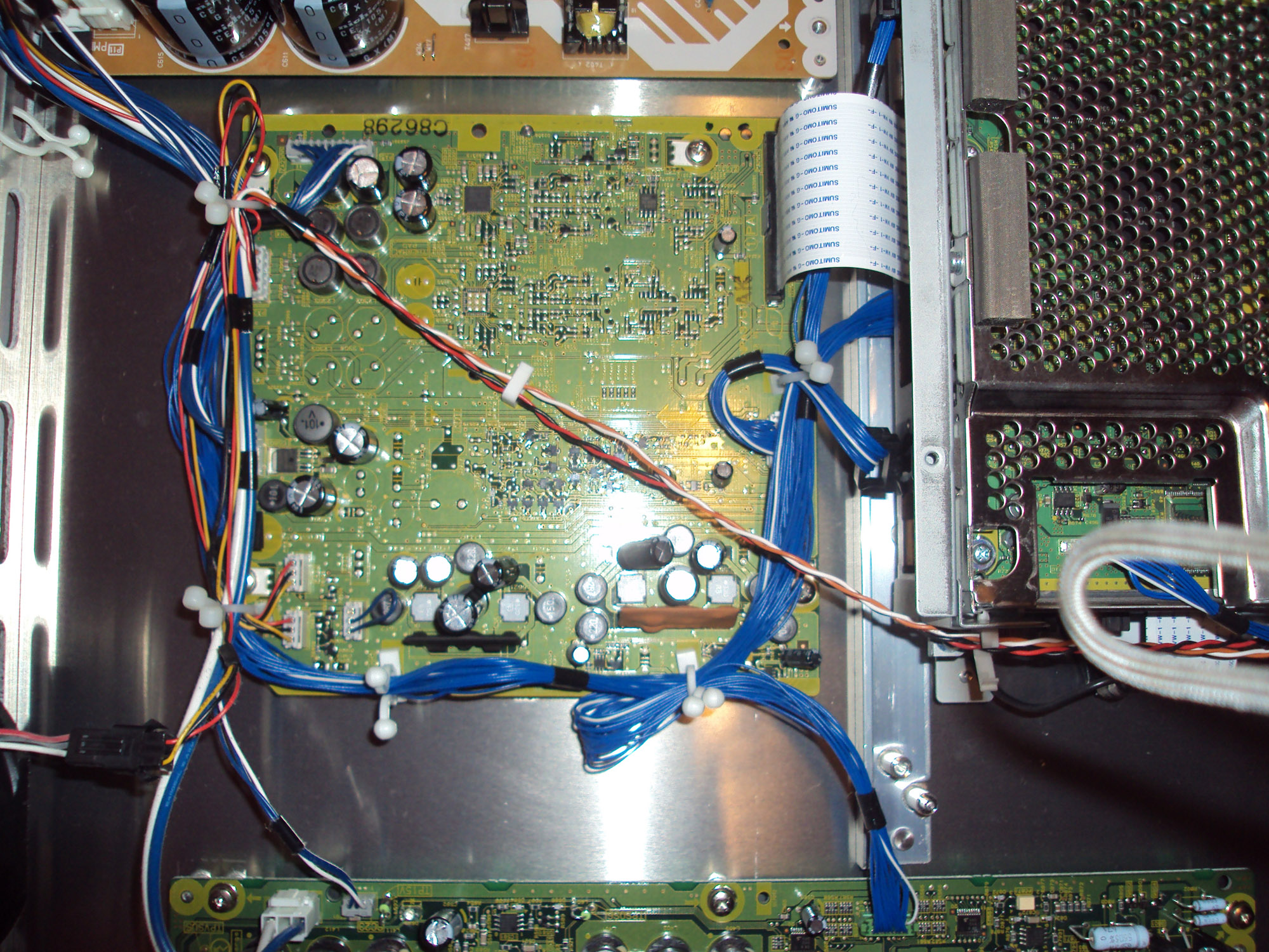

                  Could you post a well lit pic of the central back area taken on about a 45° angle from left to right? Be sure to include the P, PA, and the DT (the perforated silver box).
                  I want to verify something for the next step.
                  I'm looking for the DG connector.
                  I think it's on the board under the DT (box) and should have a white ribbon-style cable going into it.
                  veritas odium parit
                  • gmzombie
                    • Sep 2009
                    • 83

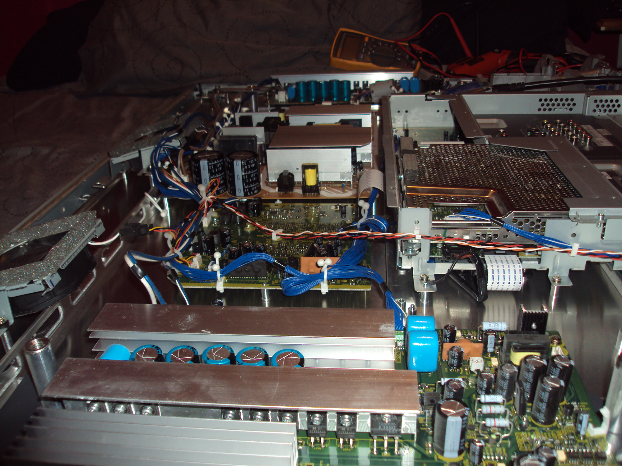

                    #29

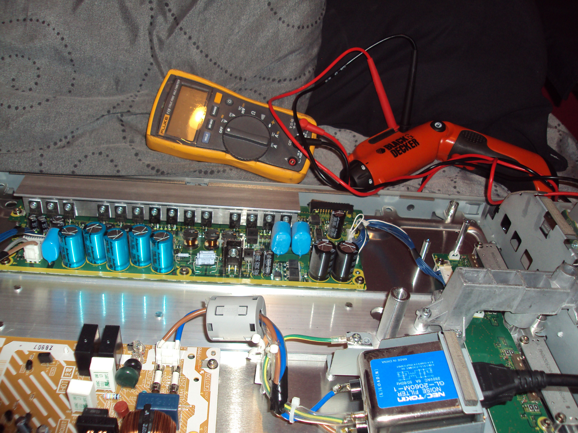

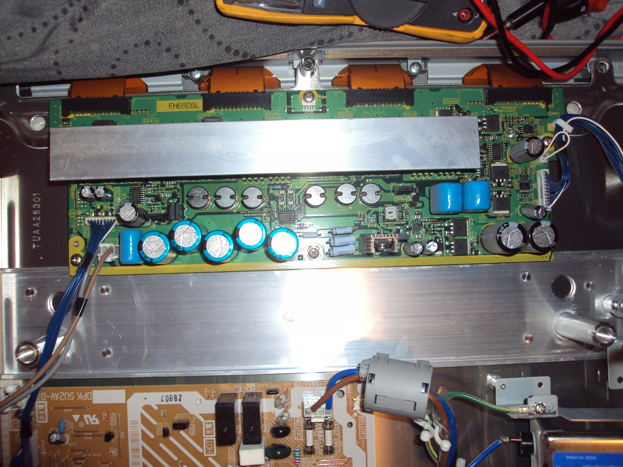

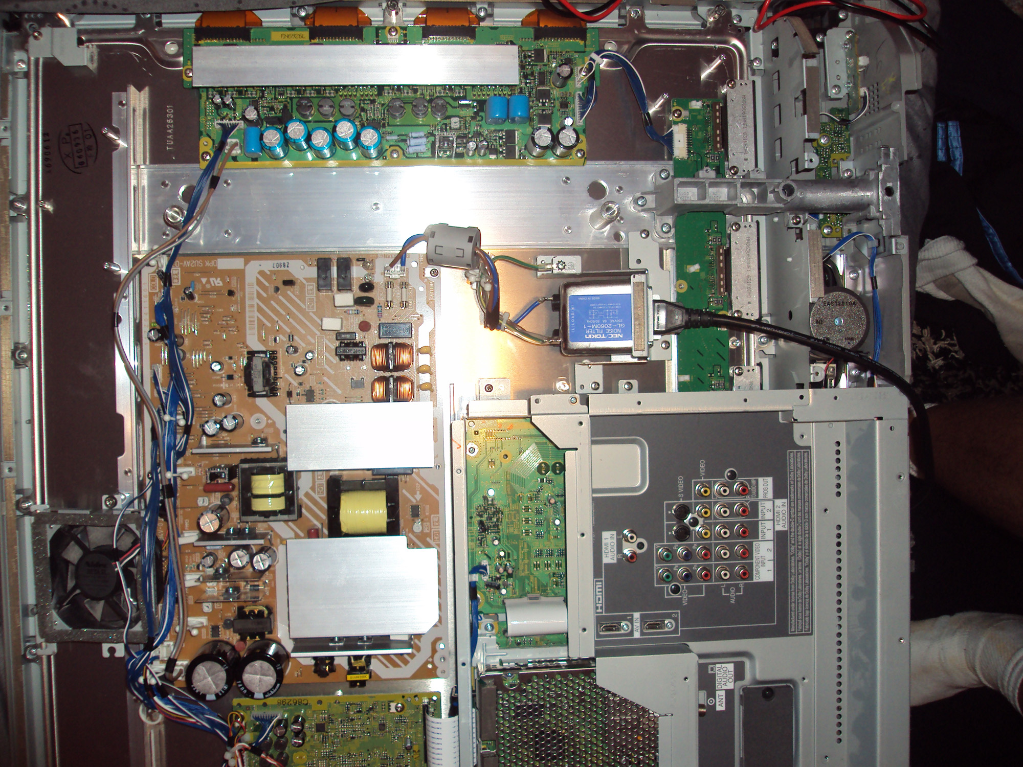

                    ok here are some pics i have a few more im posting now...it wouldnt let me post them all?
                    • gmzombie
                      • Sep 2009
                      • 83

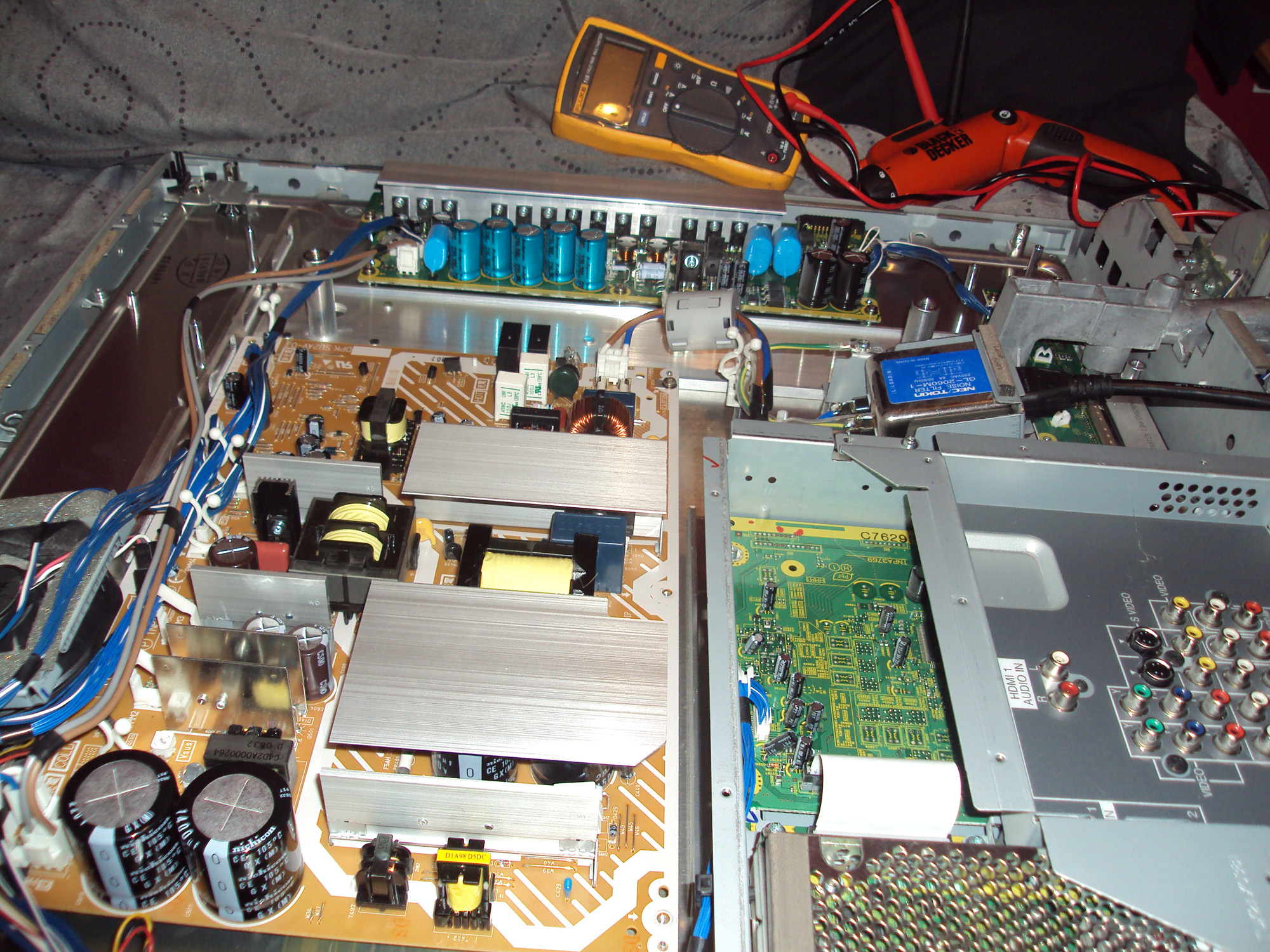

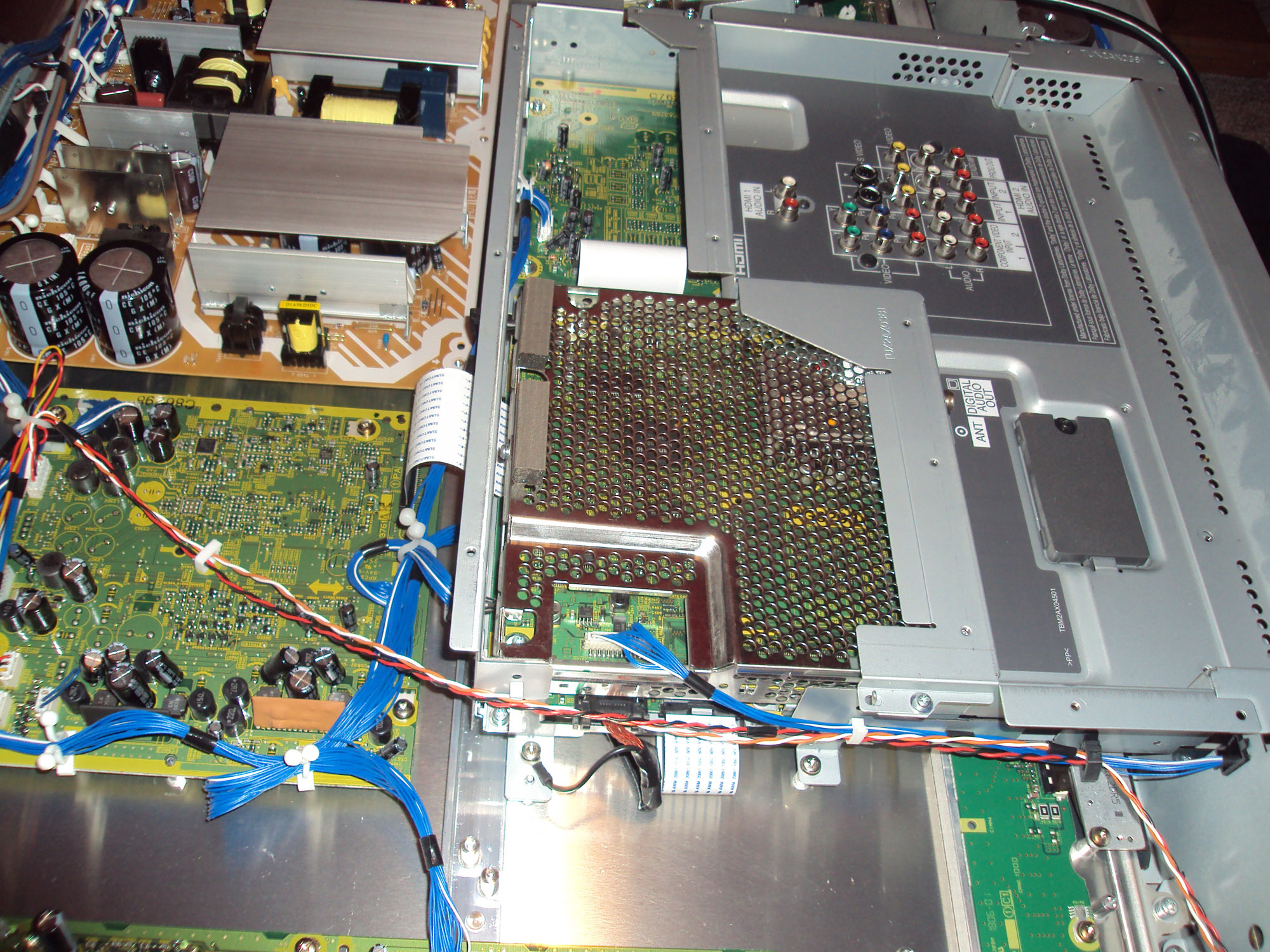

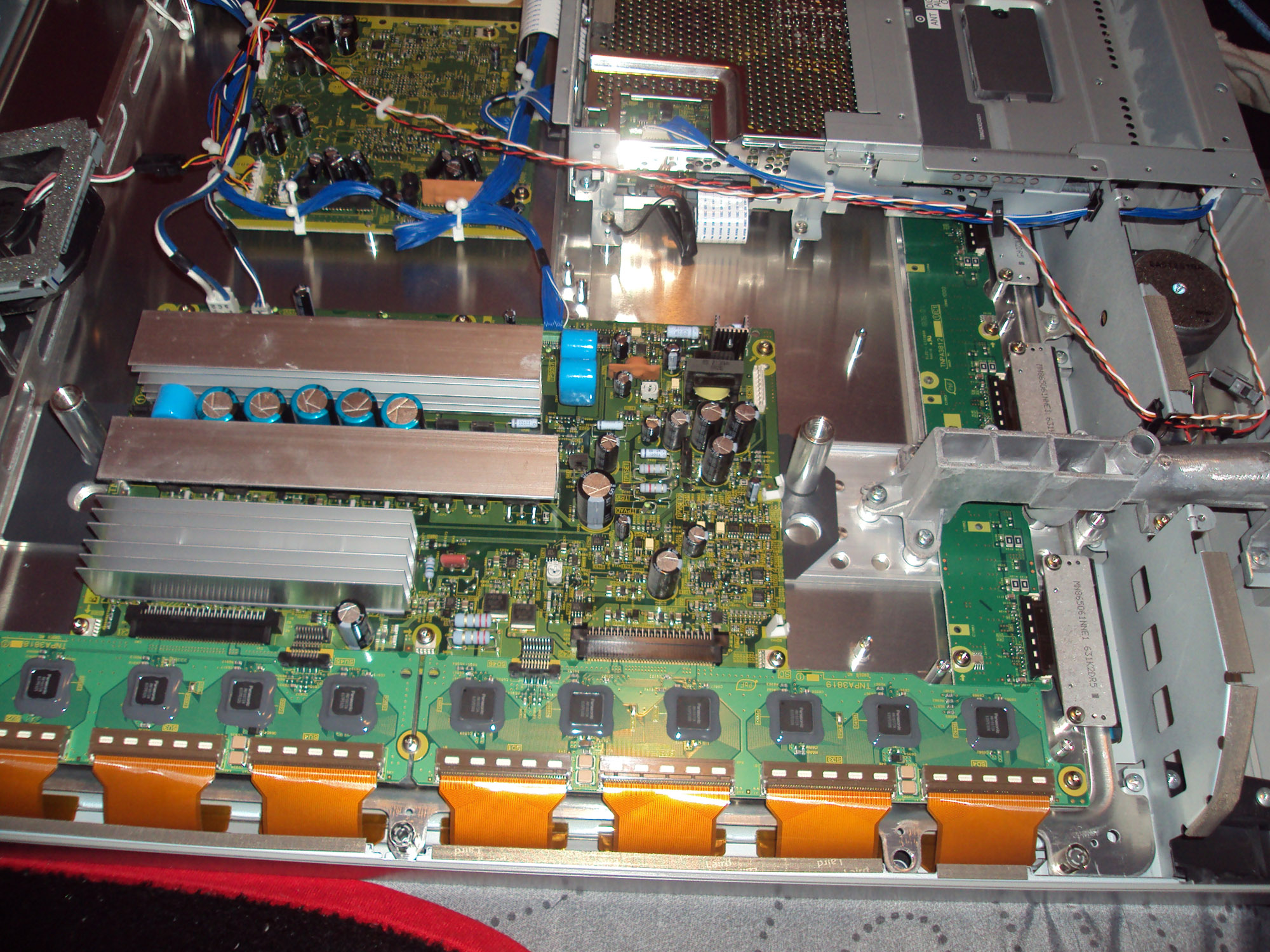

                      #30
                      2nd half hopefully these help

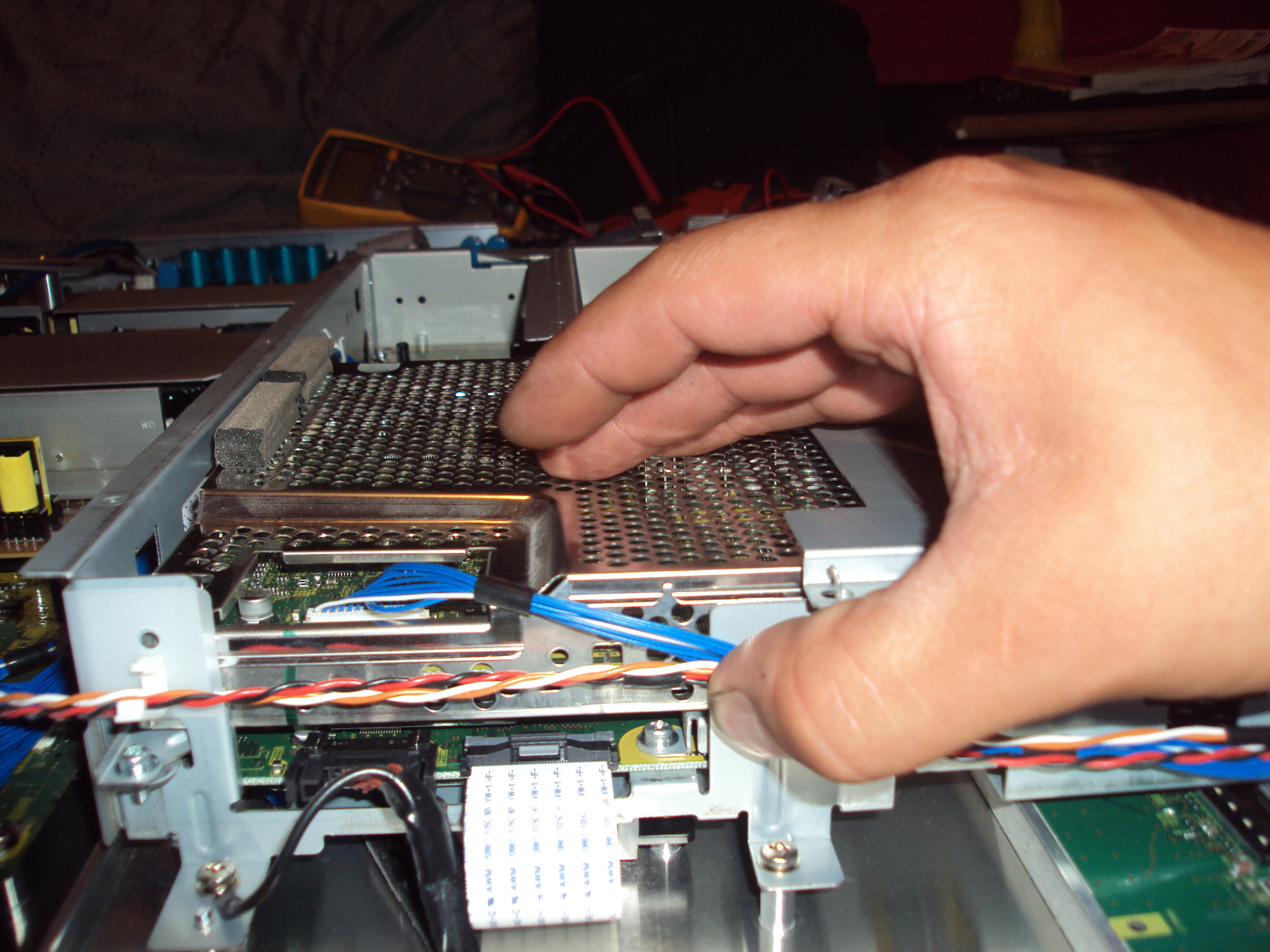

                      • Toasty
                        • Jul 2007
                        • 4171
                        #31
                        At this point in the testing, the P board is no longer suspect.
                        Unplug the TV.
                        At the end of the flat white cable under your hand in the 3rd picture in the first set of pics is the DG3 connection. I am not sure if there is a locking mechanism in place on that cable or connector. Some use a clip. Some use a pressure clamp. Be careful and don't pull on it until you look at it carefully.
                        Disconnect connector DG3.
                        Plug the TV in.
                        Do the relays click after the TV is plugged into the AC line?

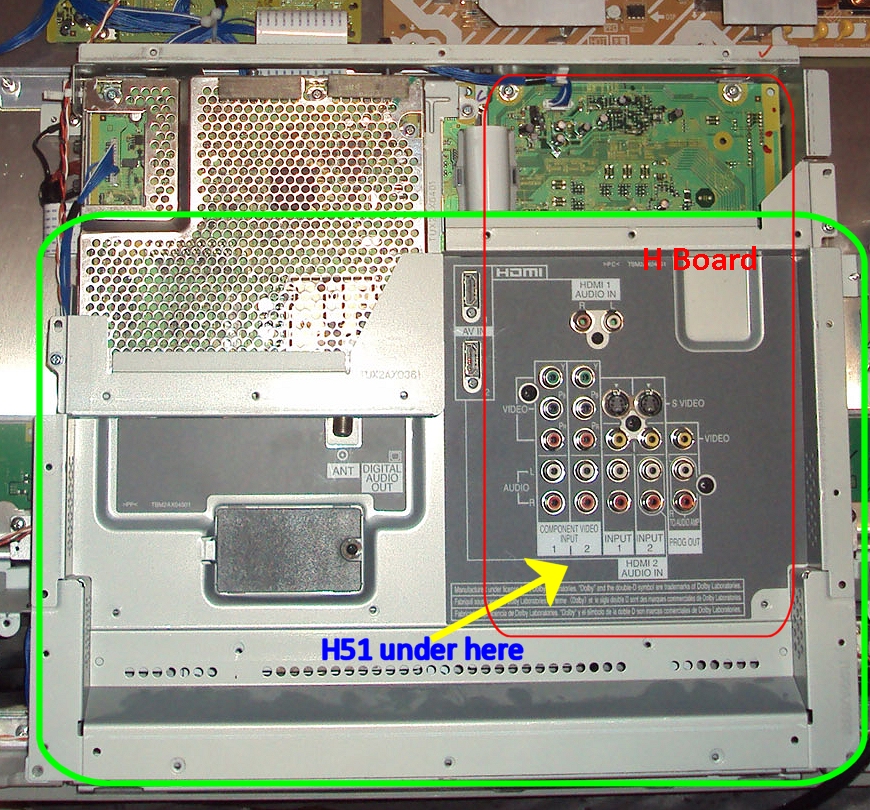

                          • Toasty
                            • Jul 2007
                            • 4171
                            #33
                            Unplug the TV.
                            Reconnect the DG3 connector.
                            See the attached photo.
                            Disconnect H51 from the H board (red outline).
                            That's the board with all the RCA and other types of input jacks on it for the set.
                            The connector is towards the bottom (as indicated), under the area of the panel where it is marked:
                            Component Video
                            Input
                            1 2
                            You'll have to remove that framework around and over it (one big piece outlined in green) to get to the connector.
                            Once it is disconnected, plug the set back in.
                            Do the relays click?
                            If not, the H board is defective.
                            If yes, more to check.
