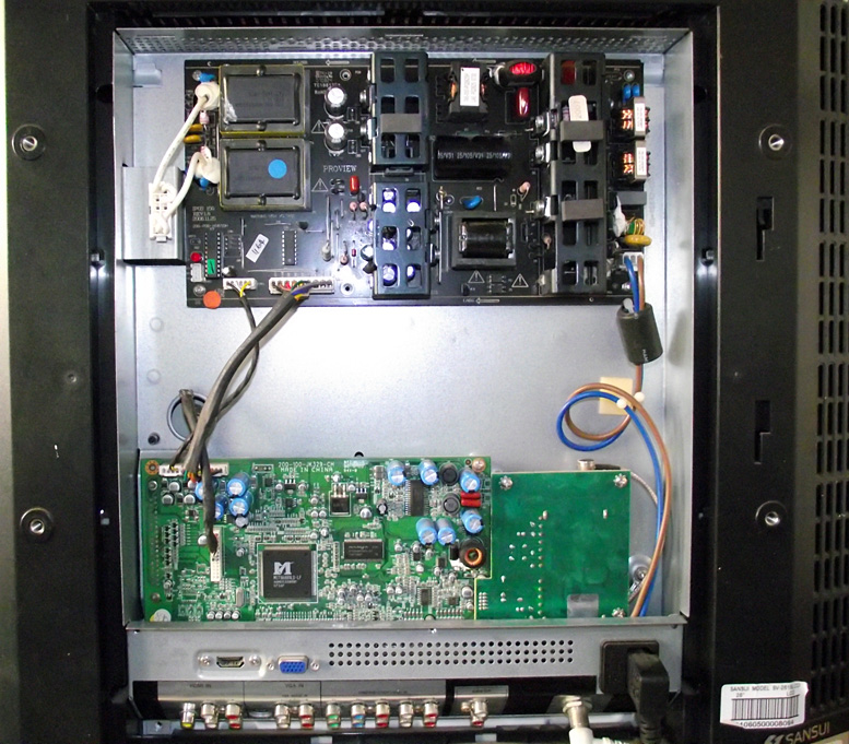

    Sansui SV-2615 LCD
    This set cuts off the screen, sound remains OK on that station but doesn't change to other stations.
    Needs to switch off and on again to bring picture [perfect picture].
    Takes longer to shut screen when it's cold, and less and less as it warms up.
    I checked the power board for d/js and used a computer fan to extract heat, to no avail.

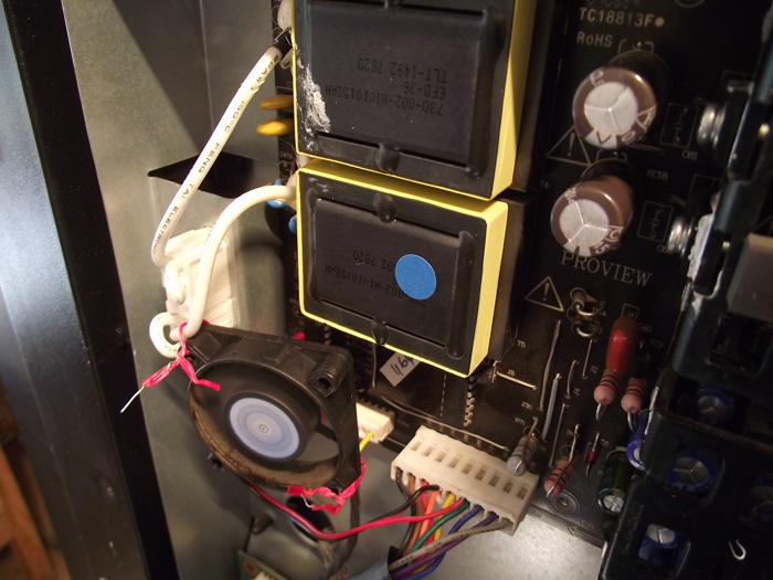

        The set is right now holding its picture, since I connected a computer fan, as you see in the picture.
        There is a small cap nearby, but maybe the culprit is the chip - assuming the fan has located the problem area.

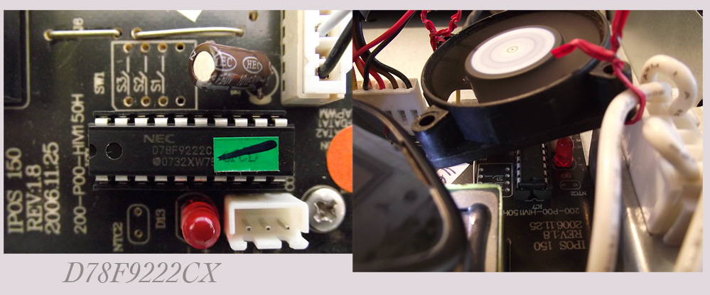

            While blowing air on the IC, it's holding picture!

              This inverter IC could be the culprit, after all.
              I haven't got one at the moment.
              Just sent an email to Mastercare Sparescare, here in Johannesburg to see if they stock it.
              I have told the customer that the set is holding nicely while the fan is going - a low noise one, by the way.

                Looks like it's in a DIL socket too, should be a simple replacement

                  That appears to be a microcontroller. It may have a custom program stored in internal ROM, so a new chip might not work. It is strange that the chip is socketed.

                    Did you physically feel this chip heating up?? Chips like these usually dont. The chip to the right of it is the PWM. I'm about to change one out in a board that I have. Does that Red LED on the left bottom corner of the power board ever turn on?

                      Yes, when the screen turns black, the LED goes on/off at slow time.
                      The IC wasn't hot at all, nor could I detect an increase in temperature prior to the fault showing up.

                          To me, the flickering LED meant no power going through the inverters.
                          By the way, I'm trying to get the faulty IC, but it's looking hard.
