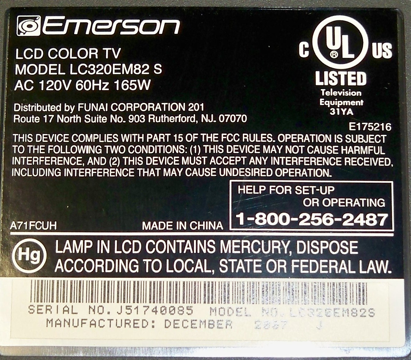

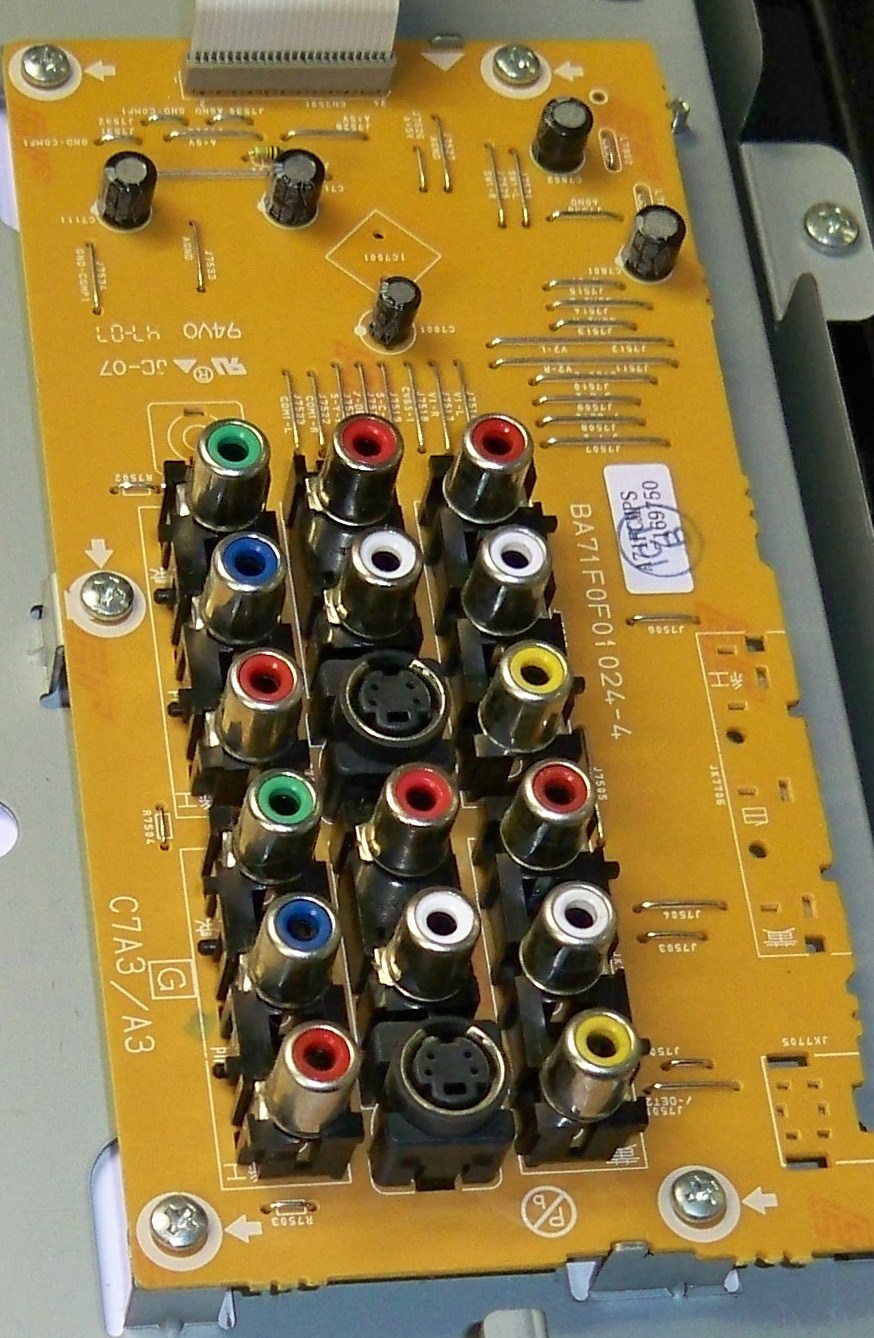

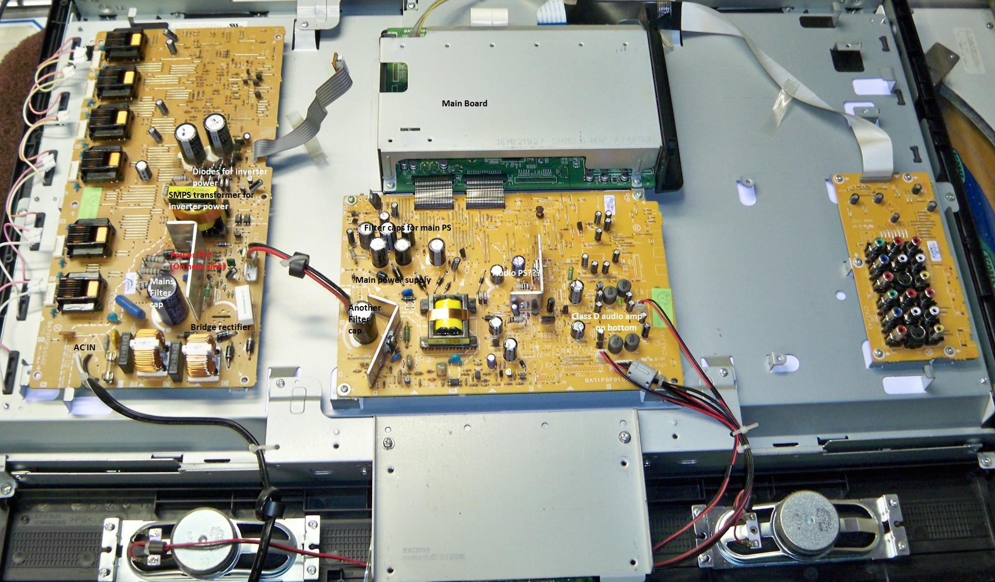

    hi guys. Just picked up another craigslist gem. Its a 32" emerson lcd.
    Looking at this set, it appears to run the same chassis and plastics as a sony bravia. I will document this set with several pictures so you can confirm or deny my suspicion.
    WHen powered on the led goes from red to blue, tv comes up with a picture, then tv immeadiately shuts down, back to red standby led. I have been told its been fussy to power on for awhile now and finally got to the point of not staying powered on now at all.
    I suspect bad caps. Getting ready to tear it down now. WIsh me luck.

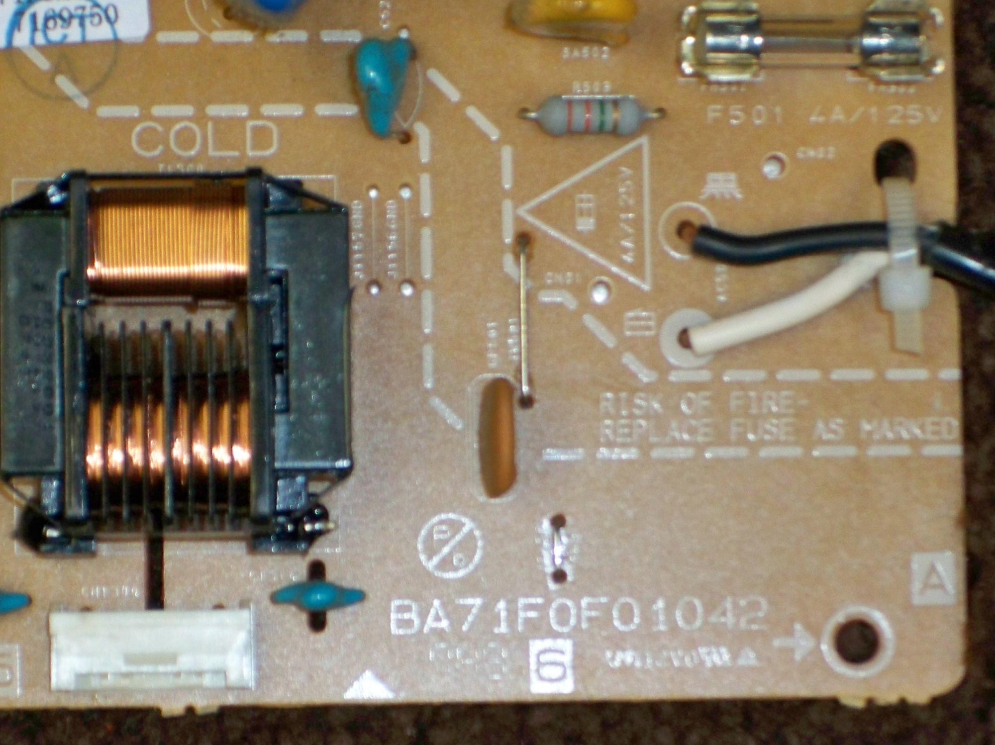

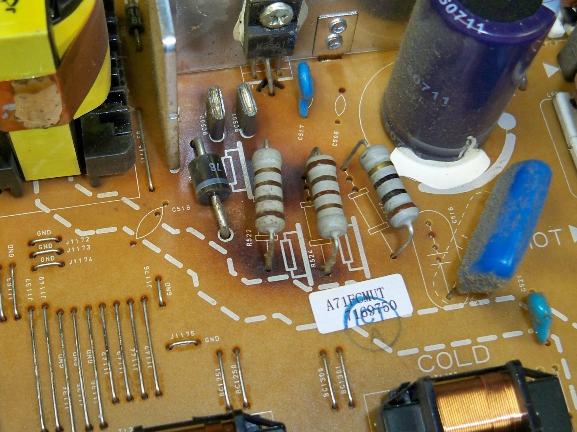

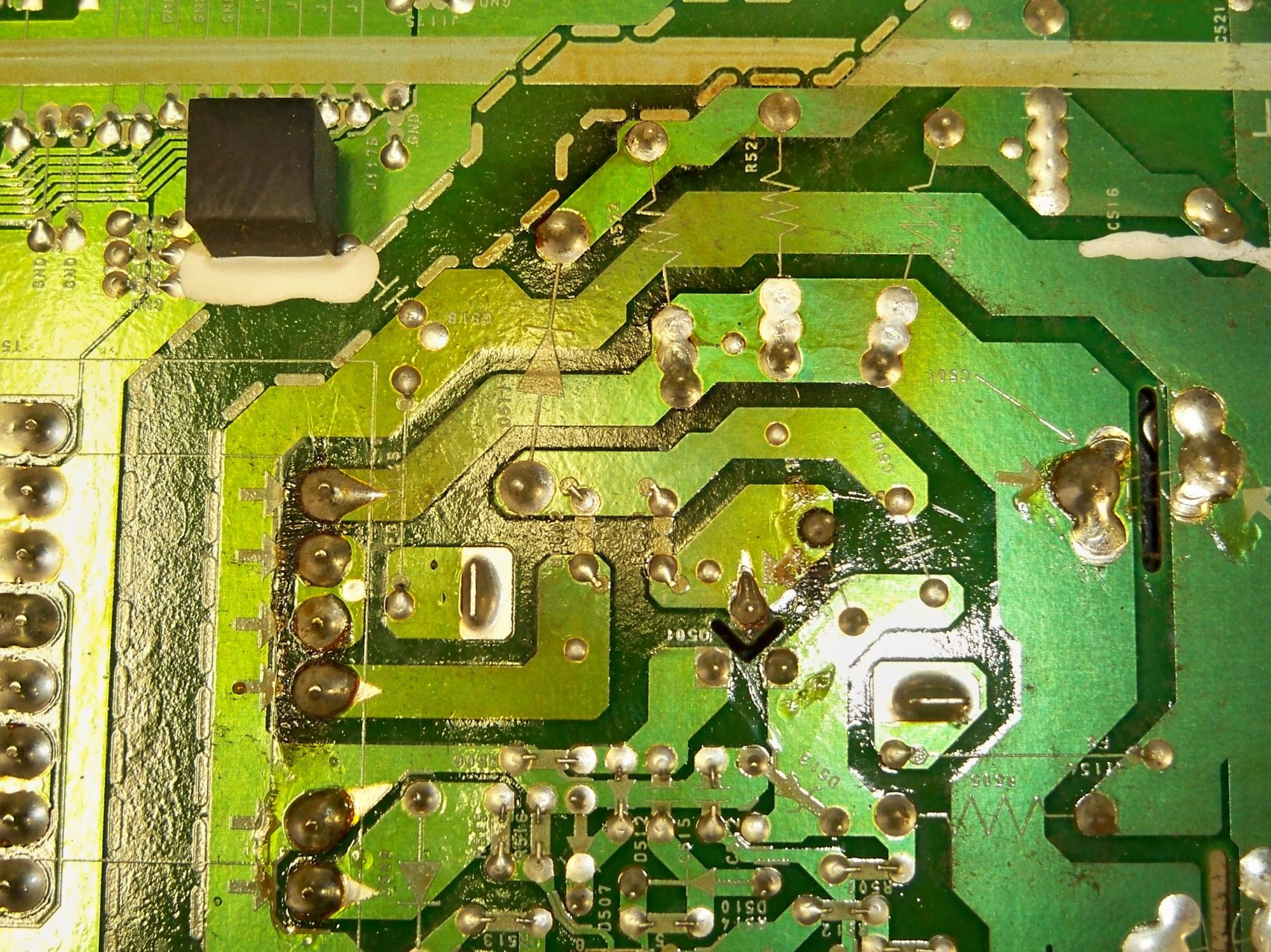

      nope, im hosed. for the life of me cannot find this issue.
      so far ive found bad solder and reflowed:
      bc502, d511, r522, r524, r520, d504, d558, d552, d555, d553, bc552, c511, both coils "C" AND "D", AND all jumpers to inverters. NO CHANGE.
      replaced a few caps for giggles (ont he secondary power board) c648, c811, c639 and NO CHANGE.
      On the two pin connector between power/inverter baords i have 163vdc at all times.
      i did find that half of the inverter board transistors ohm out at 37 ohms between the 1st and 3rd leg, thinking i had a bad xixtor i lifted the right leg on each, the low ohms is not in the transistors, apparently im showing that reading due to something else on the board, this may be normal.
      SO at this point i dont know where to go. Caps are jamicon and some other brand, none bulging.
      again the set had a red led. Press power green led blinks a few times, picture up then shuts down, goes back into standby untill power is pressed again.
      my old lady is going to kill me, moneys tight, i figured this would be an easy one.

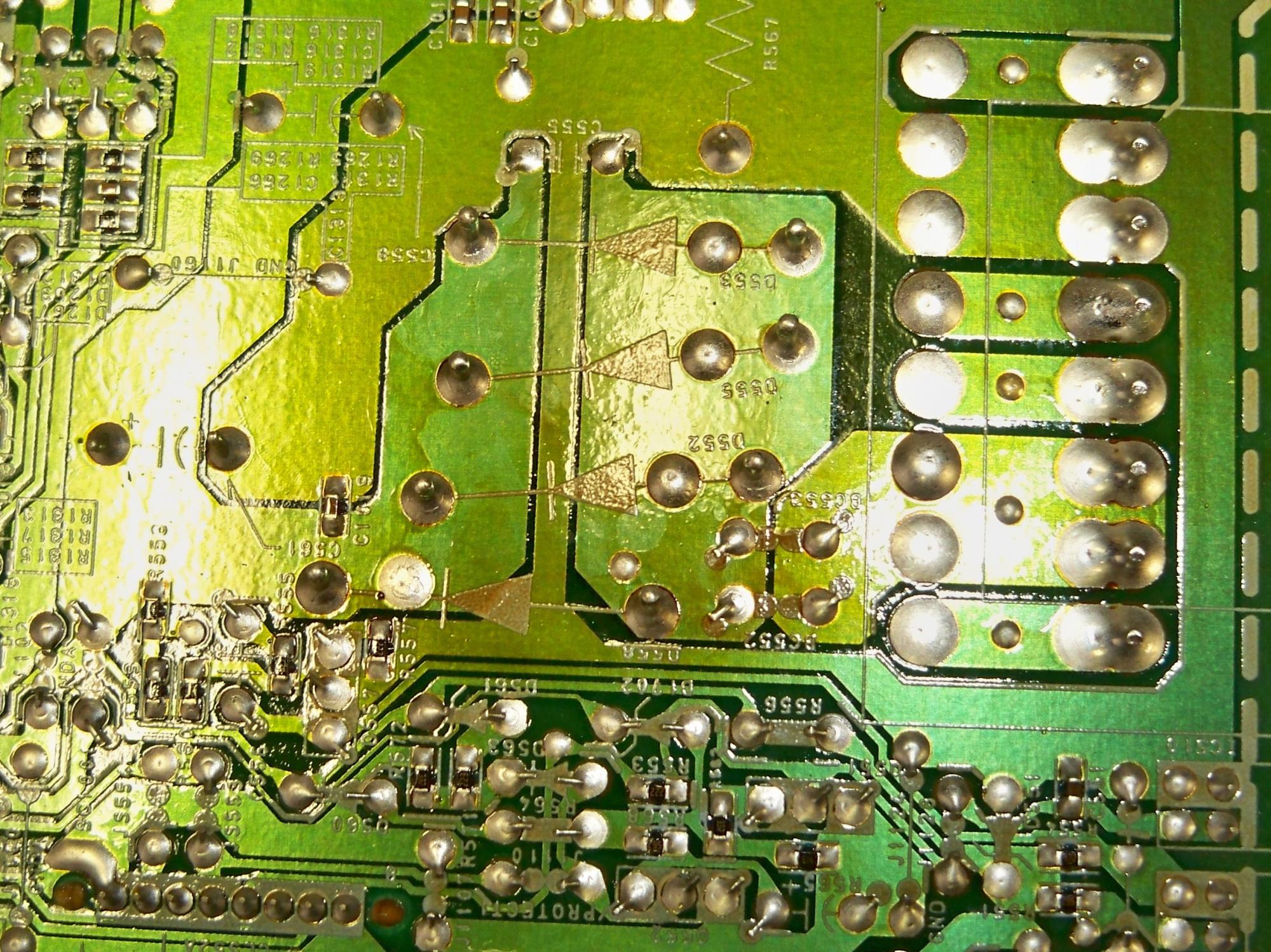

        Re: Emerson 32" lcd, LC320EM82 S power issues(sony bravia??)

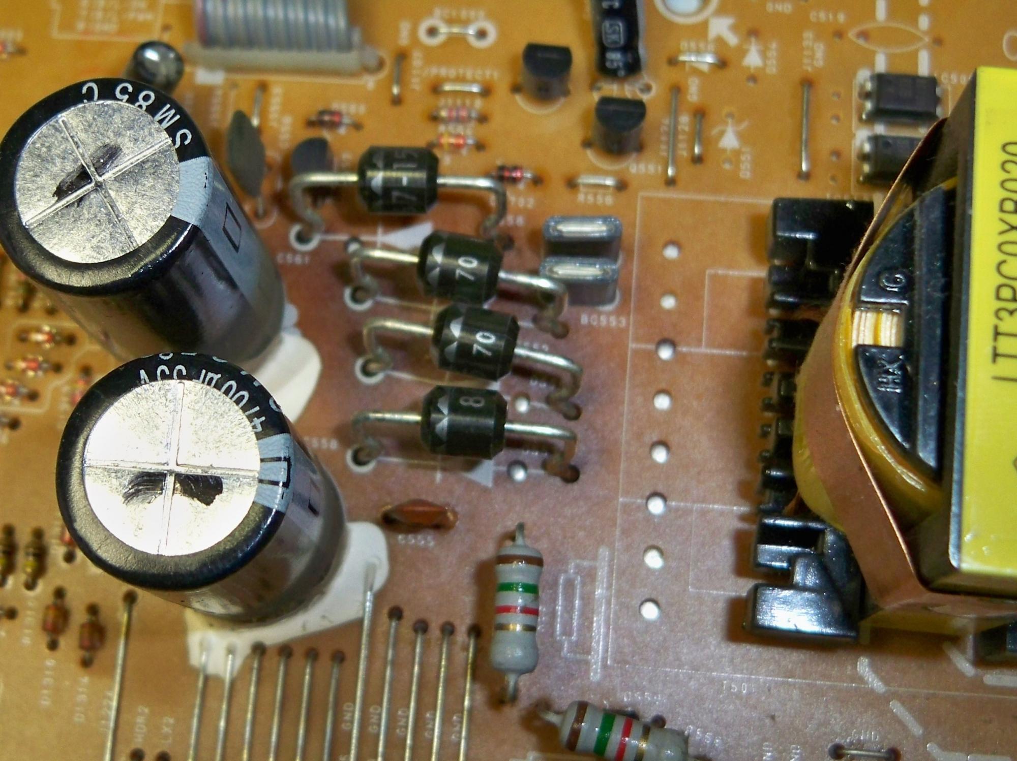

        What connector goes from the control/signal board to the power supply board? I'm thinking that the power supply is being shut down by the control board (not the other way around.) One of the pins on that connector will probably be power on/off.
        Also, I'm not liking the look of those output diodes (esp. the heat toasted PCB), but they are probably okay.

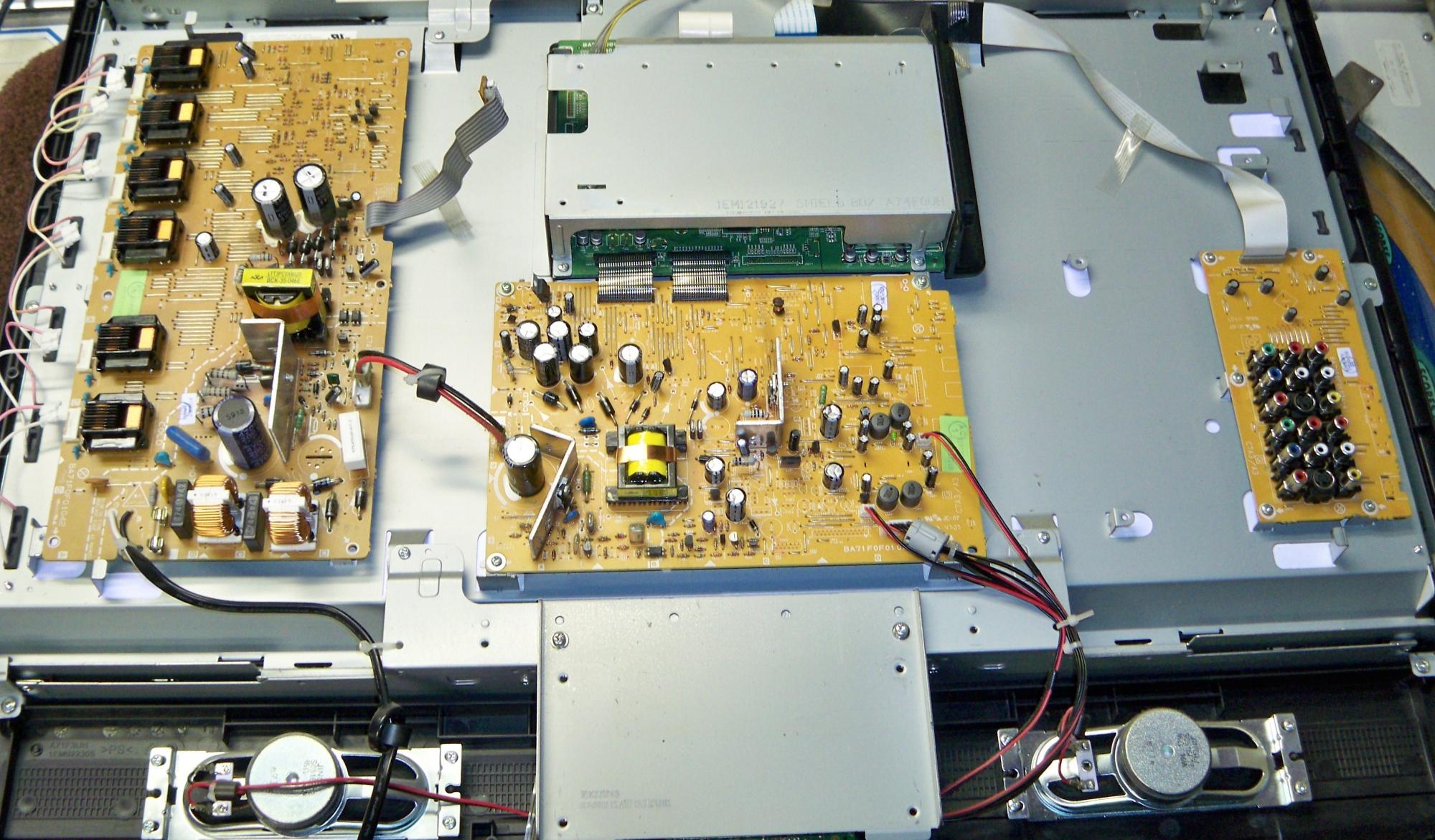

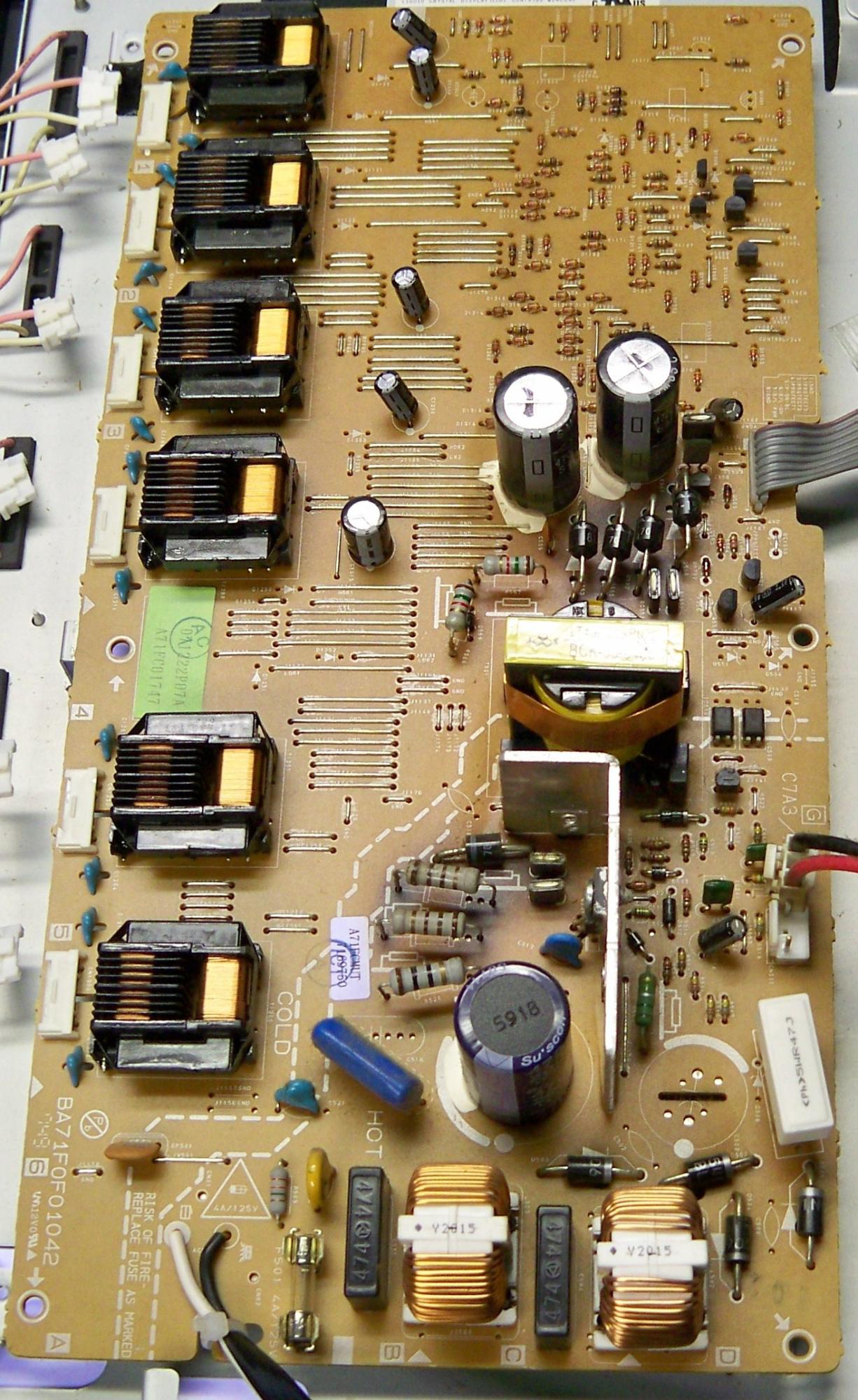

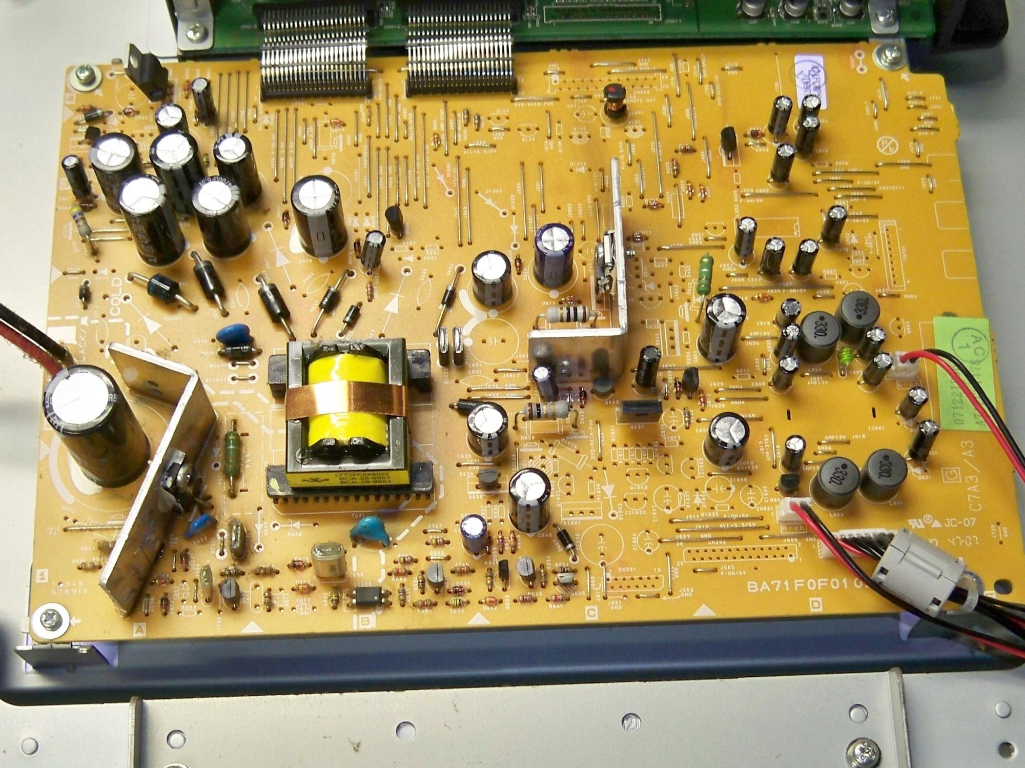

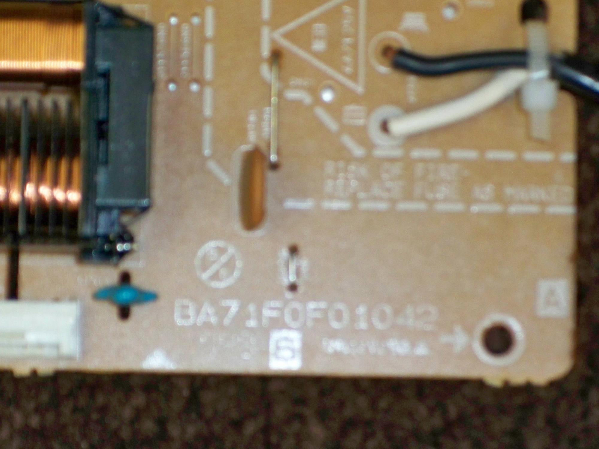

          hmm.. there is a 6 or 8 pin connector between the mainboard and the main ps/inverter board i will make a quick note of waht is what then test them all tv off, tv on, and tv back off..
          it is marked power on, ground, error 6, error 8, etc so this might get interesting..
          this tv is setup weired. wall power goes to the inverter board so the inverter is also partly a power supply, then theres a 2 pin hrness tht goes to the secondary power supply. the only other wires besides ccfls is tht 6-8 pin harness going from the inverter to the main logic pcb(under the metal shield)
            The guy who laid this out (I refuse to call him an engineer) certainly came up with some original ideas. I've marked up a few interesting points. A significant effort was made to isolate the inverter power from the audio power. That leaves me to believe the capacitors are pretty darn marginal.
            As far as the problem, I see a couple of possibilities. Of course, there are the usual suspects - bad caps, bad solder, bad regulators. I REALLY don't like the signs of overheating on the diodes for the inverter power.
            One other possibility - many inverters have a status or error line that goes back the the main board. Those diodes were either seriously underrated, or something in the inverter is drawing too much power. If the inverter shuts down, and alerts the main board, this could explain the sequence of events.
              Ok. none of the inverter diodes check shorted. In the short time the inverter is running, i am getting 24vdc on the banded side of each of those 4 diodes.
              CHecking the ribbon cable that runs between the inverter and the mainboard i have:
              (pin number) (assignment) (volts off) volts while temporarily on, vshutdown
              1: ground 0 - 0 - 0
              2: prot. 3 3.3 - 3.3 - 3-3
              3: prot. 2 1.4 - 0 - 1.4
              4: prot. 1 .4 - 3.2 - slowly back to .4vdc
              5: p-on-bl 0 - 3.0 - 0
              6: b/l on 0 - 1.2 - 0
              7: b/l pwm .464 - .464 - .464
              8: ground 0 - 0 - 0
              so should i take this is all protections should be 3.3v while powered on???
              i tried to follow pin 3 on the inverter side, it seems to stop right at the solder joint of pin 3.
              If anybody needs more detailed pics of anything just say so.

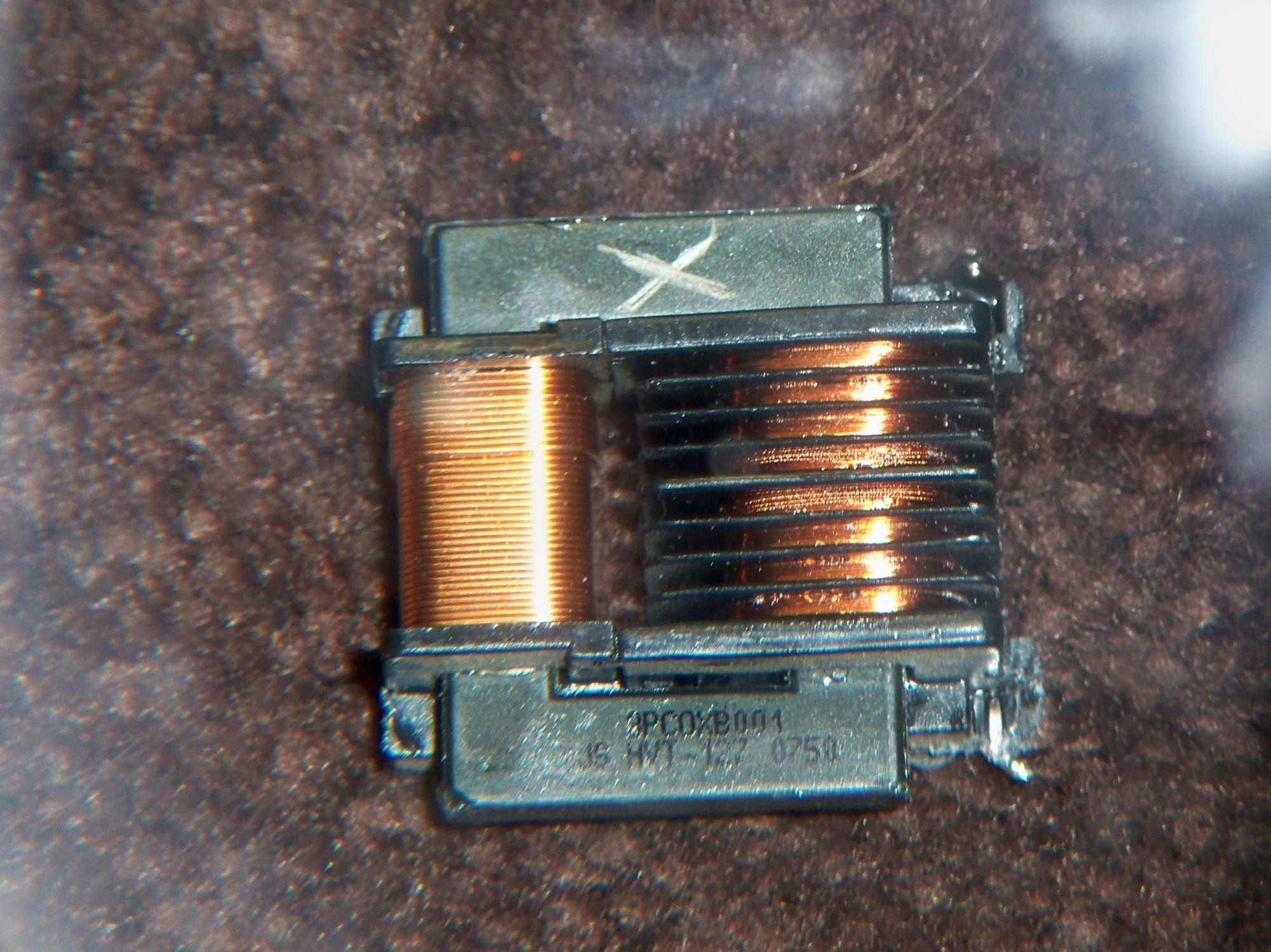

                for giggles i replaced all the 1000uf caps on the inverter board, replaced a 470uf cap on the inverter board, reflowed a bunch more solder. same.
                do you think this is the correct inverter transformer?
                ( well one of them) http://www.encompassparts.com/products/?FUNLTZ2PC0MS008
                also, somebody walk me though how to check my inverter transformers. I want to maks sure im not missing something stupid obious here.
                EDIT: GOT IT!!!
                one of the inverters is open on the SECONDARY side. The secondaries on these things read like 4 megaohms(between ccfl pins)... I never wouldve thought that. one reads dead open. In a case like this a ring tester would give me a definate answer, but i think we got this.. after pulling the transformer one side of the secondary checks ok the other side checks open.
                Now i have to hunt an inverter down, nonew of my parts sets are funai.. oh wait i have a stack of torn down tv boards to go through yet hmmm

                              Are there any part numbers on the bad transformer?
                              PlainBill
                              • cadillacman
                                • Feb 2011
                                • 524
                                js-hvt-127
                                the pic i posted earlier is the inverter in question..
                                let me see if i can attach it again...
                                aha this listing shows an alternate number as the top number of my dead inverter. I believe this will be the one to go with.

                                      The next to last picture in post #3 shows an inverter transformer. The primary winding is to the top of the picture, the secondary to the bottom. If you look carefully you can see the leads at the bottom corners. Measure the resistance of each secondary. If you look at the last picture, this is the bottom side of the inverter. The arrows point to the secondary pins. If you prefer, you can measure on the bottom of the board. If any reading is different by more than 3%, the transformer is probably bad.

                                        im sure i found mine the wrong way lol, but disconnect all the lamp wires form the inverter. On between the pins of each. should be like 4 megaohms or something like that. If any read open, you likely have an issue with that inverter.
                                        Likewise anothe rmethod would be to plug in one lamp connection at a time, then attempt to power on. If you get one set of lamps tht does not "flash on" when the tv powers on, this is likely the inverter you are having issues with.
                                        DOnt forget to check it over for bad caps, bad solder, test for proper voltages while it is apart.
