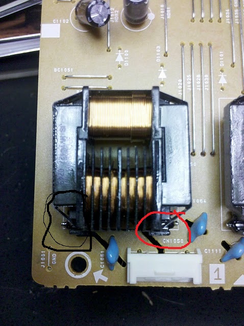

      Ok so i took the board out and i took some pictures (attached)
      one is the pic of my voltmeter and my setting (to make sure im doing it right)
      second is the pic of my transformer and where im putting the black and red needles
      everything reads 1
      so i assume im doing something wrong here. i also tried it from underneath the board and got the same thing

              putting the leads where you marked wont do any good.
              Put the leads directly at the connector pins or each lamp( unplug a lamp, put the meter leads where the connector used to go on the two metal pins)
              Yes thst meter isnt so good for a newbie. You want a more modern auto ranging meter.
              by process of elimination, looks like you found it that way. Now you know which one is most likely giving you problems.

                Your test is incomplete. You have learned that one transformer / wiring / CCFL combination does not work. As of yet, you don't know if it is the CCFL / wiring or the transformer. To determine that, let's say the transformer / CCFL in position 3 does not work. Connect the CCFL from position 3 to the transformer connector in position 4 and repeat the test. If it lights, the CCFL in position 3 is probably good. To confirm, connect the CCFL in position 4 to the transformer connector in position 3. If that also does not light, the problem is associated with the transformer (and associated circuitry) in position 3. By measuring the resistances of the secondaries of each transformer you can determine if the transformer is open or shorted.

                    Those are the correct points, although you may have better luck on the bottom side of the board. Caddilacman reported 4 megohms resistance on the good transformers, so make sure you start with the highest resistance range.

                                measure at the transformer.there often is a cap in series with the lamp.i would expect no more than a few k ohms.

                                  if you measure at the two secondary terminals on each side of the secondary side yes sir, but from pin to pin at the lamp connector it reads like 4 meg ohms, weired, i know.
