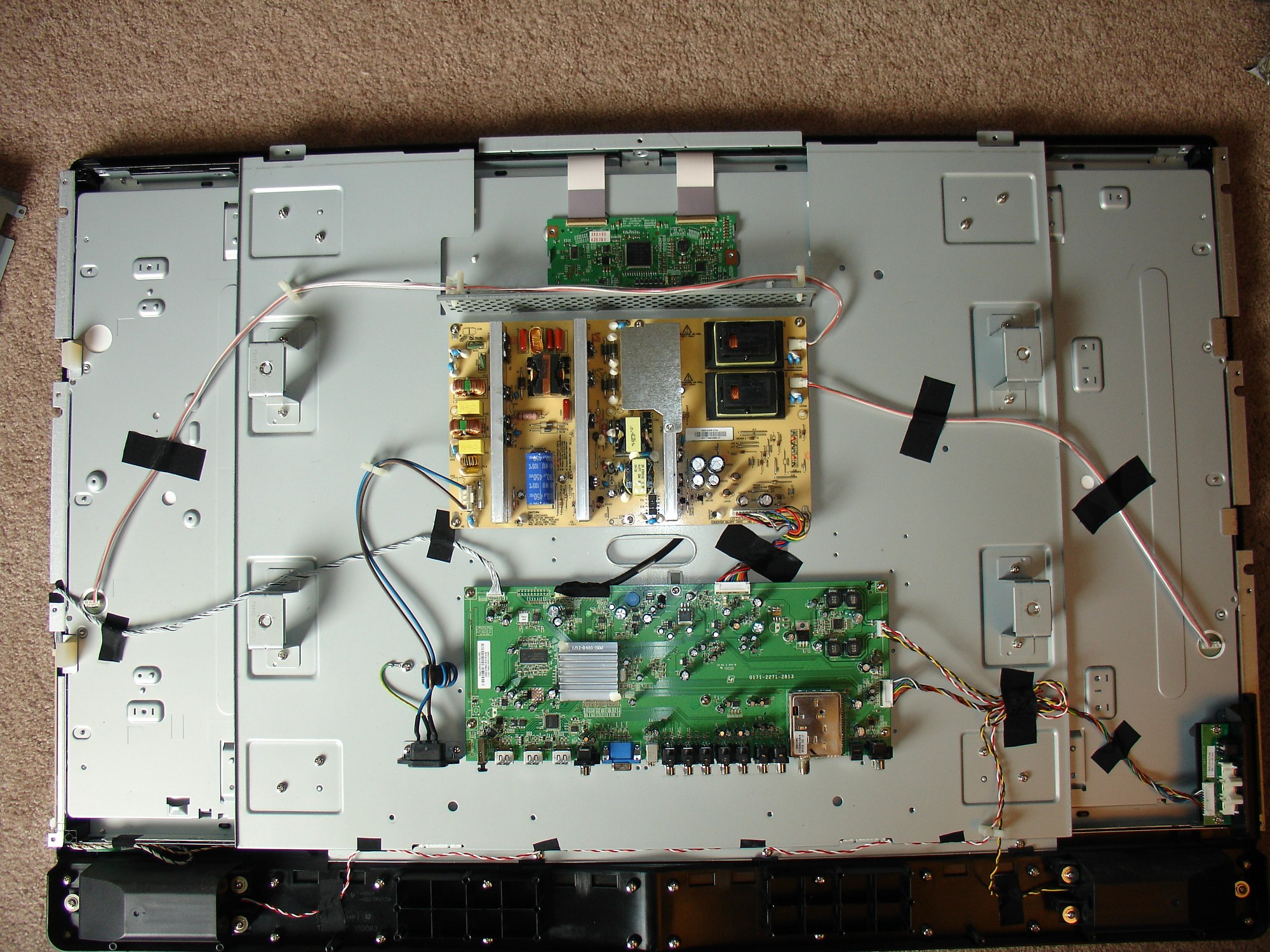

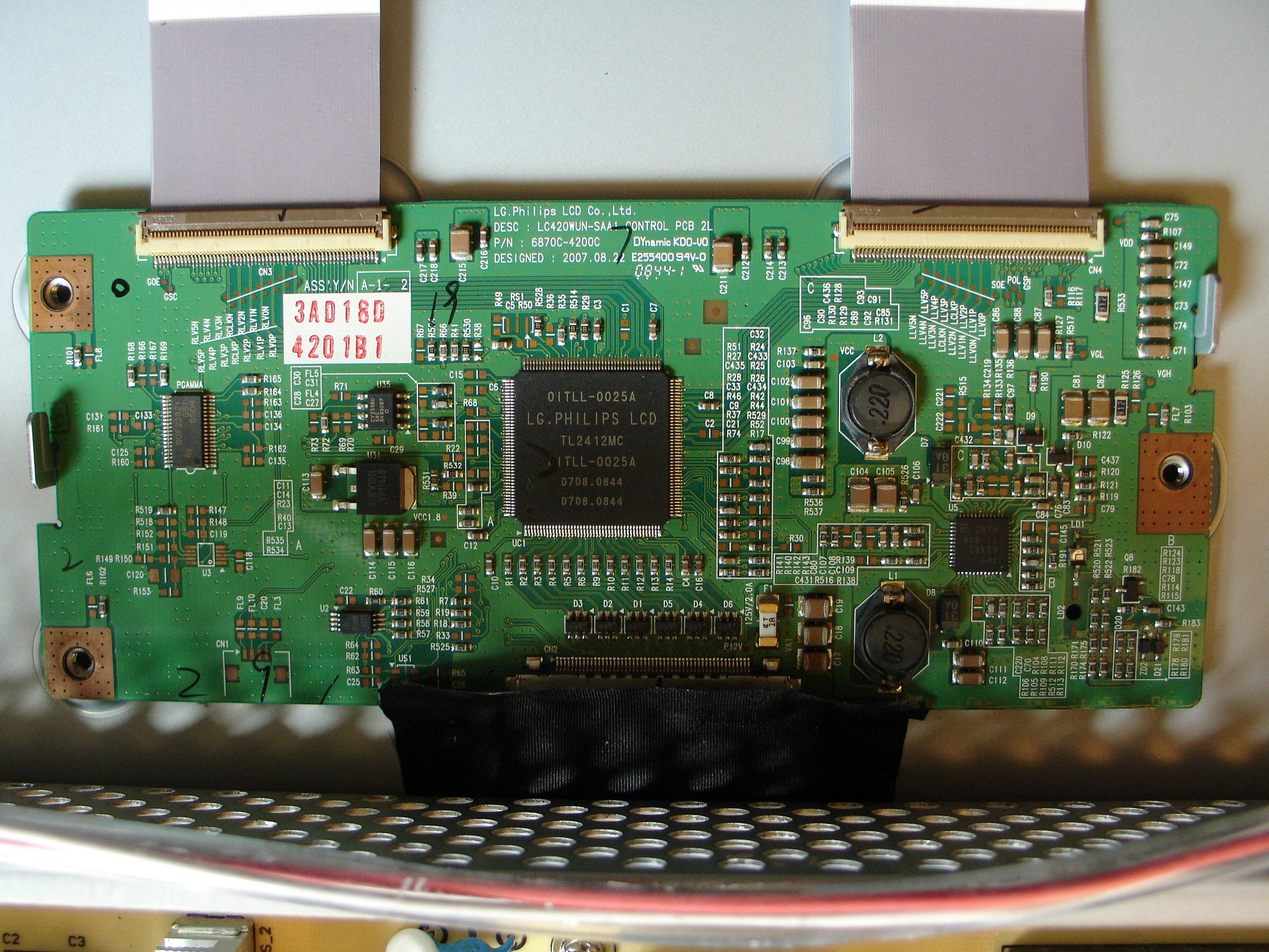

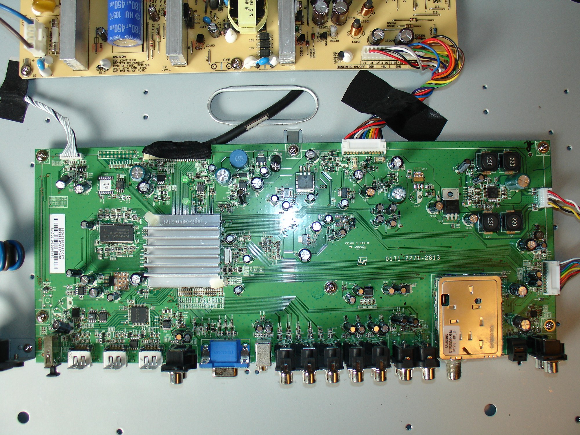

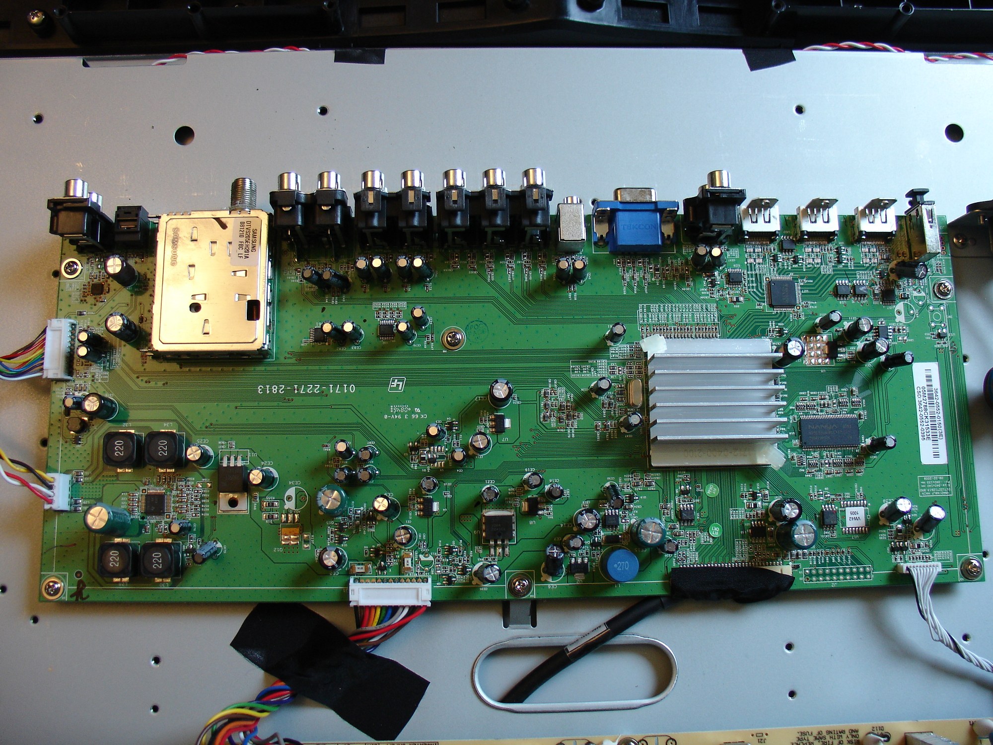

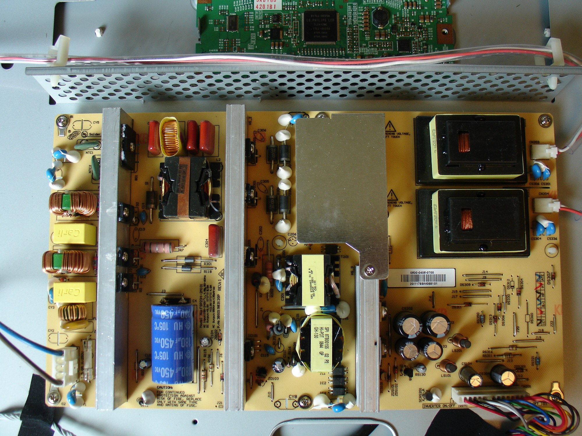

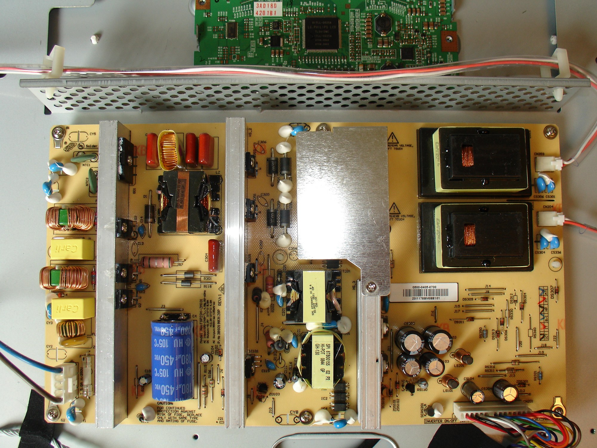

    Here are some pictures. Let me know if you need a close up or a different angle. Also update: Just started noticing a different sound (like a stuck pig - well, the sound a stuck pig would make if it was the size of an ant) coming from the control board.
      Re: Vizio VS420LF1A - Attack of The Black Screen
      One point - terminology is important if we are to communicate. 'Control board' is ambiguous. There is the Tcon (Timing control board), the board with the buttons (control panel), and the main board which controls everything. There is some justification for calling any of these the 'control board'. Henceforth we shall speak of the power supply, the main board, the tcon, and the control panel.
      Intermittent failures like this are often caused by a bad solder joint. This could be on either the main board or the tcon. And as you might suspect, they are a bear to locate. One method is to use something like a 'stick' pen to tap and prod various points in hopes that something will stop or start working.
      If you want something easier to start, I identify 7 voltage regulators on the main board. They are U2, U4, U5, U8, U9, U11, and one below U11 whose identifier is washed out by glare. The best way to do this is to record the identifier (U2), the part number (may be something like NCP1117ST33T), and the voltage on each of the three pins (numbering for U2 is left to right, the tab and the center pin are connected together). Use the mounting screw in the middle of the board as the ground point.
      Of course, if you can get readings both working and not working, it would be a big help.

          Here is the types of voltage regulators for now:
          U2, U4, U5, U7, U8 - K481 G1117
          U9 - 1084 0845CL
          U11 - 7805CT RAF842G
            Generally speaking, a white, gray, or black screen (as in backlights working, but screen shows no picture) would usually indicate a bad T-con. However, since you said the sound is also not present, I am more inclined to think it's PSU or the main board and not the T-con. The PSU seems to use good brand capacitors, though.
            U11 is a common 7805 voltage regulator - it should have 5v on it's output pin when a voltage higher than about 7v on its input is present.
            U2, U4, U5, U7, and U8 - I'm not sure if they are BUK481 MOSFETs or 1.7v regulators. Might be the latter, but I'll wait for PlainBill (or someone else) to confirm.
            U9 I'm can't find.
