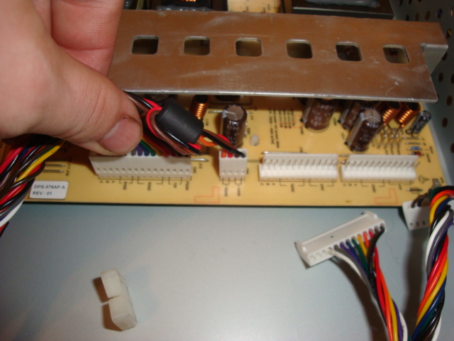

    The power supply unit in this TV is nicely labeled. The power cable going to the main board has 3 12volt pins and 3 5volt standby pins as well as one labeled PSON. With the TV plugged in and turned on (the only way I can test it because I can't get it into standby mode)
    The 5volt pins each have 5.14 volts.
    The 12volt pins each have 11.76 volts (less than 12)
    When I test the PSON it shorts out the TV and the relay on the PSU clicks on and off.
    There are 2 24volt pins going to the sound board both read exactly 24.1v
    There are 2 inverter boards and each one has 5 24volt pins coming off the PSU
    All the 24volt pins have 23.8 volts.
    The inverters and the main board are getting just under their correct voltages.

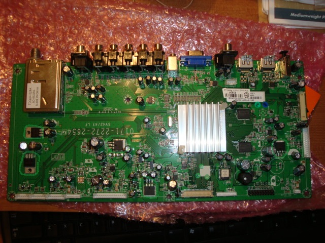

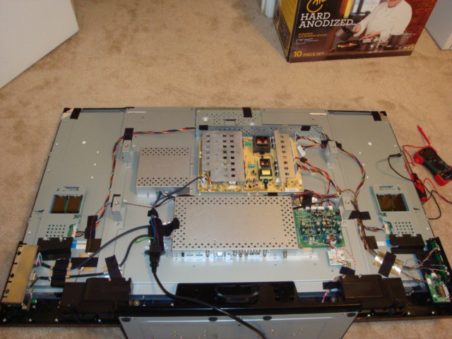

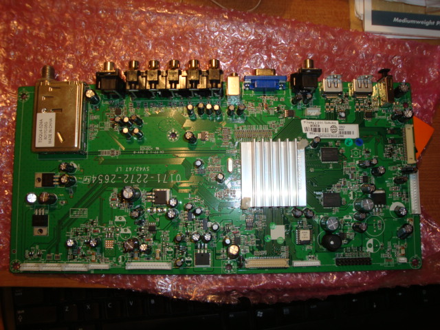

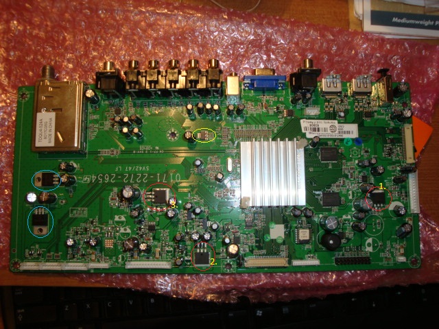

                  Here are the pictures
                  I really appreciate any and all advice. Can anybody figure out why the TV would automatically go from standby to on by itself after being plugged in. That really does not make sense to me.
                  Also why would the power button only work sometimes and only once or twice at a time?
                  I do not have a service manual for this TV but I am fairly certain that the main logic processor is on the main board. If it is being under powered that might explain the unresponsive buttons.

                    One of the first steps would be to check the output of the LDO regulators on the board. I've identified 6 and circled them.

                      Re: Vizio SV470XVT1A LCD No Picture/No Backlight

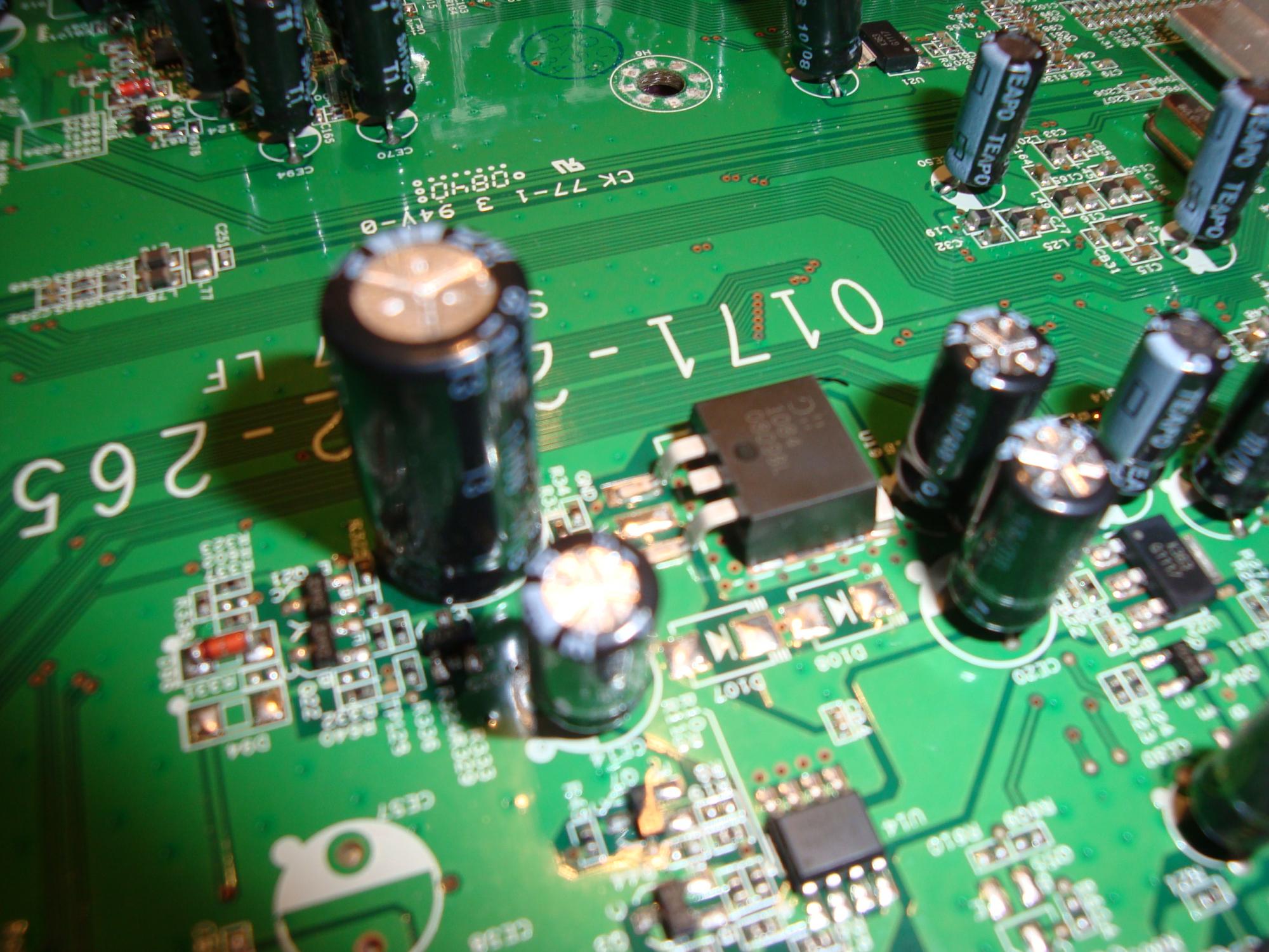

                      My apologies for being a novice, but some of these voltage regulators have 3 pins connected and others only have 2 pins connected.
                      The ones that have 3 are labeled In Ground Out
                      The ones that have 2 are labeled Ground VO VI with the center pin VO disconnected.
                      In the picture you can see the center pin of one LDO is not connected. How do I test the ones with only 2 pins?

                        The tab is the third pin.
                        One well known secret is if you Google the part number, followed by datasheet you often will find the datasheet for the device. The datasheet has a wealth of information, including the pinout.

                          The identification numbers of the 6 voltage regulators are as follows:
                          There are 3: (circled in red)
                          1804
                          0809BL
                          The voltages are:
                          Vi to ground
                          1. 2.73v
                          2. 3.91v
                          3. 2.75v
                          Vo/Tab to ground
                          1. 1.250
                          2. 1.251
                          3. 1.248
                          (I can not find a datasheet for these)
                          There are 2: (circled in blue)
                          AZ7805T - E1
                          820J71
                          The datasheet specifies that these are 5.0 V output
                          They both measure from Vin to Vout 11.75v to 5.1v
                          There is 1: (circled in yellow)
                          K363
                          G1117
                          It has no VO/VI/GNd labels however i found that the tab is the ground
                          PIN 1 to Ground/Tab 1.24v
                          PIN 2. to Ground/Tab 1.25v
                          This one seems the most suspicious to me, however I suppose there is a chance I am not reading it correctly.
                          With regards to the backlight, if it is getting voltage from the power supply why is it not turning on?

                            The numbers are interesting. The first three output voltages are a common voltage used by processors, although the varying input voltage puzzles me.
                            The two circled in blue certainly seem normal.
                            The 1117 family of LDO regulators are quite common, although usually the output voltage is incorporated in the part number. The fact that input and output voltages are the same seems to indicate a real problem.
                            What is even more surprising is there is no 3.3 volt output on any regulator.
