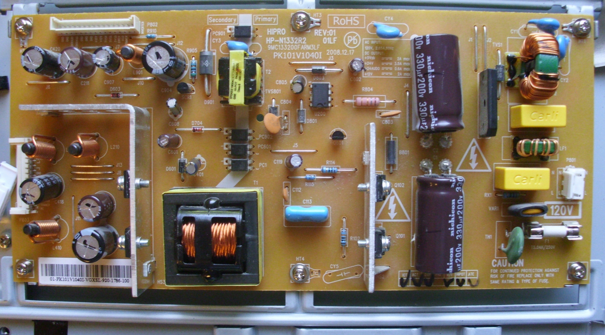

    Re: Toshiba 26AV52R power on problem
    After powering the set off with the power button last night, and still plugged into the wall outlet the set powered on and worked.

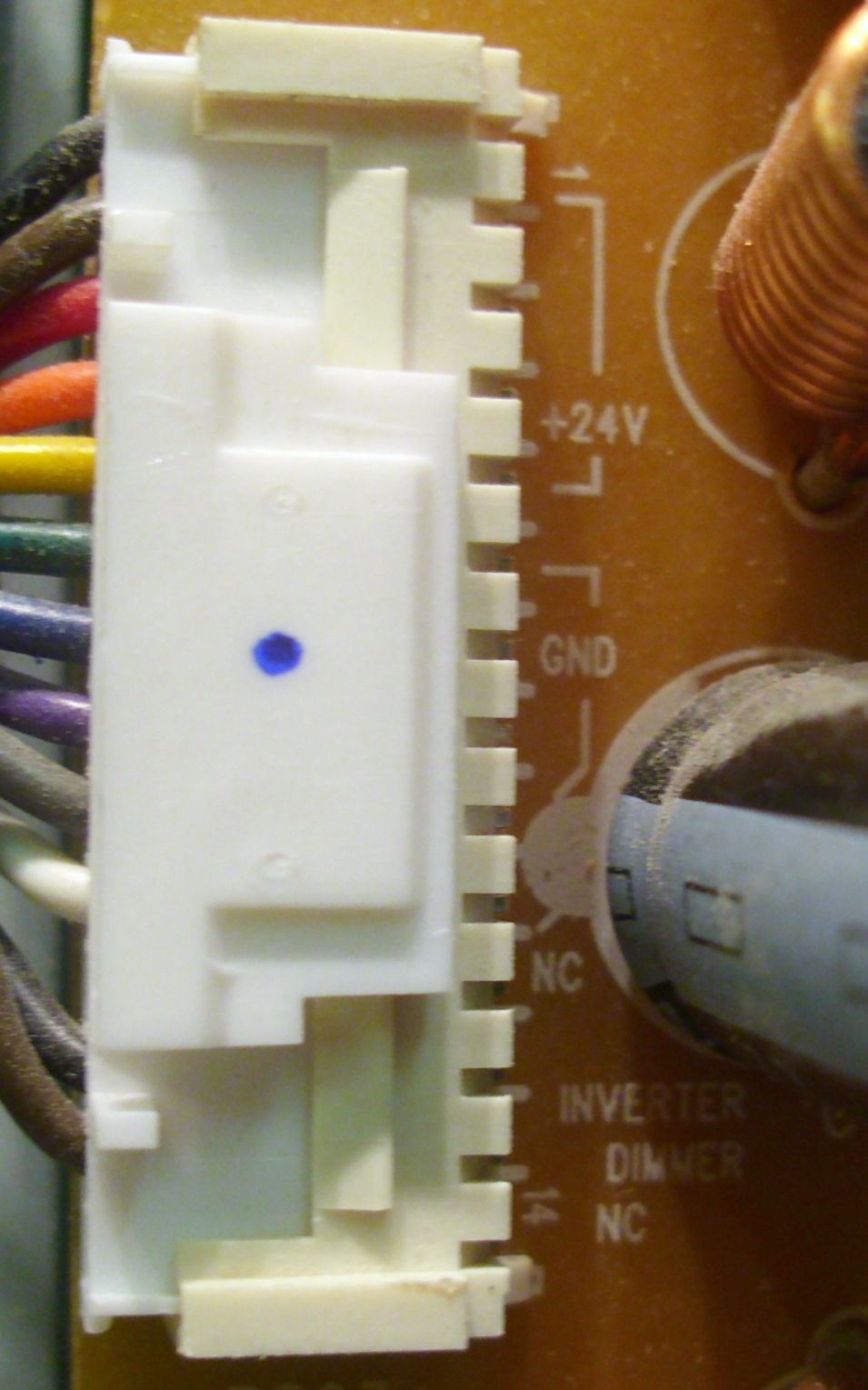

    I measured voltage to the two large 320V caps and in reference to the picture the lower cap showed 329V, and the 320V cap just above it reads 164V.
    I had 5V stand by voltage, and a Pin marked “ower” read 4.2 V as the power button was pushed, and the set powered on. The 24V, and 12v voltages were good.
    I removed the plug from the wall outlet and could slowly watch the voltage bleed down on the 320V caps.
    After plugging the power cord into the wall socket the large caps voltage rose, to 322.6V and 161.4V
    The standby voltage reads 5.046V, But as the power button is pushed the pin marked “ower” only reaches 3.625 This voltage is lower than when the set will power on.
    And of course I get no 12V or 24V at any of the pins.

        Those look like they say 200v @330Uf. If you are reading 329v, I would think the cap would blow. That's measured right on the pins of the big caps? The 161.4 at the upper cap seems right for most rectifiers output. The 329 at the lower one doesn't seem right.
        • alexanna
          • Mar 2010
          • 1346
          Thankyou for calling that to my attention,I didn't look at things closley enough this morning.
          I had refrenced the ground from just one of the capacitors,I did not want to have 164V wake me up this morning . When I refrence the ground to each capicator I do read 164V on both of them.

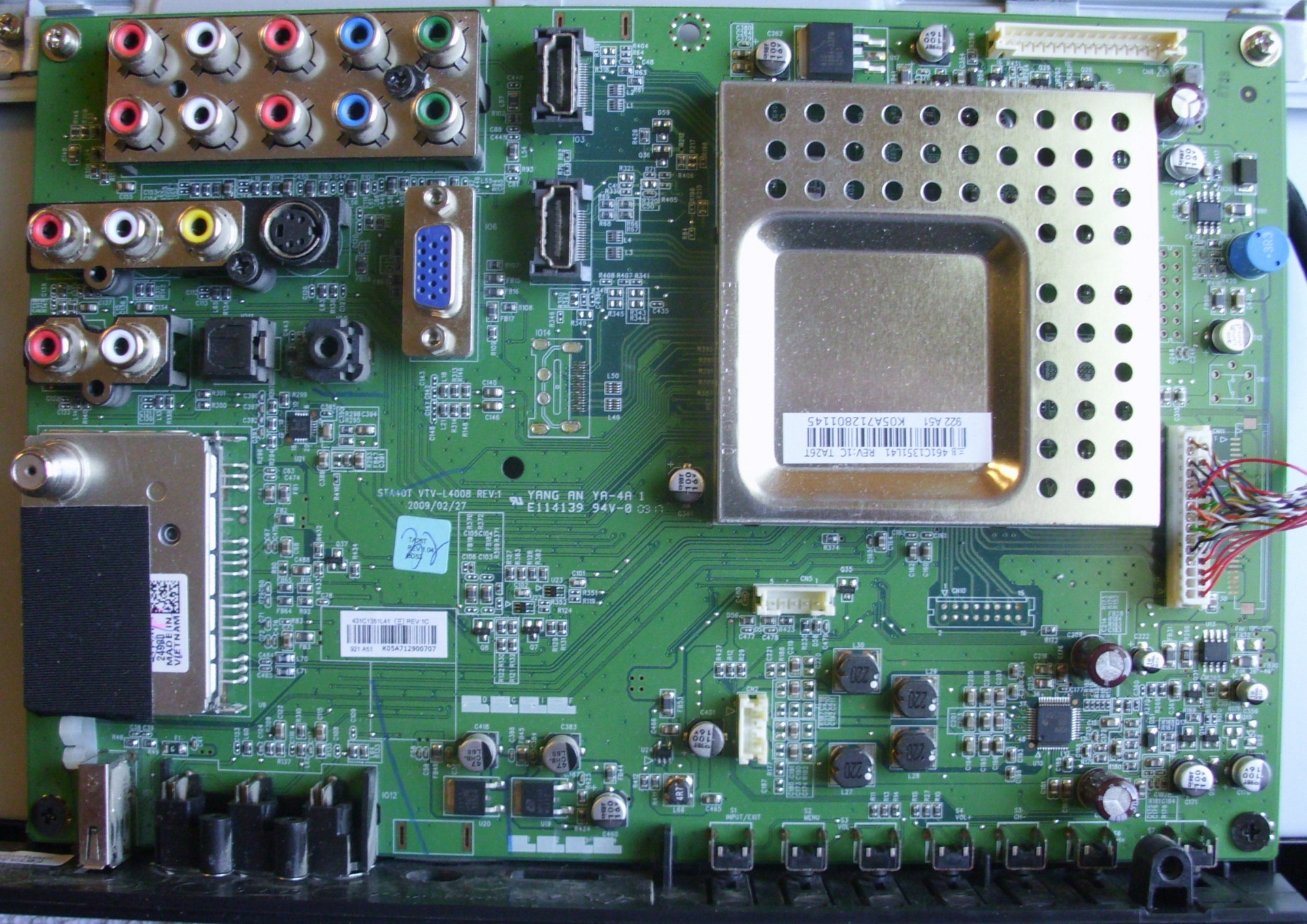

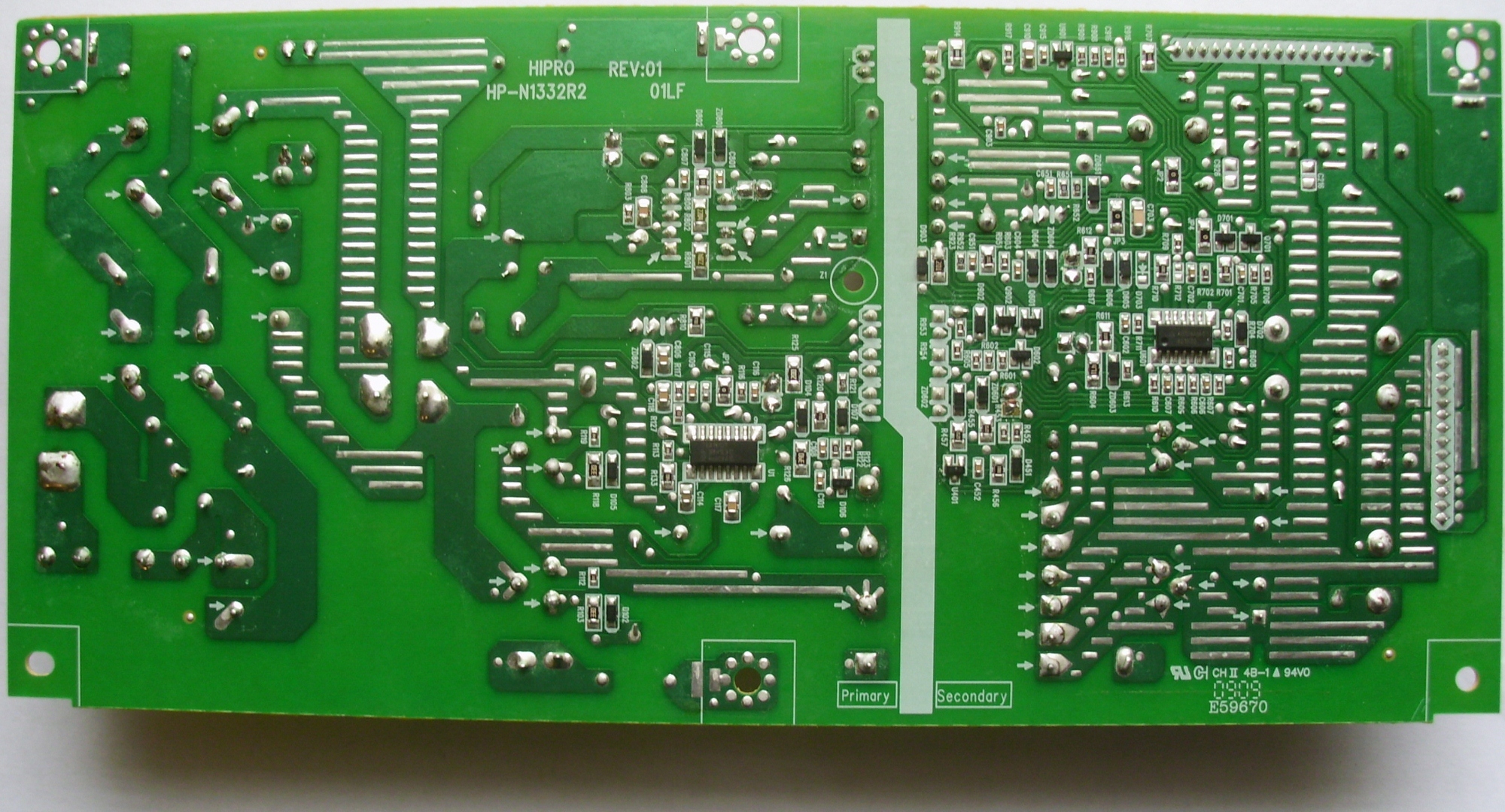

            I am going to include a picture of what I think may be the IC to start the 24V, or maybe the 12V ? IT is a 16 Pin IC and it looks like it may be some type of amplifier?
            AS324AM http://pdf1.alldatasheet.com/datashe...S324AM-E1.html
            On the bottom of the board the top 16 Pin connector, The third pin from the left is the “ower” pin I can trace that pin to a resistor R707 which is 5.1K Ohms to a zener diode D605 and to pin #4 of the AS324AM.
            Because the set will work when the power pin has 4.2V on it and not when 3.652V, I wonder if there is a way to tell if the signal board is not providing enough voltage or if the ASM 324AM may be causing the voltage to be low?
            On D605 the zener diode there is a making T4---and a W3 on it.
            Also on the bottom of the board there is a TEA1610 this is on the secondary side.
            http://pdf1.alldatasheet.com/datashe.../TEA1610T.html
              there was ia mistake made in the above post the TEA16120 is on the primary side

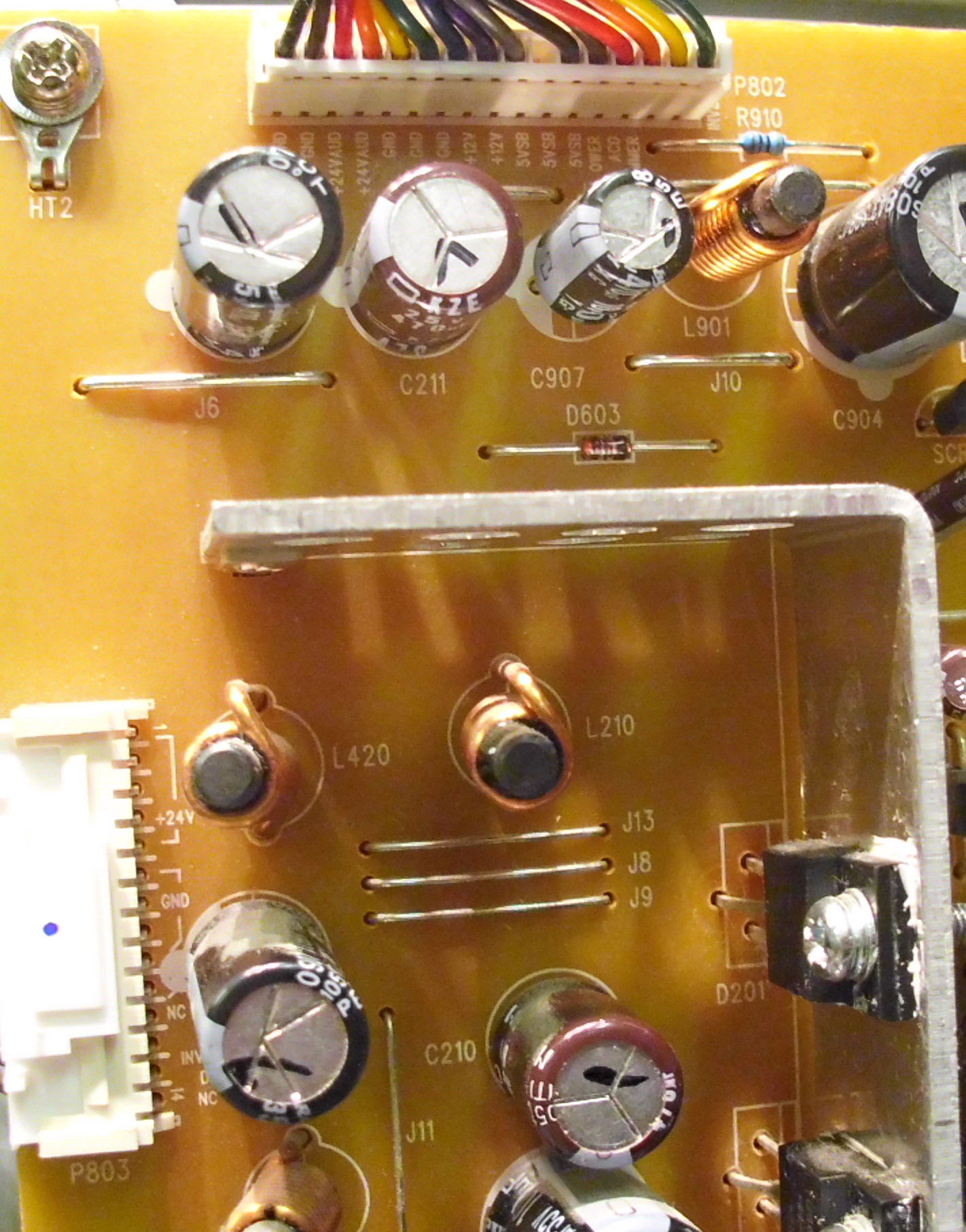

                  I hope I am not too premature on this, But I think it might be fixed.
                  I will leave it unplugged for a while and if it is, I will share
                  Whatever I do, I consider it a success, if in the end I am breathing, seeing, feeling and hearing!
                  • cadillacman
                    • Feb 2011
                    • 524
                    sweet!!
                    • alexanna
                      • Mar 2010
                      • 1346
                      I am going to say this is fixed, it sat unplugged all night and when I plugged it into the wall outlet it powers on and stays on.
                      I replaced on cap on [for lack of better name] the signal board it was a 10V 470UF cap, and 4 470UF ranging from 10V to 35V on the power supply.
                      So it really turned out to be an easy repair, all of the capacitors were within their UF specs.
                      I guess one thing I did learn is there are some voltages on the power supply that can really do some serious damage to you, and you have to be really careful there is a possibility you could buy the farm!
