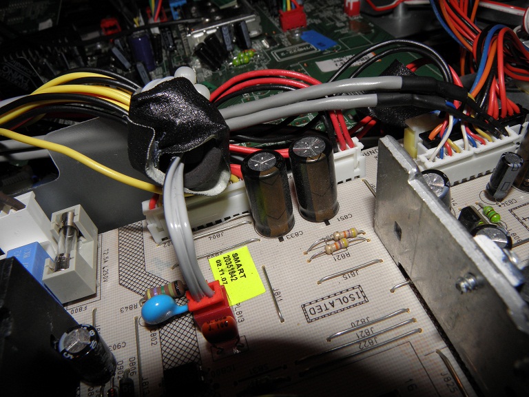

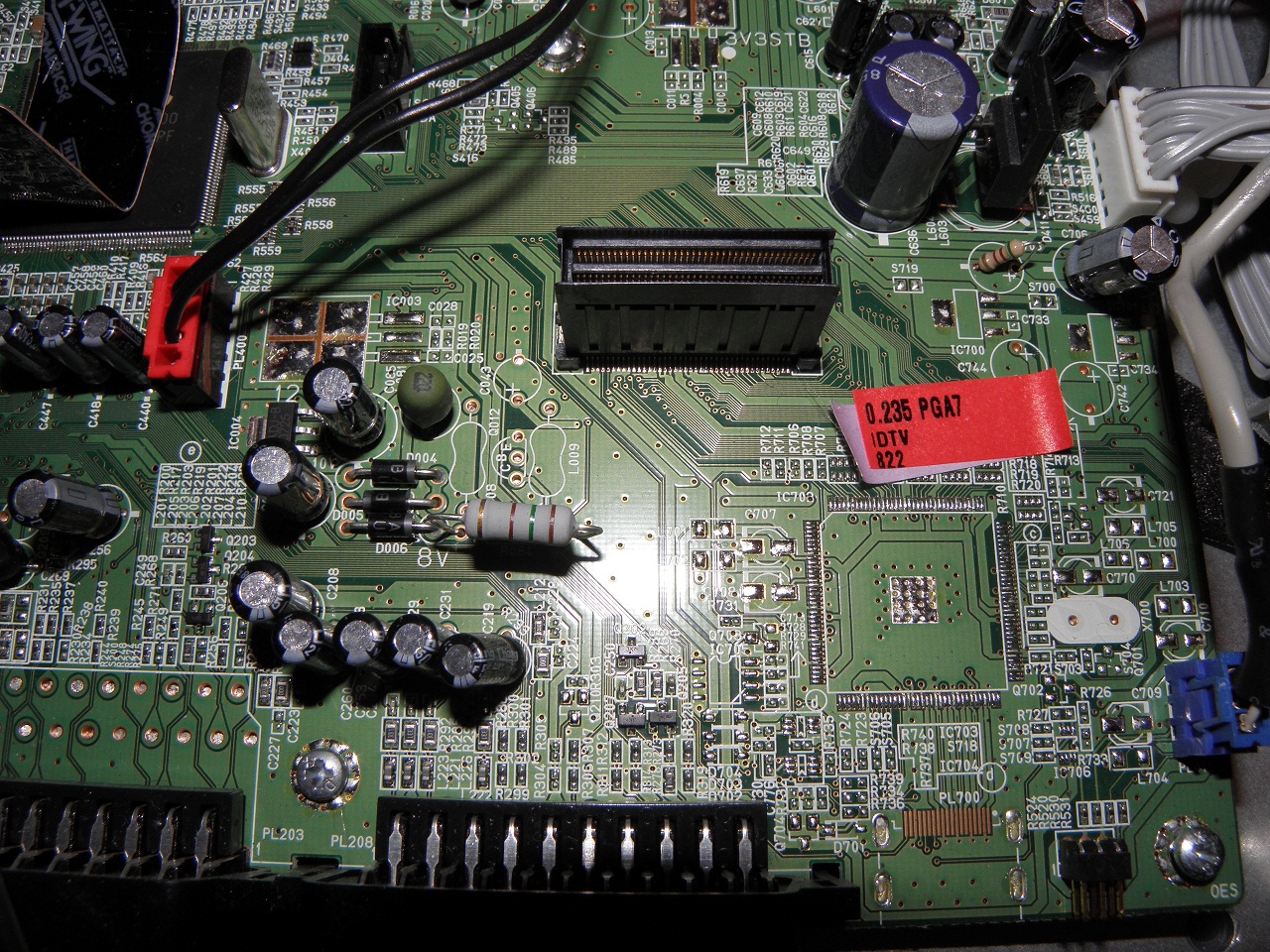

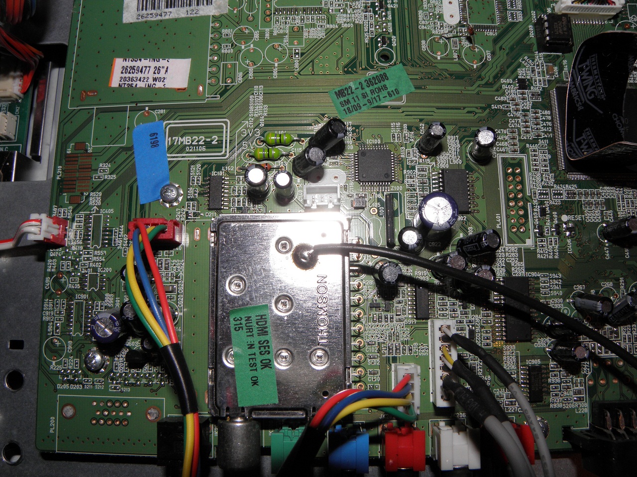

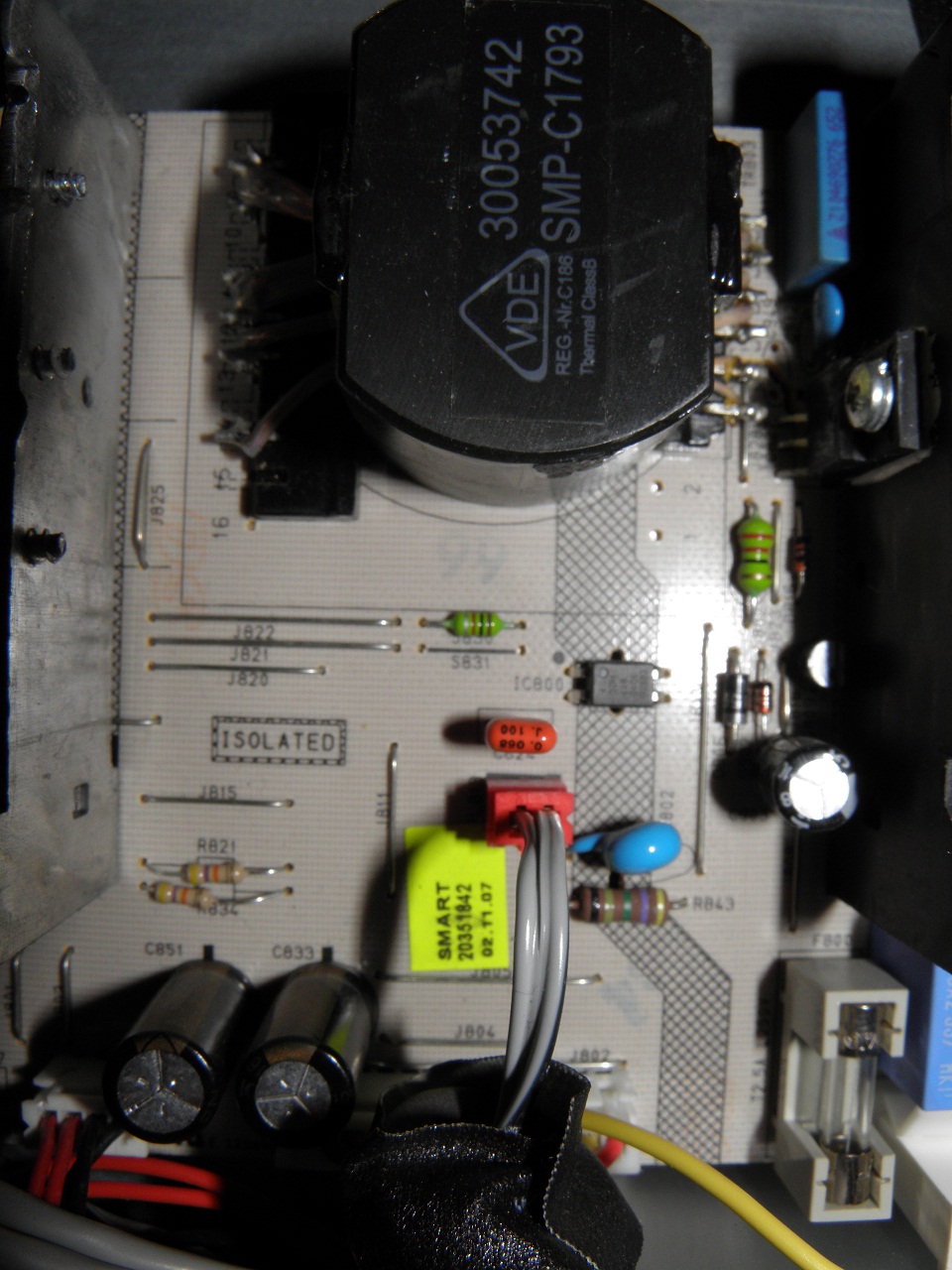

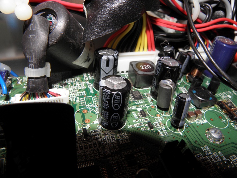

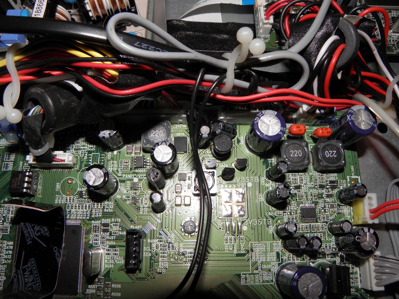

    Hi Guys,
    Firstly I'd like to say this seems like an excellent friendly and helpful forum and I'd like to say Hi to everyone.

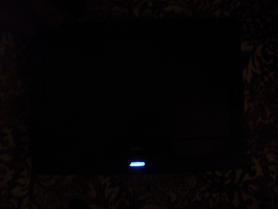

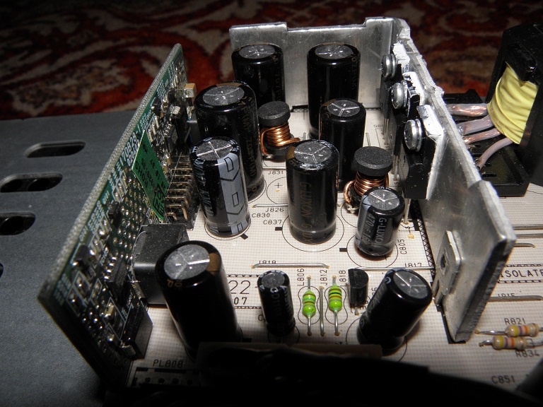

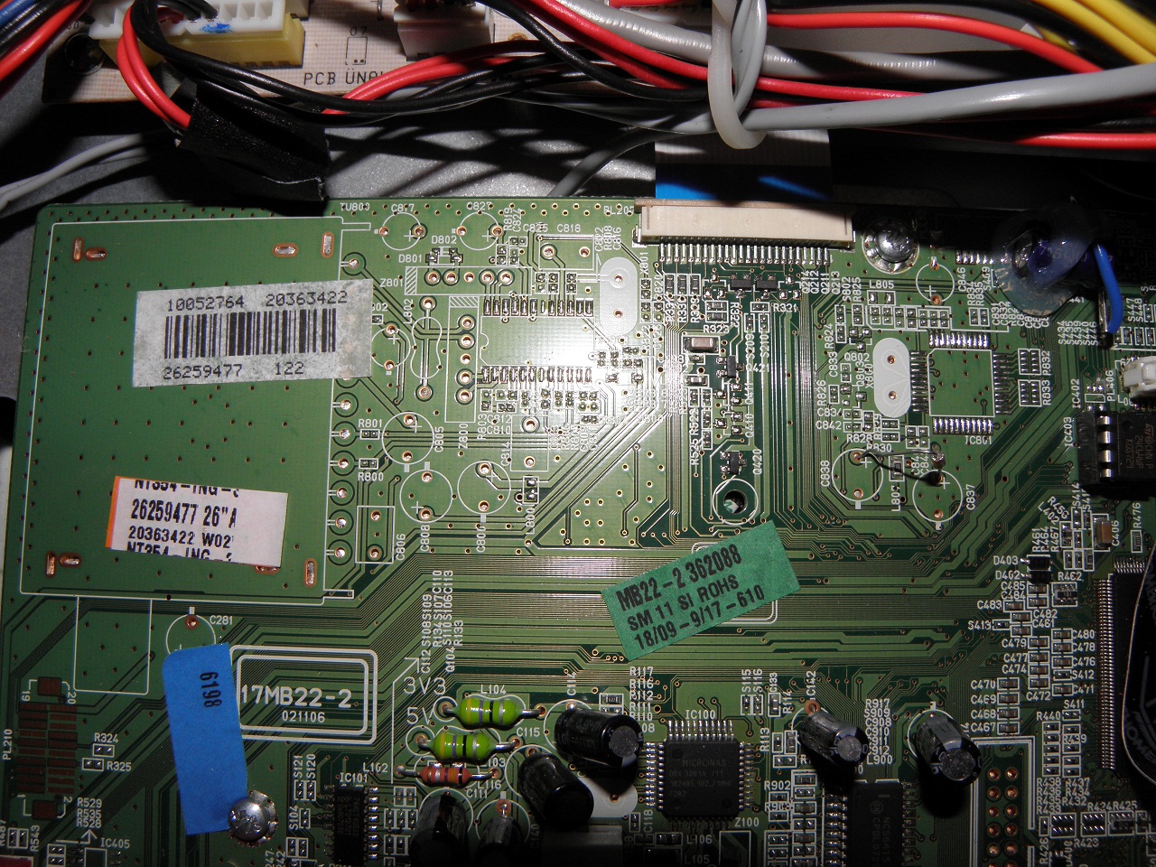

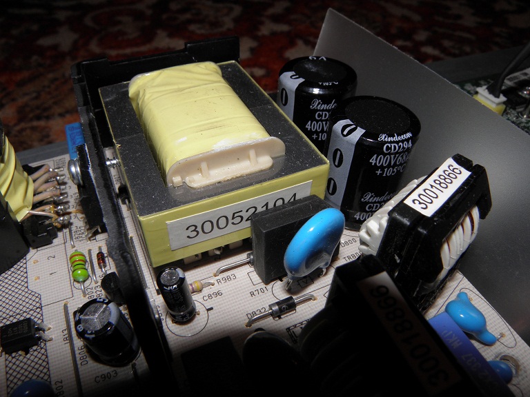

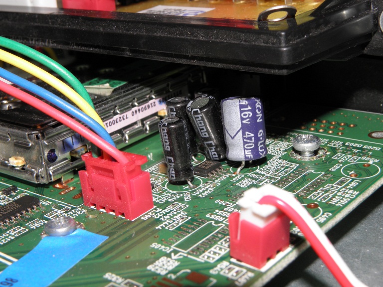

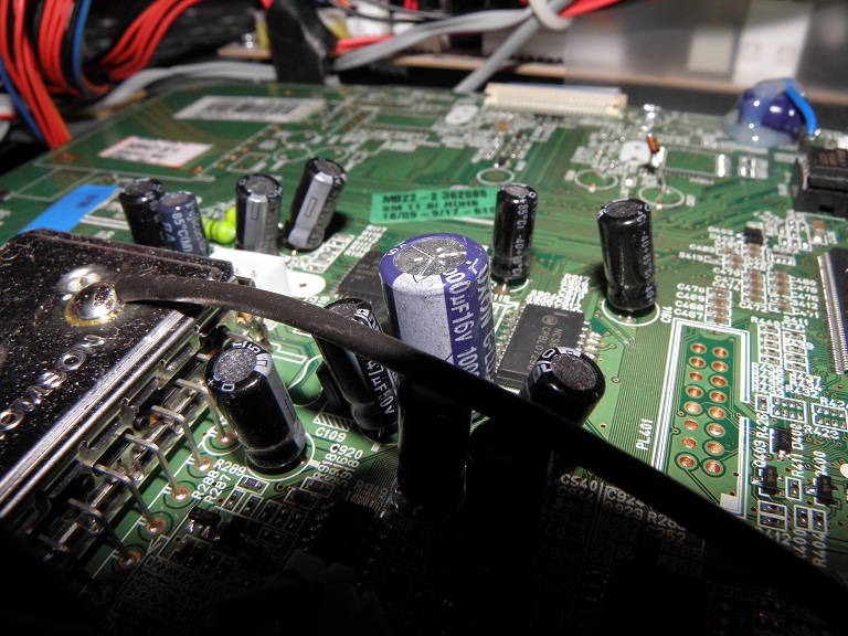

    I wonder if you can help diagnose the problem with my Technika 26" LCD TV.
    The tv is a Technika 26-207 26" HD Digital TV.

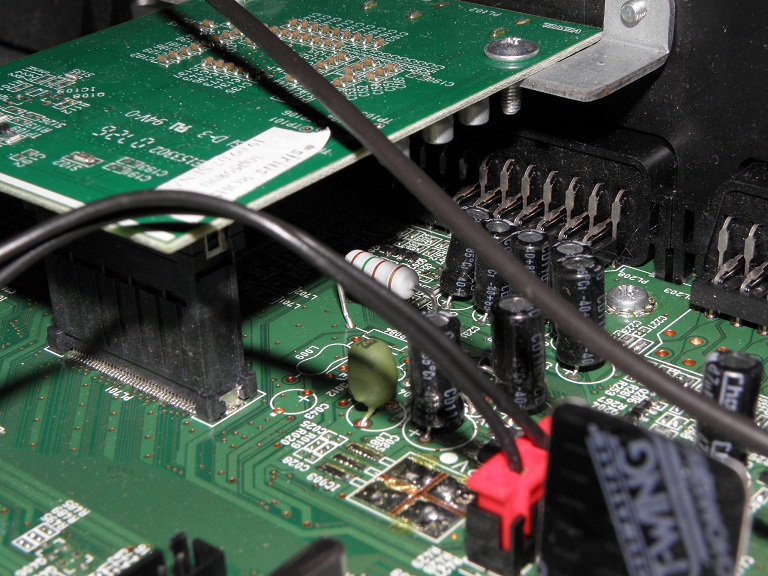

    The problem is there is sound on all inputs but no picture (screen is black - backlight is on). You plug it in and turn on the power, the blue standby led illuminates and when you power it on the led goes out and the screen remains blank (black) with backlight bleed around the sides. You hear the sound as you cycle through the inputs analogue, digital, scart, hdmi - no picture or OSD on any.

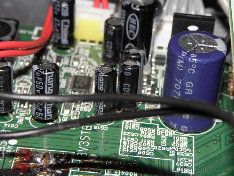

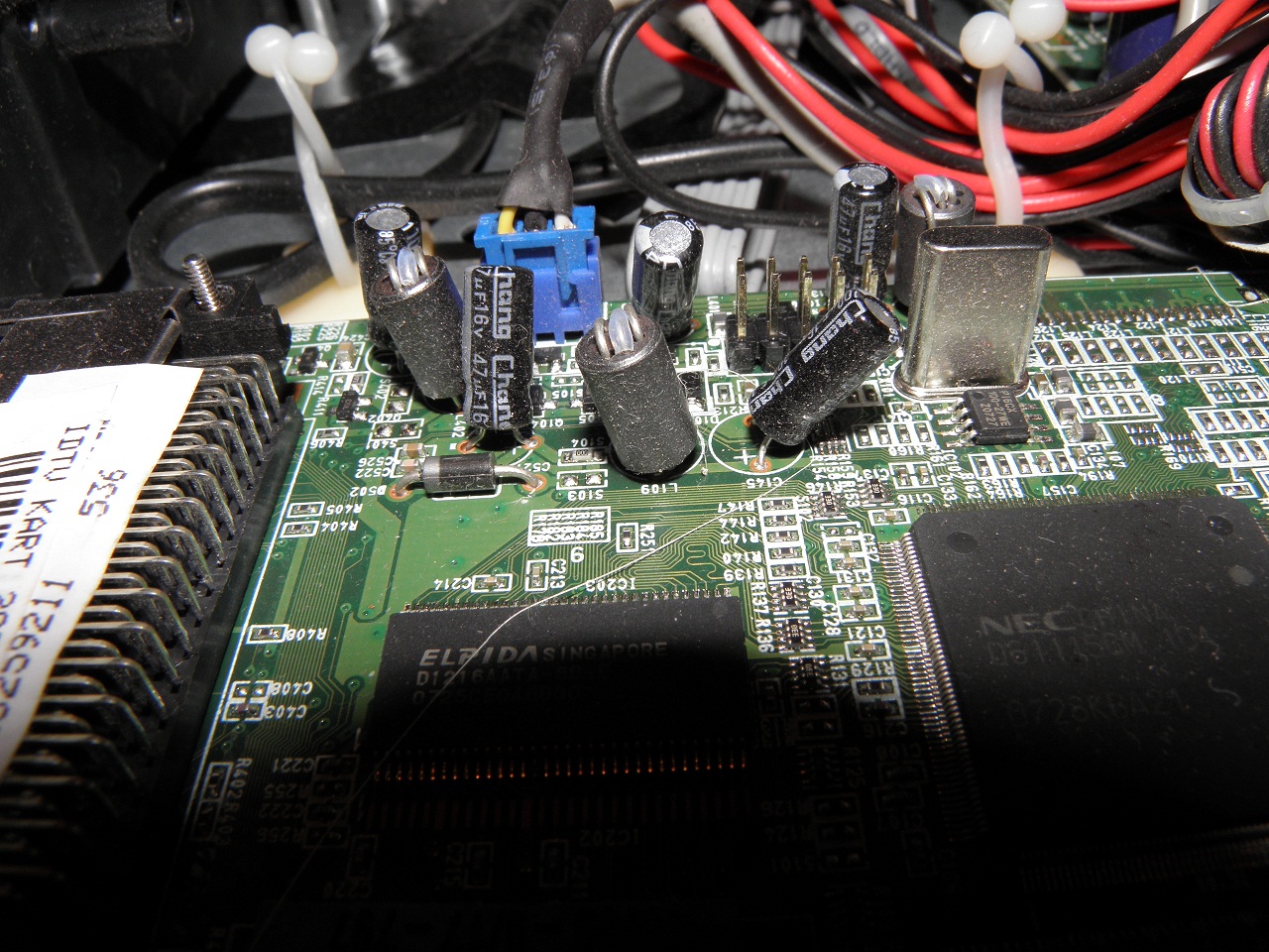

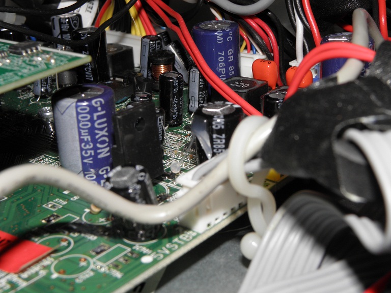

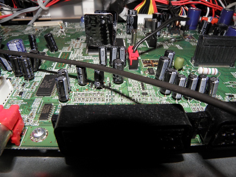

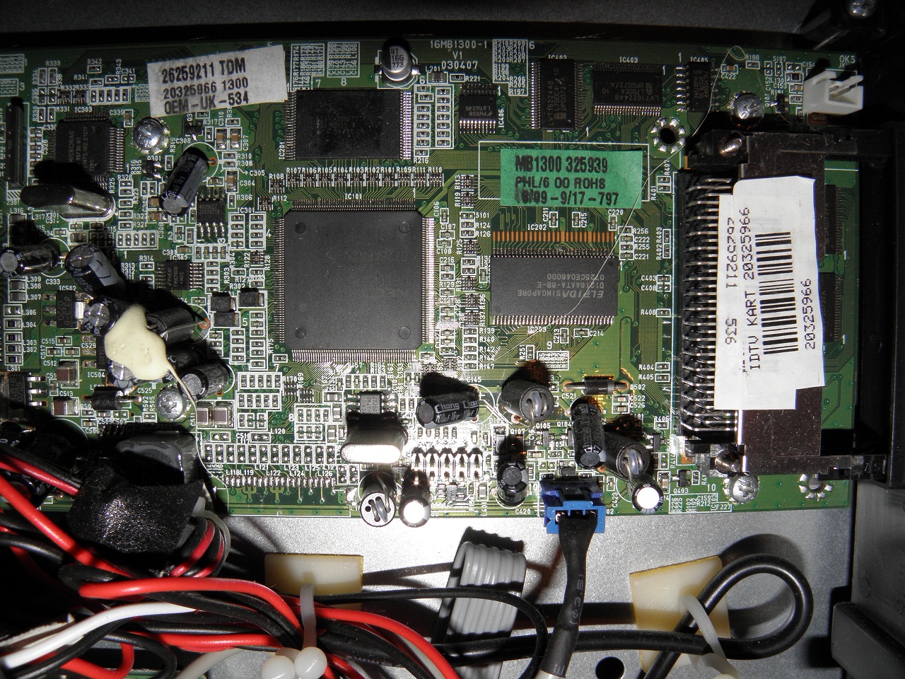

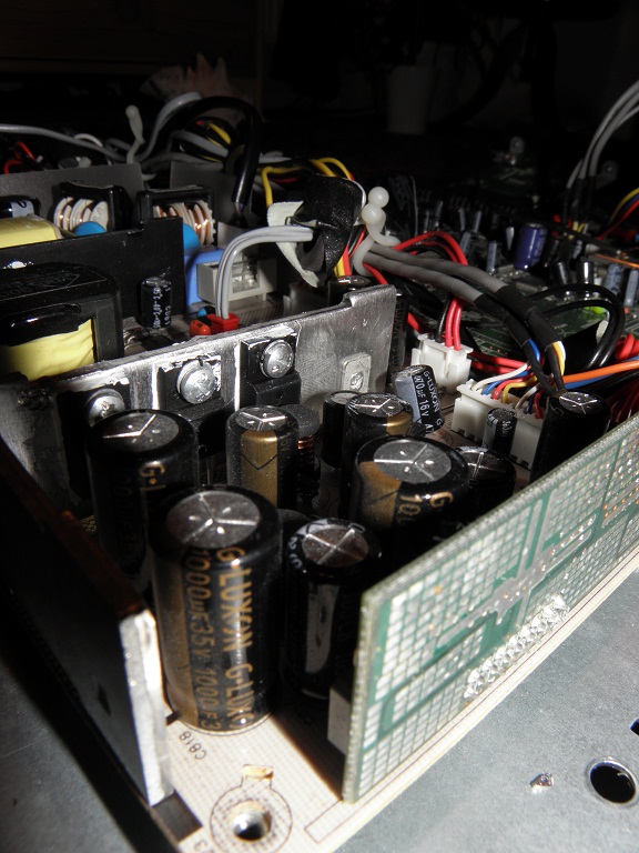

    None of the capacitors are bulging, burst or distorted. No components visually look burnt out or damaged.

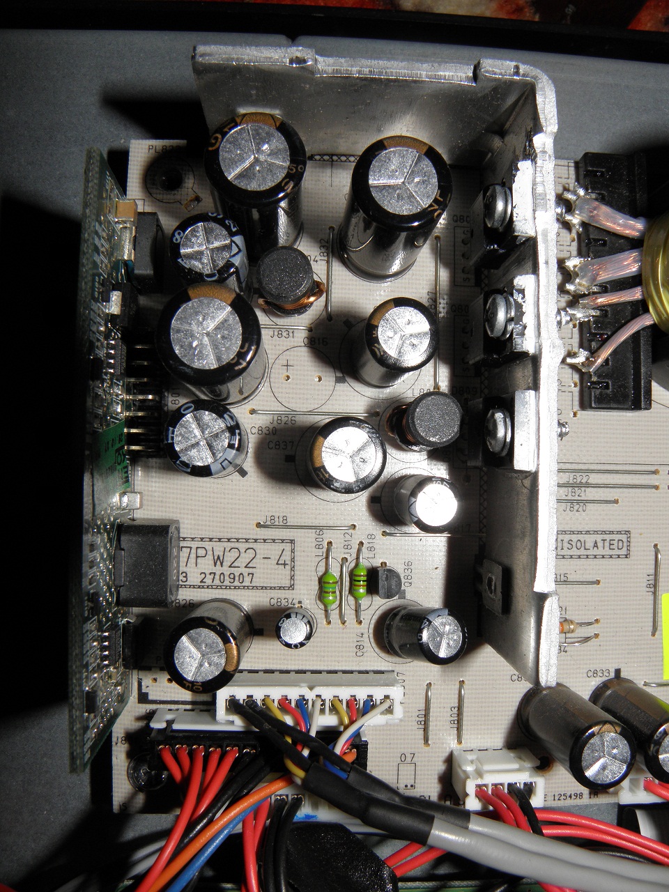

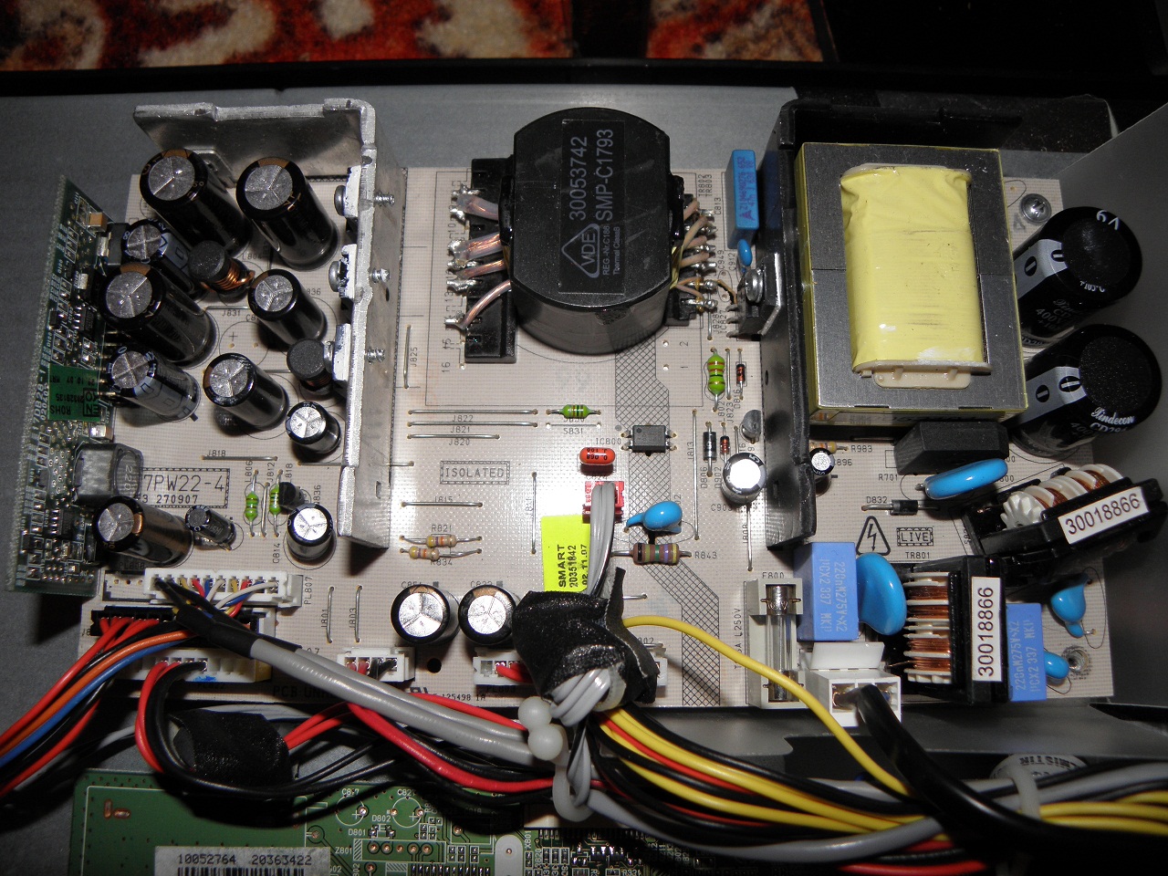

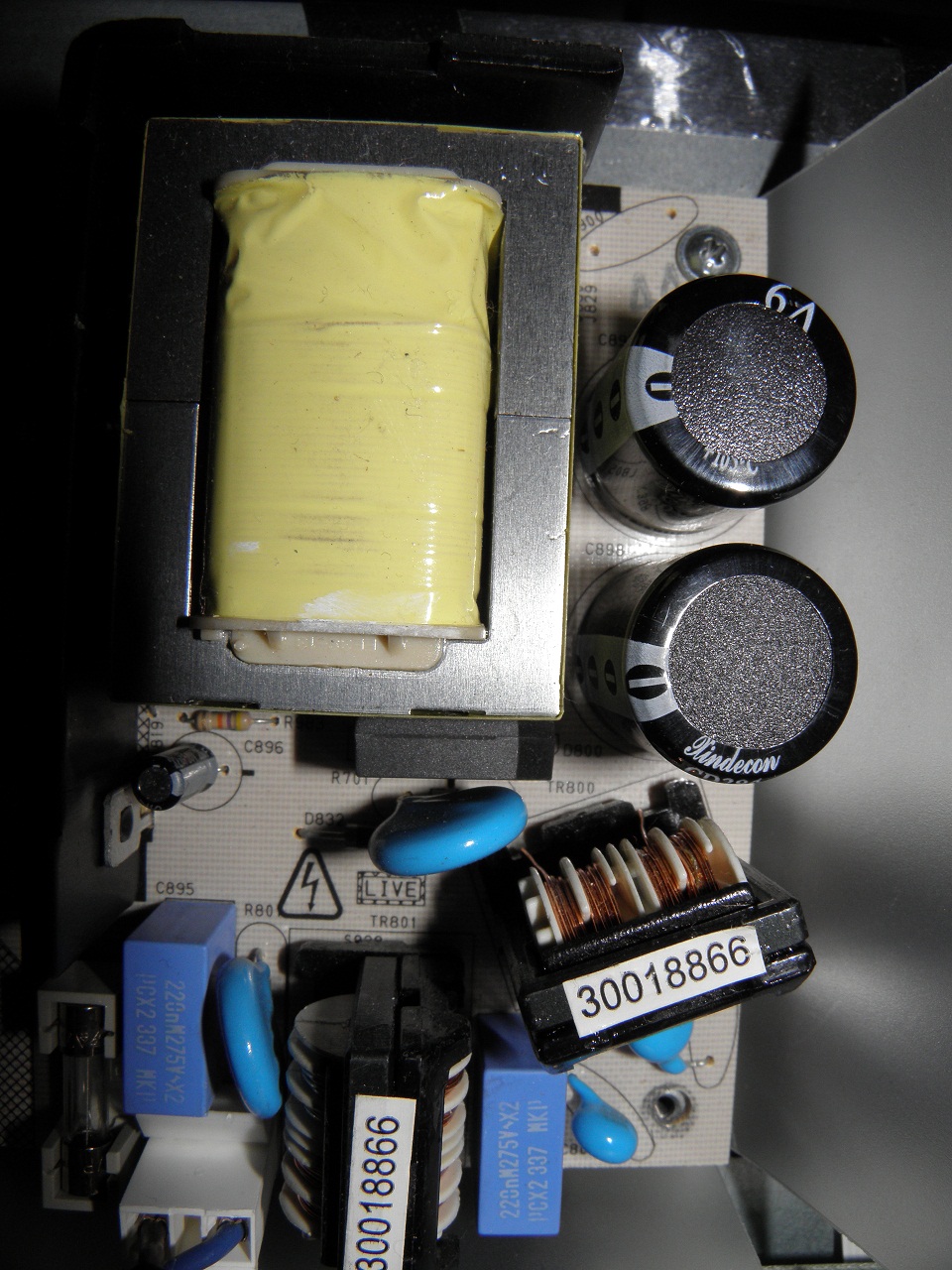

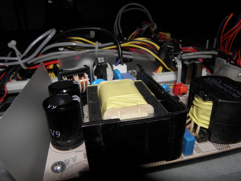

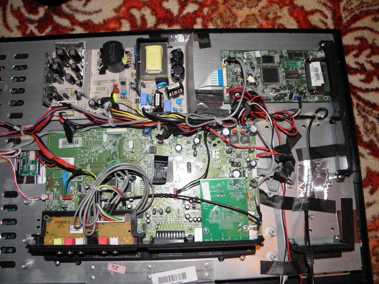

    This tv has generic Vestel boards inside:
    PSU: 17pw22-4
    MAINBOARD: 17mb12-2
    DIGITAL CAM PCB: 16mb1300-1
    PICTURES

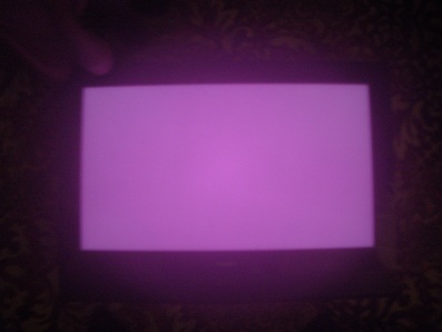

    01 to 14 - pics of tv and pcbs. a)the purple screen pic 02 is the result of night mode - it is actually black with backlight poking through and around the edges. b)pic 07 - the black socket is where the hdmi socket pcb plugs into - took it off for pic.
    x1 to x13 - random pics of caps etc...

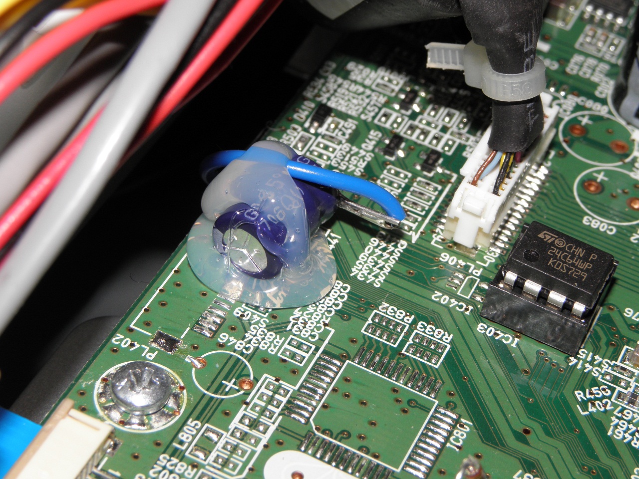

    mainpcbcapmod - a cap soldered and glued to the pcb, have seen a few hits on google suggesting this is vestel factory 'hash' and not a repair.
    Have tried to be comprehensive as I'd like to save this tv because I like it
    Happy to answer any questions or provide further info.
    Thanks,
    Mark.

    Re: TECHNIKA LCD26-207 Sound but no (black) picture... advice please.
    Sounds like caps. There's a whole host of dodgy brands in there - HEC, G-Luxon (actually Teapo), Chong, Lindecon (who?) I'll let someone more qualified answer properly, but they're definitely suspect to me.

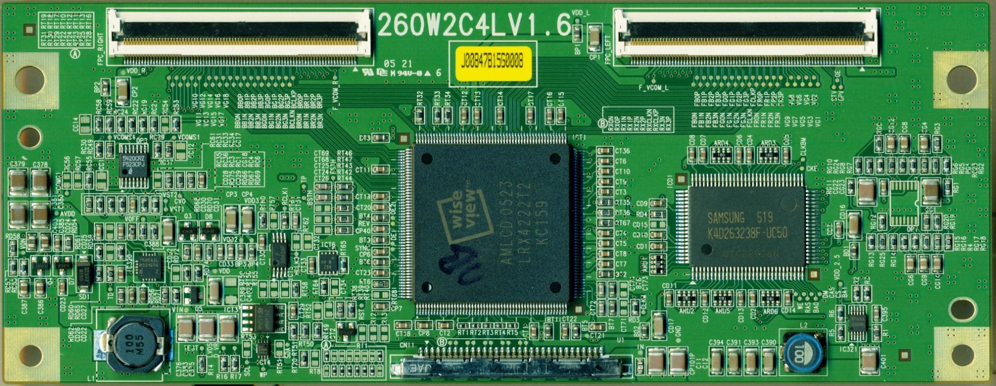

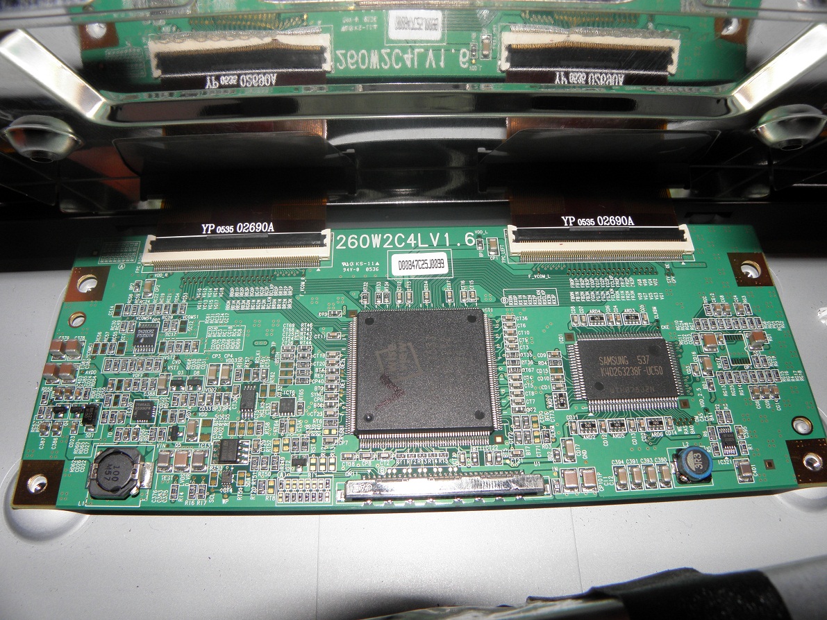

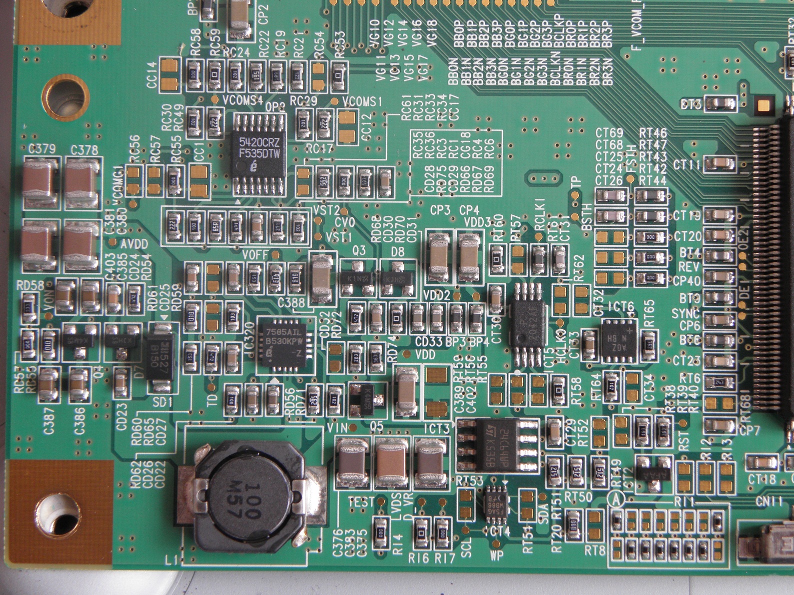

        by t-con - do you mean the LVDS pcb on the back of the LCD panel?
        I've tested the smd fuse marked 'P' and its fine - the voltage coming out of it is 5.23v - so assume that pcb is getting power

          Yes, that should be it. The t-con could still be bad without blowing the main fuse. Therefore, post a picture of it - there are a few voltages that need to be checked.
            Pic below.
            Its got 260W2C4LV1.6 on it

              Okay, there are two voltages I'd like you to measure.
              1) Measure the voltage between test point VDD_2.5 and ground. It should be 2.5v. Using your picture as a reference, test point VDD_2.5 is located close to the lower right corner of that Samsung chip on the right side of the t-con board.
              2) Measure the voltage between test point AVDD and ground. AVDD is located all the way on the left side of the t-con, next to those big ceramic capacitors (C378, C379... etc.). I reckon AVDD should be 10V or more. Let me know what voltage you get for it, though.
              It seems that the left side of the t-con handles all of the power, so that would be the area of most interest to us. Therefore, it may also be helpful to get the part numbers of IC320 (?), IC13, and that other IC above IC13. If possible, please post another (overhead, not angled) picture of the left side of the t-con. My guess would be that IC320 is the main controller for the t-con's power supply - hopefully one of those "smart" controllers (they have good datasheets ).

                Yes, sorry for the angled pic it was a tight squeeze for the large camera without stripping the unit down further. Aerial pic attached below.
                1. VDD_2.5 = 2.48v
                2. AVDD = 4.79v
                3. IC320 = 7585AIL B530KPW - Z
                ICT3 = 24C64WP K535B
                ICT5 above ICT3 = P 2042AF
                  Oh, no problem. It's actually still quite a decent pic. Believe me, I've seen much much worse. The one you just uploaded, though, is perhaps one of the best-focused pictures I've seen. Makes things much easier to analyze.
                  On the TV matters:
                  Originally posted by Markie76
                  1. VDD_2.5 = 2.48v
                  2. AVDD = 4.79v
                  1. VDD_2.5 is fine.
                  2. AVDD is too low, however. Should be 10v or more. 4.79v suggests either something is pulling AVDD low (faulty component) or IC320 is not turning on/detecting a fault.
                  I think the simplest way to check this is to turn on the TV and see if any components in that area of the t-con get hot (most probable candidates for this are IC320, diodes SD1, D7, D8, and transistors Q3, Q4, and Q5). You can use your finger for this (don't worry, there are no high-voltages on the t-con, but do be careful not to get burned, since a faulty component can get pretty hot) - I know this method is not very scientific, but it's effective. You might need to cycle the TV ON/OFF a few times to do this, since IC320 may shut down if it detects a fault.
                  Speaking of IC320, I did find a datasheet for it based on the numbers you posted - it's a Intersil EL7585A and can be found here:
                  It is a "smart" controller, indeed - makes things a lot easier to understand in the circuit. I'm still analyzing it though.

                            Sounds as if the controller IC320 is not turning on or it's detecting a fault. To verify if this is true, measure the voltage on the following pins of IC320:
                            Pin 18 (EN)
                            Pin 14 (VREF)
                            Pin 20 (PG)
                            Pin 16 (FBB)
                            Pin 6 (FBP)
                            Pin 8 (FBL)
                            Pin 11 (FBN)
                            Use the Intersil EL7585A datasheet I posted above as a guidance - page 1 has a diagram of the pin outs. For each pin, measure the voltage between ground and that pin. For pin EN, VREF, and PG, also see if the voltage on them changes or varies when you cycle power to the TV. Let me know what voltages you get.
                            Last but not least, with the TV turned off and unplugged, measure resistance between ground and each of the following test points: AVDD, VON, VOFF, and VDD. If your multimeter is manual ranging, use 2000 Ohm scale. Post what resistances you get.
                            *EDIT*
                            Just noticed and forgot to mention... Pin 1 on IC320 is right where that arrow points in the lower left corner. The pin count then increases counter-clockwise, as per the datasheet.

                                      Measurements as requested;
                                      On Voltage on the following pins of IC320:
                                      Pin 18 (EN) - 0v
                                      Pin 14 (VREF) - 1.22v
                                      Pin 20 (PG) - 5.18v
                                      Pin 16 (FBB) - 0.37v
                                      Pin 6 (FBP) - 0v
                                      Pin 8 (FBL) - 1.42v
                                      Pin 11 (FBN) - 1.09v
                                      Cycling the power;
                                      Pin 18 (EN) - 0v
                                      Pin 20 (PG) 5.17/5.19v
                                      Power off & unplugged resistance;
                                      AVDD - .755 (755 ohm)
                                      VON - 25.1k
                                      VOFF - 58.9k
                                      VDD - 54.6k
                                      Thank you for the effort you are putting in to help me with this

                                        Okay, the good:
                                        Pin 18 (EN) is the enable pin of IC320. When this pin has low voltage (less than 0.8v, as per EL7585A datasheet), IC320 is enabled to work, so what you got above is good.
                                        Pin 14 (VREF) is the internal reference voltage of IC320. Datasheet indicates it should be between 1.19v and 1.235v. You have 1.22v, so that's also good.
                                        Now the not-so-good:
                                        Pin 20 (PG) is used by optional protection FET (not sure if there is one on your t-con). When IC320 detects a fault or when IC320 is disabled, this pin will have high voltage (usually 0.6v or more). Since IC320 is enabled as I described above, then there must be a fault on one or more of the voltage rails, AVDD, VON, VOFF, and VDD. Your measurements for FBB, FBP, FBL, and FBN seem to agree with this. When working, this is what they need to be:
                                        Pin 16 (FBB) --------- 1.188 to 1.22v
                                        Pin 6 (FBP) --------- 1.17 to 1.23v
                                        Pin 8 (FBL) --------- 1.174 to 1.226v
                                        Pin 11 (FBN) --------- 0.171 to 0.235v
                                        So what all of this means is that there is likely one or more bad components on voltage rails AVDD, VON, VOFF, and VDD. My guess would be either a bad ceramic capacitor somewhere or a shorted diode or transistor. Not likely to be a resistor, though.
                                        With that said, let's start with the easy things first: Using your multimeter (either diode/continuity test or resistance @ 2000 Ohm scale) to check diode SD1 (next to inductor L1). When negative (-) probe is on cathode pin of SD1 (side marked with a stripe) and (+) probe on the other, you should get lower resistance/voltage drop than when you reverse the probes. Nothing less than 50 Ohms/ 0.05 voltage drop, though. If you do, let me know.
                                        Otherwise, if SD1 checks out fine, the next step would be to check some of the ceramic capacitors in the area (compiled list is at the end of post). The good thing is, you can check them without removing them from the t-con. Just use your multimeter to measure the resistance across each. Start with 2000 Ohm scale. If any of those ceramic capacitors measures under 100 Ohms, write down the resistance and post it here. And if any of them measures less than 50 Ohms, definitely make note of it and post it here. The typical failure mode of a ceramic capacitor is short circuit (2 Ohms or less), but sometimes they can fail with a slightly higher resistance of 50 Ohms or less - just enough to disturb the whole circuit.
                                        Now, you have already done a resistance test on voltage rails AVDD, VON, VOFF, and VDD, and the good news is, none of them appear to be shorted to ground. This means that the following capacitors have also been checked (therefore you do not need to check them again)
                                        C378, C379, C380, and C381 (the big 4 ceramic caps by test point AVDD)
                                        C386 and C387 (near test point VON)
                                        C389 (next to VDD), CP3 and CP4 (above test point VDD2 and VDD3)
                                        C388 (near VOFF)
                                        C376, C383, C375 (the big ones connected to VIN, to the right of inductor L1).
                                        Again, those capacitors I mentioned above have been checked already. That leaves just the other smaller ones. Starting at the top-left corner on the picture you posted and going left-to-right, top-to-bottom, these are the ones I think that need to be checked (I'll try to group them as much as possible):
                                        CP2; CC17; CG18; CD28 and CD29; C403, C385, and CD24 (next to VON); CD30, CD31, and CD33 (above VDD); CT30; CD23 (next to diode SD1); CD27; CD26;
                                        Note: you may need to rub the multimeter's test probes a little bit on each cap lead in order to get an accurate reading.
                                        And that's pretty much it for now. Sorry for this big wall of text. Hope it helps somehow, though. Let me know if you have any questions.
