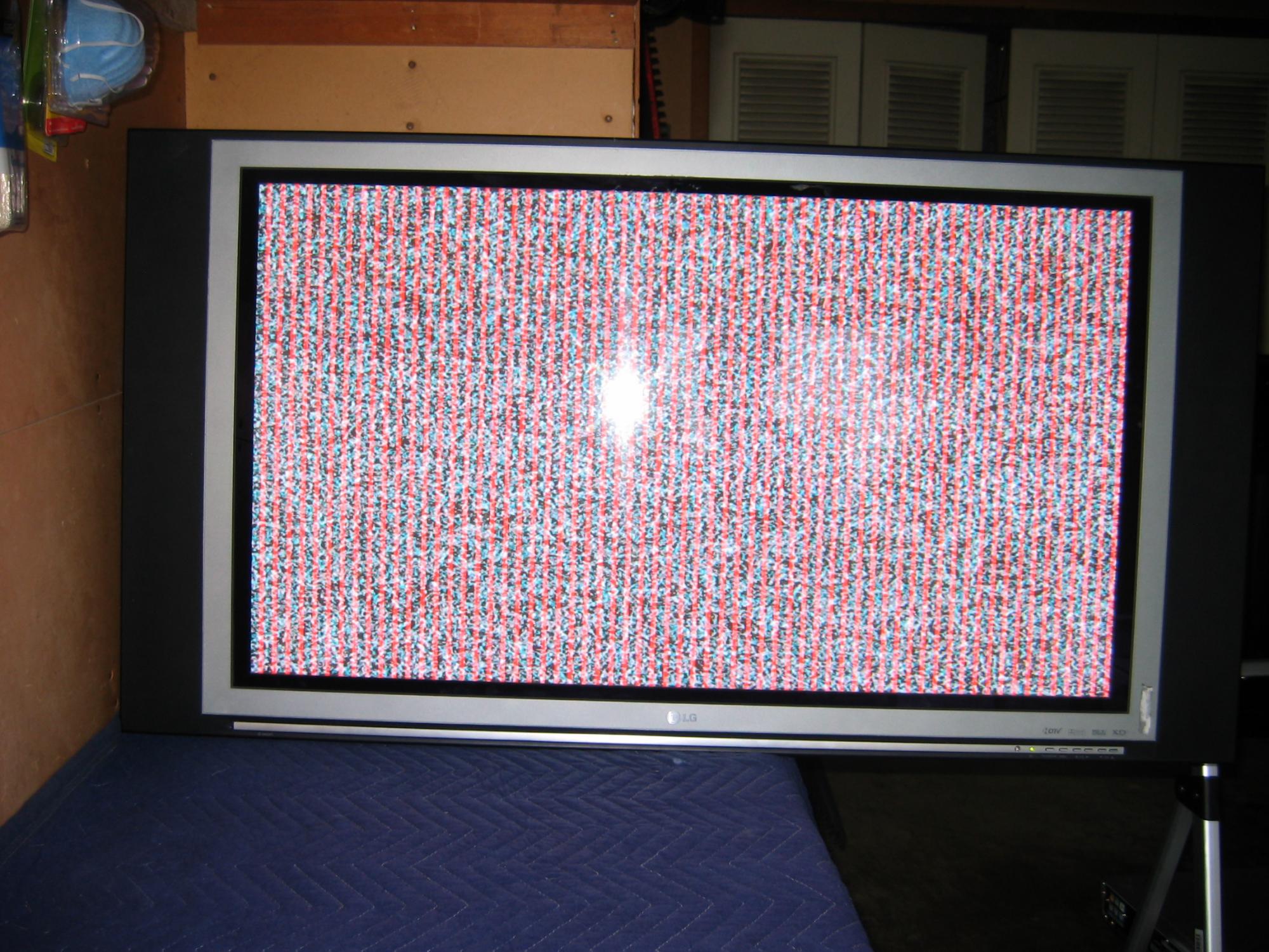

    Hi guys i am new here, let me get straight to my problem,
    after replacing the z and y sus boards because my tv when power on no picture only sound, with the new boards there is a picture with red vertical lines all over the entire screen, already adjust all the necessary voltage but lines would not go away please can anyone help me. LG -DU-42 PX12X

    Could you please post a picture of the screen showing the failure?

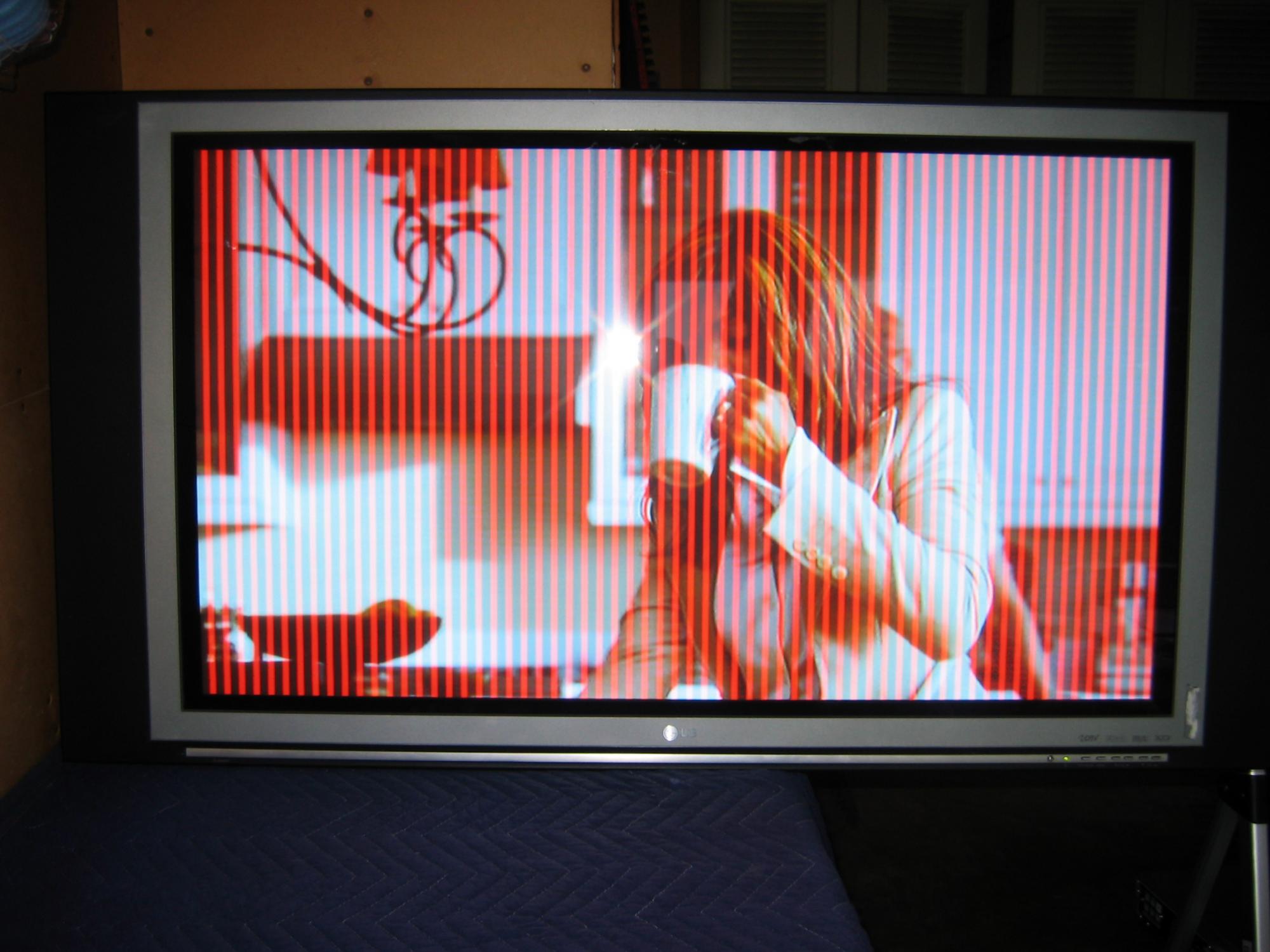

      Recheck the panel connections. You may have misaligned one.

        Any ribbon cables from control board to y and/or z drive and any cables from y/z board going to x drivers (boards along the bottom of the tv) can cause this as said by V/E.

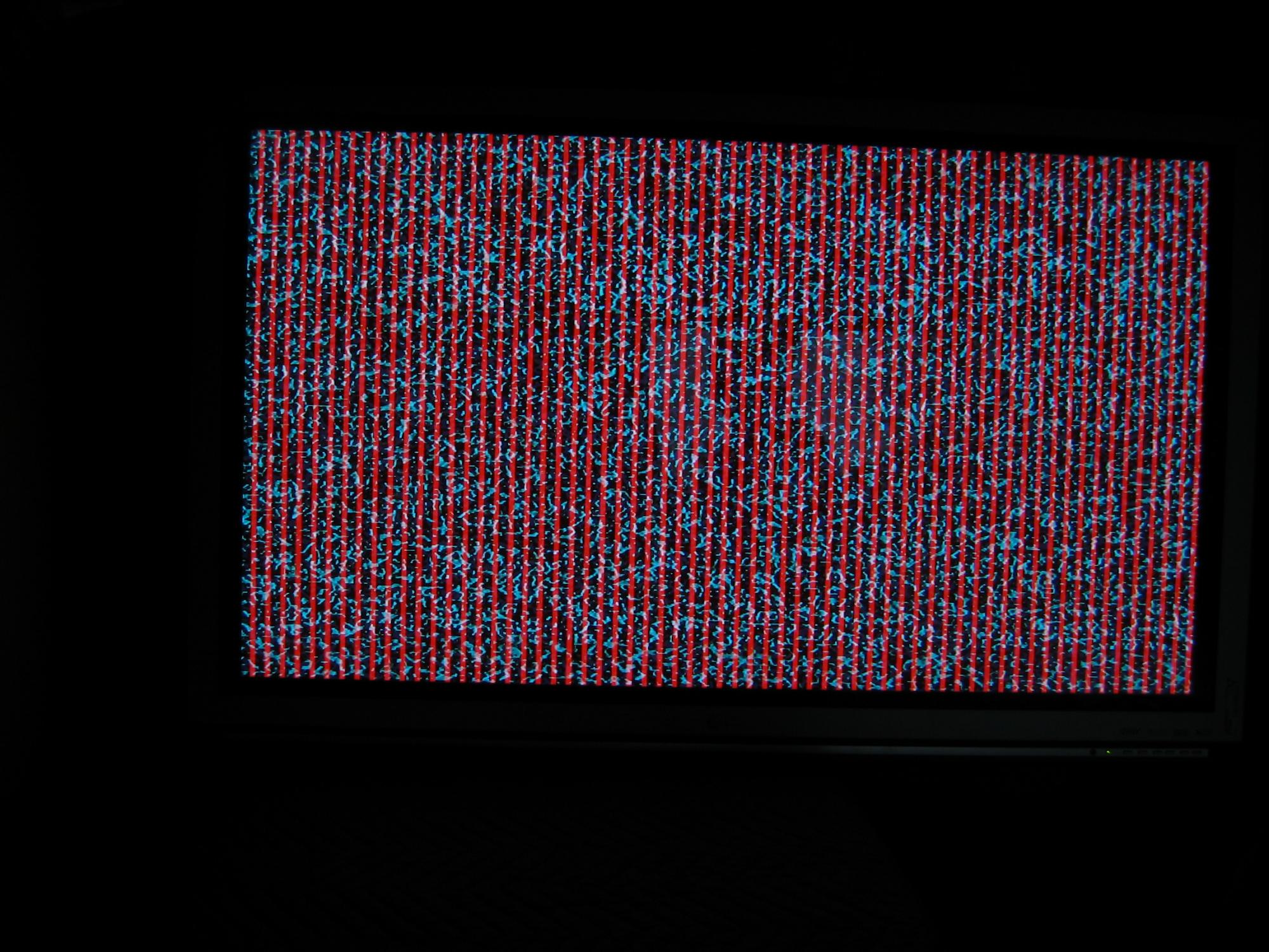

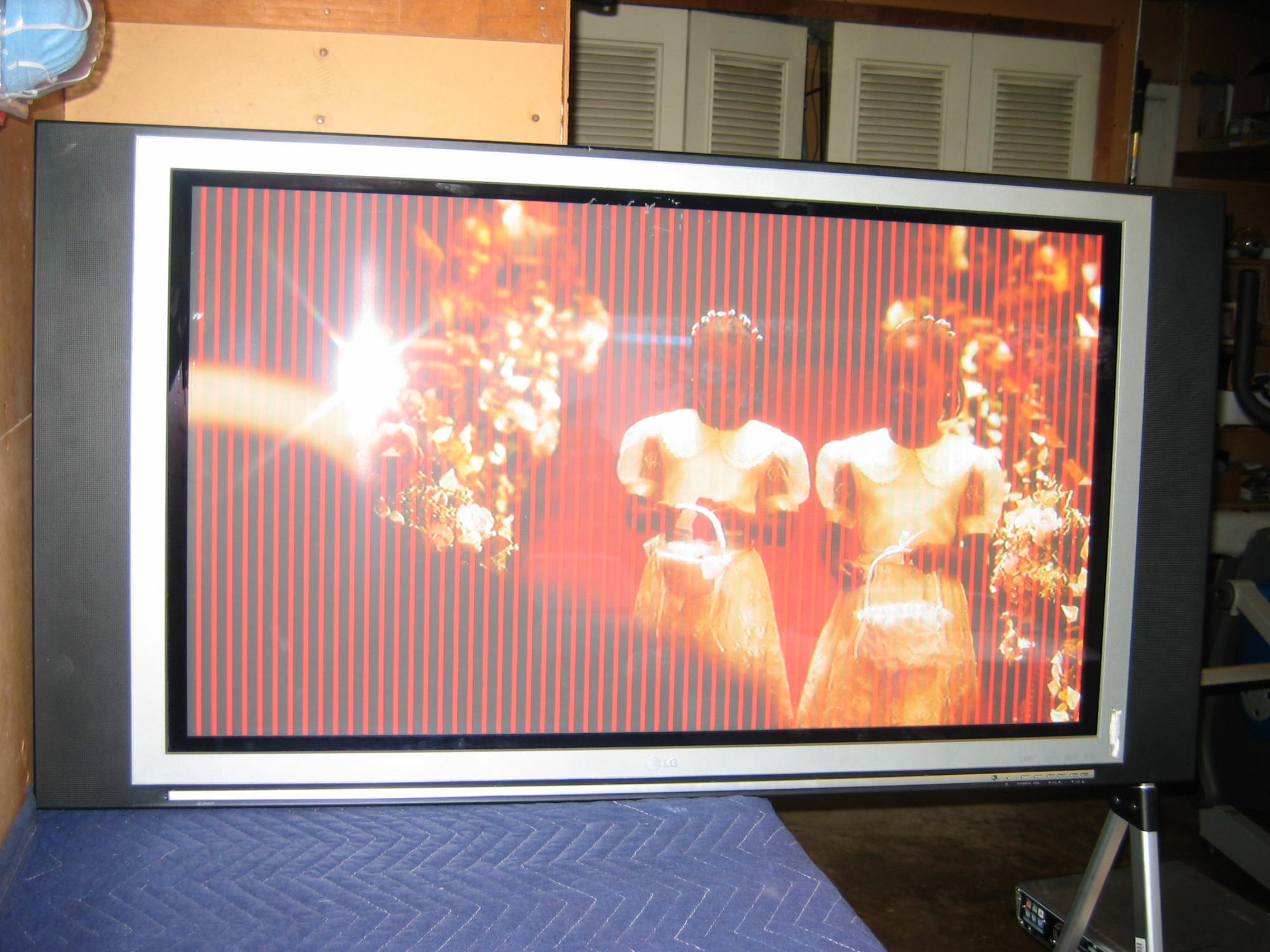

          Re: plasma with vertical lines and photos
          hay guys, here are some photos, at first when power on the TV there were no picture but sound, after replacing both Z and Y SUS boards i have a picture with sound and vertical lines in the picture. all the necessary voltage adjustment was done in white wash mode.

            buffer issue perhaps?
            see if any of the buffer chips are running signifigantly hotter than the others.
            also check the largest surface mounted fets on the buffer boards. Ohm between the center tab and the right leg of each one and post your results.
            i just fixed one of these with a shorted q1 on the top buffer board so this may be worth your time to check.

                            That looks like a control board issue. Regular vertical lines on a plasma is usually a fault with the control board.

                                Search for the service manual at Elektrotanya.com
                                Sometimes there are testmodes that can be selected on the logic board (like shorting a jumper, the service manual should tell exactly) then the logic board may generate a testpattern or a all white screen. This would tell if the logic and upstream multiplexing is OK, or if the signal from the mainboard is bad.
                                The repeated lines could be the result of a bad adress or data line in the logic board.
