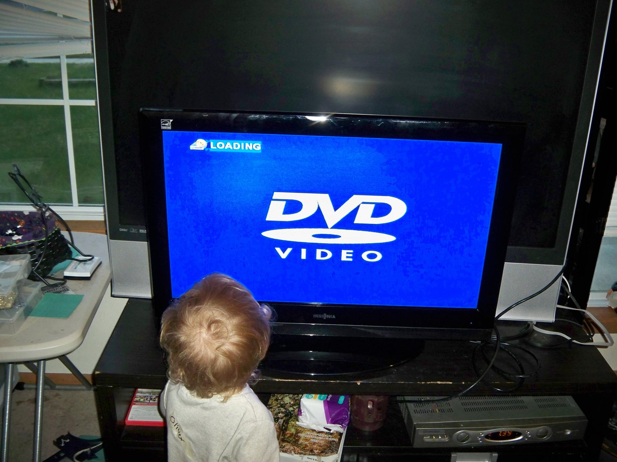

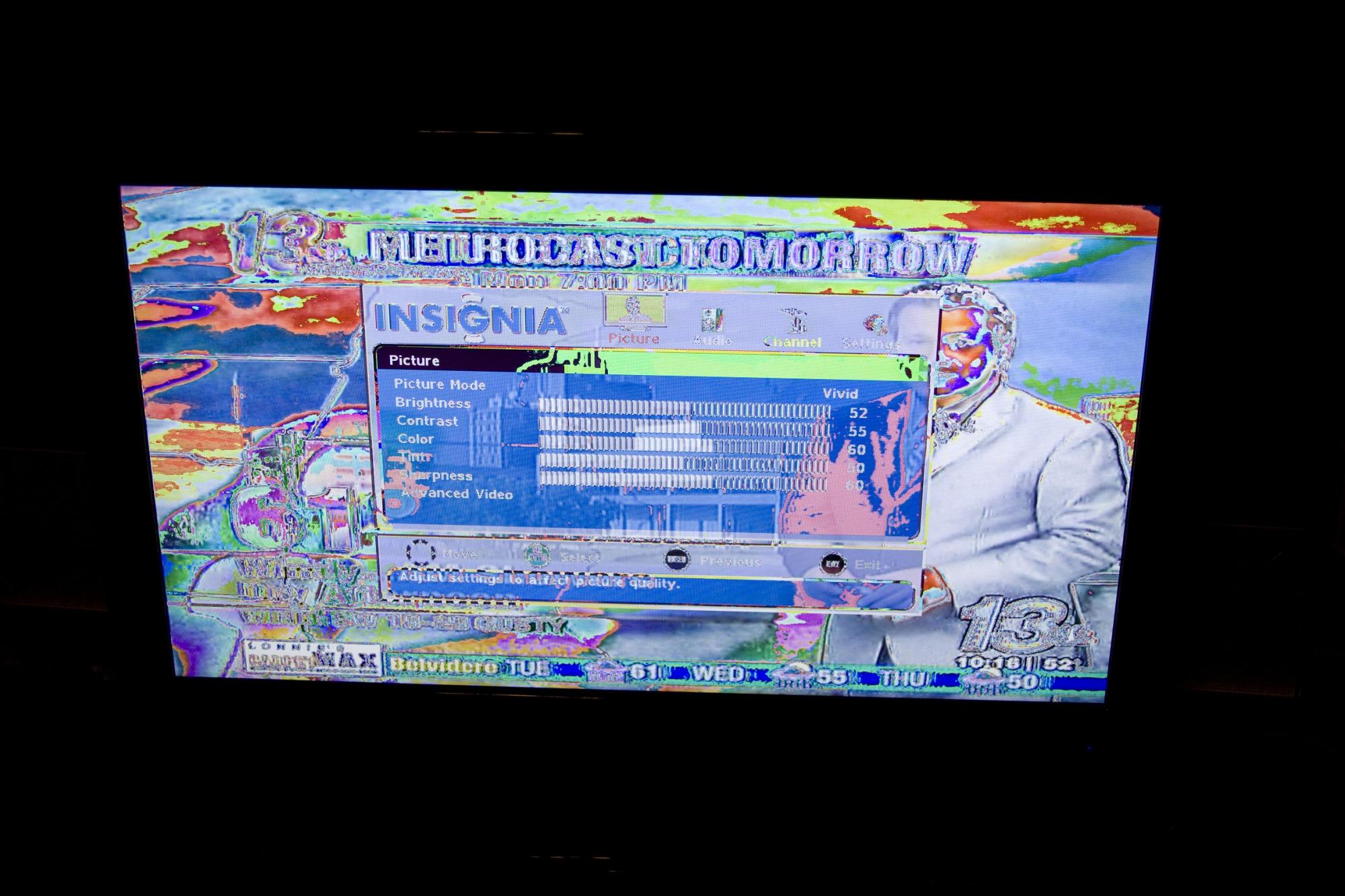

    insignia 32" ldvd32g-10a acid trippy osd+ inputs
    Man i got ripped on this one... traded a nice 42" plasma i just fixed for this supposdly perfect working unit and a bunch of other junkers..
    when i play a dvd in the onboard dvd player, the pic looks good. THe little box that says "dvd" momentairly in the upper left also looks good.
    However the osd and any inoput i use looks acid trippy- like a photo negative almost.
    Has anybody ran into this? google search shows alot of folks with the same prob. Hopefully i have a blown pico fuse somewhere or something else simple.. this is a bummer man.

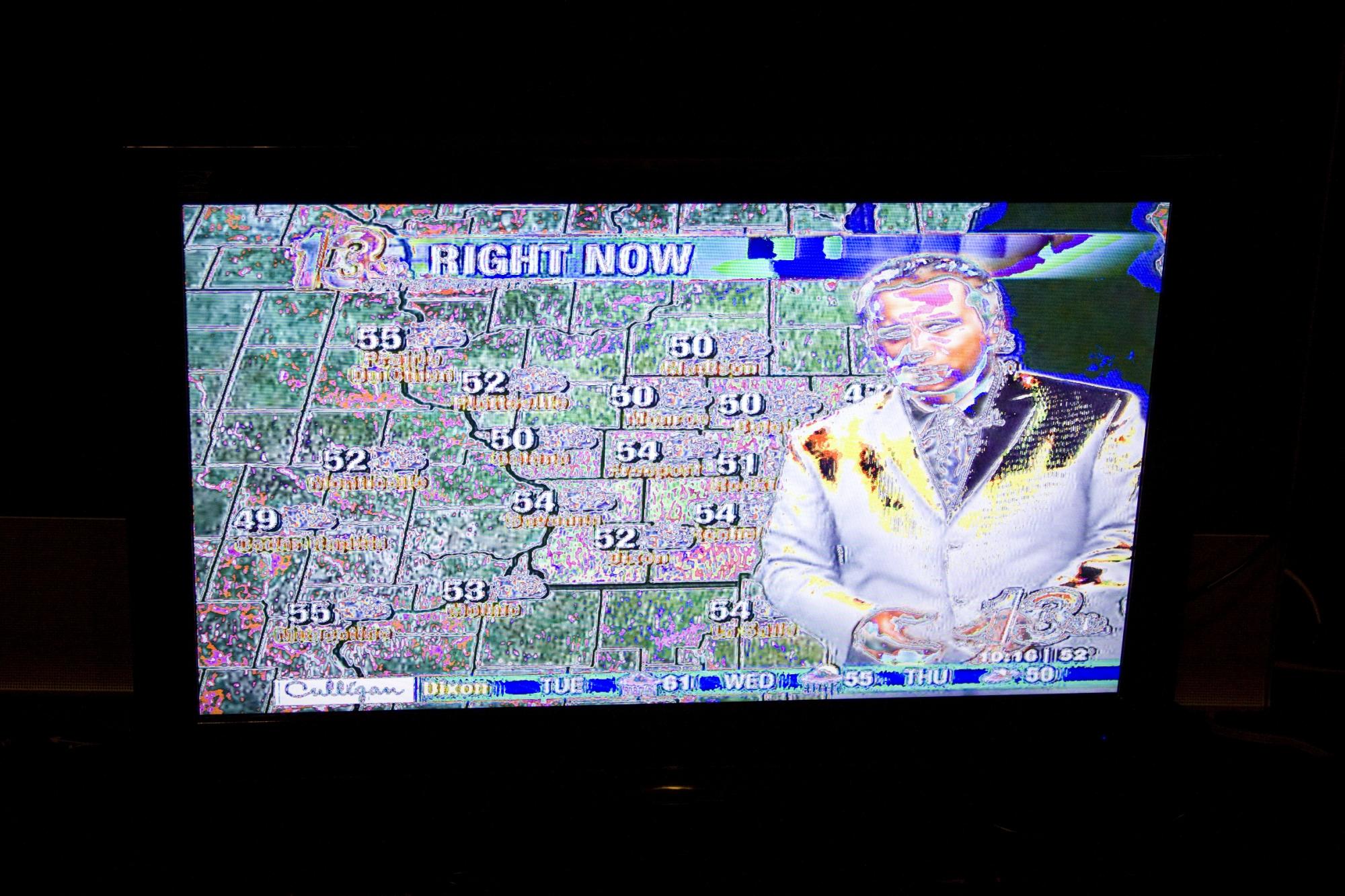

                Re: insignia 32" ldvd32g-10a acid trippy osd+ inputs
                all the red green blue component inputs look like that. all the tv function osds look like that. vol display looks like that.
                onboard dvd looks good, cable input shows regular colored snow so id assume thats an ok input( i need to get a remote fort this damn thing- id like to try a factory reset just for gigs)

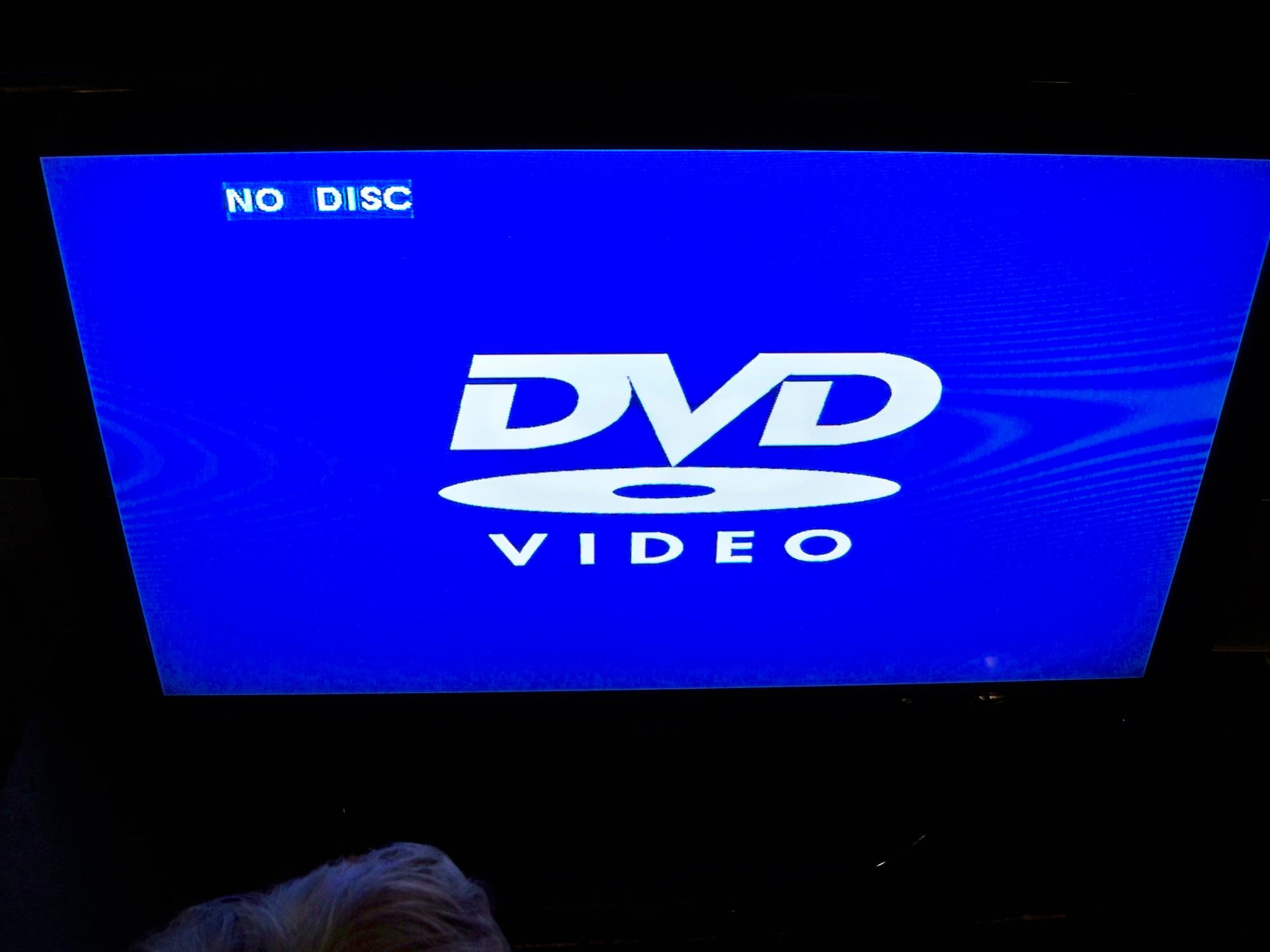

                        ok wtf.. man i promise you when i checked this yesterday at work i played dvds for about 6 hrs- screen looked great. the only distortion noted at that time was with the osd only.
                        now the video from the dvd player is also trippy. Un fing believeable.
                        Could be this tv was mostly fine untill i transported it home or something....
                        heres pics of the remaning screen that is still "happy"
                        weired stripes in the second pic are from the camera..
                          Whenever you do post a picture, post one of a good dvd picture. This set's problems are puzzling.
                          • Dgtech
                            E. Technician
                            • Apr 2009
                            • 1462
                            • Steeler
                            that pic is a clue however the dvd pic should be when the dvd's playing. That screen is just a two color screen. Hard to confirm the problem is still there or not.

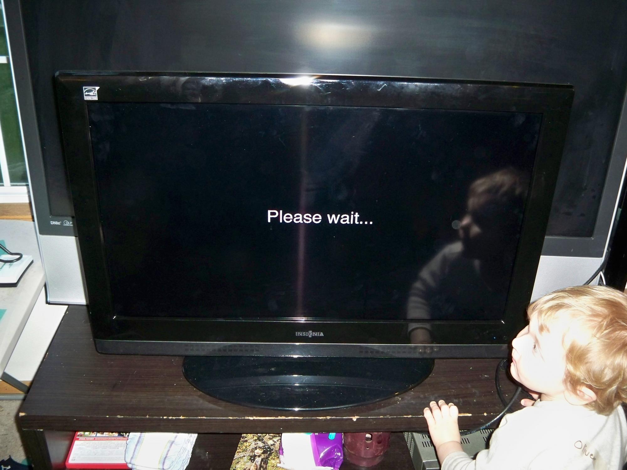

                              Its there now. Im sure you think im nuts but it was not there before.
                              i guess 6 hrs of watching movies at work isnt good enough for this pos. Im not bothering to take a dvd pic because it looks just like the damn other stuff now.(however intermittently ill get a brief glimpse of proper color)
