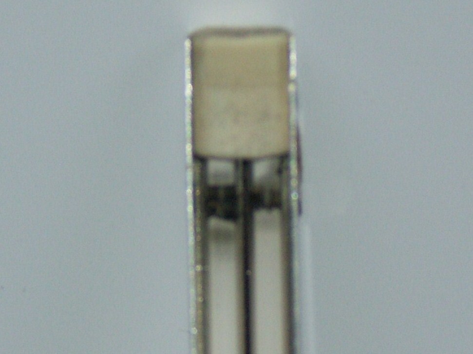

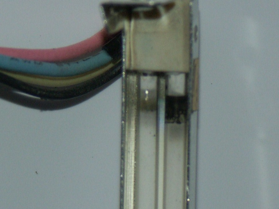

    been over this one a little, this ones actually my first victim form way back when. At the time it was torn down and checked for bad caps. Thats as far as i went. WHen powered on, it works ok for 10-20 secs then the backlight goes out. Seems to have a hint of pink in the whites for some reason also.
    have any ideas? going to check the inverters now..
    Pink is an indication that the ccfls are dying.

      That would make sense. Ive checked over everything now, all fuses and "0 ohm resistors", checked the primary and secondary of the little transformer for the ccfl, followed the taced back to the trsnsistors that kick it on and they check ok as well ( no shorts)
      i guess im going to take this lcd apart and have a look. Gotta learn sometime. I actually have a 19" dell lcd thats cracked, but thee backlights still work in that... hmmmmmm...

        Well we have a conformed ccfl failure.
        Bummer is i canot find my parts lcd to rob the ccfls out of. Oh well.
        This thing is toasty man!!!
        SO today ive learned that when ccfls start to go bad, the screen gets pink. Ive also learned how NOT to take a lcd panel apart, howeve ri do still have a good lcd itself. I learned to be very careful with the diffusers, you would almost need to setup a hospital clean room when you mess with those.
        But this tv was free from way back when, mabye someday ill find a compatible lcd assy to jam in there or itll be good for parts to fix other tvs with. Cool man! The more i tinker with these the more i absoultely love it!
